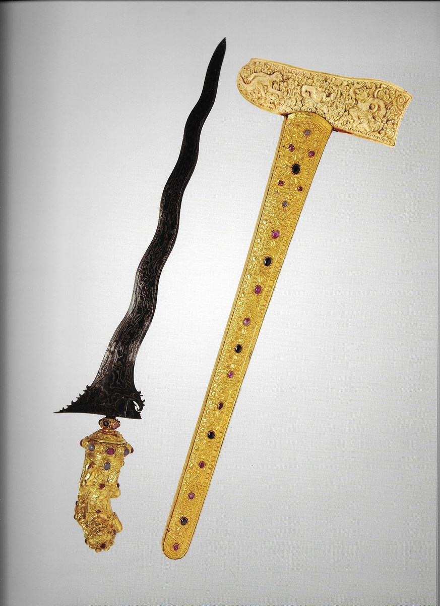

I found this specimen of kris Sempana Robyong Luk 9 on page 251 of the Bali kris book mentioned earlier so this dapur name is actually used at least in Bali.

But what about the illustration in "Keris Bali Bersejarah"?
Well, the text for that book was written by a man who is a talented craftsman who makes keris, he is also a very talented writer. I knew one of his teachers quite well, and I know that this man, Basuki Teguh Yuwono has a reputation for many talents, but I would prefer not to mention these. Basuki Teguh Yuwono is Javanese, and the text of "Keris Bali" has a decidedly Javanese flavour. The fact that he has described a Balinese keris as dhapur Sempana Robyong cannot be taken as evidence that this term is in use in Bali. In fact, if we are to take any notice of Haryoguritno and Raden Tannoyo, Basuki Yuwono has given this keris on Page 250-251 of keris Bali the dhapur of Sempana Robyong in error. This keris clearly has only a single rondha.
