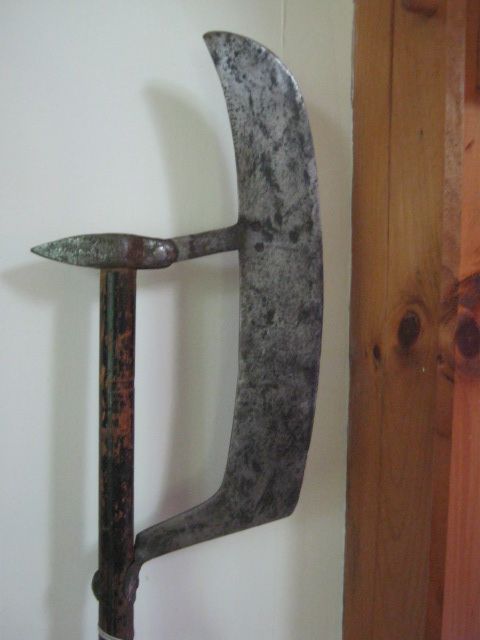

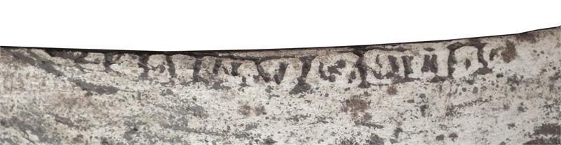

I acquired this some years ago from Fagan Arms, so, needless to say, I overpaid.
Here is the original description from them:
“RARE ANTIQUE ITALIAN VOLGUE C.1550-1600
Known in Italian as a falcione. The iron axe blade with a Gothic alphabet stamped inscription along the back edge. The heavy forged iron top spike for attacking armor with connecting bar to the blade shows wrought iron lamination and traces of an inscription. The volgue originated in Switzerland and evolved into the halberd as well as evolving in its original form through the 18th century. Town arsenals were stocked with volgues along with other weapons and armor. They armed the populous in the event of attack. This example may be dated to the period of full plate armor by its combination of heavy back spike and sword like cutting blade. Length: 63 1/2".”
I don’t dispute that it is properly a voulge, as opposed to a bardiche. I think the heavy backspike does imply plate armor days, so I’m thinking pre-1650. The angles of the spike are no good for hooking, it isn’t sufficient as a counterweight, and it would be a waste of iron if it wasn’t included for the purposes of being used as a spike. It appears to be a purposeful inclusion/design.
Fagan Arms does not supply prior paperwork or details, but I think it’s a safe assumption they acquired it with some sort of knowledge it was Italian, whether by the prior owner or if they got it from Italy directly.
Construction-wise, I see no other extant examples that combine these features. Obviously in the world of polearms, we see a lot of variations and hybrids, so sometimes we just have to be satisfied with a mystery.
However, the inscription on it could have some clues. I’m unable to identify the characters, but was wondering if anyone here had some insight.
Photos attached.

As you well note Guy, countless variations and hybrids found out there are some times close from astonishing or, if one prefers, do look unreal.
I would humbly advance that some particulars in this example look made by a handyman, as opposed to a regular regular smith; that back spike, together with fixation to the blade, sure look unorthodox, so to say. On the other hand, it would be a good sign if the inscriptions run symmetrically along the place where they are engraved... if i make myself understood.

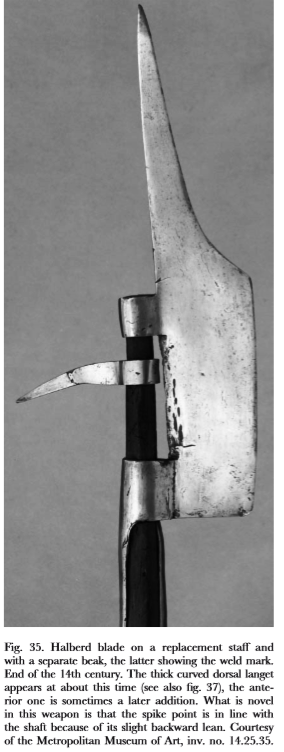

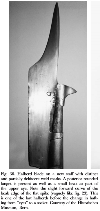

I bet you are aware of HAFTED WEAPONS IN MEDIEVAL AND RENAISSANCE EUROPE by John Walman. Could your example belong in the same typology of the attached ?
... Notwithstanding the posture of your piece's main blade indeed reminds the shape of a bardiche
Please take all my words with lots of salt; no expertise here .

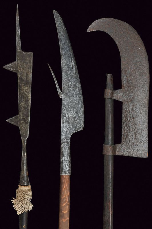

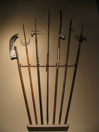

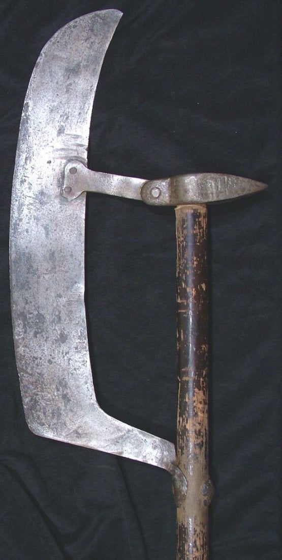

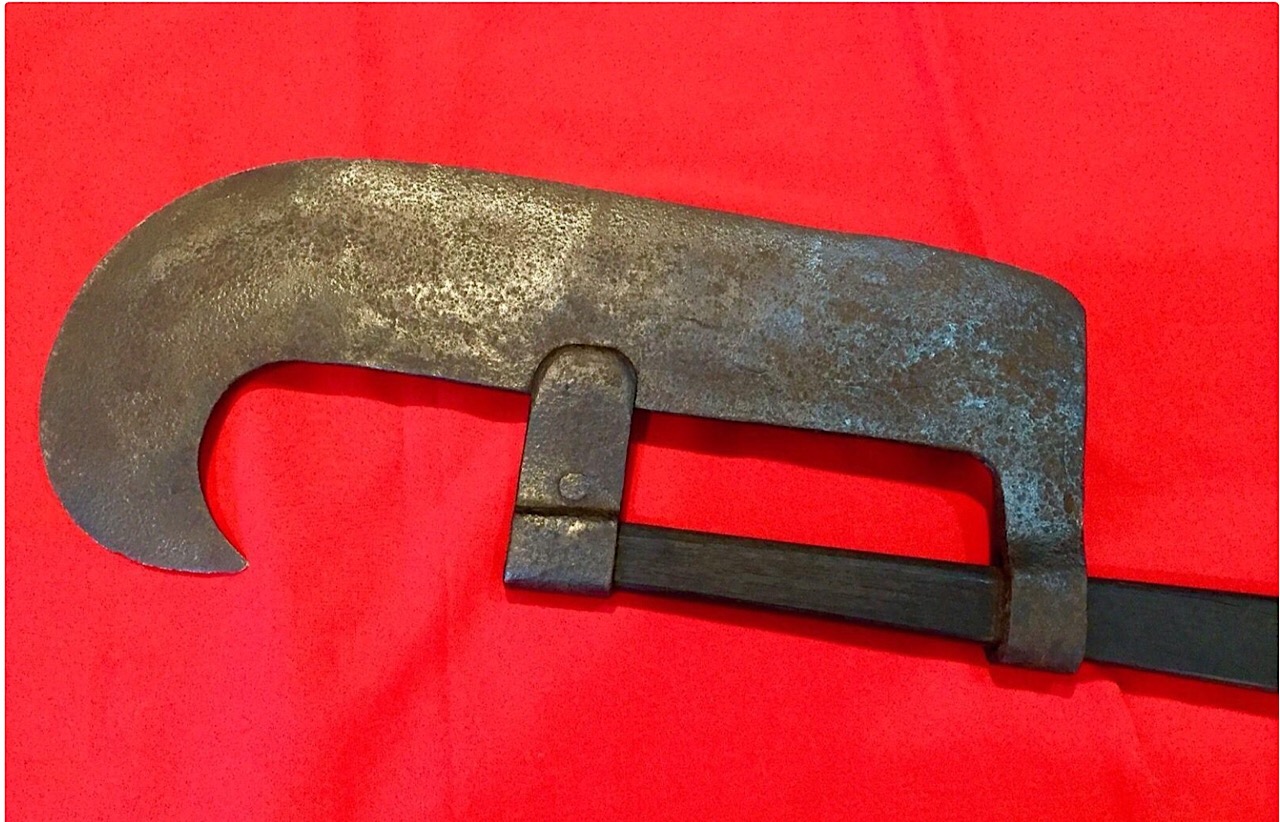

I hesitate to group mine in with 15th century halberds. On the other hand, very little attention is given to peasant weapons, so examples would be rare.
We do regularly see similar blade shapes show up for sale, but we can’t trust their descriptions on EBay or other websites.
I have attached a few examples from the Internet, and one from the Higgins Armory. These types are usually associated with 16th-18th century France, Italy, and Scotland.
Because there is are so many “possible” explanations from my item, I think the inscription is the only key to information, and the back spike is just a hint or clue toward age.
Photos: Red: reportedly Scottish 18th c. Black, no info. Group photo: Higgins Armory
The example from Higgins was eventually auctioned off as being 19th century in the style of the 16th century.
One thing we do know is that faganarms tends to only sell good items. They may be the only seller out there that Ive never seen an obviously bad item or bad description from. I suppose that goes along with their prices.
Concerning the Higgins armory and many others like it, most tend to have some later items mixed in. The "Bavarian Sabre Halberd" seen in your Higgins photo. They are known to be later fantasy produced items that did not exist as a weapon. The point is, just because it is found in a museum does not mean it is a good example.
The fact that your blade is thin goes a long ways in confirming it a wepaon rather than farm tool for chopping brush or wood.
I do wonder if the top spike might have been a later addition as a means to mount it to the current haft? With an item of that age, it could have been added at any point over the centuries. Has anyone else ever seen a similar spike?

It looks like a rather efficient polearm. A volgue is basically a meat cleaver on a pole. I think the hinge contraption aids the cut by sliding the edge slightly. Then like the multi-purpose Swiss army knives, you can turn the polearm around to deal with plate armour by using the thick spike (similar to the early halberds shown by Fernando above) instead.
These kind of ”peasant arms” tend to have fairly basic decorations at best. They were intended to be cheap and functional. The inscriptions (if that’s what they are) don’t look like Gothic letters to me although I can’t decipher them. It could well be very faded letters in a Romance (evolved from Vulgar Latin) language like medieval Italian?
