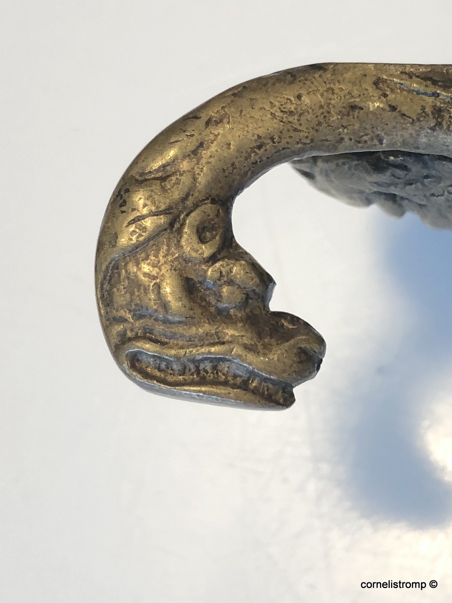

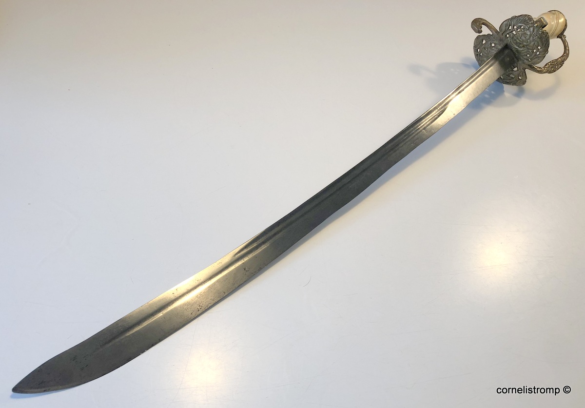

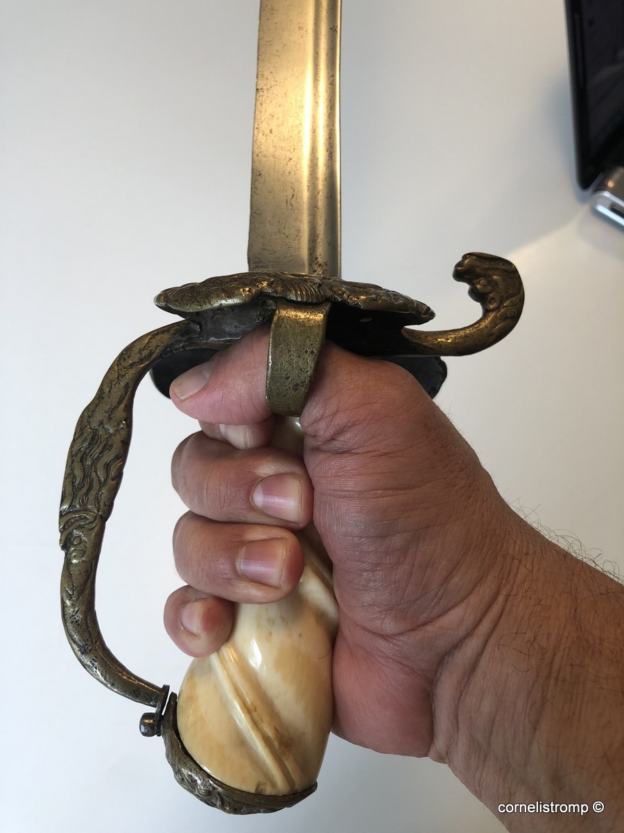

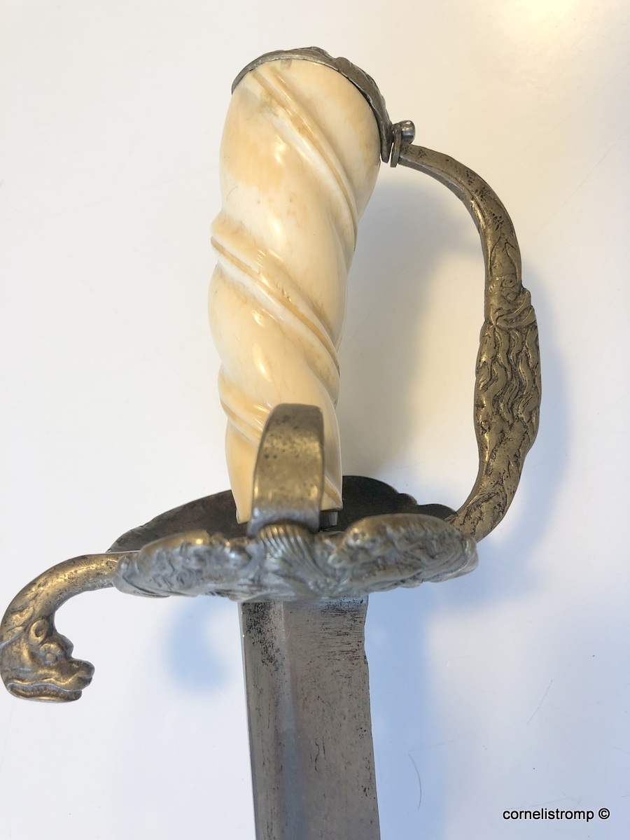

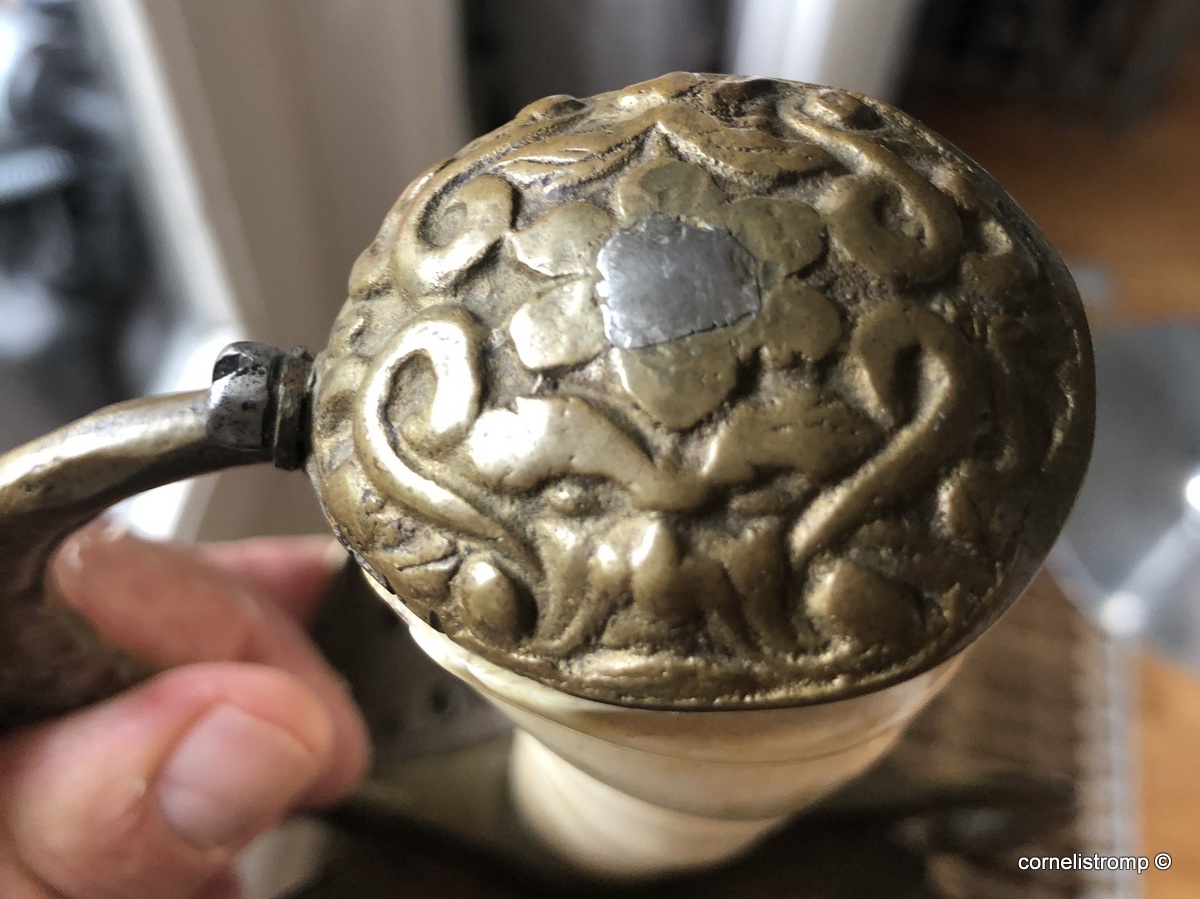

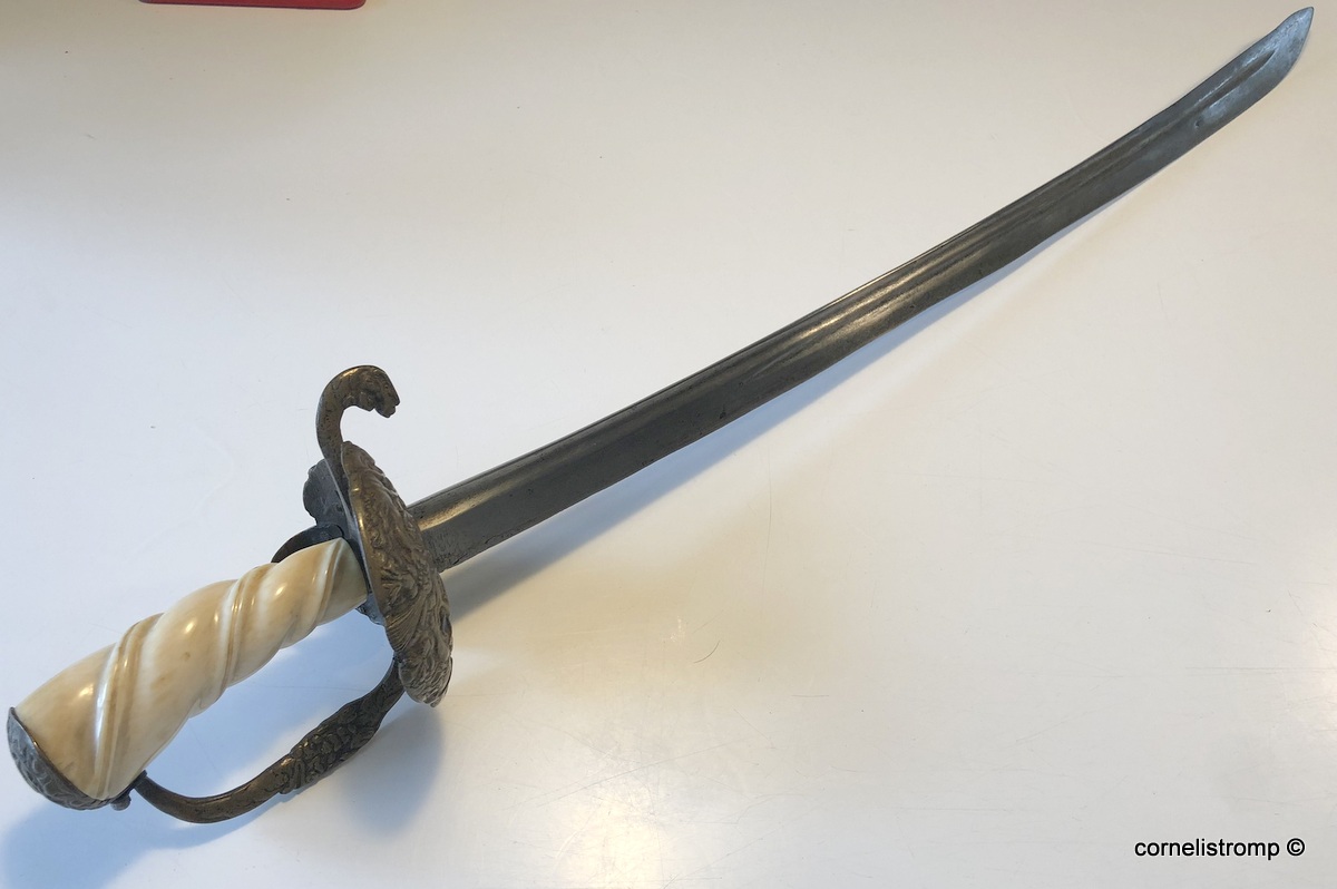

I recently purchased this hanger at an auction. The cutlass is of a very large proportion, almost 90 cm long, with big brass cast shells of unequal dimensions, an ivory carved grip and a cast pommel cap. the sharp blade has a slight bow and a 20 cm sharpened clip-point.
Weapons of this type, construction and material were made in the Netherlands in the second half of the 17th century, mainly in silver and brass.
My theory is that this weapon was also made in the Netherlands for the export market, probably Russia, given the design of the pommel cap.
The image of the Sultan on the shells, attacked by two hungry lions is probably Mustafa 2, an Ottoman sultan who reigned at the end of the 17th century.
best,
Jasper

Do you think the sword originally had a tang nut which was removed to rehilt it, and replaced with a peened tang?

hard to tell if there had been a tang button, see fe examples on

I am wondering if refurbishing at some point in maintaining these long favored swords and keeping them serviceable might account for the seemingly incongruent peen.

furthermore, the sword has been taken apart very recently, probably to clean and remove free play.
no further conclusion can be drawn from this. as I can see, all parts belong together.

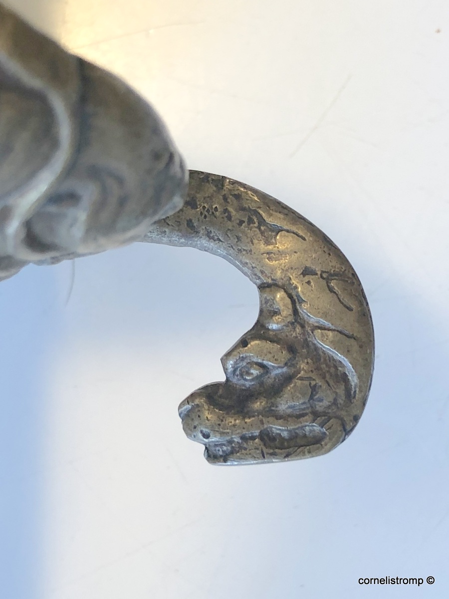

The size of the blade, choice of grip, and presence of a sea dog (some say dolphin?) on the upper guard supports the idea of maritime use. The figure looks like a saracen, not sure if there is any significance that he looks unbearded? Not sure Russia is included in the list of countries that use lions as a national symbol but perhaps the creatures are used here just to symbolize brave victory as Jim suggested? It looks like the motif appear on both plates? It really does tickle the imagination.
How can you tell that the sword has been taken apart very recently?

That is a very good point, Victrix, concerning the dolphin/sea monster finial. I also wanted to immediately blurt out 'sea service' sword, but we all know my biases when it comes to that! Of course, this heavy cutlass closely resembles other Dutch naval pieces of the era (and that of rival Great Britain, who had the brass naval monster head swords). If we take into consideration that possibility, could the hilt motif simply be allegorical?
The Barbary Corsairs, terror of the West African Coast, were heavily active during this time period. They attacked many European ships and forced some nations to pay them tribute just to sail through the Straits of Gibraltar unmolested. Obviously, the Dutch saw them as a scourge and perhaps some daring sea captain had this fine sword specially made (the two lions representing the Dutch lion, as their symbol from time immortal, attacking a Turk.) I'm wondering if any of the more famous Muslim pirates (the Barbarossa brothers, for instance), were beard-less?
