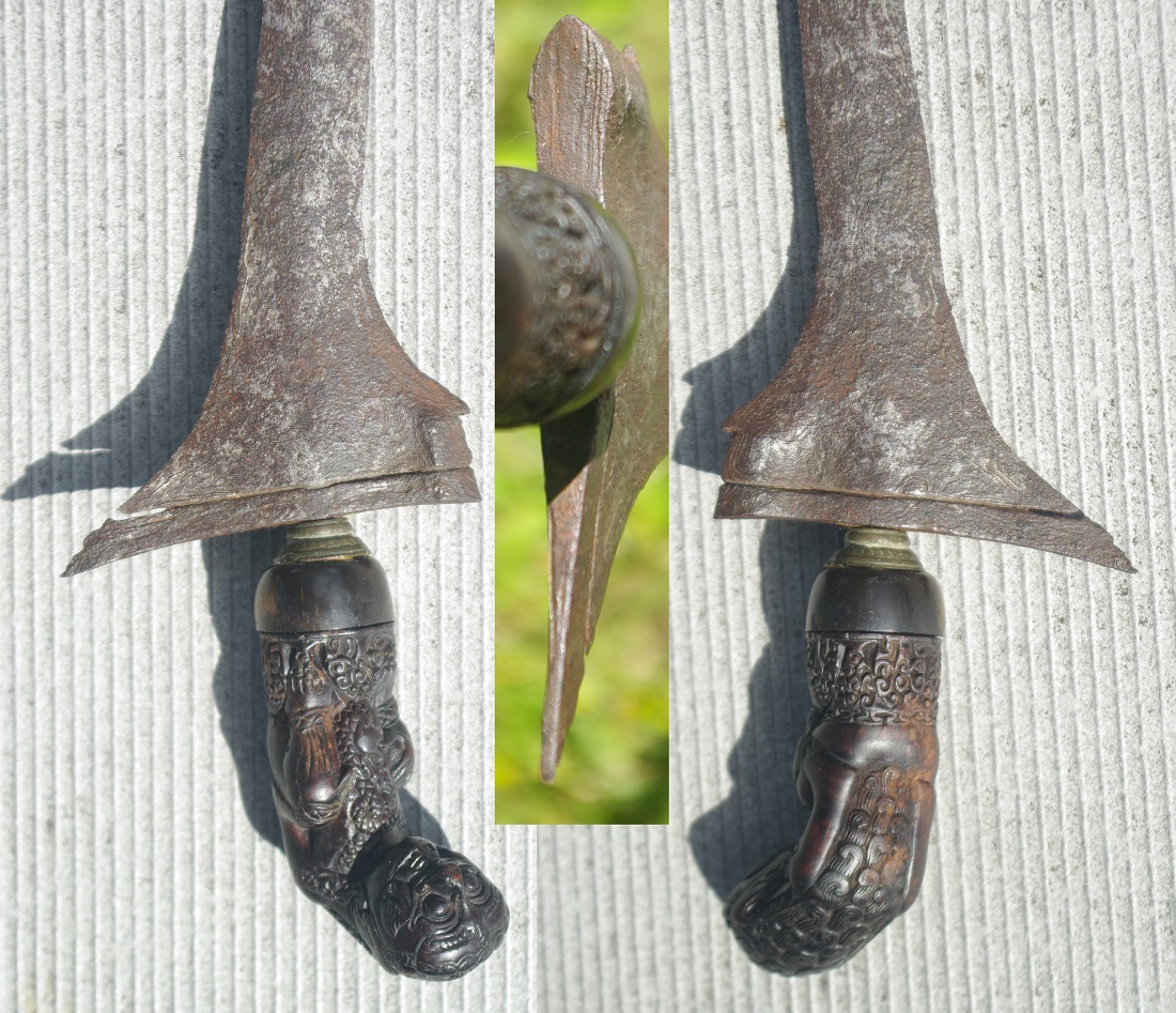

When I bought this old Keris there was only the blade and the handle with a remnant of Gandar with pendok from Madura. But when I look the blade and the handle I suppose that it comes rather from the region of Cirebon.

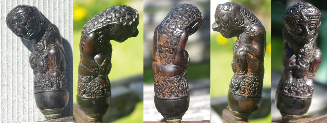

The handle is made of wood but it has the particularity of having the base covered with a ring made of buffalo horn.
The blade is very worn out and has just been quickly cleaned with WD40.
To dress up this Keris I added an old bronze medak I had in stock and for the warangka I just temporarily put an old gambar (too narrow for the blade to completely fit) and an old gandar from a different lot.

I would classify this blade as Segaluh, which is West Jawa, not North Coast, but is quite commonly found in North Coast dress ---- in fact Segaluh blades are very commonly found in dress from all over the region, it is a very old classification and was located near to a major trading port, so Segaluh blades spread to everywhere.
The hilt style can come from West Jawa, North Coast, through into East Jawa, so although not specifically Cirebon, it sits OK as Cirebon.
I believe this gambar will accommodate the blade with just a very minor degree of adjustment.
Use of a horn selut is a common repair.
The mendak is a nice mating for this ensemble.

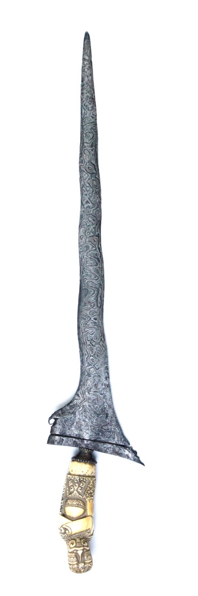

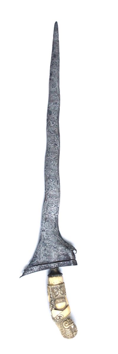

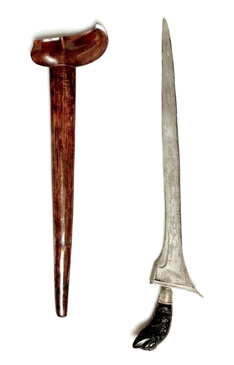

Pics of my similar blade in Segaluh style, also similar to Patje's blade in another recent thread. The nice ivory hilt is in alternative style from West Java/ North Coast/ East Java.

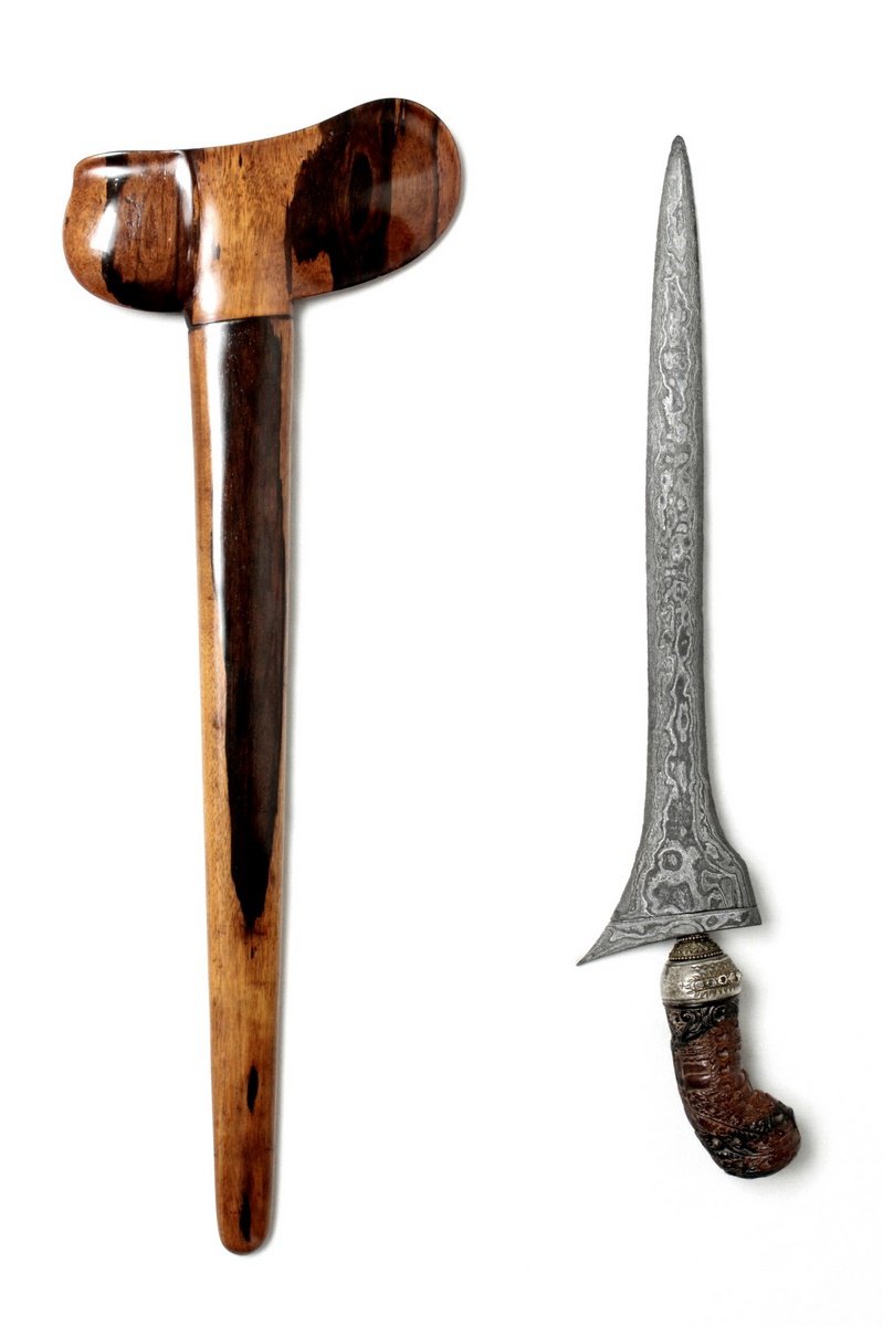

From my observations and references the scabbard from Séverin is typical of the gayaman style from East Java/ Madura (see another typical specimen shown on my first pic).
Again from my observations and references the old kris scabbards from West Java and the North Coast of Java (Cirebon and Tegal) are very rarely (if any) made from timoho pelet wood but rather from a local dark wood which could be kayu areng or sono keling? Also the gayaman style of scabbard is quite rare in these areas and the gandar has a specific shape (thick and wide at the mouth and with a peculiar shape of buntut) unlike the scabbards from East Java. You can see 2 typical specimens on my second and third pic, the first one is from Java North Coast and the second one probably from West Java.
Of course I could be wrong and apologize in advance.

Another typical gayaman scabbard from East Java/ Madura.

Jean, the top photo in your examples I would place as Madura, the second photo I would hesitate to be definite about, it actually looks as if it has been remade/reshaped by somebody who was not a tukang wrongko, I would probably give this second wrongko as generic Jawa. The third (dark wood) wrongko I would give as East Jawa/Madura. The bottom one puzzles me a little, I'd probably give it as Madura, but I would need to handle it to be sure.

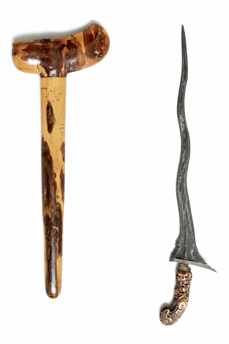

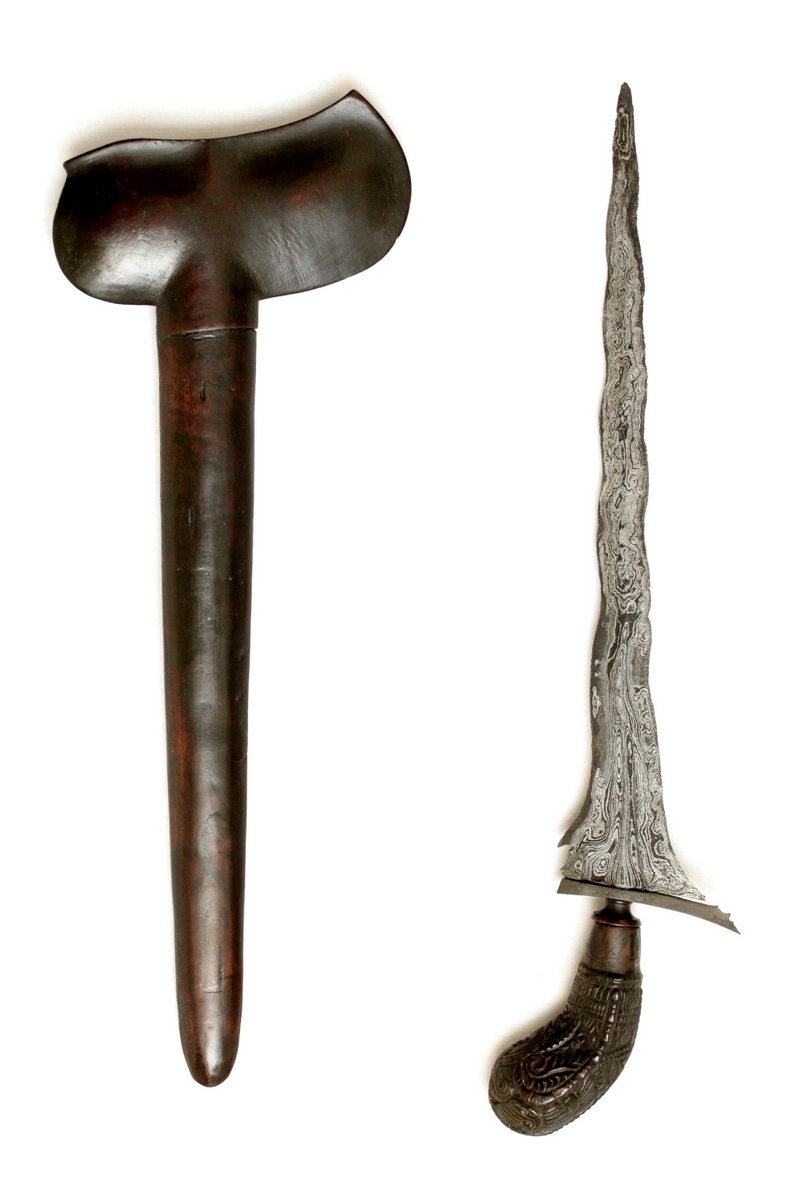

Alan,
The scabbard (iras) shown on my second picture is undoubtfully old and looks original but the gambar is undersized indeed and the gandar was probably covered by a pendok, which gives it its odd appearance.
Regarding the proposed West Java origin for the third specimen, I have relied on the opinion of the Swiss expert Gaspard de Marval, see page 41 of his reference book "Le Monde du Kriss", and he also shows a typical gayaman scabbard from East Java.

It has been my experience that when we post images on this site they don't always appear in the same order on everyone's computer screen. For instance, when i look at Jean's post that Alan is discussing in the above quote, the timoho pelet wrongko is the third and last image to appear and the "dark wood" wrongko that Jean describes as West Jawa appears first. Fortunately Alan does refer to what he sees as the third image as the "dark wood" wrongko. Otherwise i would have been mislead by his assessment. I wanted to point this out so that everyone is aware of this issue when they post numerous keris in a single post.
You are fully correct David, it seems as if the pics order has been changed but from memory it was correct when I posted them?
My supposed first pic shows the scabbard made from timoho pelet (last one on my screen now), the second one is the large scabbard made from medium dark wood, and the third one (on top on my screen now) is the dark scabbard with a thick gambar. Sorry for the inconvenience!
