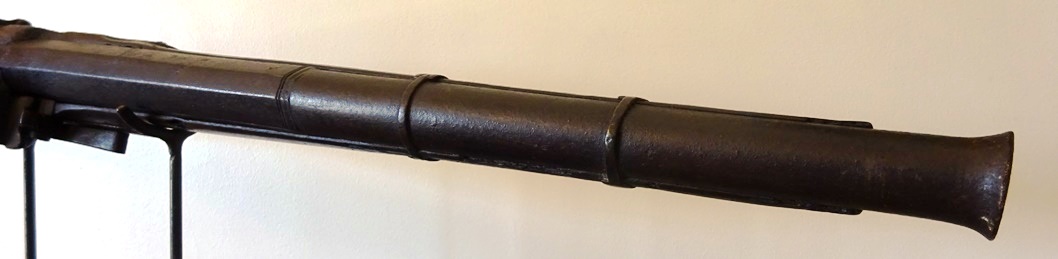

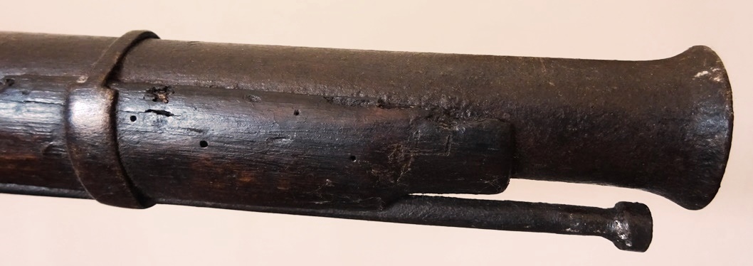

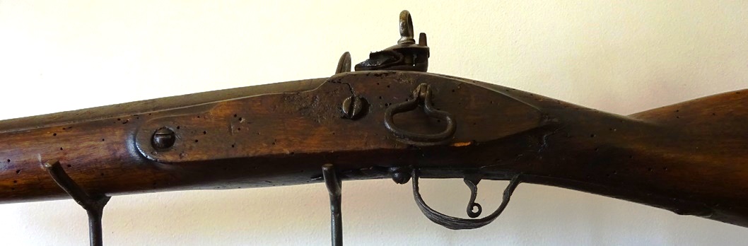

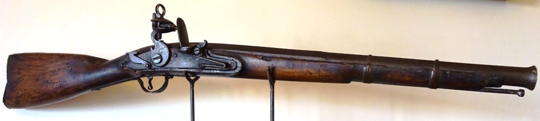

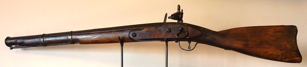

So according to what is registered, the dog lock system preceded the real flint lock and saw action to around 1700. Hence this example is a relic. With a 48 cms. barrel shortened from that of a musket and having its muzzle 'abacarmatado' ('blunderbussized'), it has signs of being Portuguese, as per its triggerguard in a scallop shape, for one.
The suggestive suspension ring visibly dates from the time this gun was transformed into a 'handy' blunderbuss.
Caliber circa 16 m/m. Total length 83 cms. Weight 2728 grs.
Anyone here has with this kind of pieces ... or may give an opinion about this one ?

Good morning Fernando,
This is a very interesting looking piece.
I know next to nothing of Portuguese arms, but can say that by the style of the stock, and the tang screw entering the tang from below, plus the dog -lock, that I would say this piece is from the1690's at any rate.
Earlier locks often were attached with three sidenails rather than the two we see here, but the lock is very archaic looking and I don't think newer than I suggest.
The buttstock shape also says from the 1690's rather than early 18th century.
I recall something about muskets being reduced in length in this manner, but not well enough to say anything further!
Again, an interesting arm!
Richard.

Thank you Richard: observations well noted.
Musket barrels being reduced in length used to be a rather common exercise. In Portugal, for one, during troubled periods (Peninsular and thereabouts) people mainly in rural places had local smiths to assemble parts of muskets left back by either side armies and build hand made blunderbusses. For statistically reasons, most setups were made with British parts, namely locks and shortened barrels. The basic reason for the barrel shortening was, more than the need to used them in confined places, like from inside carriages, the practice to go out at night and hide them under one's coat, for eventual defence against assailants. Other cases like this one posted, i guess, would be to shorten the barrel from an integral musket, for the same purpose.

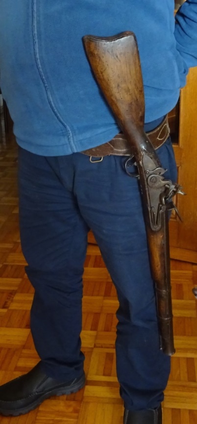

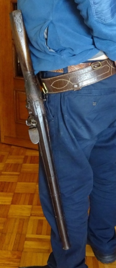

I note Fernando, that it has a sling loop, so a sling could pass around the body and over the opposite shoulder, in the same manner that a Royal Mail B-buss would be carried. Very useful on a coach or mounted on horseback.
If only it could talk!
Richard.

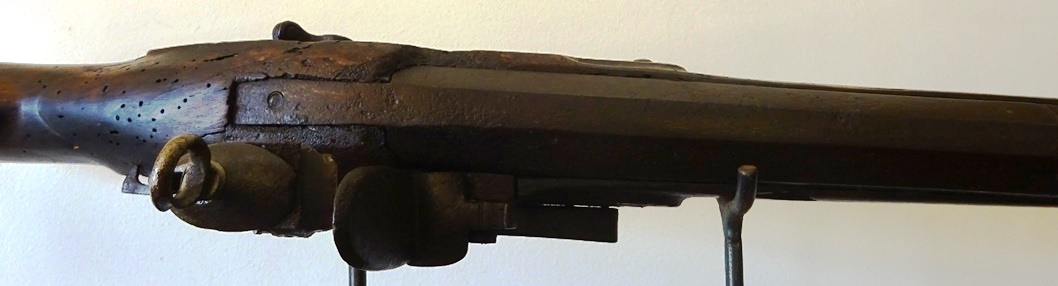

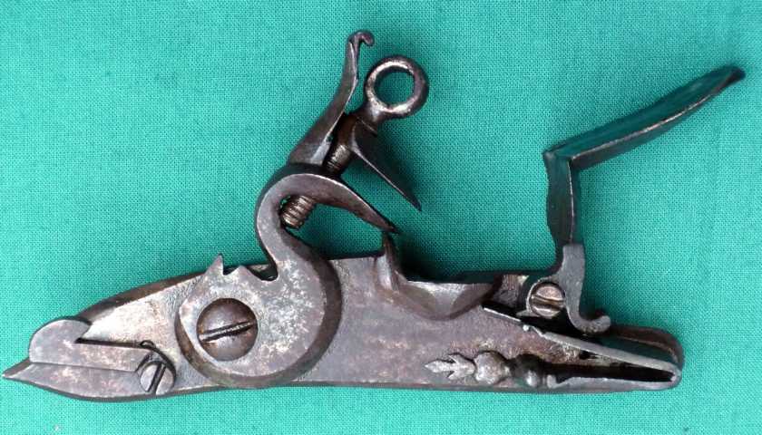

Only to add that the screw that closes the jaws ends in a ring, common in Mediterranean locks

I suspect the screw is a replacement. A very minor consideration on a gun of this age!

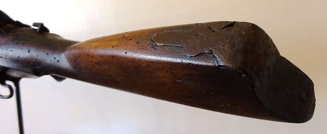

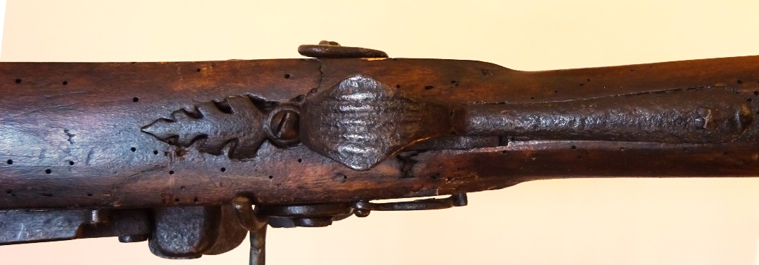

Awesome early blunderbuss, Fernando! It kind of reminded me of a wall gun (as in those mammoth swivel types protecting forts). I know it's not, based on the length, but I'm with Richard that it could easily have been a coach gun.
About the stock- I'm assuming its 'wormy ash', based on the worm holes? Or do other woods get those pesky moth larvae as well. If it is ash, is this a common wood for a gun stock? Not my area, so just thinking aloud and hoping for education on this! Wormy ash was the #1 choice for pike hafts-

RE ash,
No clue on Portugal, but ash was used at this time in England and Northern Europe, even for matchlock tillers/stocks. It wasn't the only wood used, as walnut, fruitwood and elm were used and walnut being the most popular. Maple /sycamore used as well.
The ring type vise pin in the cock is more Spanish ,Portuguese/Mediterranean, but very practical and sometimes seen even in Scotland. Could well be a replacement sometime in its very long life.
Has the barrel any proofs?

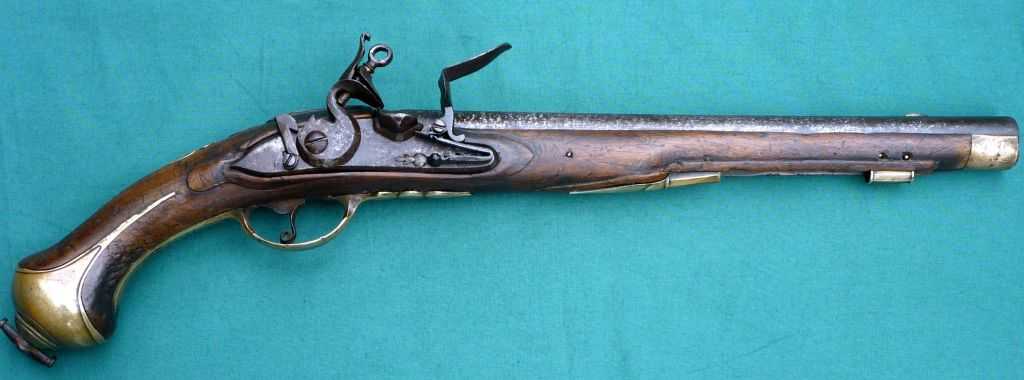

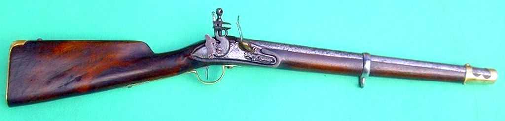

good evening ,aside the yaw-screw i possess a very similar rifle in its original configuration ,the allmost identical barrel has 2 british proofmarks on the left side of the barrel. the gun is 84 cm long . there is a good chance this very early doglock-carbine is from england. (my guess) iskender Switzerland

gentlemen ; Sorry for calling my carbine a rifle as it has no rifling and that is a inacurat therm for it. .It is Just the fakt that in switzerland most of the men call every "rifle" that looks like a broomstick a " Flinte" even when it is a full auto assault rifle ! gretings iskender
If only it could talk!...
I don’t think the hanging loop was a for a formal shoulder ‘bandolier’; maybe for a belt hanging hook, so that you had your hands free. It could even be to hang the gun on the wall, when at rest. As you say, if it could speak …

... About the stock- I'm assuming its 'wormy ash', based on the worm holes? Or do other woods get those pesky moth larvae as well. ...
Well captain, the collector fellow who sold me this piece is a timber man. He reminds that walnut is a rather wormy wood; of which potentially this stock was made of.

I know it works fine the way you mention, Richard; i was only realizing that it can also hang from different spots. In my eyes i don't see this particular gun in so formal service, but more like a private weapon. But it is only my imagination ... at least so far.

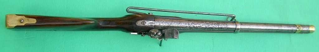

Yes, as you suggest, it could be hung from anything with this butterfly swivel, and I also believe you are right regarding it being a private weapon.
Still, such a swivel was very useful, see below;

Quite nice, thanks. Mine hangs vertically ...

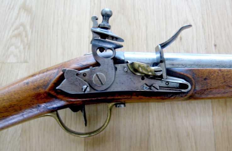

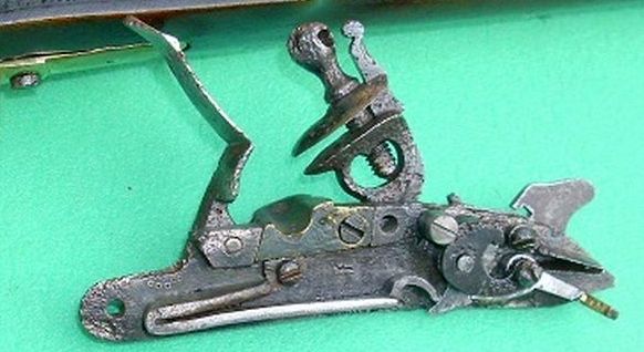

The dog-lock on your gun is considerable interest. This type is most associated with England, mid-to-latter 17th cent. There is an example whose cock jaw screw has a ring terminus, as on a miquelet, on a musket ca. 1650 in the Tower of London collection (now Royal Armouries Mus.), inv. no. XII-48. The lock on that gun, however, is of more archaic form than yours since it has a 3-bolt attachment to the stock, not the 2 as on yours. The shape of its plate is also patterned after that of the earlier snaphaunce, whereas your blunderbuss' lockplate is the more usual "French" type that became standard as the 17th cent. drew to a close.
The use of the dog-lock also spread to northern Germany. The Livrustkammaren in Stockholm has two pieces relevant to your lock, albeit in very decorative, luxus-sporting guise -- a detached lock signed Paul Rolof, Stettin (now a part of Poland), ca. 1680, and a complete rifle by Berndt Orther, also of Stettin but a decade later. The shape of the cock and lockplate on both are very similar to the mechanism on your gun, but the jaw screw terminates in a slotted bulb, not ring. These German locks also feature a 2-bolt attachment to the stock.
So these examples help corroborate the attribution of last quarter of 17th cent. to the lock on your gun. It could be an outlier of slightly later date from a very conservative area, but considering that the true flintlock with internal half-cock safety had started to become more and more popular after the mid-17th cent., I rather doubt that dog-lock manufacture persisted much after ca. 1700.
The examples referenced above can be seen in H. L. Blackmore, GUNS AND RIFLES OF THE WORLD (1965). Also, it is worth noting from Torsten Lenk's writing (THE FLINTLOCK, Swedish edition 1939, English 2007) that the dog lock was NOT the predecessor to the "true" flintlock -- it existed contemporaneously to it, and appeared AFTER the latter came into existence.

1. Norman could not be correct on this. The north European dog-lock, of which you have an example, is not developmentally connected to any of the dog-locks of the Mediterranean or Oriental worlds (the agujeta, the Sinhalese snap lock, etc) for the simple reason that the former has an internal mainspring, and all of the latter have external springs.
2. Furthermore, the sear (the assembly that releases the cock upon pull of trigger) is entirely internal on the northern dog-lock. It is a one-piece L shaped arm under spring tension, with studs that engage a tumbler or nut on the cock's axis bolt. The sear system on the agujeta (either the Hispanic or Algerian types) is a 2-piece assemblage with a stud or nose that engages the cock directly through an aperture in the lockplate; on this type of lock there is no tumbler. See Blackmore, pp 112-15 for text and diagrams.
3. I'm not sure whether the Sinhalese snaplock is a direct descendant of the agujeta. A comparison of the sear systems is in order, and I can't find this aspect illustrated in any of my reference books. Lavin's article "Spanish Agujeta-lock Firearms" in ART, ARMS AND ARMOUR (ed. Robert Held, 1979) emphasizes that the Iberian version typically has a wheellock-derived lockplate profile -- trapezoidal with an obtuse point at the bottom, AND is equipped with two bridles or support bridges for the cock and frizzen pivot screws. The Sinhalese lock has a different plate and lacks a frizzen bridle. Daehnhardt, in ESPINGARDA FEITICEIRA, contends that the Sinhalese lock originates with the Italian miquelet "alla romana" which may well be the case. Again, a comparison of the sear design will help resolve this.
Note that the trapzoidal lockplate is absent on the Algerian version of the agujeta although functionally it remains the same, and even inherits the big alligator jaws and the wing-top screw on the cock of the later Spanish versions. From this we can expect some stylistic changes when the Sinhalese developed their snaplock, whether it be from prototypes originating in Spain, Italy, or even Portugal.
Sorry if this sounds so convoluted and geeky, if you need any clarification please let me know.

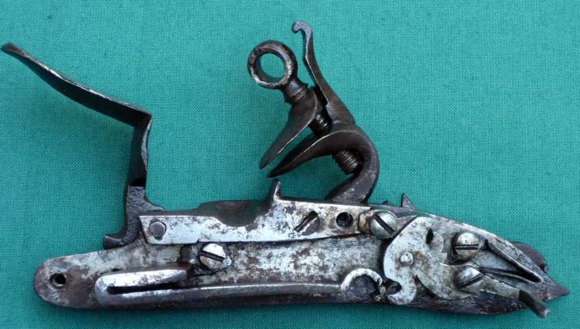

Corrado, it would be interesting to know if besides the safety hook (dog-lock), the nut has also tooth half-cock. You could upload photographs inside the lock? Thank you
affectionately. Fernando K
As all of the shown firearms are sold meanwhile I only can post fotos existing in my archive. But what I can say is that all these dog locks have a half-cock tooth at the tumbler.
corrado26

Thank you, Corrado. The photographs do not let you see the tooth in half-cock nut, but I trust in your word. Then the dog-lock would be an additional safety means.
Affectionately. Fernando K

Now I think of a question. The safety hook (lock.dog) not being commanded by a spring and automatically removed (as in agugetalock or lock Ceylan) can not be engaged and prevent the shot to reach full-cock?

Yes Fernando, i have read that this would be a handicap of this system (some article in castillian, don't remember where).
The author said the catch could be a problem in either being too tight and difficultate the full cocking or being too lose and... i don't recall the precise words.

Default how user-friendly are they?
Seems to me that the catch would be rather inconvenient to operate if it isn't under spring tension as with the agujeta and its variants. Am trying to visualize this, it looks like a two hand operation that should be performed with both hands on the same side of the gun. Fernando, have you learned an easy way to engage and disengage your dog catch?
