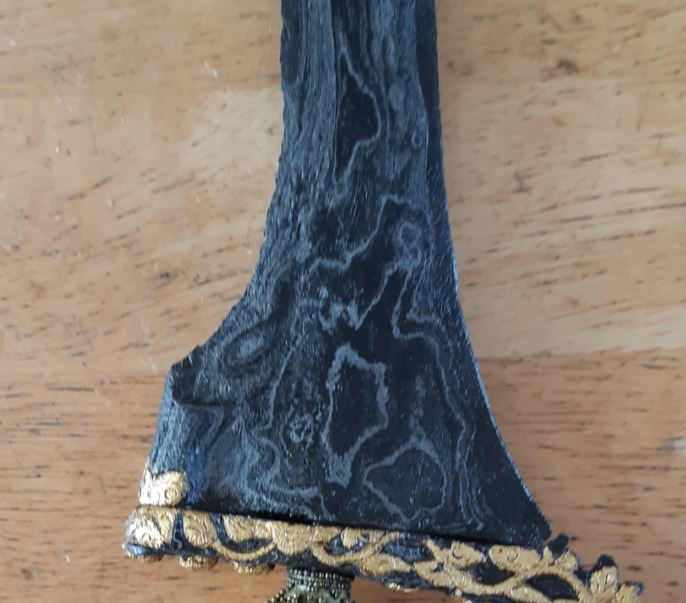

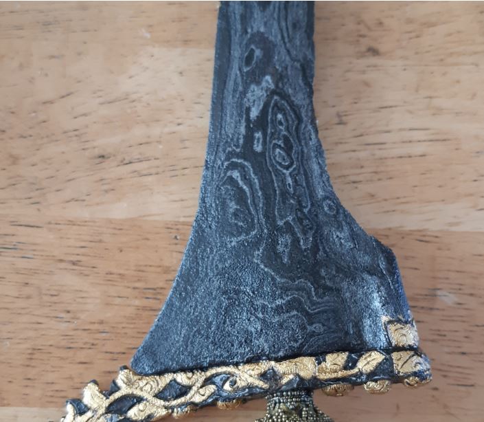

Hi All,
Identification of the pamor on this Javanese Solo Keris Java
I found this one today. The keris itself seems old.
Any ideas on the pamor type?

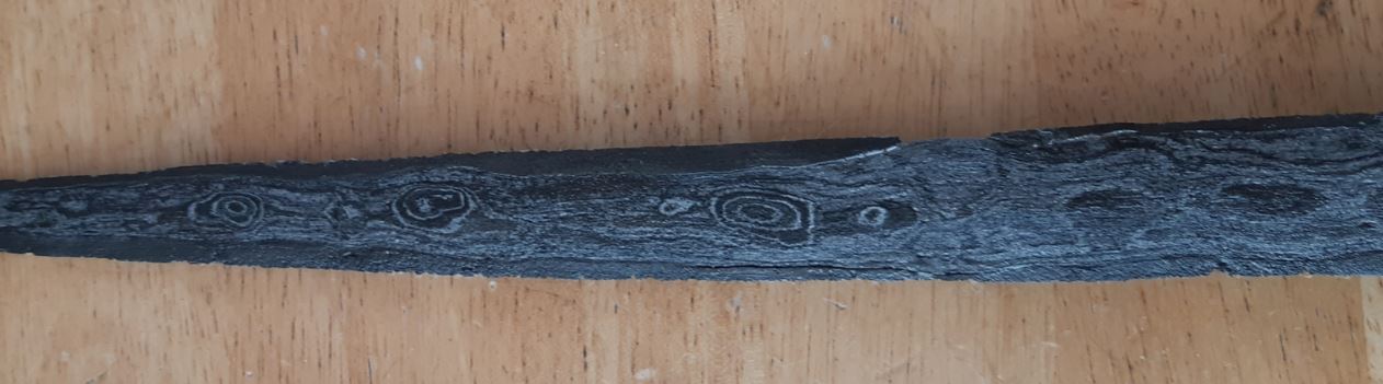

Wos wutah (beras wutah > scattered rice).
It is a random pamor motif, not a planned pamor motif.
There might have been some intended surface manipulation at time of manufacture, and at the present time a whole swath of names for variations of wos wutah has arisen, however at base, this is a simple random pattern pamor.

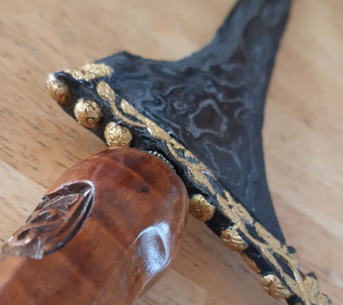

Agree, I would call it also wos wutah. I think that the gonjo is a very recent replacement and the kinatah as well.

Yes Detlef, agreed.

Yes Detlef, agreed.
Hi all, thanks for al the information. I also had that idea. Because the keris itself is very fragile on the point of the wilah.
regards Patrick
