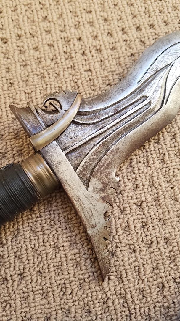

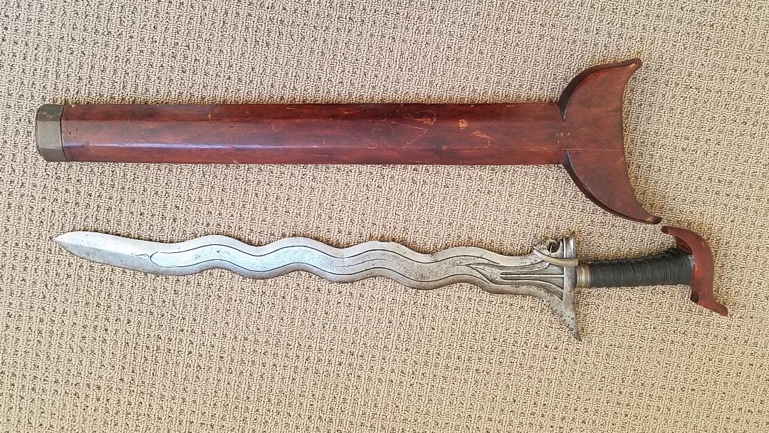

Not my area of collecting but picked this up as part of a random auction lot with some other non related items.

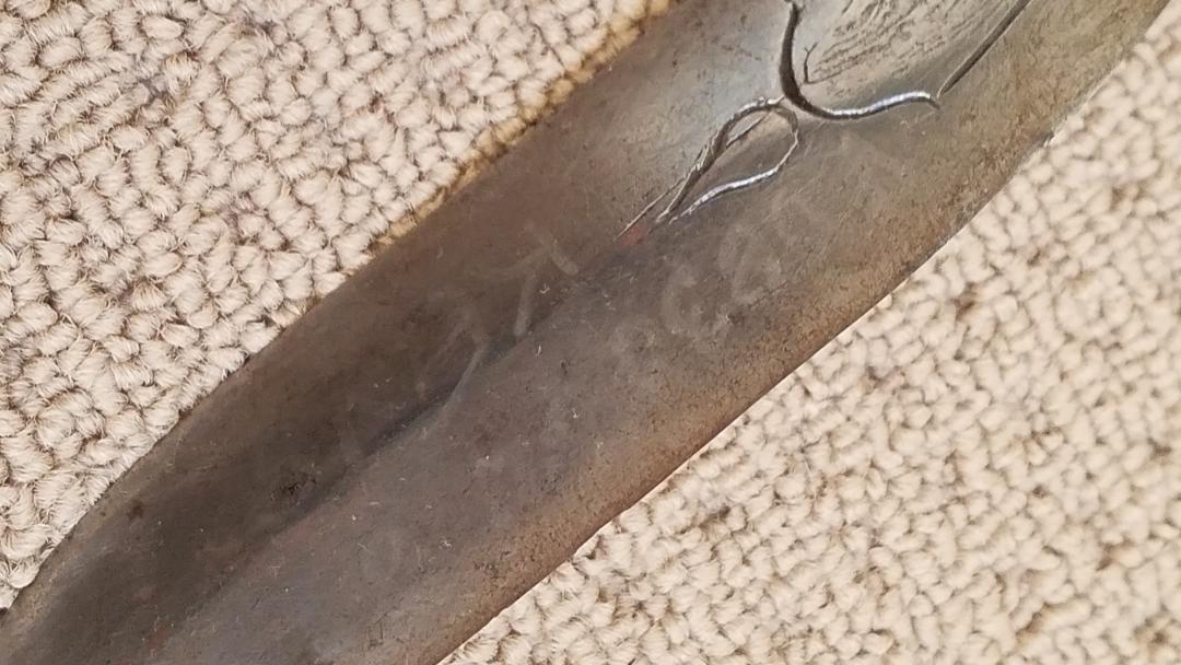

From my limited understanding this is a Moro Kris from Mindanao. This one interestingly has etched on the blade and written very lightly on the sheath the name KEYS (surname) with what I think is a service number V 08306218. I think this world be WW2 but can't trace this number. 8 digits would be British but the V is often a prefix on Australian service number. Enlistment being in the state of Victoria.

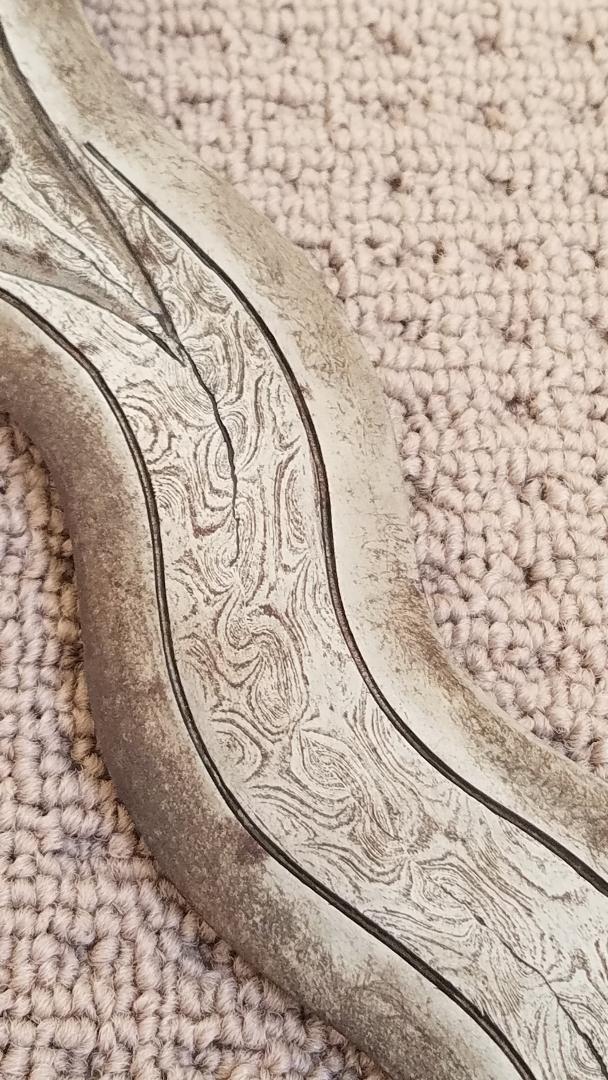

Back to the Kris.I think it would be from the 1940s? Really don't know. The blade has twist core. The blade is 48.5cm. Total 63cm. The scabbard is varnished and unfortunately cracked - recent damage. kris has some rust but no damage.
I have since been told it is a nice old Moro Sundang Kris 19th C.
Thanks for comments in advance.

Actually this needs to go to the Ethno Forum and not the Keris Forum. Moderators please move this.
Now to your questions:
1. I would place this kris into the very early 1800s.
2. Maguindanao would be my guess on tribal origins.
3. The scabbard is unusual and not a common Maguindanao form.
A very nice piece especially with that great twist core!

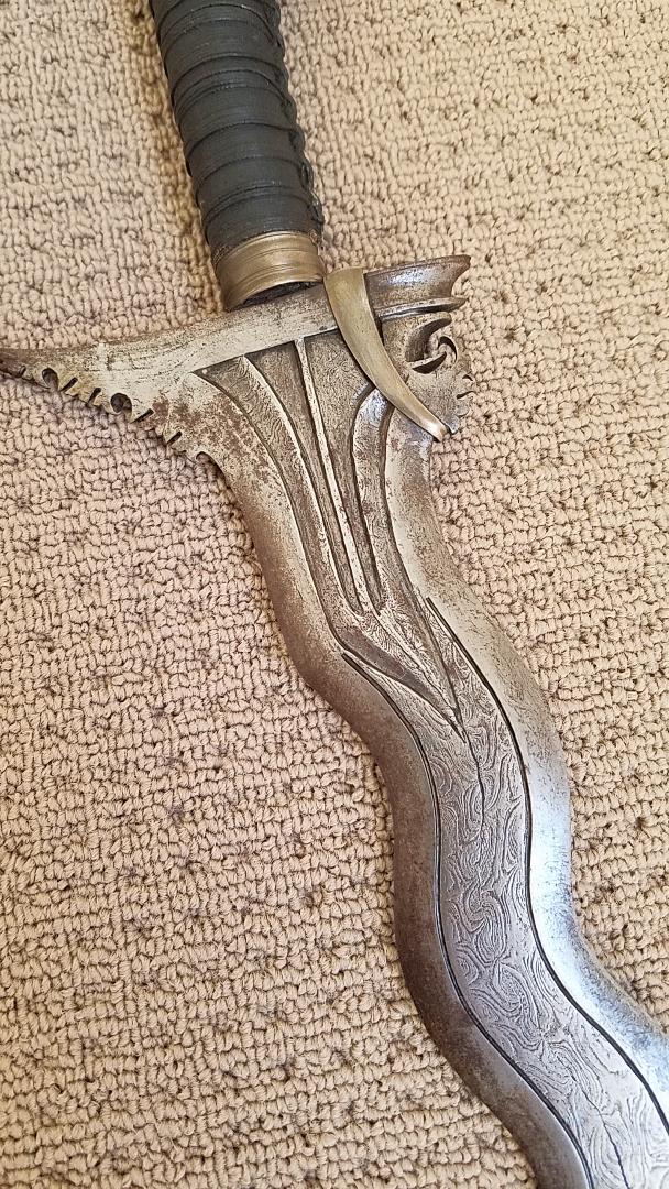

I agree with Jose that this blade is a really good catch!
Based on the flow of lines and surface condition, I'd be inclined to place the blade at mid-19th century to Span-Am war period rather than any earlier.
There is a good chance that the narrow engraved lines once had silver inlay; however, the motif close to the tip was a bit crudely cut. Maybe there is no undercut for better retention of any inlay?
The scabbard seems to be a later replacement which might be consistent with a WWII scenario. I'd try to remove the varnish after carefully glueing the recent crack (traditional wood glue, possibly with a de-oiling step for tropical woods; I reckon the wood is not really heavy hardwood though?).

Thanks for the response. This is good news on the blade and I suspect the rest is a later refit of the old blade. The twist core certainly gets people interested. The scabbard does not seem to be 19th C to me. But would make sense if made in the 1940s. The damage to the scabbard is recent -unfortunate as a result from someone hammering u-tacks (I removed them) into it to hang it I suppose - the cracking of the wood is fresh and the wood is not more than 80 years old. Also prior to the recent damage mentioned the scabbard seems to have had little damage if none. And is covered in a reddish varnish.

Thanks for the response. Yes I agree - not my area but I have handled enough old weapons to know when the blade and scabbard are the same date. And the scabbard would fit the 1940s date. The wooden pommel is of the same period to the scabbard and are covered in the same varnish. The workmanship of the blade is not lost on me and I have spent some time looking at the detail. I see no evidence of there being any silver in the lines. I can't see undercut as I have seen on some inlaid other blades.
I have done my best to use wood glue and have glued up the cracks - solid now and the kris can go in and out without the scabbard flexing.

Yes, everything said about it is true as to age, sheath(not original) and the inlays were definitely silver.

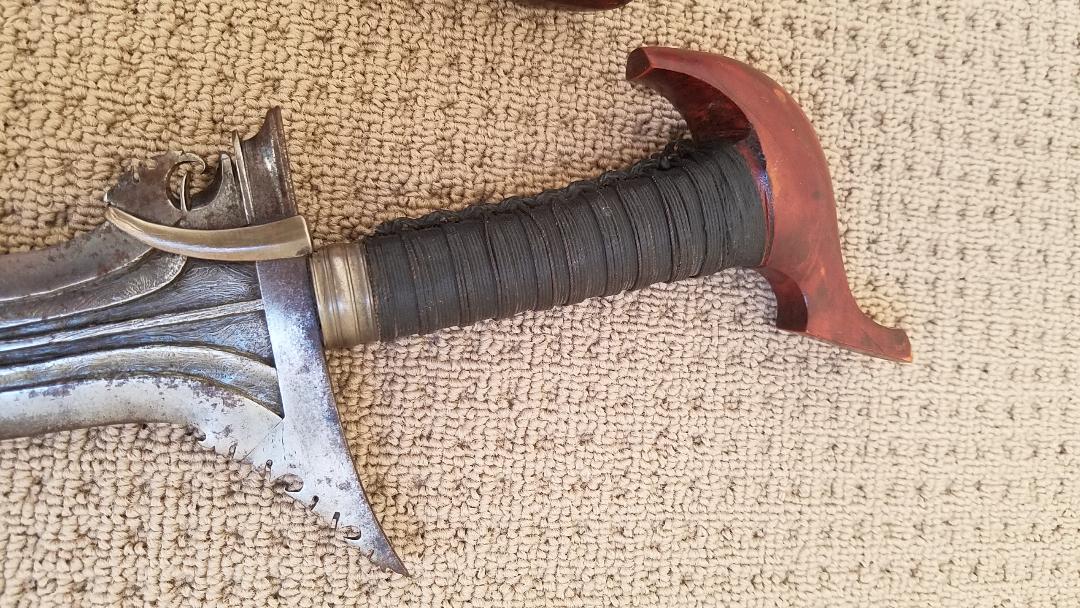

I'm with Kai. More likely mid-19th century than earlier. I would say that definitely the kakatau pommel and possible the entire hilt is a later replacement though.

Thanks for the comments. So mid 19th C with a later 20th C replacement scabbard and hilt. The pommel and scabbard seem a fit so probably all done at same time and as the theory goes picked up around the WW2 period.

Yes!...a lovely blade, indeed! Like Battara said the scabbard is unusual for about any Moro area, and I have to wonder if it is later to the sword, which would not be unusual at all.
