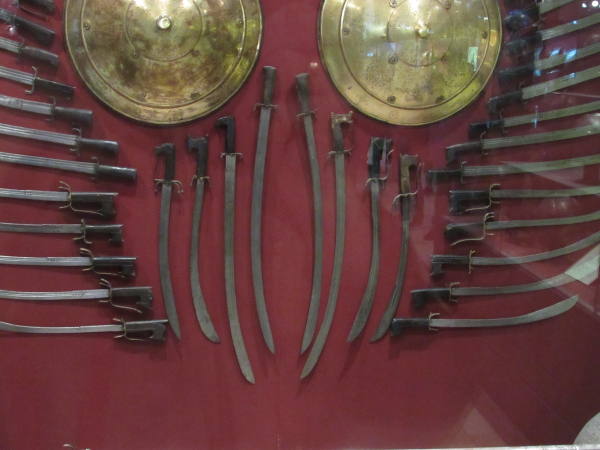

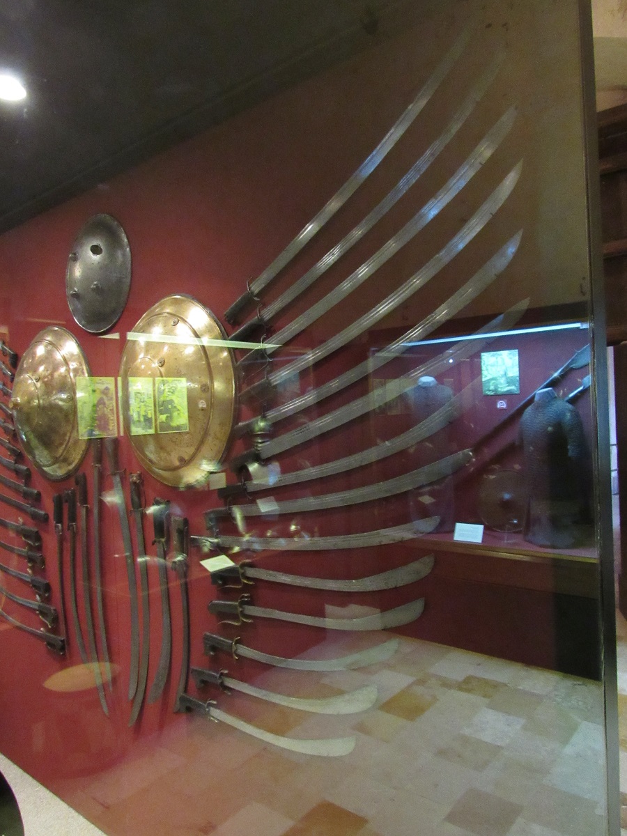

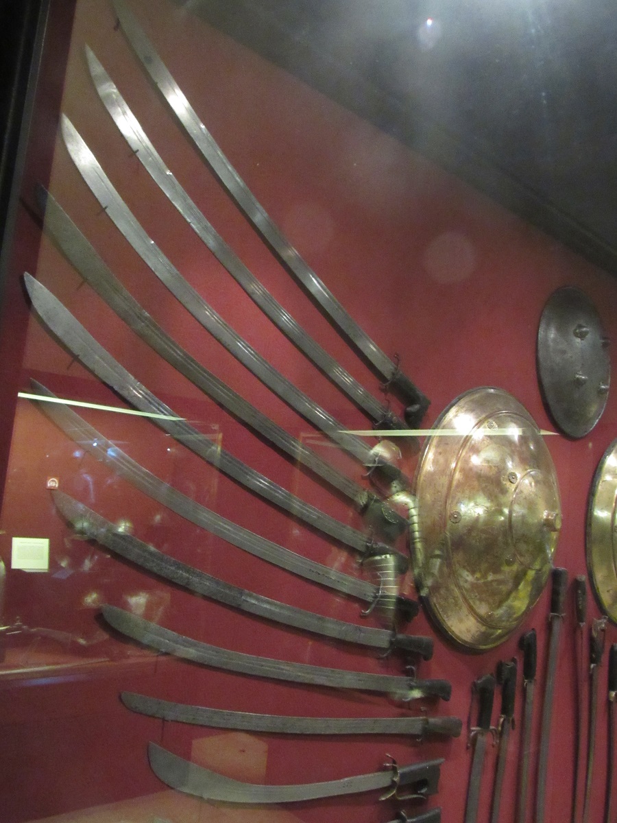

I recently visited the Grand Master Palace in Valletta and its armory is quite remarkable, but for me the most interesting part of the exhibits is the extensive collection of early nimchas. This thread is entirely about these nimchas and other Ottoman swords, and my intent is to share my pictures here. By nimcha here I would mean any sword with the characteristic hilt, including full size blades. There is in general surprisingly little known about the nimchas, and their origin, both when it comes to the blade and the hilt. The theory proposed by Anthony North is that they originated from the Italian storta, and a particular nimcha-like storta in the Met is presented as the sole evidence. But is it a case of a weapon, which influenced Islamic sword makers, or rather a case of a sword made to appeal to North African/Ottoman tastes? Given that there are not many similar examples around, I am leaning towards the second personally.

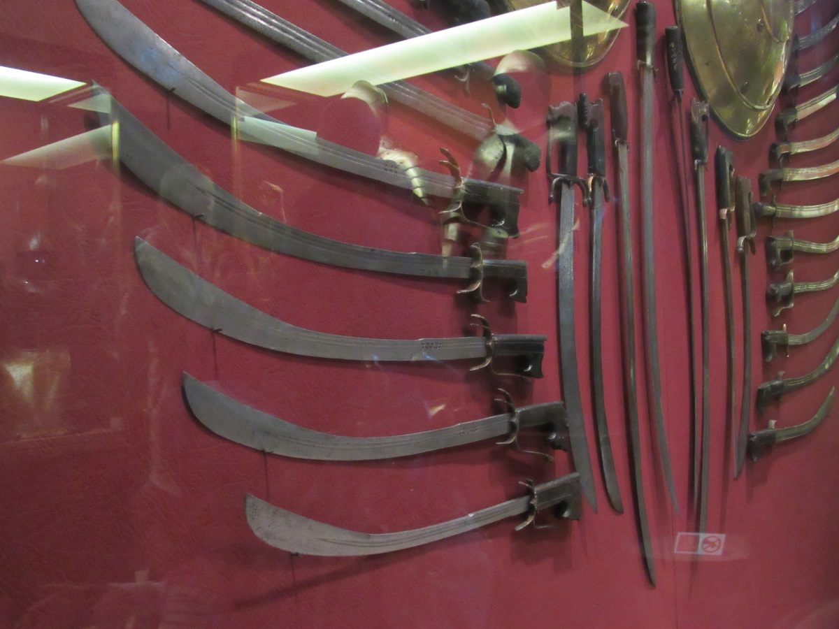

Anyway, let's start with some pictures. The exhibit is quite impressive, with a symmetric arrangement of nimchas of various length flanking a few Ottoman parade shields. Note how many guards are missing the knuckle bow - was it removed on purpose? During those times bucklers would have been used, so having a knuckle bow to take hits perhaps was not as important. I will leave it to HEMA enthusiasts to answer that one.

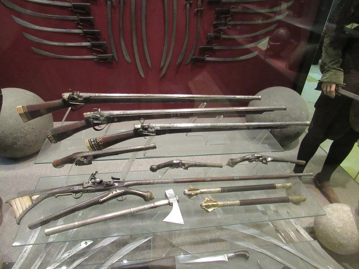

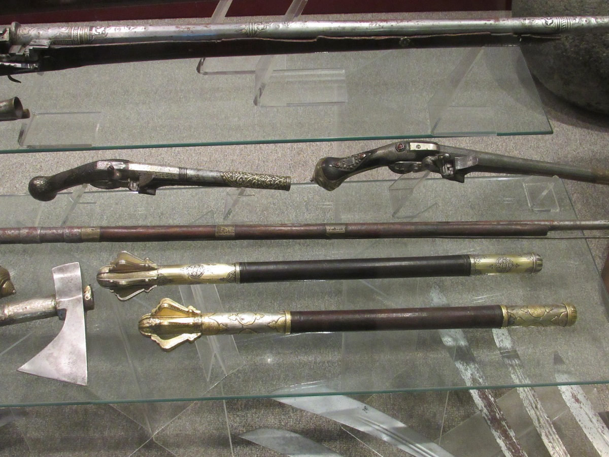

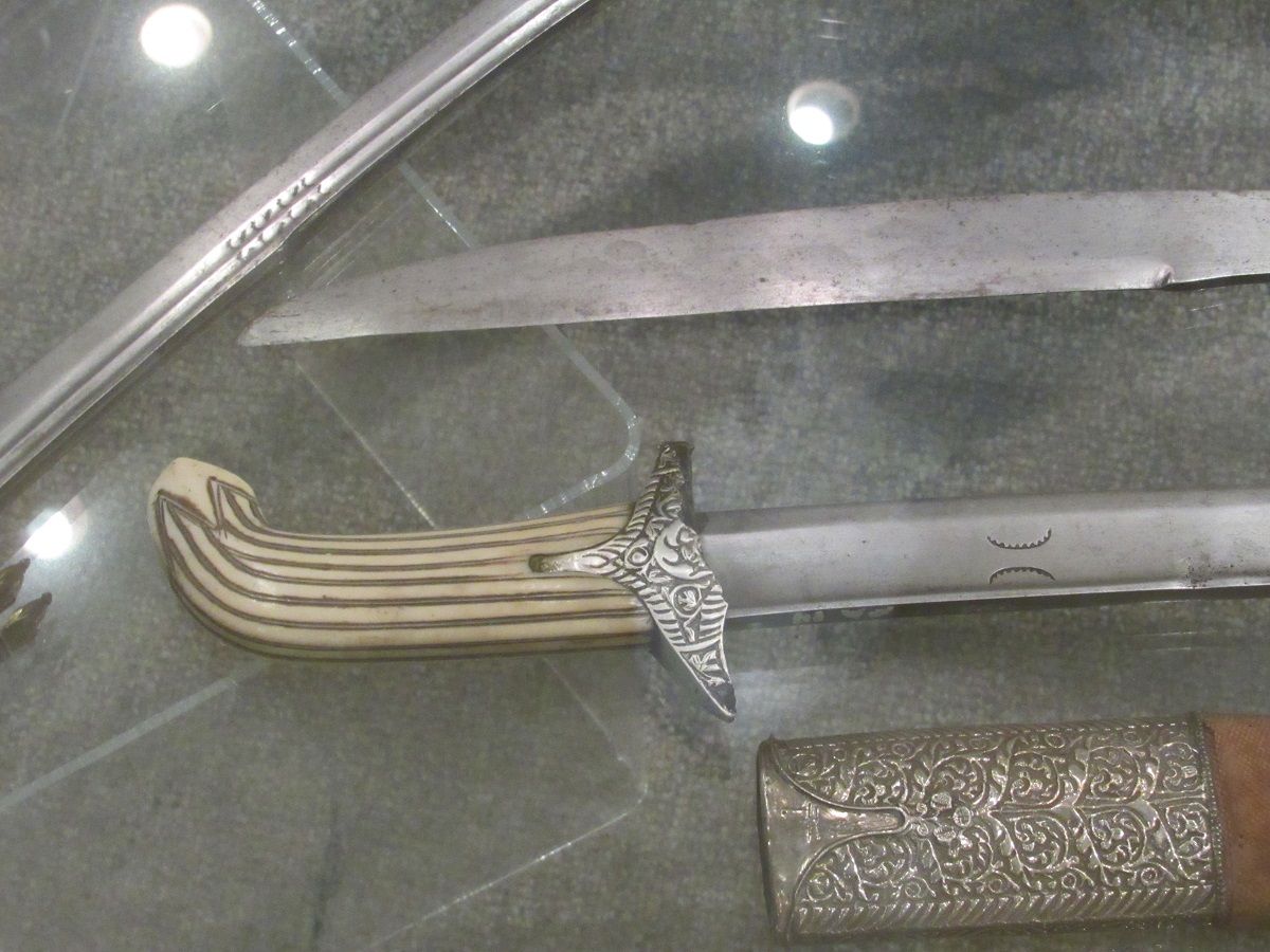

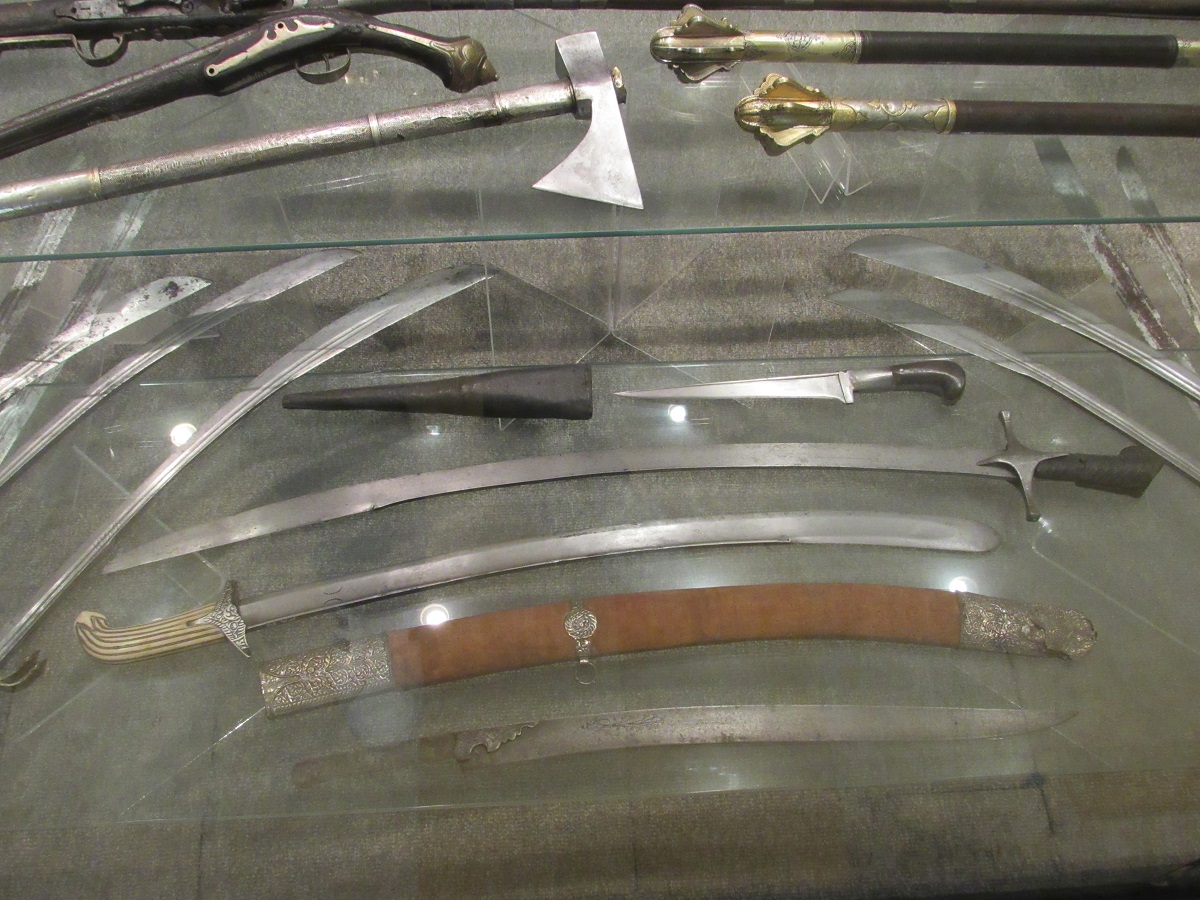

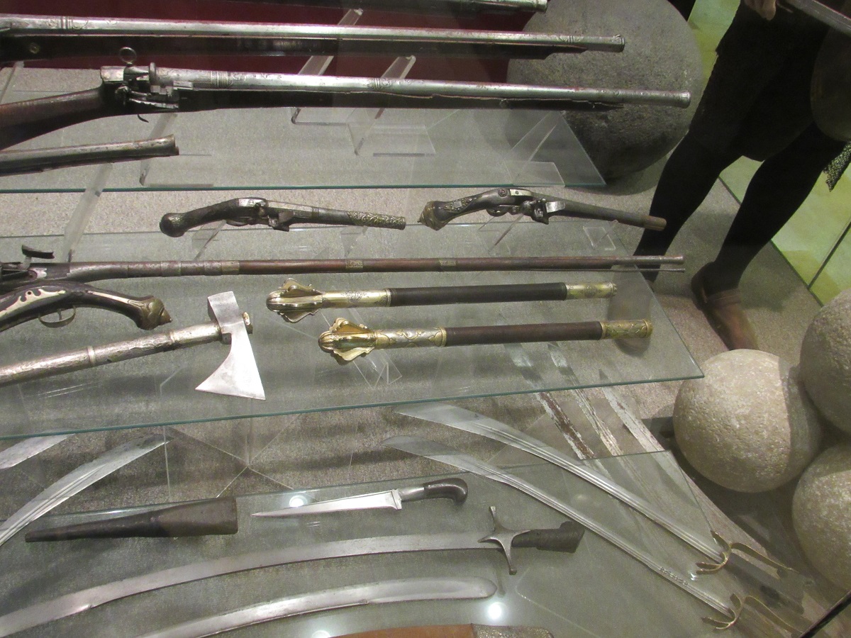

Continuing with the pictures: there is a display of various arms, including an axe, some maces and firearms in the middle. More importantly, as far as this thread is concerned, there are also two interesting Ottoman swords. One is a karabella, of a type that is generally associated with the 18th century. The horn hilt has sadly cracked and needs to be restored, and the blade appears to be of an earlier type - 16th century perhaps. The other sword is even more intriguing - it is shorter, with a very unusual eyelashes (Gurda) marked blade. Both the blade and the fluted ivory hilt seem to mimic early Ottoman swords, but it looks more like something made in a European shop for export to Istanbul or to one of the major ports in the Maghreb.

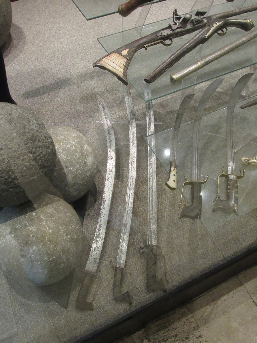

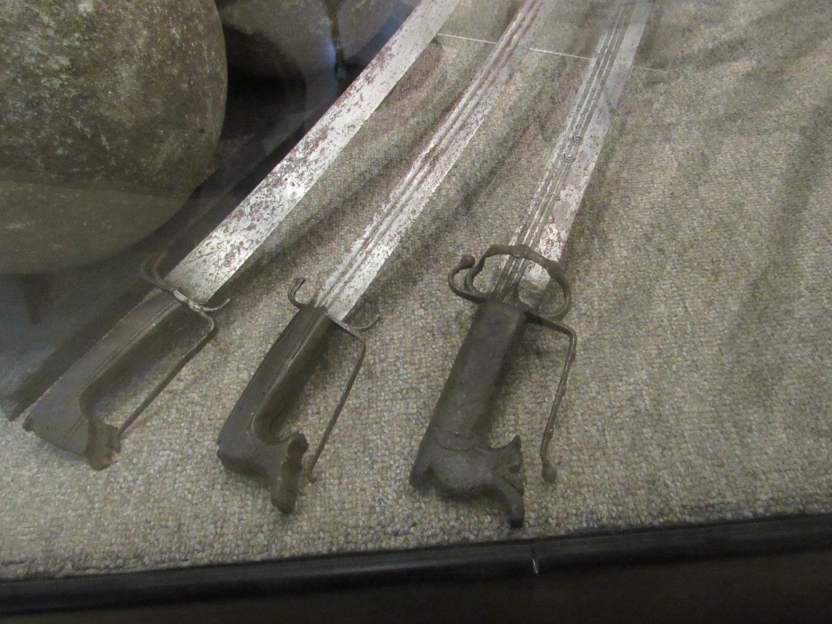

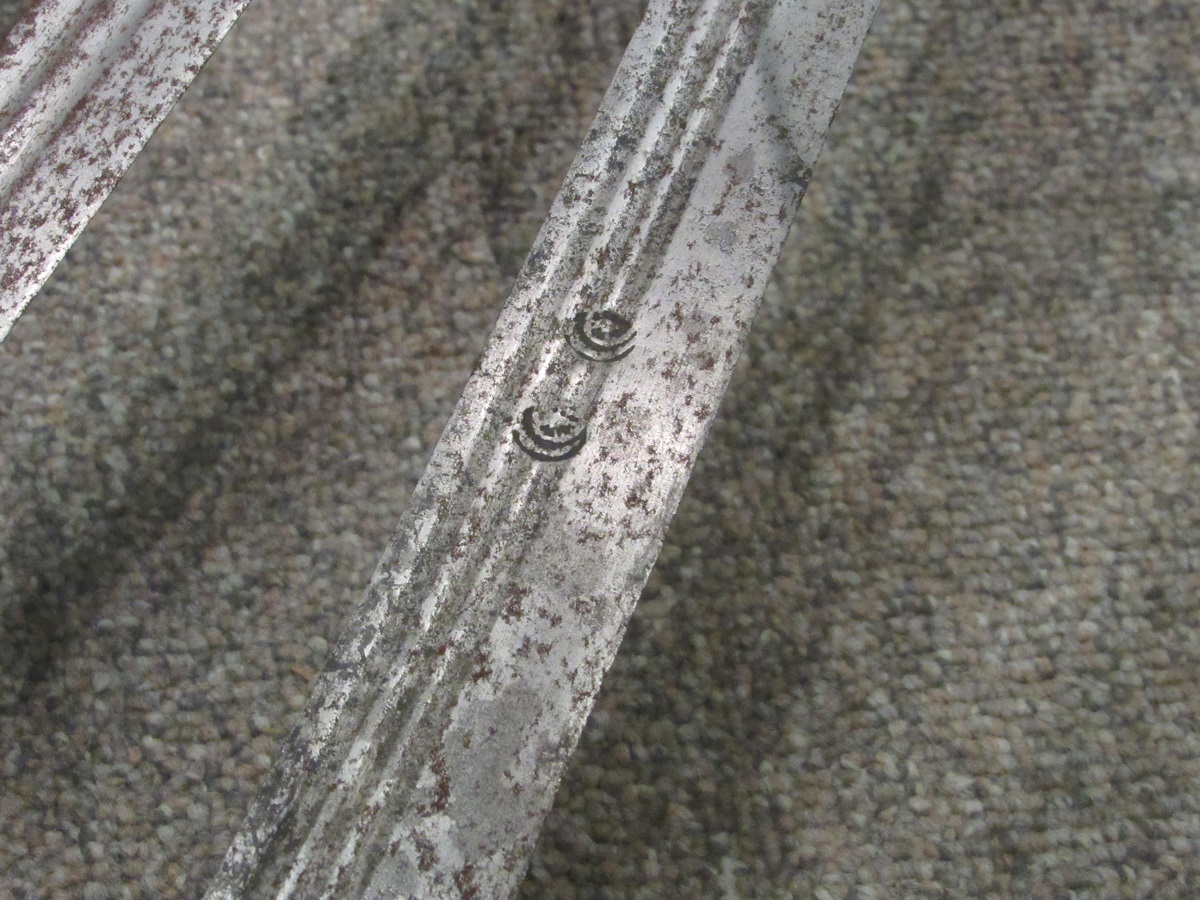

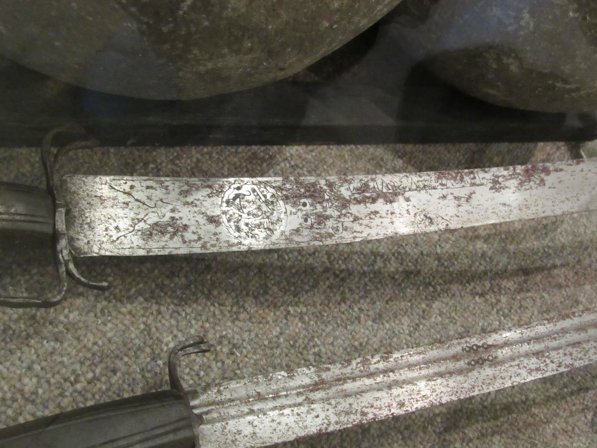

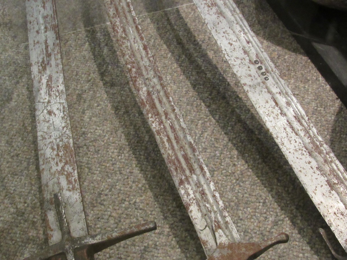

To the lower right of the center display there are more swords, with longer blades. Sadly, they are in a bit of a neglected state, with gunk and light rust forming on them. Two of them have really crude hilts with ugly washers under the rivets which to me appear to be modern replacements by someone with very little idea of what he was doing. The blades though are interesting, especially the one with astral (Peter Munich and imitators) motives, the only one such blade in the entire collection.

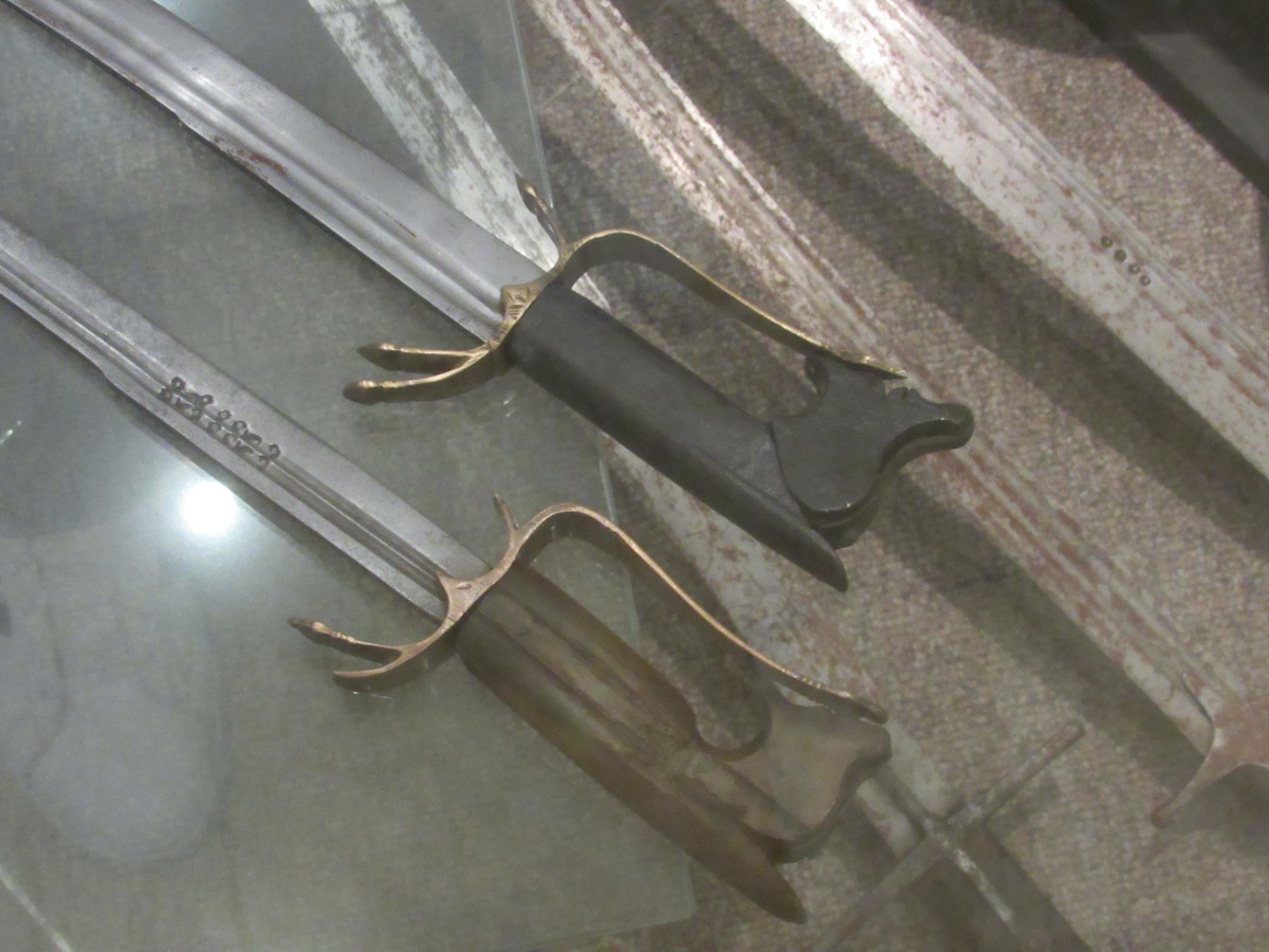

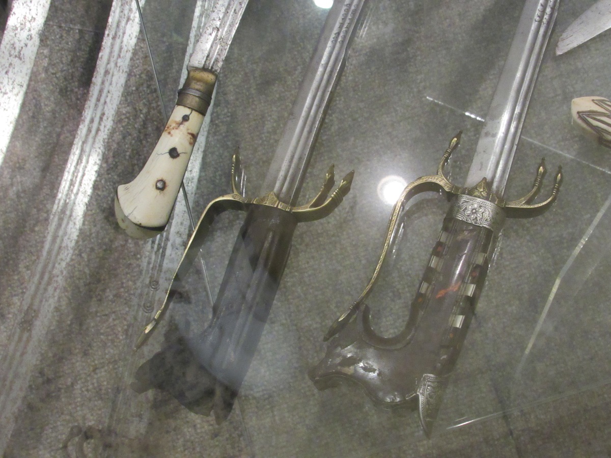

To the left of the central display there are also more swords, and quite possibly the most interesting/important ones. There is one sword with a tortoise shell and silver hilt, belonging to a group of swords in the Met, the Hofburg, the Real Armeria and of course, the de Ruyter sword in the Rijksmuseum. These were collected all sometime in the mid 16th century, so this one is easy to date, and quite pretty. Note also the similarities in general shape to excellent nimcha Charles shared with us. There are two more nimchas next to that one,among them a yatghan-style hilted one with ivory scales and a brass bolster.
Furhter to the lower left, there are three very intriguing swords. One of them has a D-ring. This feature is usually associated with swords from Southern Arabia, Zanzibar and the Komoros, but there is no doubt this sword was collected in the Mediterranean and one occasionally finds such D-rings on Maghrebi nimchas. Note the straighter blade on this one and the crescent and star markings. There are two more swords next to the D-ring one: a sword with a fullered curved blade, and another sword with a great 16th century Mameluke blade: hard to see under all the dirt and rust, but all the characteristics of Mameluke blades are there. This is obviously not the original hilt of this blade, and sadly as of right now we have no way of telling exactly when it was mounted that way.

.......we can therefore conclude that the majority of the arms were collected in the 17th and 18th centuries.
What is Afghani Ch’hura doing there? Is it also 17-18 century? Ottoman-Hotaki war?
And in the next array: short saber with yataghan-ish eared handle and no guard. Proto-shashka?
Theodor, do you have any idea whether there are museum provenance records and dates of entry?
The similarity of Maghrebi and South Arabian “nimchas” is plainly obvious to the point that some are virtually identical. Who was the donor and who was the recipient? Were there any exchanges of mercenaries? What might have been a role of the Ottoman forays into Southern Arabia starting in the middle of the 16 century? I think it might be a topic of a fascinating research.
No, I have no idea. Unlike the European armor and arms, which are extremely well studied, there is next to nothing on the Islamic ones. As you can see by their state of preservation, they have been neglected in more ways than one.
I could be wrong here but I do not see a Central Asian hilt - I see a nimcha blade adapted to an early yataghan hilt.
I am not implying anything Central Asian. But a weapon with saber blade, eared handle and no crossguard is a decent description of a shashka-like one. My question ( likely an unanswerable one) is whether we are witnessing a connection or just a parallel development. Something to put in the memory piggy bank;-)
As to the sorry physical state of nimcha blades... For a minute or two I thought that when I retire , volunteering going to Valletta and cleaning them might not be a bad idea. I could even donate WD-40, steel wool and Renaissance wax.

Very impressive grouping! Thanks for these pics. The number of blade variations speaks volumes, even with the later long straight blades missing.
The knuckle guard lacking on some is well noted, as most seem like true "no thrills" fighting swords.
I did also note that one example(silver and inlay in a nice close up of the hilt) is decorated in a way very similar to some Moroccan snaphaunce, or afedali.

That might account for the presence of what appears to be an Afghan 'choora' dagger, though it is obviously far more recent than many other weapons here .Also the ivory/bone hilted yataghan form (sans ears) with nimsha blade, which reminds me of certain similar hilts from Balkan regions I have seen with the 'oriental' influence favored through Europe in 18th c. .
