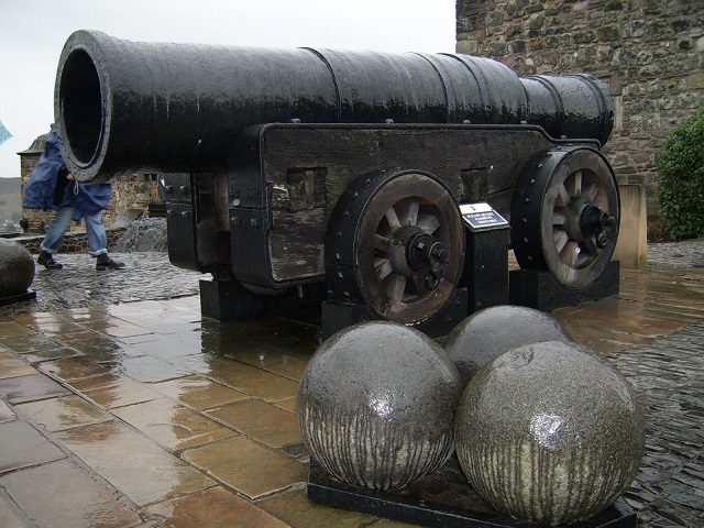

Mons Meg, which is 15ft. long and a 20" barrel, firing a 369 Lb. ball.

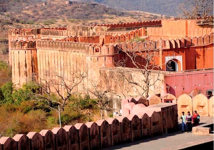

Focus on Jagargh Fort, which was apparently built overlooking Amber Fort and the palace to guard the royal family. It is on a promontory on the hill called Cheel ka Teela (as noted) and which means hill of eagles. Here in the Aravali range it seems there is an abundance of iron, clearly well providing for the casting of cannon, which they could cast in a day many of 16 ft.

Images of Jaigargh fort as seen from Amber Fort and looking down from it to Amber Fort.
Bottom, Mons Meg at Edinburgh

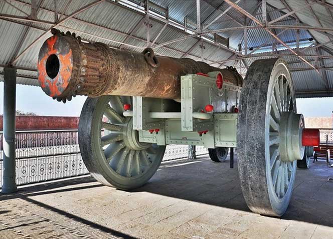

Jim, while you have certainly read such notes about the Jaivana, let me please recall the data presented in my first post and the following further details i originally omitted, in order not to be so boring; this will perhaps gives us a more balanced contest with the Mons Meg, often approached in previous discussions. Besides my impertinent correction, the data is now in Royal units, as metrics could create some confusion.
The Jaivana barrel is 20.2 ft. long (not " ) and weighs 50 tonnes.
The carriage weighs a lot more! It was rumored that it took four elephants to turn the cannon around.
Its circumference at the tip measures 7.2 ft.
Its caliber is indeed 11", but fires a 110 pound projectile, expelled by 220 lbs of powder.
It rests on two wheels measuring in diameter 4.5 ft. Two removable wheels measuring 9.0 ft. are used for its transport.
The Jaivana Cannon was only fired once by the Jai Singh II, as a test-fire in 1720. The most exaggerated myth claims that the weapon had a range of 40 km (25 mi), other sources say it is 35, 22 and 11 km (6.8 mi), although the exact range could perhaps never be determined without adequate scientific computation.

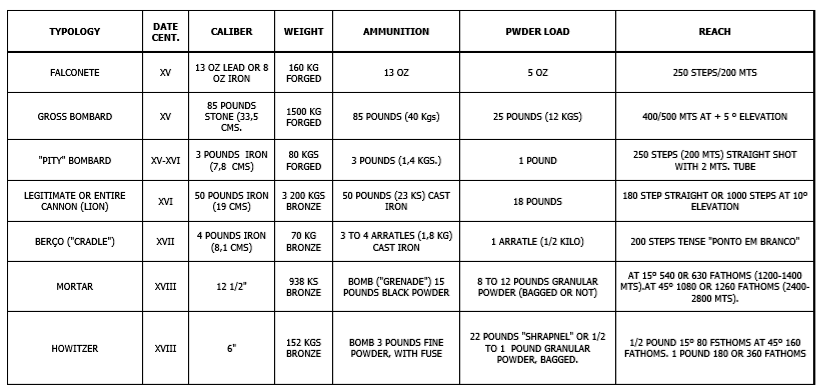

I have made a timeline chart with a few of the examples in exhibition and described in A ARTILHARIA EM PORTUGAL (1982), written by General Manuel F. T. Barata, when of an event in the Oporto Military Museum where, among other details, that of the guns reach is rather more realistic.
It is undeniable that (mainly) the evolution of gunpowder, added to the elevation angle of the piece and other parallel technologies contributed for an exponential reach and impact of projectiles.

Fernando, looking back at the chart of guns in the Portuguese report, it is fascinating to see the different terminology used in the variant types. I had not been aware of differences between a bombard and other guns, nor what a howitzer was exactly.
Jim, the names of artillery pieces is a fascinating subject in itself. First off, our term "gun" is derived from the word "gonne" which was first applied during the late Middle Ages to mechanical catapults.
The "falconet" in Fernando's museum table was a common term for a very light artillery piece, its long but slender barrel having a bore as small as about an inch or slightly bigger. The names of birds were often applied to artillery pieces, generally of lighter caliber. Thus, the "robinet" which incidentally was earlier used to identify another type of catapult. And there's the "saker" which is, as I recall, a species of hawk.
Reptilian names, of real or mythical beasts, were used for some larger bore weapons. There was the "culverin" , from culebra or serpent. And the "basilisk".
To answer your question, a howitzer (Ger. Haubitz) is a gun of large enough bore to shoot an explosive shell, but of fairly short barrel length, mounted to fire at medium elevations (around 20 to 45 degrees), usually for the purpose of breaking up enemy formations in the open field with bursts of shapnel.
At the extreme are mortars, very short large bore guns shooting bombs at very high elevations, designed to drop their bursting shells behind enemy fortifications, to clear or penetrate the decks of ships, or to hit troop formations behind hillocks or other obstacles. (small hand-held versions in shoulder stocks and fitted with flintlocks were even made to launch grenades)

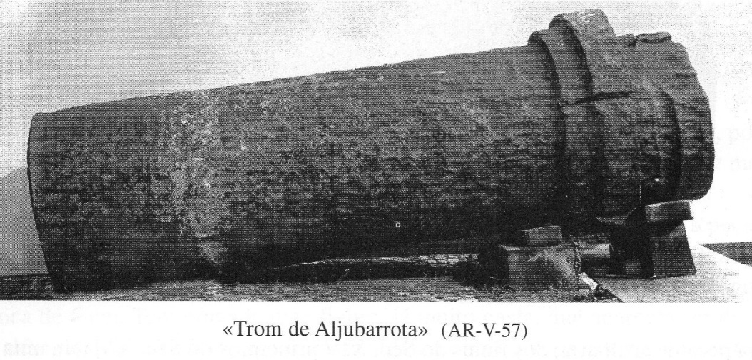

It is undeniable that, the first efficient component in artillery was not its wished purpose but the noise, that imposed fright among the enemy's hordes.
Aside from the first registered use of artillery in the Peninsula, which took place in the siege of Algeciras (1342-1344) where Yusuf I, Sultan of Granada, "fired iron projectiles from primitive gunpowder bombards, which caused extensive damage*, we have the Battle of Aljubarrota (1385), in which the Spaniards were equipped with 16 trons**, which only managed to kill two Portuguese and a British (ally) in the in the defenders right wing, with one of the volleys; however the trons fuss causing great consternation among the Portuguese horde, as our men of arms did not know such weapon.
* I am not certain of the type of the damage; a plausible inferrement would contextually be the psycho impact, rather than physical.
** Trom is the onomatopoeic name given after the noise caused by these devices (troooom).
In the Portuguese Navy museum, there is a device called Aljubarrota Trom, recognized as neither having being in the Aljubarrota battle, contrary to tradition, nor being a whole trom, but a loading chamber for one of the trom kind. With 1.7 yards in length and weighing 1.5 ton, must have served a 5 to 6 yards gun, basically due for beating walled fortification gates.
In a timeline as from then, artillery pieces were given a countless series of names, from those of birds, beasts, and other, until they ended up being named after their caliber (six pounder, twelve pounder), still not forgetting that, before a caliber 'standardization' was 'imposed', yet long after it was 'idealized', calibers existed for all tastes, through all such timeline, which caused great difficulty to check on what ammunition to introduce in each barrel.

From most of what I have been able to find online, there seems to be a lot of myth and hyperbole on this gun. As I mentioned in an earlier post, it seems to have inspired the 1933 CS Forester novel "The Gun", which later was made into a movie in 1957, "The Pride and the Passion", about the travails of trying to transport such a huge cannon.
While most accounts say this gun was fired only once in 1720, others claim it was fired numerous times, as evidenced by fire marks inside the barrel. The disputes over the actual range have apparently been largely exaggerated in accord with the huge size of the gun.
It also seems that a water tank was often placed near guns, particularly large ones, for gunners to literally dive into to avoid the shock wave and it seems the heat from the explosion. I would think more research would be necessary on the validity of that perspective.
With the huge gun, it would seem the very noise of firing it would be a profound declaration of power, and disconcerting to any potential attackers as well as the surrounding populace. We have at times been located near Ft. Hood here in Texas, and often we would hear resounding report booming in the distance, and a sense of concussion almost as the practice firing of their artillery took place. It is very convincing!
Though this is a huge cannon, firing 110 lb ball, it is hard to imagine the explosion from 220 pounds of powder! I would not wish to be standing next to this kind of explosion as these poor gunners must have. Another account claimed the gunner was killed by the detonation of this huge gun before he could make the water tank. Naturally it is hard to determine the truth from the lore in these things.

On the Mons Meg ...
I know you guys are more focused on why it cracked, but i find it also interesting to find when it cracked... as attached down below.

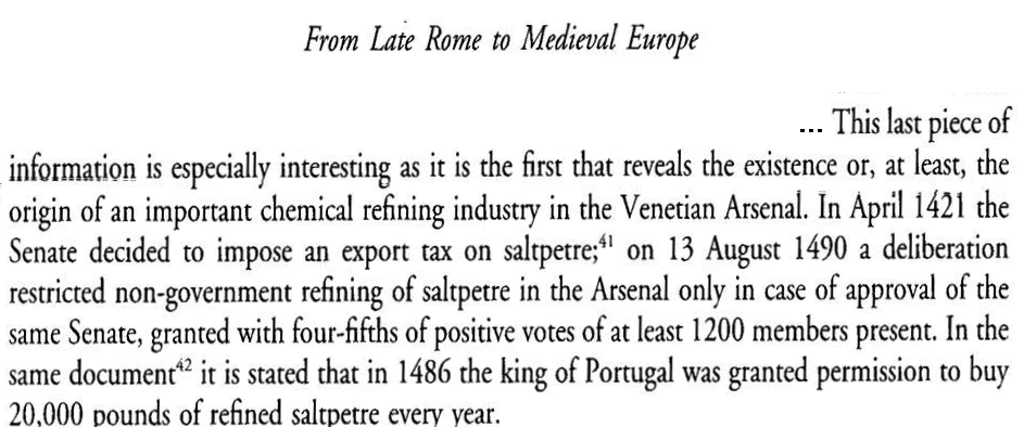

**** Such look for precious gunpowder raw materials may be observed in the third attached text.

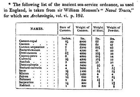

Serpentine Powder charge table for various bore sizes is attached.

Serpentine powder charge chart for naval cannon sizes:
