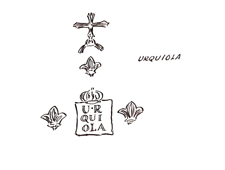

As you know I am not real up to speed on firearms, but I did go to what general resources I have. In 'Gyngell' p.106 is this illustration of a marking configuration which seems to correspond to what you describe.
It does not have the rampant lion, and of course the 'stacked' in three name abbreviation does not match, but checking in Gardner ("Small Arms Makers", p.325, URQUIOLA is listed 1680-1714 in Madrid; then again in Madrid 1815-31.
While the makers name does not match, and the rampant lion is absent, I thought perhaps this marking convention might indicate at least possible Madrid manufacture. While Spanish type markings, the 'ANO' suffix does sound Italian. Not impossible that an Italian gunsmith might be there and use similar marking techniques. The absence of the lion may suggest subordinate to makers with royal contract ? or some such administrative situation .

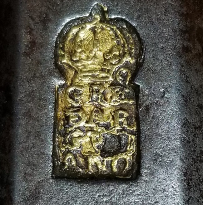

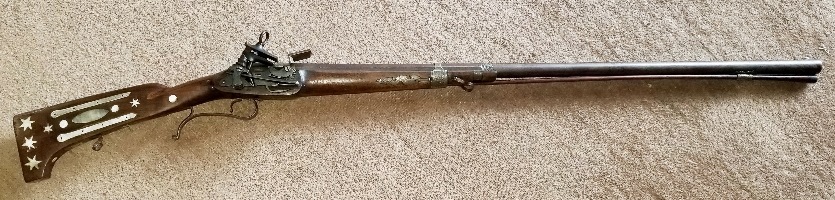

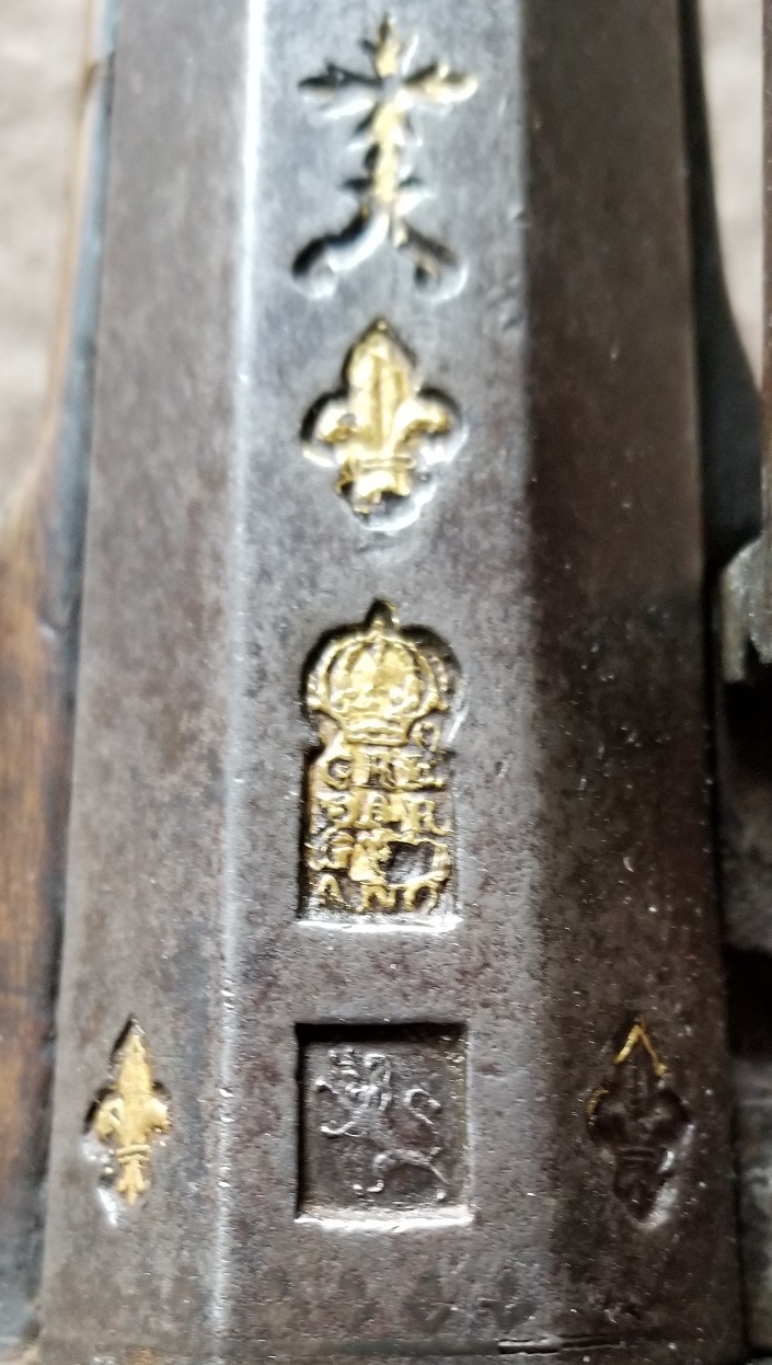

I was visiting a client who was unwilling to have the musket photographed.
He has since sent these pics.
I've checked my library, but am unable to find this maker.

It really takes eagle eyes to discern the contents of such damaged lettering; i confess i couldn't do it myself.The GRº for Gregorio seems consistent; the rest, i wouldn't know. It still could be the name of a Spaniard; Arcano, Marcano.
I wonder what Fernando K has to say about this mark.
A (hunting) escopeta ... Africanized ?

The owner insisted it was French, that he had bought it in France,
and that it had been there for "many generations." The inlays in the stock are bone and mother of pearl.

Thanks, I should have said escopeta rather than musket.
The mother of pearl pieces look like gambling chips. I didn't
have the opportunity to study it for long as I was working.
I did notice that the mounts are both silver and steel, very
well inletted and engraved. There is no maker which even
approximates this name in Lavin. I must say, however, that
it was a pleasure to read him again. Very good piece of arms
history writing.
Looking again at the photo of the mark just now, it looks more like
GRE.
DAR
GUD
ANO
Whether the name itself is Spanish, all of the marks, including the lion countermark, point to Spain, do they not?

A. The photo of the maker's punzón is quite clear as to the lettering except for some defacement on the penultimate line. Taking DAR ... ANO and checking the listing in Stöckel reveals no such combination, no matter what letters may fall in between. As you suggest, it may reflect the name of an obscure maker. And it may be that there's more work to be done in documenting all those Iberian gunsmiths whose names have not appeared in the published references to date. As a small example, over a year ago I purchased a very fine Eibar-made shotgun, ca 1790s, signed on lock and marked on barrel by a maker with a very unusual surname - Murúa. No mention of him in Lavin, Neal, or Stöckel. At first I even doubted it was Spanish, and only after checking the US Census Dept's list of Spanish surnames was able to verify that indeed it was.
Furthermore, there is no requirement that we take the 3-letter combinations in Oliver's photo at face value. If you would re-read Lavin pp 214-215 he explains that these can be quite cryptic, including abbreviations, using non-standard spellings, or even incorporating place names.
B. I do believe that although the identity of the maker is a mystery at this moment, I can recognize certain stylistic elements that point to this shotgun originating in the Eibar area (foothills of the western Pyrenees adjacent to the Bay of Biscay, where Spain's sporting arms industry is centered even today). The boot-shaped "Catalan"style buttstock was popular here, as was a half stock barrel mounting with a single capucine on the abbreviated forestock. Also, the cock jaws on locks made in this region are long and slender, a conservative feature harking back to the 17th century but remaining in vogue through the end of the 18th. This basic format (albeit minus the rather garish stock inlays) can be seen on an Eibar fowling piece of restrained elegance but of the highest quality in the Metropolitan Museum of Art acc. no. 16.135, bearing the marks of Antonio Guisasola (barrel) and Juan Navarro (lock). The Murúa shotgun in my collection shares the same design.
C. The Spanish format of barrel breech markings was used in Italy - specifically Naples, which is not unexpected considering that this city was the seat of Spanish rule over the southern half of Italy which lasted for centuries. The familiar features that we associate with Spanish markings: the cross upon the arched base, the fleurs-de-lys, punzones and heraldic seals, are present.
