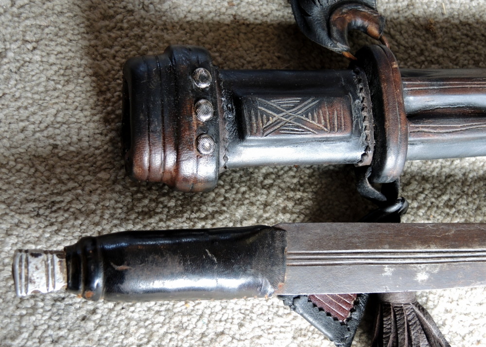

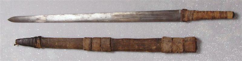

Interesting thread Jim. There is no doubt that the hilt style of Manding swords closely resembles those of Oman. Trade in the "early days" no doubt would have had some bearing on similarity of styles.
I have attached a pic of a Manding sword which I have. While the blade is quite short, and straight, the hilt is guardless and resembles very closely those of Oman.
Stu
Stu

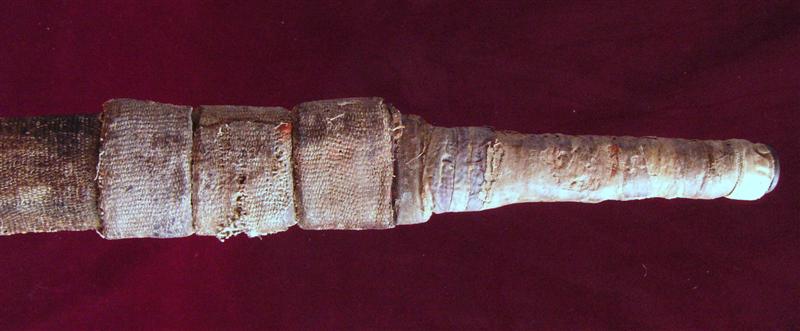

This straight version of these West African swords which has of course similarities to the Manding, but has the kaskara like blade (central three fullers). These I have thought associated with straight blade swords of Sierra Leone (often termed 'slavers swords' from the 'slave coast'). The leather work of Manding character seems to often broaden the geographic scope of these similar but slightly varied types.
I added a picture of one of these with the three fuller blade from 2008...…...in the thread I got a good chuckle from our late friend Vandoo…..when he quipped it looked like the sword of Karis from "The Mummy" because of the mummified wrap.

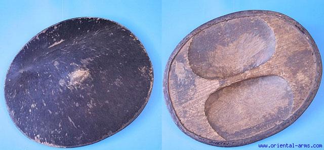

The shield noted as of a Madagascar type seems interesting, and though I really don't know shields well, it may be equally 'licensed' as are the swords. I am sure that in the busy enterprise in Zanzibar with trade from many sources brought weaponry and goods of wide array into materials handled.

To this was added the Manding shield...
