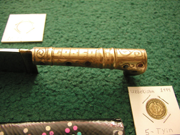

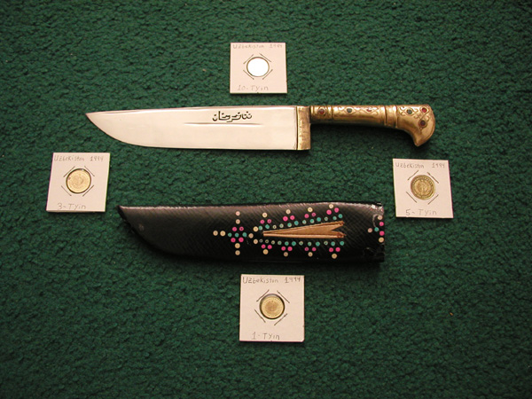

Hello All!
I have finally got a very good quality Uzbek pichok. It is definately a using piece, the quality is great! The blade is either carbon steel, that was chrome plated or stainless steel. (I can't tell which one it is) The blade is well made either way and was hand forged, as well as the whole knife being hand made. On the blade and handle there is some sort of odd script, maybe someone can translate it. There are 12 small glass 'jewels' on the handle. What I find odd about this is that the sheath does no swallow it up to the top of the pommel, and does not have a belt loop of any sort. (perhaps it had a frog at some time or another) It is not that old I would say anywhere from the 1991 break up of the USSR to the present, would this estimate be correct or not? Any comments or information on translation would be much appreciated.

Hello Ariel!
Yes they are very pretty knifes. I like your estimate on it's age more than mine, looks like I bought the right coin set dated 1994(close enough to 1998!) I have two more comming that have the longer sheath I will post them when I finally get them. Is there a way to test if it is chrome plated or is stainless steel. The one reason I am leaning toward stainless steel is that I matched it up against a stainless steel axe head I have that is mirror polsihed like the dagger and the color and mirror liker qualities match.
Bye.
P.S.- For great information on pichiks and Uzbek culture in general the website " http://intangiblenet.freenet.uz/en/uzb/uzb3211.htm " this is one of the best websites I have seen on this stuff!
Judging from this site my pichok seems to be a soili or komalak pichok due to the trench on the one side of the blade.

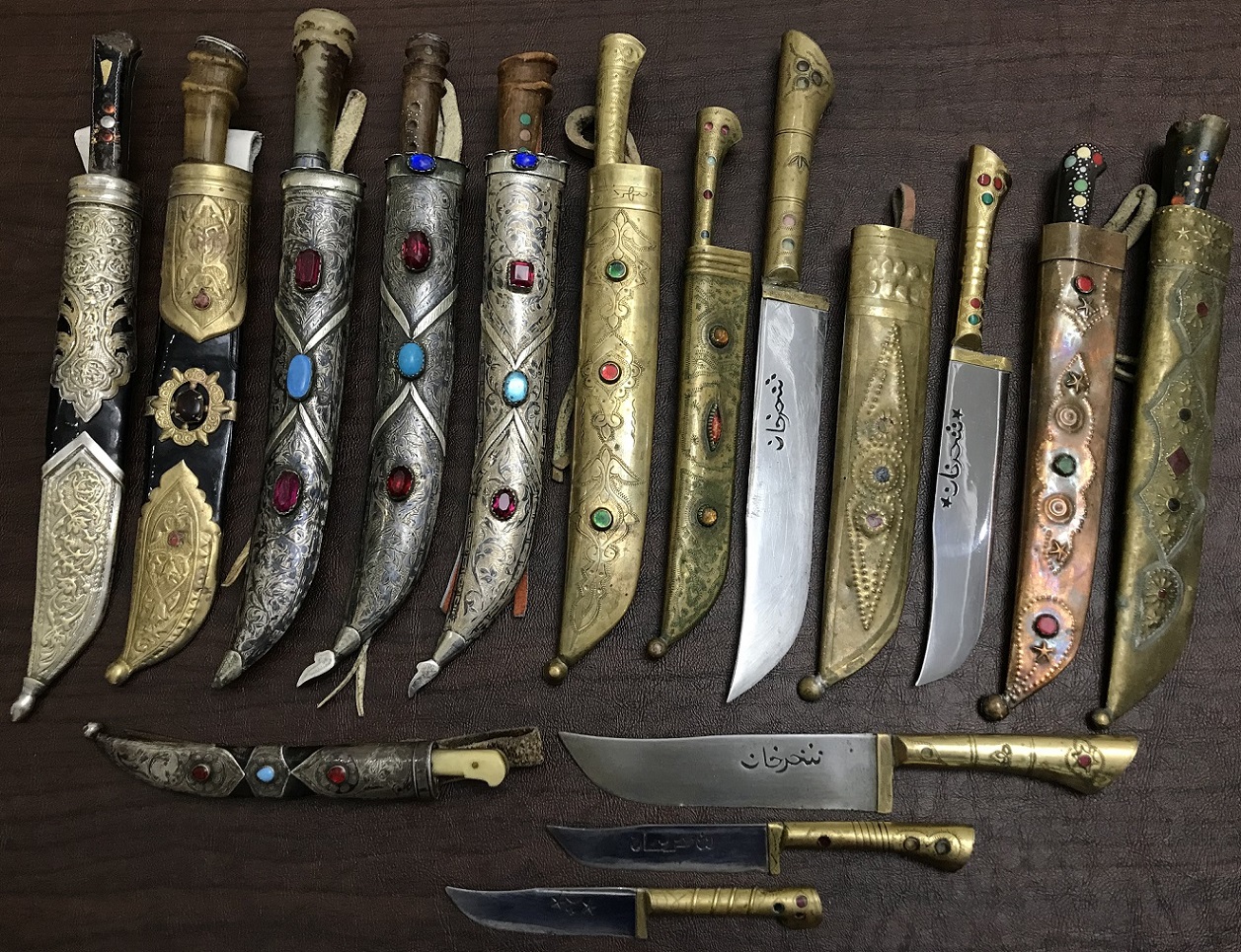

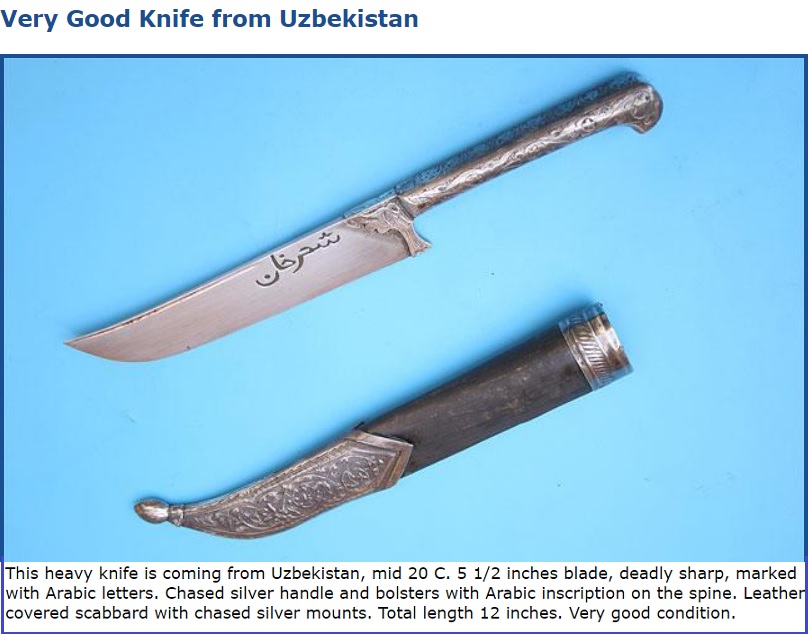

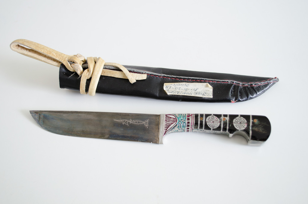

I agree, these knifes are pretty, late 20thC. The knife in Post 1 is from the city of Shakhrikhon in the Andijan province of Uzbekistan. The blade is polished stainless steel. As you know, there are several main knife making centers in Uzbekistan, their production looks generally similar. In addition, many knifes are coming to Uzbekistan from Afghanistan and other nearby countries, most also look quite similar to the locally made, some are really high quality with impressive damascus blades and elaborate handles. In terms of vintage Uzbek Pichok knifes, below is compilation of the late 20thC types, an older Shakhrikhon knife from Oriental-Arms site, and variety of different vintage Shakhrikhon (and some Chyust) knifes.

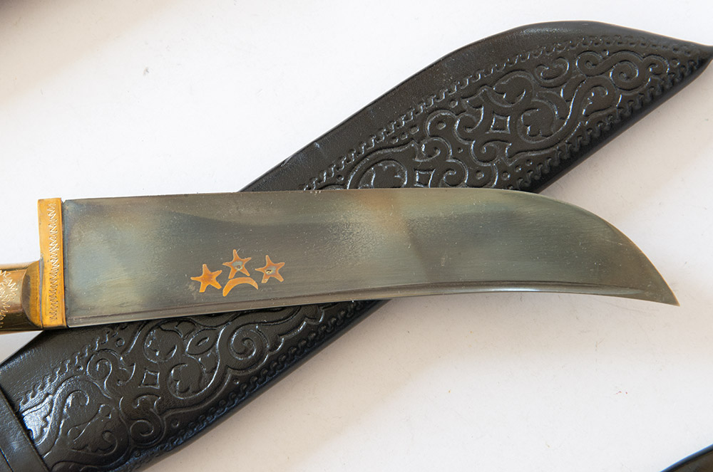

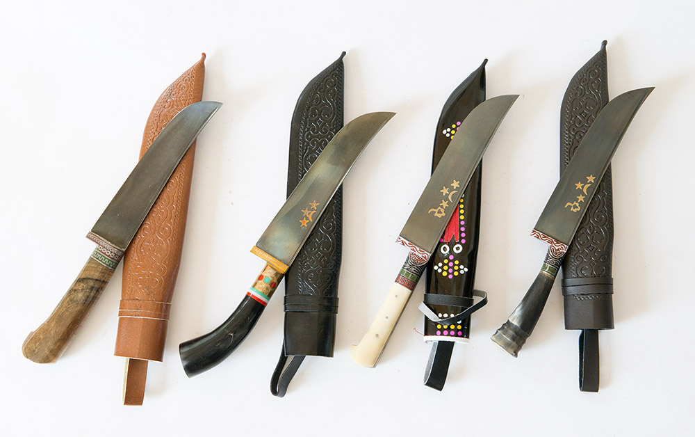

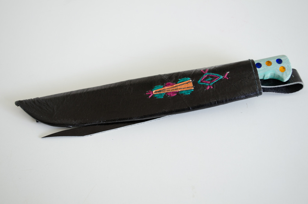

Here are mine Pchak. I find them pretty attractive.
All of them are modern day production and were bought in Kiev from fruits sellers from Uzbekistan. All have good quality blades. One of them has a differentially hardened blade made of some kind of crucible steel
