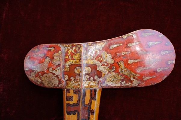

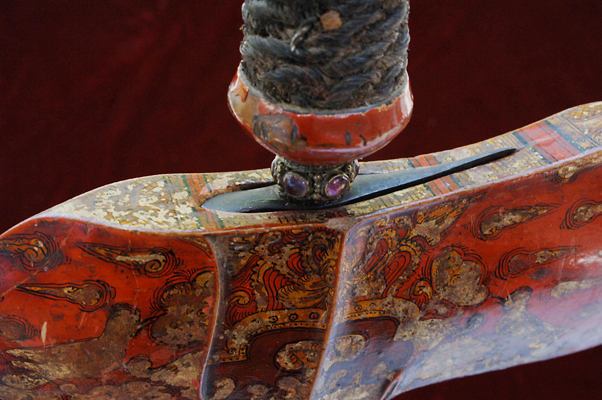

An interesting keris Athanase. Can you tell us how long the blade is as it looks shorter than the norm for Bali blades? I also have a similar keris in that it is Bali/Lombok with old sunggingan (painted sheath) and the blade is particularly short for a Bali keris though the sarong is normal size just like this one seems to be. I agree that this, just like my own, once had a form of pendok, the Balinese type that covers just the back and sides and leaves the front open to expose the wood.
Mine also has a Tapukan style hilt like yours with a hair wrapping and has red paint on the wood as well to match the painted sheath.
My feeling is that these shorter keris are in normal large size Bali sheaths to accommodate the normal method of wearing the keris. I'm not sure about the significance of the shorter blades. They do not seem like patrems, but there must be some significance to the shorter lengths i would imagine. It does seem the the larger lengths on Bali keris is more of a later development though, so maybe these are older blades being fitted for the normal customs of wear over time.
I am afraid that i do not have too may photos of mine currently, but here are a couple of shots i have for comparison.

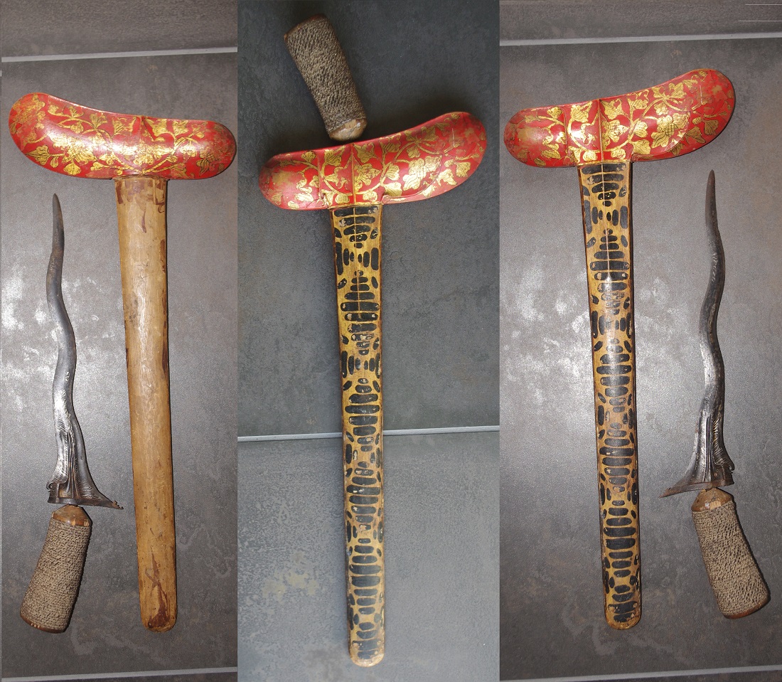

Here is another similar dress combo of sunggingan sheath and Tapukan hilt, though the blade seems a more standard size.

Originally Posted by David
Here is another similar dress combo of suggingan sheath and Tapukan hilt, though the blade seems a more standard size.
Mismatched blade and scabbard?
Old 25th February 2019, 02:19 PM   #10
Posts: 7,303
I have no idea judging solely by these photos. Why do you suspect so?

The sampir is designed for a ganja kelap lintah...
Old 25th February 2019, 03:44 PM   #13
Posts: 7,303
Well, you might be correct there. Not something i really noticed from these photos. However, my purpose in posting was to show similar dress to both Athanase and mine. Whether or not the blade was re-fitted to this dress was not really important.

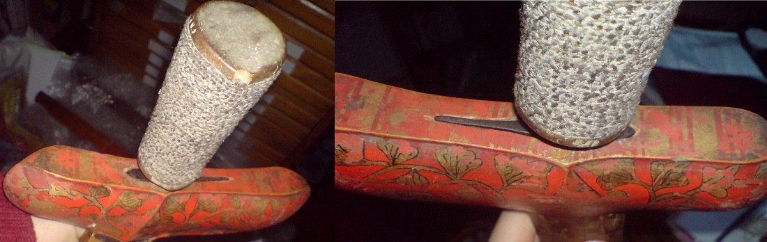

The fitting of my keris in the wrangka is near perfect.
The wood of scabbard is light and less quality than my non-painted balineses Keris.

Understood Jean. So apparently we have mine, which i am pretty certain is a sheath made specially with this old, relatively short Bali/Lombok blade, and now Athanase is confirming that his sheath also seems cut to fit.
Athanase, can you take a photo of the top of the sheath so we can see the fit?

The pictures.
Old 28th February 2019, 10:19 PM   #18
Posts: 7,303
Thanks Athanase. Given the small size of this keris and the lack of visible fillers it would seem that like my example your sheath was made specifically for this blade.
