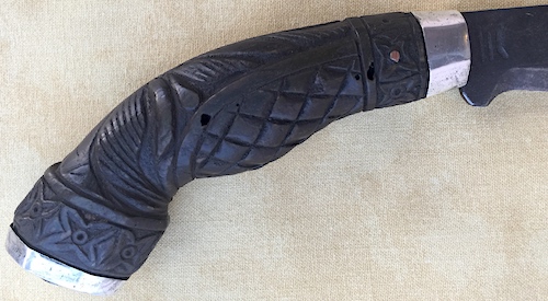

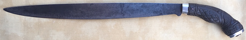

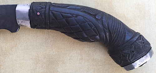

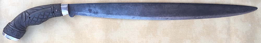

Hello forumites!
This piece got me stumped:

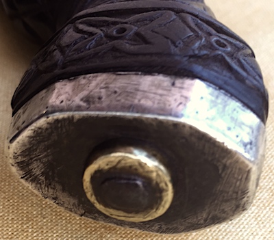

Blade with single bevel on the right hand side (left side flat except for a tiny bit of edge wear) - not with a broad chisel grind as in most Visayan blades though; full tang construction consistent with Luzon (influence).
The horn hilt nicely carved with silver ferrule and silver pommel cap (both octagonal); tang peened over a brass disk; copper pin visible on both sides near ferrule (possibly securing the blade?).
I seem to remember blades of similar profile being attributed to Bicol...
Thanks for any comments/pointers!
Specs:
sword length 564 mm (22.2")
blade length 421 mm (16.6")
max. blade width 39.3 mm (1.55"); at base max. 30.2 mm and min. 25.8 mm (1.19"/1.02")
blade thickness: at base 5.85 mm (0.23"); 1/3rd 3.9 mm (0.15"); 2/3rd 3.3 mm (0.13")
weight 504 g (1 lb 1.8 oz)

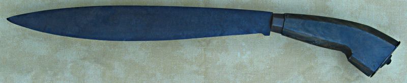

POB 90 mm (= 331 mm from tip)

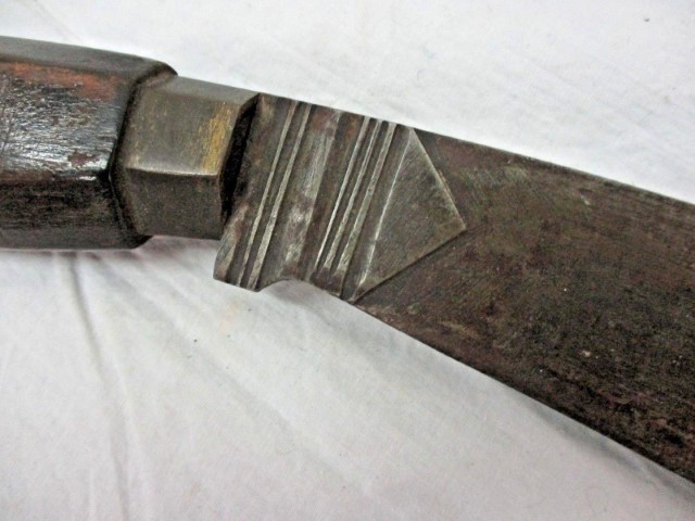

P.S.: Note the maker's mark(?) at the base of the blade (right hand side)!

Certainly not my forte; however, going by the hilt's carving, materials, and craftsmanship, I'd estimate it around the turn of the 20th century, possibly even 19th c.
I believe there is a tendency to underestimate the age of Luzon blades with monosteel blades.

BTW, have you come across any similar "maker's mark" on Luzon blades?

It would seem a bit redundant to have a single soft copper pin go through the tang (weakening it by drilling) when it already extends completely through the hilt and butt plate and is then peened to secure the blade. With this piece sporting silver fittings you might have the pin checked to see if it isn't a low grade gold alloy instead of copper. This might also explain why most of them are now missing.

Hi Kai! Yes definitely related. Your blade profile is what is called "dahong buho" or "dinahong buho", common among several towns in the province of Laguna, Luzon.
Thanks a lot for your info!
As for the hilt, that's a curious style, and echoes antique iterations of 'tabak' and 'dahong palay/dinahong palay'. I'm guessing yours was made in Laguna as well.
It sure is a really nice carving work with the prominent flowers (possibly even enhanced by copper inlay)! Looks like old-style craftsmanship to me; most likely antique, isn't it?

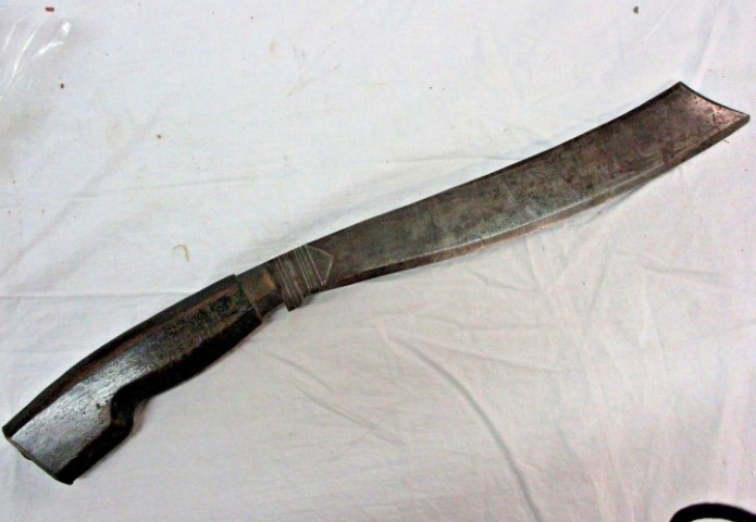

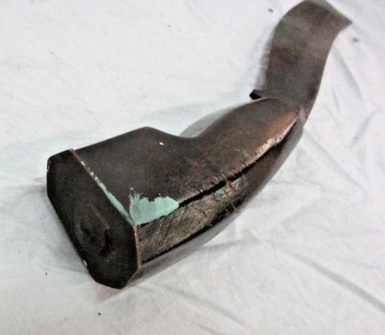

For comparison, I'm adding a regular Luzon blade from possibly the same period; the hilt is the same type as in Robert's example while the blade has a symmetrical bevel (i. e. no chisel grind). [Please excuse the poor pic quality. I traded it with a forumite a long time ago.]
BTW, this common plain hilt type always seems to have 7 facets (which is also reflected in the ferrule).
The ornately-carved hilt has an octagonal ferrule as well as pommel plate though; also the neighboring flowers number 8.
Specs:
Length: 492 mm (19.4")
Blade length: 334 mm (13.15")
Blade max. width: 46 mm (1.81")
Blade max. thickness: 8 mm (5/16")
Hilt: 160 mm (6.3")
weight: 598 g
Yeah, I agree that wouldn't make sense with a peened tang.
Thanks for the good idea - might well be red gold or decent suasa: No tarnishing visible with them while the silver retains quite some old tarnish...
I'll report back when I manage to obtain sound results!

The final fitting the tang extends through before being peened looks a bit yellow in your photos as well, so you might want to have it checked at the same time as the pins.

The 'peened tang' could be just a nail used to hold the pommel piece on, as is done on many khukuri. An x-ray would confirm or deny the tang type.
More cheaply, you might get some info by using a strong super-magnet, running it along the grip to feel if it 'pulls' all the way along.
