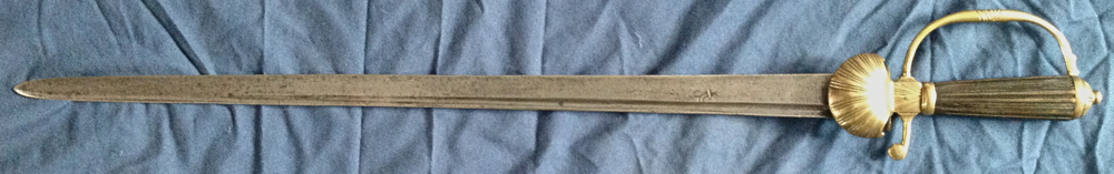

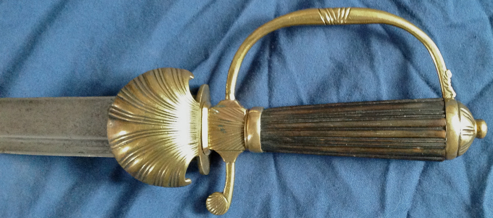

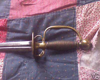

Hi,
Continental European, rather than English I would suspect, mid 18thC hunting sword. O.A. length 28 inches blade 22 3/4 inches, 1 1/4 at widest and shy of 1/4 inch at its thickest, the hilt is of horn. There is no blade decoration but there is a makers? mark on both sides of the blade, see photos. I have come across one other sword on the net similar looking, but with pictorial relief on the guard, with the same makers? mark. Would obviously like to hear from anybody who has any idea on the maker and of course all comments welcome.
Norman.
Old 4th June 2014, 06:13 PM   #2
Hi Norman,
From the altar of my ignorance ...
If it is not German, surely has such influence, with that typical shell guard appendix.
I can not avoid thinking that many hunting swords are mounted with (shortened) sword blades.
Have you examined how the fuller end meets with the point, to exclude such probability ?
Nice piece, by the way .

Hi Fernando,
German would seem to me to be a good call. The fuller ends properly on both sides 5 1/2 inches from the blade tip thereby to my mind excluding the possibility of a cut down blade. Here is another with the same makers mark and blade profile making the probability of both coming from the same workshop more than a possibility.
My Regards,
Norman.
Old 4th June 2014, 07:13 PM   #4
I see !
Pity i can't ID the mark; maybe some member will.

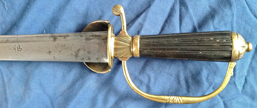

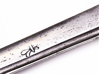

Hi
Here's a better image of the 'makers' mark on my sword.
Norman.

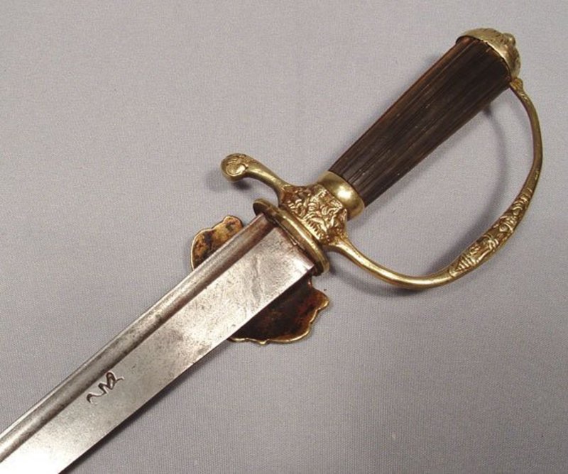

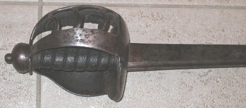

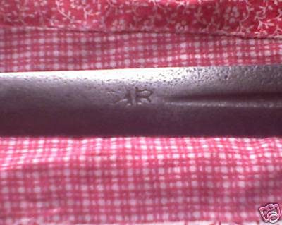

Hi,
A friend found this similar mark on a basket hilted backsword.
Norman.
Photos, Culloden House Antiques.
Old 5th June 2014, 08:35 PM   #7
A fleur de liz ... right ?
Old 5th June 2014, 08:50 PM   #8
Norman McCormick
Norman McCormick's Avatar
Posts: 1,657
Looks pretty much like it, now all we need is some well informed Forumite to come with an I.D.

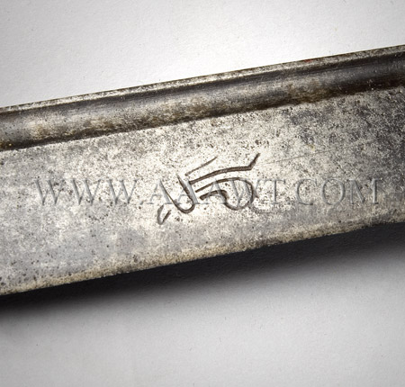

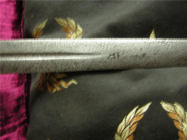

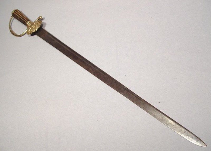

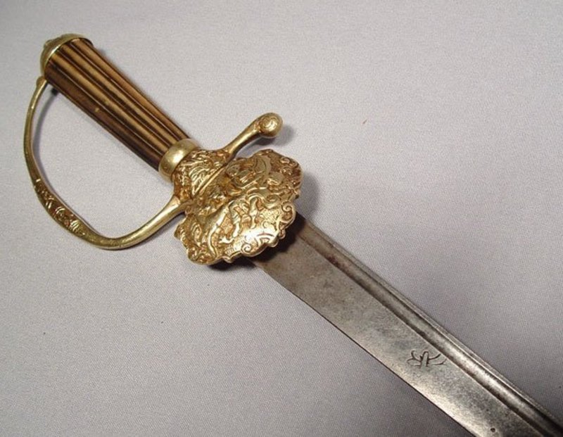

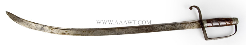

Hi,
Found another possible example of this mark.
Norman.
Photos, AAAWT

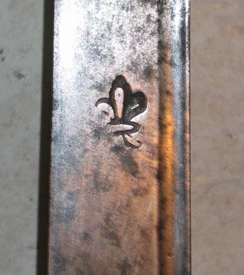

Hi,
Have found an assertion on the net that the mark is that of the London Cutlers Company but I cannot find any corroborating evidence for this, anybody got more info on this possibility?
Norman.

Yes, the blade is English-made, mid-1700s, so is the sword. Why wouldn't it be?
Fleur-de-lis stamp of this style was used on British martial blades in that time frame, infantry hangers and sergeants swords, and on some cuttoe-type hangers, which imho were used by the English infantry. During that period arms were purchased by the colonels and distributed to their troops, hence the multitude of types. I don't see why the hunting style hangers couldn't have been used by grenadier detachments and skirmishers, while the regular troops were issued bayonets.

I note also at #9 some arabic to the blade which is a variation on the "God is Great" theme but stacked half sideways...
