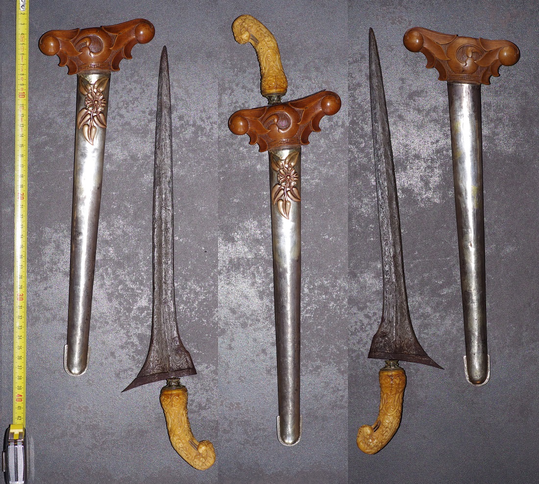

Hello
I recently had the chance to acquire this Keris. When I saw him, I fell in love for his wrongko.

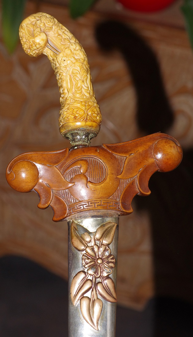

The pendok is also very unusual. It is simple, in silver brass, without decoration except for this floral plate (copper alloy? ) which is welded on it.
This pendok is obviously not the original because its opening is slightly too narrow and not fits with the lower part of the wrongko.

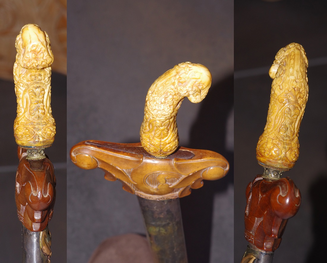

The handle seems to be ivory but I do not know what species (It is not elephant or hippopotamus and it seems a little different from the sperm whale).
The Mendak is very beautiful but does not look antique.
The blade (34cm) fits perfectly in the sheath.

Very nice indeed, I'm rather partial to this type of ensemble myself.
I am uncertain if the blade is Madura, in the photo it looks more like Jawa, but that is only a minor quibble, it is old, it is in good condition, but would be much improved by a clean & stain.
The pendok is missing its lis, the little collar that should be at its top, if this lis was not missing, the fit would be perfect. If this keris were mine I would be refitting the pendok to achieve a perfect fit without the lis. This fit would be achieved by very careful inletting of the pendok to the bottom of the gambar.
The mendak is pre-WWII and absolutely correct.
I do not know what the ivory type is, but I have been told that it is dugong.
I have been told by people who live in villages near Sumenep in Madura that this type of wrongko was normally carved by the owner, as such, there is no completely uniform style, they all vary a bit, and constitute a form of folk art.

I agree with Alan, this is a beautiful old kris, few minor comments:

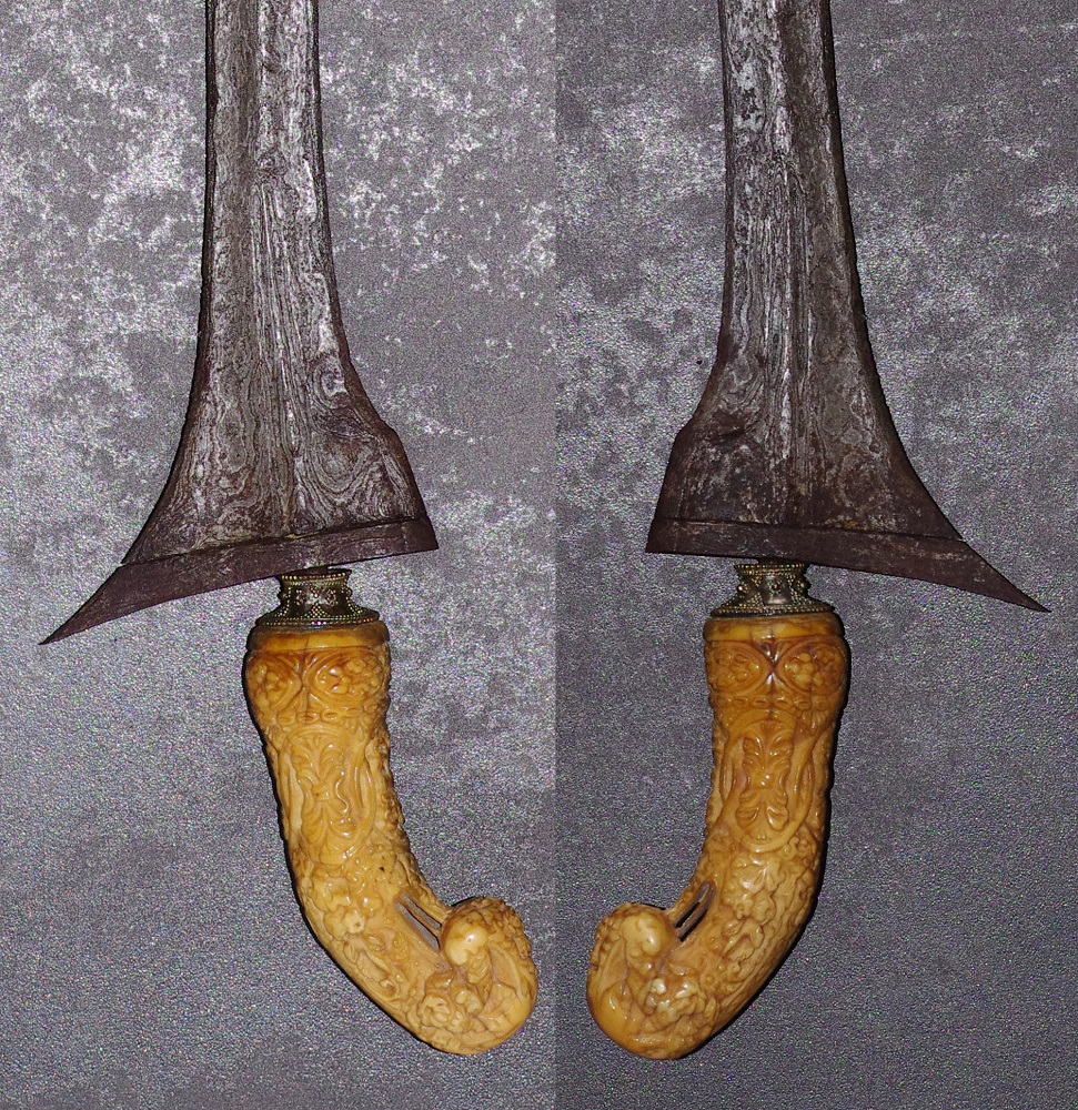

. the angle of the pesi & hilt does not perfectly match with the base of the blade (see second row of pictures).
. Although the blade fits perfectly into the scabbard slot, I wonder whether they are originally matching as the ganja looks too long as compared to the gambar on the back side, however I already saw such fitting with Madurese krisses.
. I hope that the pendok can be removed from the gandar for fitting them properly, and there is very little margin available as the blade is almost as long as the warangka.

Jean, the pesi angle is extremely common with old keris in situ, the people who actually wear them don't seem to worry much about this, but personally I find it untidy, it is a simple matter to bend the pesi a fraction, heat treatment never includes the pesi. Very often with an old keris I find I can bend the pesi with my fingers, if the pesi is too thick for this, use a bench vice with aluminium jaw liners , put the blade in horizontal and very gently apply pressure to the tip of the blade to achieve the correct angle.
This type of fitting of blade to gambar is common with East Jawa keris, don't forget, this wrongko is unlikely to have been made by a professional, its just a matter of proportion, and this type of dress is not subject to the relatively strict dictates of the kratons.
If the blade is too long to allow the pendok to be moved up a few mille, and frankly, I cannot judge this from the photos, but if it is a little too long, I guess there is no alternative but to make a new collar to fill the gap, but I would not solder it in place, I'd leave it as a separate piece.
As I said, I cannot really judge if the blade is too long to allow the pendok to move up or not, but I just did a measurement of the photo, and my guess is that there will probably be more than enough length in the pendok to move it up.
Yes, probably indeed, the pendok needs to be moved-up by about 6-7 mm and ground on the 2 sides because of the curvature of the gambar to pendok joint. The top left flower of the decoration motif may be slightly ground but it is not a serious issue.

Athanase, did you check if the slot in the scabbard was recently cut or not? This will indicate if the blade and scabbard are originally matching or not.

Oh, i btw, i love this keris, but do agree with both Alan and Jean that is deserves a good cleaning and new warangan and, if possible, an adjustment to the pesi to give the blade it's proper angle and a more correct "posture". Ideally, seeing the blade as representative of the man, i believe the angle at which a it is set should not be too upright as to be impertinent, nor too bend as to show weakness.
But in my book this is still a beautiful and unique ensemble.

Jean, the top of this pendok should not be filed down to follow the curve of the gambar , rather, the very slight step from the gambar face down to the foot of the gambar that joins to the gandar should be deepened very slightly and the step itself inlet to accept the top of the pendok. By deepening the front of the gambar foot & the gandar it would be possible to pick up a couple of millimeters to allow the pendok to be moved back, and this, combined with the deepening of the step should give sufficient depth to permit acceptance of the edge of the embossing by the gambar. The back of the gandar will then sit proud of the pendok, it will need to be filled, I prefer a very thin sliver of bambu for this, but layers of cloth or even a piece of cardboard will do the job.
If the pendok were to be free of embossing and engraving, or the border at the top was to be sufficiently wide, filing the top to a curve would be preferred, but the presence of the flowers on this one creates a difficulty, and personally, I would not want to risk damage to the embossing that could be seen.
This is a job that requires some woodcarving skill, very sharp small tools, I prefer dentist's probes and scalpels (most dentists get rid of probes and used scalpels pretty regularly), and a great deal of patience.It does not change the structure of the wrongko, all it does is to create a tiny inlet that cannot be seen, something even less than the normal maintenance carried out on the mouth of a wrongko.
I have suggested this method rather than the alternative, because wood is easier for a layman to work with than is silver or nickel. This inlet approach would be my first preference if I did not have access to a Solo craftsman.
As David has pointed out, for craftsman living in a Western society, a new collar would not be too difficult to make. But I do not know what sort of western craftsman could do this job, I doubt that a fitter/machinist would be appropriate, nor a tool maker, possibly a sculptor, or perhaps a jeweller. But what would the cost be? Western pay rates are very much higher than pay rates in Indonesia. I believe that if any of us wanted to fit a new collar, we would need to make it ourselves. I have done similar work to this in the past, it is a lengthy, fiddling job and requires a lot of patience.
To make a new collar (lis) would be my second choice if I were to be doing the work myself. Obtain a small block of silver slightly larger than the gap to be filled and carve it to fill the gap. It would need to be a very neat fit to the wood, the height of the face of the collar above the pendok would be only about one to two millimeters, the junction of collar and pendok would be undercut to permit a very small acceptance of the top of the pendok, and the cross section would be "D" shaped.
Of course, the preferred solution would be to have it repaired in Indonesia. I used to know a man who could do this and not make a mess of the job, but he died about 20 years ago. Who might be able to do a neat repair now is very questionable.
David, what you say about the hilt angle is absolutely correct, in terms of a Central Javanese kraton, however, this keris is not Central Javanese and was not intended for kraton wear. A keris worn by a farmer or a carpenter or a storekeeper is not subject to the same regulation as a keris worn in a kraton setting. Most particularly so when the keris is in Madura, and the kratons are in Central Jawa.
Then there is the problem of obtaining a perfect hilt angle in Central Javanese terms:- the mendak cannot be adjusted, to adjust hilt angle the hilt would need to have the existing hole filled with a dowel and be re-drilled, easy enough to do, but something that I would not want to do for this keris.
The question of whether or not the wrongko is original to the blade is to my mind totally irrelevant. This question of "original to the blade" is something that seems to be of great importance to collectors based in Western societies, for a genuine pusaka keris it might also be of some importance , especially in Central Jawa, but for the keris of an ordinary person, and for a non-pusaka keris it is, in my experience, something that is not considered important to the vast bulk of of the populace in the keris bearing societies of Jawa and Bali.
We need to think of the keris in its totality as:- male = wilah, female = wrongko, hilt = guardian. We do not let a beautiful woman, or even a not so beautiful woman, go unspoken for if she is divorced or her husband has died. We do not refuse to accept a gate keeper if he has worked for several people previously. We need to apply this way of thinking to the keris.

Thank you all for your advice.
Alan: I understand the concept of "Lis" but I do not understand if it must be in the extension of the surface of the pendok or if it must be in over-thickness, a bit like a border in relief?
I have silver foil (0.5mm thick) but the pendok is brass. I don't know anything about welding, but will this difference in materials not make welding difficult?
Otherwise there is the solution of a fixation with a strong glue of Lis on the pendok (removable with acetone).
In any case, it's not the blade that hindts the advanced pendok (I try without) is the width of the base of the gambar which is too big. At maximum the pendok arrives at 1mm from the edge of the left and right side.
For the pesi this can be done by my brother who is locksmith / metaller (he manufactures and installs gates, banisters, guardrails etc ...)
For the work of silver I asked him, he never learned and his tools are too big for such fine work.
For the washing of the blade it is possible (vinegar, or citric acid), but for staining .... it's complicated to find realgar, good lemons, good dosages ... I already made 2 test on very average blades, the first did nothing (I think the indicated dose of realgar was too low). And the second made a very ugly result (the realgar had largely turned into orpiment).
