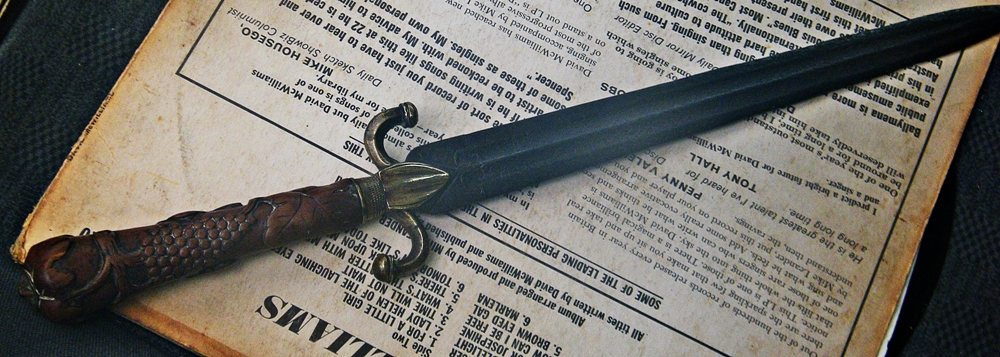

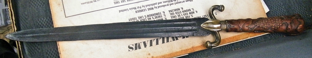

Hello dear members,
A good friend of mine asked me if I can post this dagger which he recently purchased at this place for comment since neither he nor I am able to identify it's origin and the possible name of this dagger.
Until now he don't have told me it's measurements but soon as I have them I will post them.
Any hints and comments are very welcome! Thank's in advance.

If I may hazard a guess, I'd say it is a Indian-made hunting dagger made to resemble European models. Looks mid-1800s to me with a possibly older blade.
That said, i certainly defer to the more learned folks on here

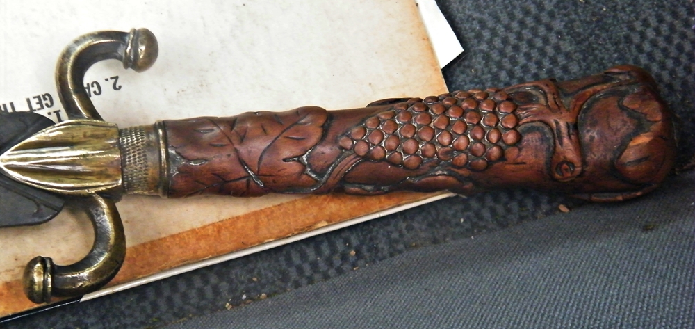

It looks old and a construct. The thimble in the handle is a little odd. The blade looks aggressive but the handle with grapes and vines looks more like the handle of a table knife or bread knife.

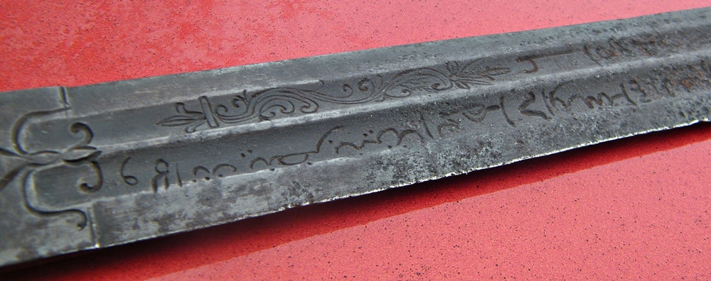

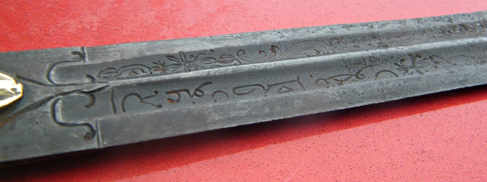

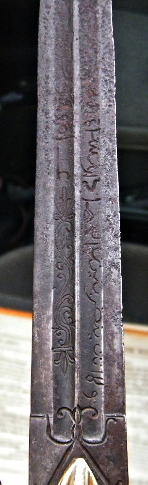

Some of the script on the blade looks Georgian. Cool bread knife handle. The marriage looks like a success.
Old 17th December 2018, 09:15 AM   #5
To me it's an Ottoman blade reused for an European hunting knife

The owner thought byself that the handle is most probably not original to the blade and that it is a bread knife handle.
It would be very useful to know if the inscription is indeed Georgian!

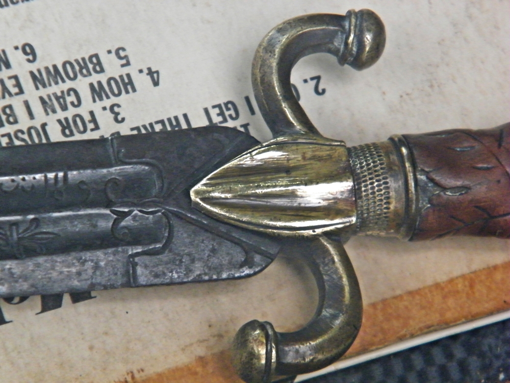

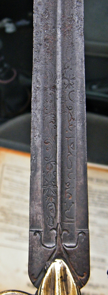

Hi Detlef, sorry to hear you were ill and I wish you full and quick recovery. The writing is 100% Arabic, though it is somewhat unclear here and there. I will not try to read it because I would make too many mistakes. Ask a native speaker and he could read it. I am not familiar at all with this type of dagger, but without an example, it is very hard to say if it is a construct. The guard, ferules and the hilt seem to fit well together, so I am not convinced.

Hi Eytan, thank you very much for both, the get well soon wishes and the identification that the writing is Arabic.
I hope that someone will be prepared to translate the inscription!
