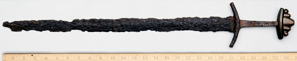

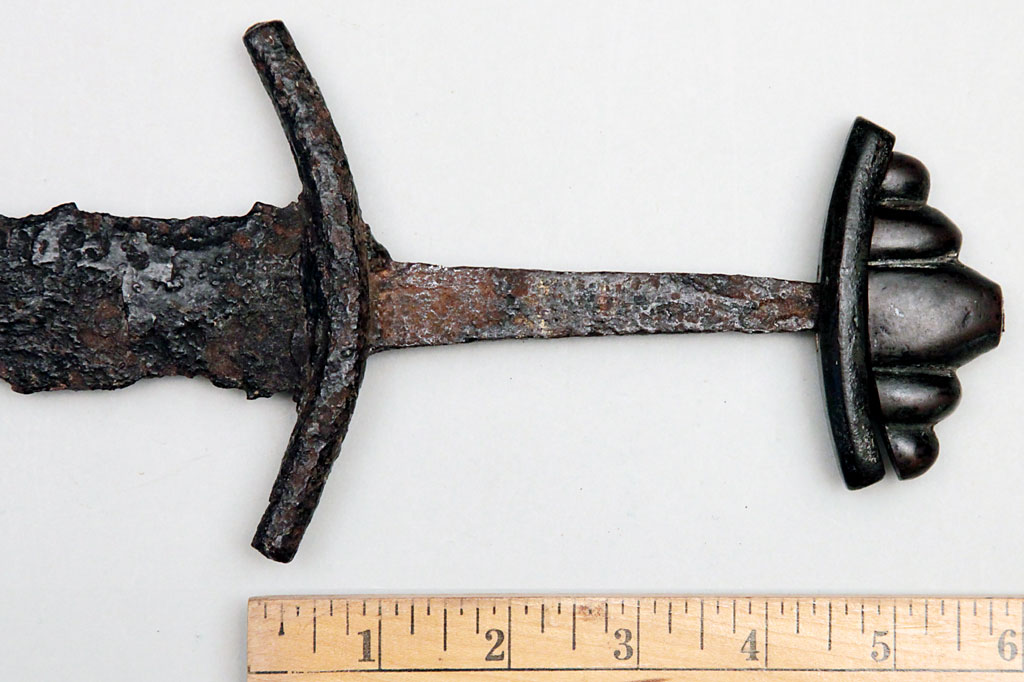

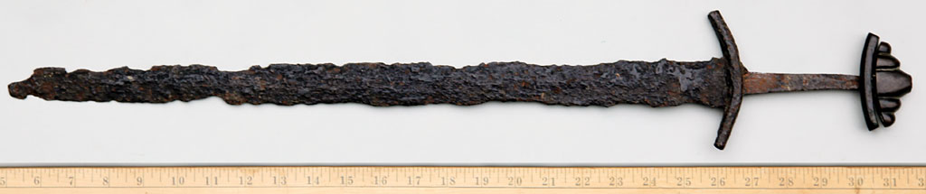

Here is what has been another mystery sword to me defying confident classification; I am beginning to suspect that it might also be Couronian.
Overall length is 26.6 inches in the present state with the blade remains being 21.25 inches of that and the weight being 531 grams.
The upper guard and five-lobed pommel are separate hollow bronze castings, now loose. The end of the tang does come through the top of the pommel where the tang has been peened to retain it and there is a dominant central lobe. A 'mismatched' iron lower guard curves towards the blade. If the corrosion is hiding a fuller, then it must be quite shallow and the blade seems to be somewhat lenticular in cross section.
Again, your observations are welcomed!

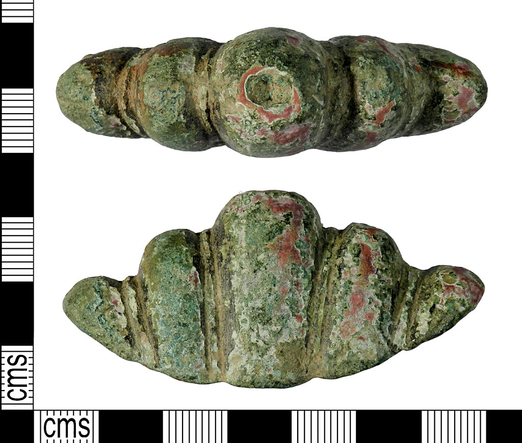

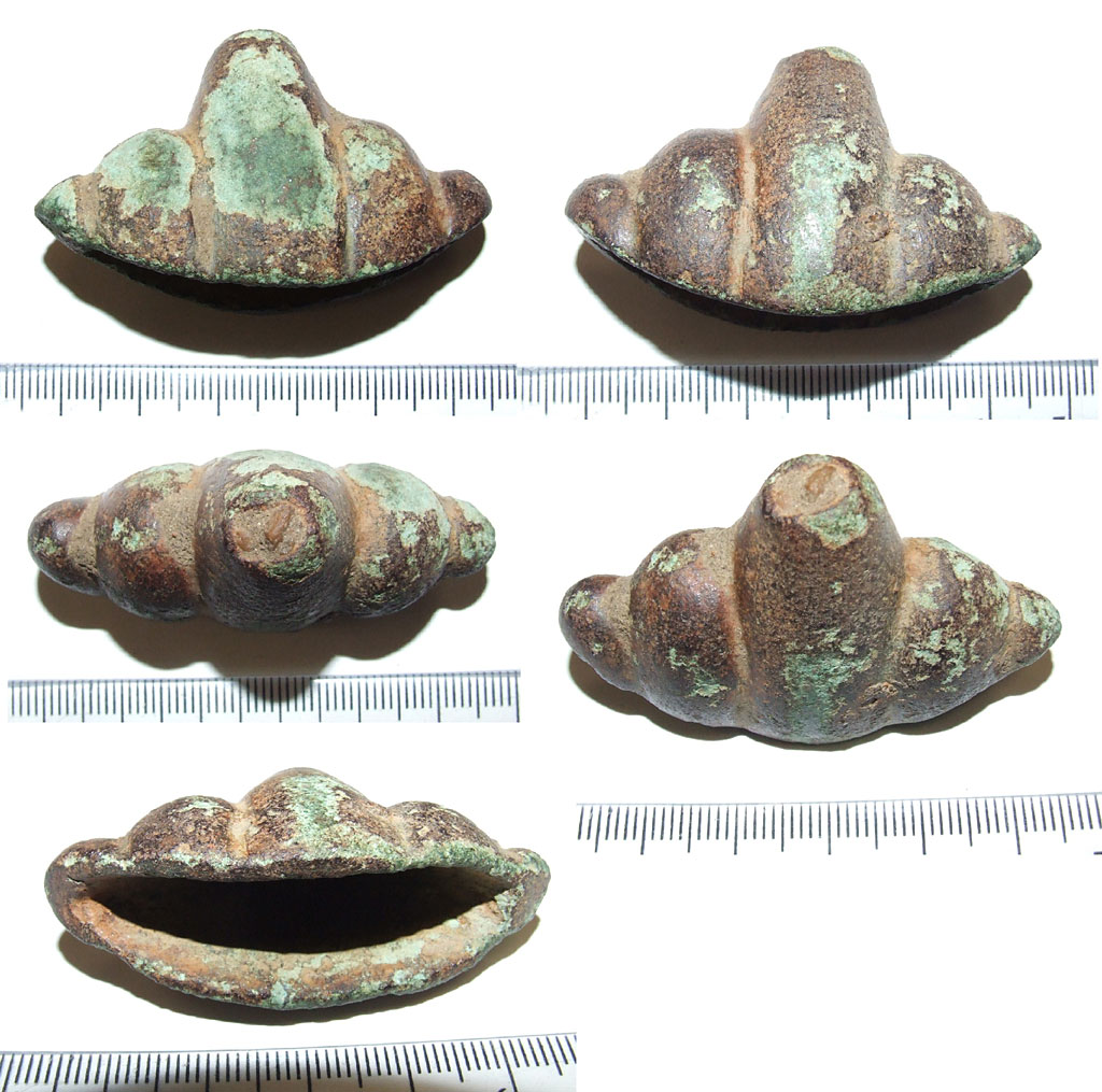

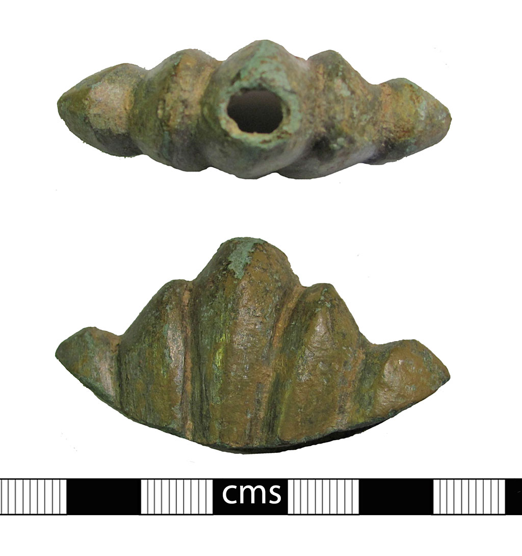

Below are links to a few stray pommel caps found in England that show the five-lobed form, curved at the base to fit the curved guards. These are the most similar in overall appearance that I could find, there is a great variety of other lobed shapes in the database.
https://finds.org.uk/database/artefa...cord/id/159321
https://finds.org.uk/database/artefa...cord/id/631548
https://finds.org.uk/database/artefa...cord/id/560059

Reventlov, I think you have made some very good points. These bronze pommel variants of Wheeler VI do indeed resemble the sword presently under consideration.
They vary a bit from my expectations for Petersen type L hilts, as those that I have knowingly encountered have relied on rivets from the upper guard to attach the (often lost) pommel.
As the British Museum kindly allows distribution of the images in their Portable Antiquities Scheme under a Creative Commons BY licence, I have attached reduced size versions of them below for convenience.

Reventlov's recognition above of pommel features in common with documented English isolated finds may very well have initiated recognition of a new localized British variant of Viking Age sword.
This type appears to be characterized by:
  • A hollow pommel of cast copper alloy...
  • with five lobes, the central being dominant...
  • that is secured by an exposed peened tang at the top of the central lobe.
  • An upper guard (pommel bar) curving away from the grip...
  • and an oppositely but similarly curved cross guard.
On the basis of the curved guards, this type most closely resembles Peterson's type L or Z while the dominant central lobe recalls type S.
Tomáš Vlasatý has prepared an excellent detailed analysis of this sword comparing it with similar examples and also reviewing where it stands within several classification systems.

Reventlov, I must agree with your opinion that related but different types with opposing curved guards have perhaps unfortunately come to be included into Petersen's type L. Mr. Peirce and I were not the first offenders, but we did perpetuate the practice.
Looking at the illustrations in Petersen, it is obvious that his type L corresponds to what Wheeler would refer to as type V (5) or the Wallingford [sic, see Jim's note above] type. Petersen's distinctive type 7 (fig 77) seems the closest that his Norwegian material comes to Wheeler's type VI (6) that Wheeler surmised was of 'Danish' origin, but well represented in England.
This present group with similar, but clearly some distinctively different features, such as cast copper alloy five lobed pommels secured by an exposed peened tang at the top of the pommel, appears at this point to be yet another localized English variation. Perhaps we may call it 'Wheeler type VIa' until the academics properly define and definitively name it?
British sword blades of the Viking Age were probably frequently of local manufacture, based on recognizable differences from those made elsewhere in Europe (see Lang & Ager, 1989). Obviously the blade of this sword is in very poor condition, but even so it has a lenticular cross section (actually not unknown in the literature, even if initially confusing to me) without evidence of a fuller and, on the surface, it is also without evidence of pattern-welding or iron inlays. I wonder if this suggests a later date within or just after the Viking Age (as indicated by the dating given for many of the pommels)? Hopefully more examples of this type with blades will surface in due course. Tomáš' article on Petersen's type M swords notes that pattern-welded and inlaid blades were uncommonly mounted with that simple hilt type, and that this may have been a less expensive fully functional but still 'budget' style - perhaps that will prove to be the case with these.

A minor point of correction through clarification. It would not be a "copper alloy" but a "high-copper alloy". I know it's barely relevant and doesn't seem all that important but there is a difference. Which is useful to recognize.
Copper alloys are those which contain any amount of copper but for which copper is not necessarily the primary material (such as pewter or monel). These are often also called by their principle component. Such as monel being a nickle alloy. But not always. As in with the case of pewter being categorized as a copper alloy even though a true pewter is primarily tin (true pewters are basically a reverse bronze).
High-copper alloys (such as brass or bronze) contain mostly copper with some secondary and often tertiary material (especially in older specimens the tertiary material is often an undesirable impurity that is tolerated for lack of knowledge on how to eliminate it, such as arsenic, phosphorous, or sulfur).
It's a cladistic thing in the classification of alloyed metal products (i.e. All high-copper alloys are copper alloys; Not all copper alloys are high-copper alloys).
Additionally I would say that the over all red-sh patina with gray to white oxidization in the low points, that are somewhat green or green sheen in certain spots and from different angles, makes it fairly safe to call this a true bronze (if we're interested in being more specific than asserting it as a copper/high-copper alloy). While both zinc and tin may oxidize as white. Only tin also phases more into gray and sulfates as a blueish-green. Which can produce the white from some angles and slightly greenish tinge from others. As can be seen in the OP's set of images.
This indicates the alloy being majorly comprised of copper with a low percentage by weight of tin. I would also say that the second images provided of a very similar pommel have corrosion characteristics of arsenic-copper. It may still be a true bronze. But the source for the copper or in that case may have had a fair amount of arsenic contamination. Back then they wouldn't have been all that good at working such impurities out.
To be clear that doesn't mean that these can't be the same typo-logically. Just that there was a bad luck of the draw with one in smelting. But these are somewhat different alloys. Though likely made via the same process. Back then one just couldn't control as tightly as we can today even following the exact same prescription.
I mention this bit because people seem to have a tendency to think that the differences in patina between presumed same materials are down to preservation conditions. But unless we're contrasting say an ocean wreck recovery vs. a shallow dirt-dug recovery, this really is rarely the case. At least in coloration, same materials tend to corrode the same. It takes fairly drastically different conditions to get fairly drastically different patinas.
