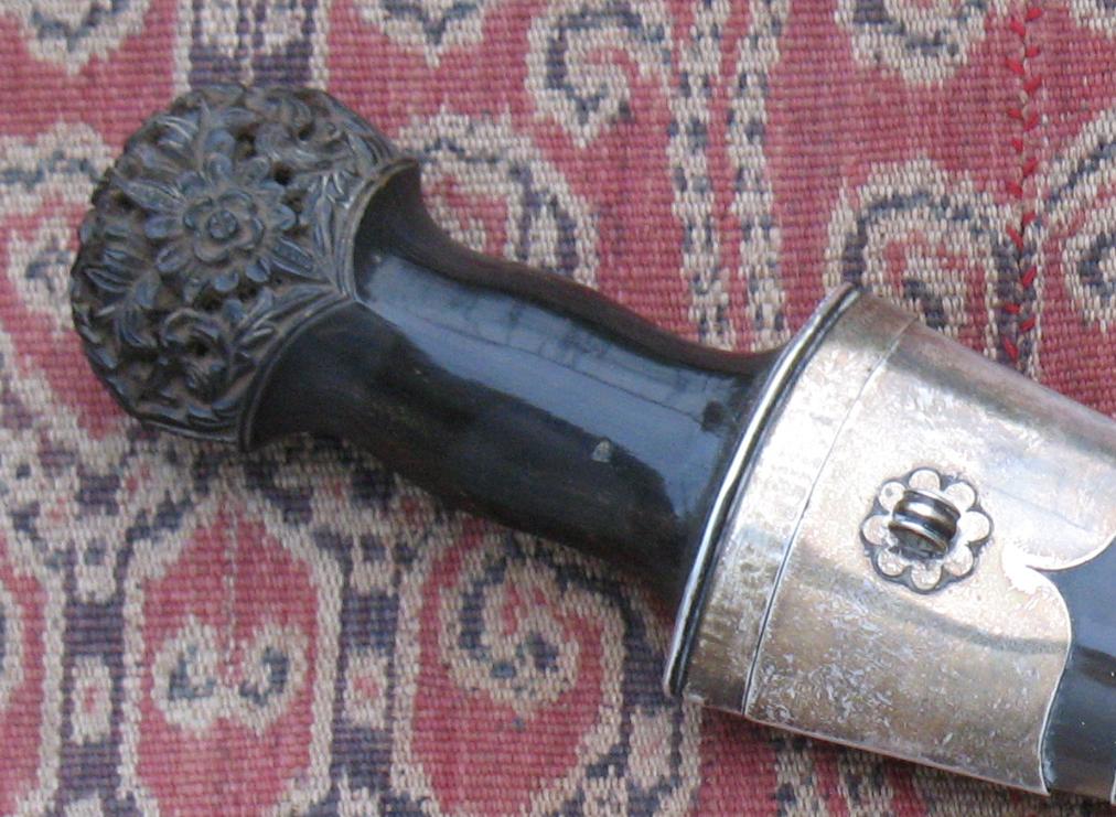

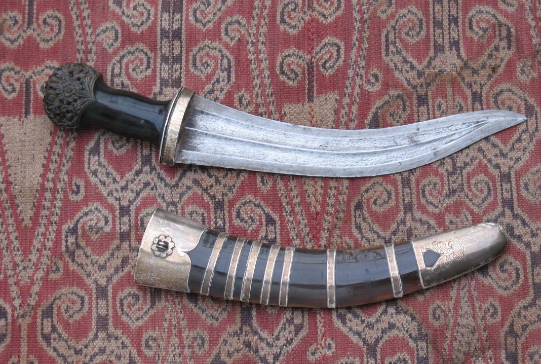

Here is a nice old Dayak dagger, but in my mind it is a "Dayak jambiya", and I am wondering with the curvature if it classifies, technically, as a sadop??
What think you VVV??

My two cents... I would classify it as a Beladau as the Dayak jambiya is called.
Very nice example.

According to Juynboll & Co the Sadop has a straight, triangular blade.
In van Z it's quoted from Holstein that it also could have a slightly curved blade.
But when I read Holstein (p.244-245 in ...Tome Premier Études) I can't find anything else than that it is supposed to have a straight blade?

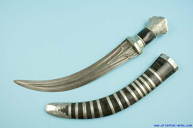

If it's curved it's either a Beladau/Baladau or a Jambiya/Djambieh.
Yours is according to my understanding a Malay Baladau from south-east Borneo.
If it would have had a more curved blade it would have been a Malay Jambiya.

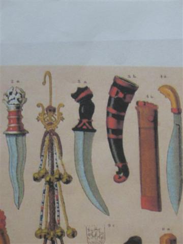

Hi Michael,
When I look at the pictures of Schmeltz, I see a similar picture of a dagger Charless has and there it is called a "Djoembia".
It looks like the same curved blade as seen above. (Taf. XVIII, nr 3a & 3b).
Maurice

Hi Maurice,
Have you also noticed that the Sadop on Taf. XVII fig. 1 is called Baladau lebar?
I assume that that the Baladau was called Djembiah by some people and some other people kept the names apart?
Just like if you ask people today what things are called and you get several different answers for the same item.
It's probably only important with "strict names" for collectors, scientists and people who buy, or ask for, something from a distance?
