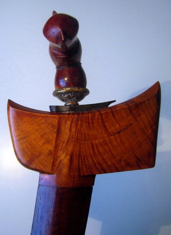

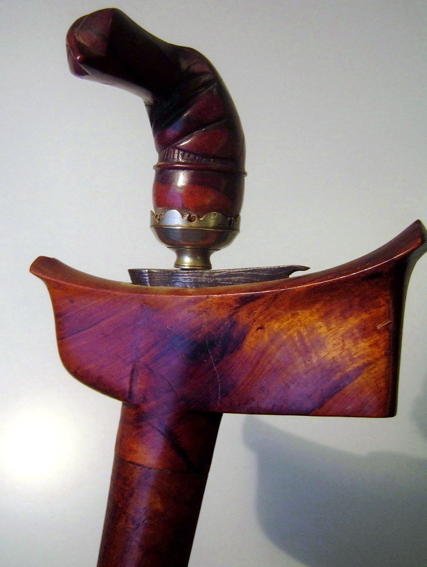

Keris Terengganu Pipit Teleng
http://www.kampungnet.com.sg/modules...view_album.php
Keris Bugis Sampir Penghulu (Sumatran or Malaysian?)

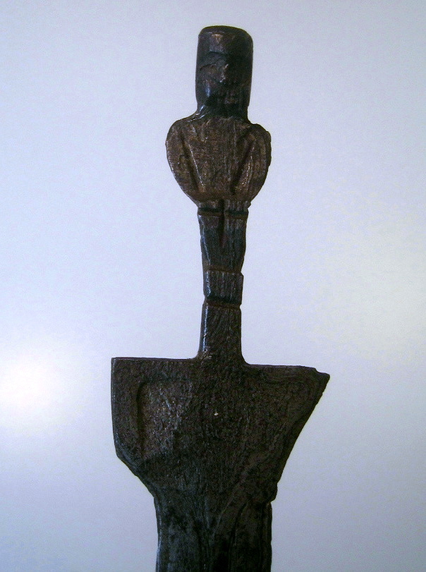

Keris Sajen Luk

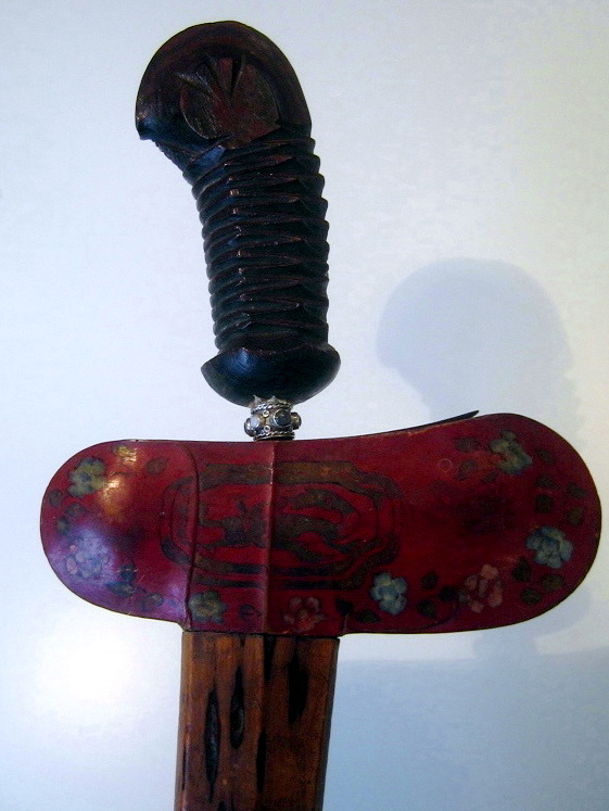

Keris Bali with painted sheath and unusual hilt.

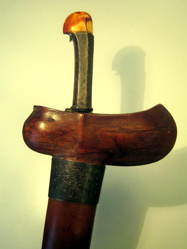

Kalis Taluseko Sulu with Javanese resembling sheath

Hi Michael, all these pieces are beautiful, but the kalis is very elegant!!! Congratulations dear friend

I also agree that the Kalis is beautiful. Given it's greneng pattern and the very Indonesian sheath i wonder about the Sulu attribution.

Posts: 4,747
Michael:
That Kalis Sulu is beautiful. The ivory kakatua is considerably smaller than most. Do you have any idea where this one originated? I'm wondering if it came from Brunei or Malaysia because it is somewhat atypical for a traditional Moro kris.
Lovely pieces all.

Thanks Ian,
I suspect that it maybe could come from NW Borneo based on the motifs on the silver band. But that's just a guess and I still think it's Sulu.
Please convince me if that's not the case?

Here are some additional blade pictures. They are in the same order as above. In case you want to watch them "the proper way" please go to Kampungnet or turn them in your viewer.
PS Something strange happened when uploading?
The order is now Sajen, Bugis, Terengganu, Bali and Sulu(?).

Well, also the bali is wonderful!!!
Hi Michael:
The reason that I think it is odd for Sulu (that is, Moro) is the hilt: a smaller than average kakatua and the continuous silver wrap to the hilt which has an octagonal "tubular" apeparance. The usual form of Moro silver hilt dress would be circular or oval bands of silver that overlap. Also, there is a small "lip" to the silver handle sheath just above the gangya -- not commonlty seen on Moro weapons.
That said, there was a lot of interaction between the Sulu and Brunei Sultanates, so some diffusion of styles each way probably occurred. Indeed "Sulu" has sometimes been used to include Brunei, so we may be splitting hairs.
None of which alters the fact that it is a lovely kris.
Ian.

Hi Ian,
Thanks for your explanation.
I also find what you exemplify quite odd.
There is one Kris in Leiden, collected in Sulu, that looks like it has just as small pommel as mine.
It also looks like as if the hilt on the Kris "Andus" in E Banks article The Keris Sulok or Sundang, has an octagonal hilt (really dark pictures in that old article so hard to see for sure)?
And then I have this Kris in my collection, that I also thought was Sulu?
Maybe they are related?
On the lip I haven't found any other example yet with that feature?

Thanks Michael.
What I meant to say is that an octagonal hilt, per se, is not rare on Moro kris, but a continuous silver "sleeve" as shown in your first example above is something that I have not seen before. Perhaps I have just not seen enough high end beauties like these.
Your second example looks more traditional and appears to be a Mindanao kris, most likely Maranao -- the "elephant trunk" area is of the Maranao form (according to Cato). The octagonal handle is wrapped with silver wire to conform to the underlying shape of the handle, although the small band holding the baca baca is circular. The ivory kakatua is small but of traditional shape -- probably late 19th or early 20th C. but could be earlier. The scabbard fits with a Mindanao kris of around that period also. So this one looks a typical Moro kris all round, perhaps redressed around 1900 +/-. The blade looks considerably older than the hilt and scabbard.
The one at the top of the post still has me baffled as to where it originated.
