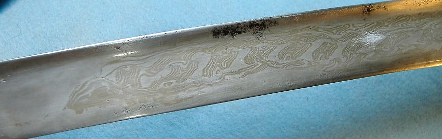

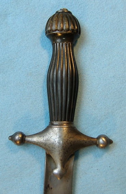

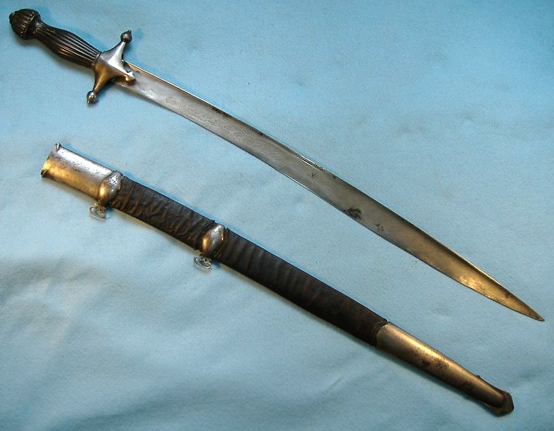

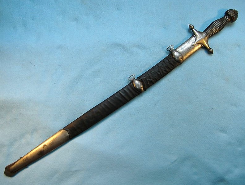

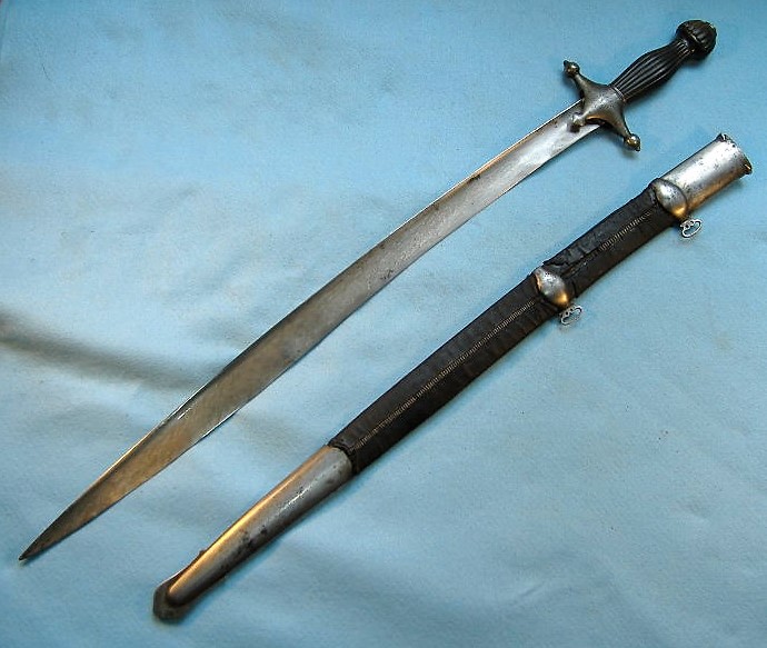

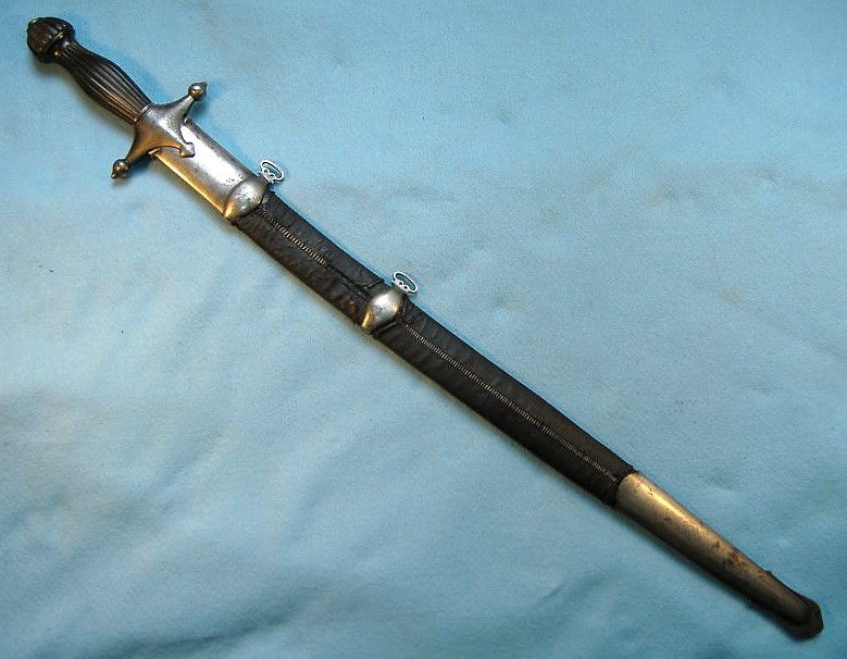

As many of you know, I love blades that show characteristics of cross-cultural construction and just when I think I have seen it all, inevitably I will find another that "takes the cake".
This yataghan is such an example.

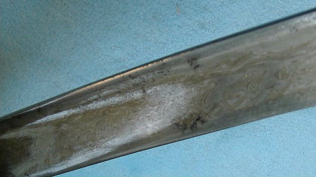

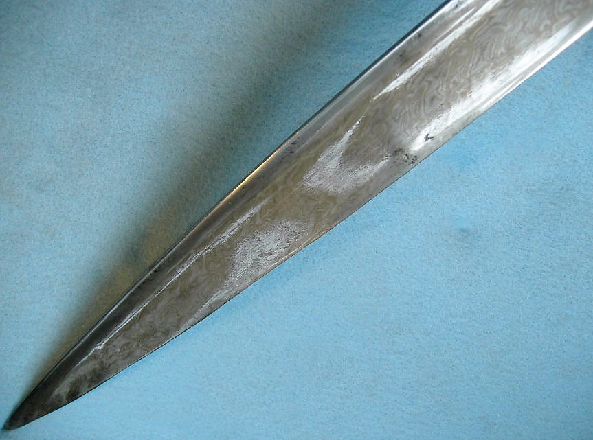

The yat's blade is almost certainly Ottoman Turkish with a "Turkish ribbon" twistcore that is very clear and defined, and starts at a rather far point from the forte. It has a common T-type spine.
It is not the blade that is so unusual, but the way it is mounted. The scabbard looks to be a combination of Ottoman(steel wire stitching), Persian(steel baldric mounts), and western(chape) influence. Note, I and think rather oddly for this particular sword, the baldric would have suspended the sword edge up!
Then there is the hilt, which combines a Persian/European style guard with a clearly European style grip and pommel made from one piece of carved horn.
The parts here are so inconsistent one would be easily tempted to assume it was some recently cobbled together piece from someone who knew little or nothing about historically accurate swords, but look at all of it carefully and you can see it was all "born together" at some point, all parts clearly showing that that were made for each other and considerable and matching age. I'll call it a historical composite if you like!
I have no idea why these parts would have come together in this rather strange way and I welcome comments about this old oddity!

Quite likely a hunting sword assembled in Europe in the 18th-19th c. Not that rare, though not that common either. Try using "Pandour" as a search term, also "Naval Yataghan".
Old 19th September 2018, 02:23 AM   #3
Its handle reminds Indian Tulwar ones, and chape looks Afghani end of 19 century.
A chimera in any case.

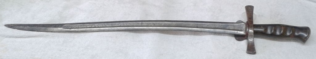

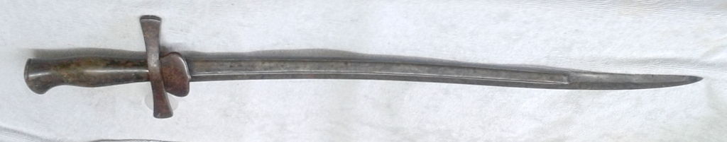

They do make nice hunting swords tho.
Mine is a bit lower class:
Old 19th September 2018, 11:42 AM   #5
I think it's a chassepot bayonnet...
I agree with Ariel, the chape is Afghani or at least Persian like the scabbard.
The quillons could be Ottoman, even the hilt... despite the European influences...
Then you have an Ottoman sword in a Persian scabbard...

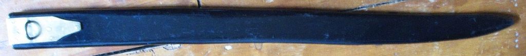

I know, as bayonets (I have one of those as well) the yataghan style was popular in many European countries in the mid to late 19c, including England. Mine is a French 1866 blade repurposed as a hunting sword. Fits the 1866 French all steel scabbard perfectly. Has it's own wood & brass one now tho.

Thanks for your input guys.
David, that is a great observation. I had completely forgotten about that "pandour" thread. We will never be able to prove it, but that makes sense.
Ariel, I am not quite sure how "chimera" fits here?
...yet the stitching style is very Ottoman, though the mounts may be Persian.

Posts: 6,012
The grip is kind of Chinese looking.

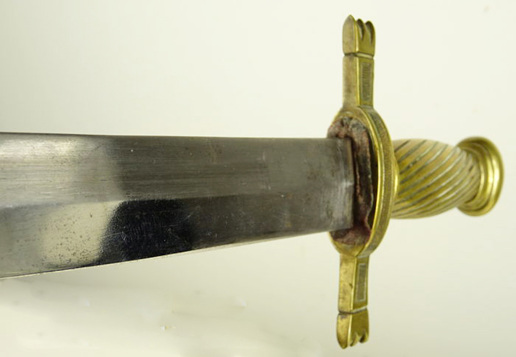

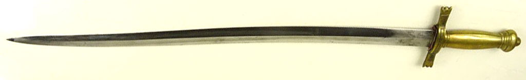

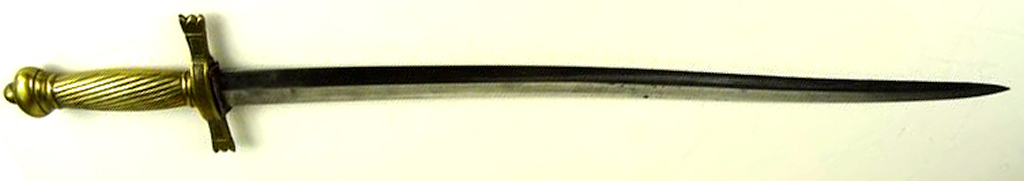

Another, Infantry Sidearm, now mine, cast brass hilt, Yataghan blade 58cm. of flattened diamond x-section, unfullered, brass hand grip grooved on the outer side, smooth on inner (to same uniform wear?). Seller thinks it is Russian or possibly Hungarian. Will check for other markings when it arrives.
