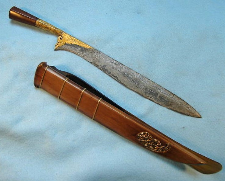

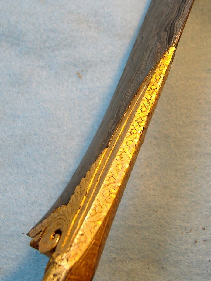

I picked up this wedong recently and wondered about its age...or lack thereof...

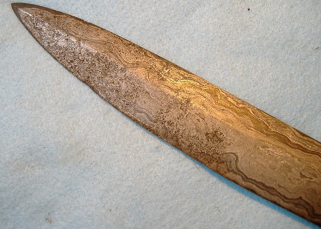

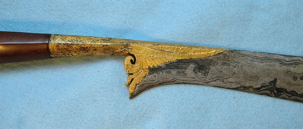

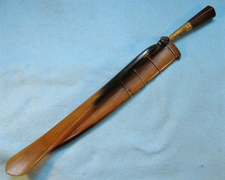

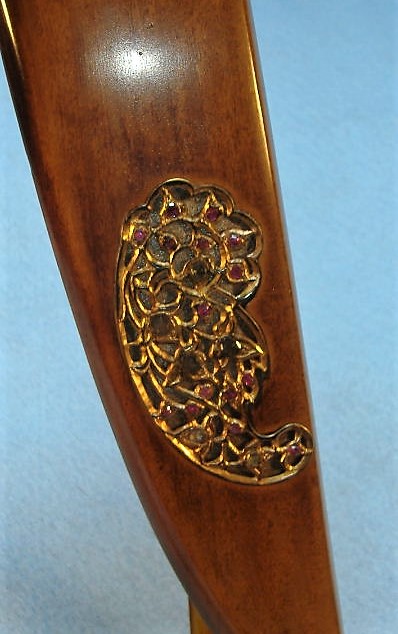

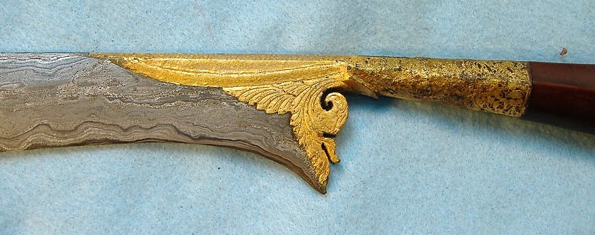

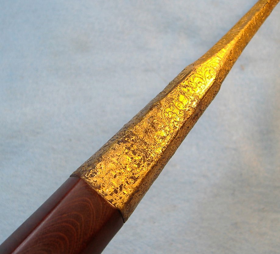

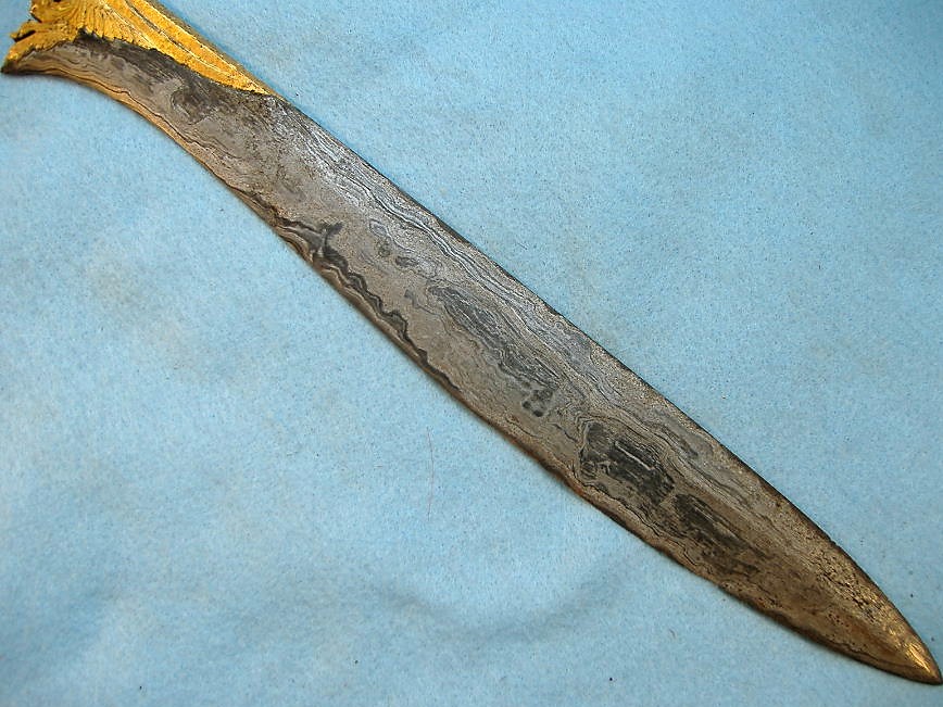

Whether old or more recent, I like it. The work is clearly of quality. The scabbard I would imagine is more recent, but beautifully and elegantly made with low-grade gold mounts to the horn belt attachment and an inset cartouche of gold-plated metal and low-grade gems. The blade is of a slightly unusual form for a wedong, being somewhat elongated and with less of a "belly". The hilt is beautiful wood with a gilded bolster that blends directly into the blade and it gilded forte. Along the spine, the gilded areas show a very nice pattern of floral motifs, quite worn on the exposed portion, less so on the portion protected by the scabbard. The blade shows some age around the tip, perhaps from acid washes.
So, gentleman, what have I got here...old? new? a little of both?
Dimensions:
Overall length, complete piece: 21.5in.
Blade length: 14in.
Blade's widest point: 1.5in.
Thickness at the top of the forte: .5in.

It looks to me as if it has been made from a keris or tombak blade, not necessarily a mark against it, it could well have been a pusaka that the original owner wanted as a part of his court dress.
Workmanship appears to be fine, everything that can be seen is correct and fine quality.
I would be inclined to accept it as having been made with the intention of wear as a part of court dress --- a wedung has no role outside of court dress.
Since the blade is pamor, and dress style seems to be Surakarta, it is possible that this wedung was originally made for a prince, the externally visible red stones in the scabbard ornament would seem to confirm this.
I doubt that it is particularly old, possibly late colonial era or even as late as the 1960's.
