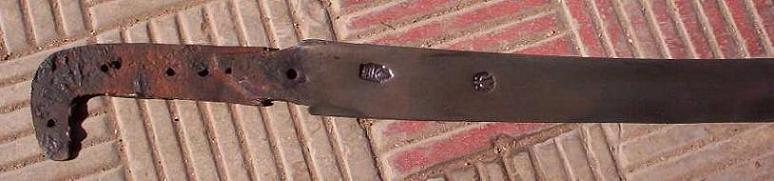

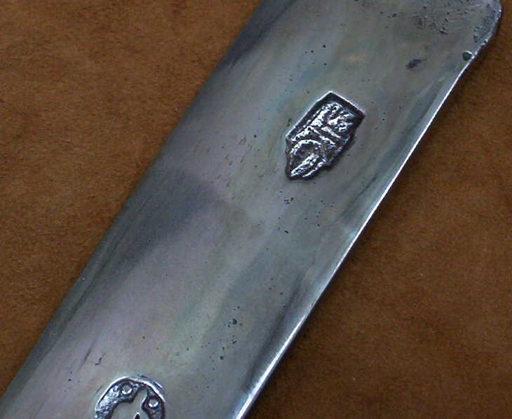

I've seen the similar stamp (on the left side) in one of the books, but can not remember anymore. I think it's an armory mark. What is/are they?

Hi Alex,
Both marks seem to be very deep. Is the mark to the right a katar?
Jens

Posts: 936
Jens, it is difficult to make that determination, but it looks like it is.

Posts: 1,099
The one stamp definitely looks to be a katar and the other stamp I believe is a trident. Unfortunately, cannot say if these are armoury marks, religious in nature, or what.

Posts: 2,718
Alex, I have seen at least one other blade on this forum with a katar mark, the problem is, that I don’t remember who showed it and when it was, but it looked very much like the one you show. So lets hope someone sees this and comes forward.
What does the whole sword look like? Do you have any close ups of the hilt?

... What does the whole sword look like? Do you have any close ups of the hilt?
Jens, I found this blade as a rusty piece of metal, without a hilt. It has been cleaned and polished and it appears to be of a low contrast pattern welded steel. I am inclined to say it is of an Indian origin, but it's just a distant quess.

Posts: 2,718
Alex, I think you can drop the ’inclined to say’. This blade is Indian, and I am glad you got it, and restored it. The interesting part now will be the digging, to find out from where in India it origins – happy digging. Should I find anything, rest assured that I will let you know.
Can we see the blade, just to see the form and the tang?
Could you also give us a close up of the katar?

Posts: 10,867
The mark on the left is a trident and this is seen on tulwar blades in the same location in the center, upper third of the blade usually. The later examples of this from 19th c. seem to have become more stylized and look more like a bird foot. I have seen early tulwar blades with this trident and in the upper forte near the hilt a cartouche usually stamped in Urdu script.

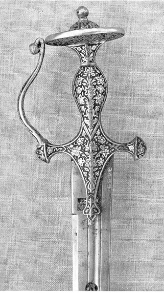

Jens, I think in Rawson there is a tulwar with the markings described but cannot recall what illustration it was. Also, in Egerton, it seems in the chapter concerning Gujerat, there is detail on a tribal group who have a great deal of traditional focus on the katar. It is said, if memory serves, that they swear oaths, legal matters etc. on the katar, and that any failure or 'breach of the contract' would compell the swearer, even unto suicide for such dishonor. I recall in research years ago that I had considered the possibility that such blades bearing the katar stamp may have had to do with this tribe. The reason I am suggesting this to you is in hopes you might find that reference in Egerton as I do not have access to it, and I would be interested in your opinion. Its horrible without the books !!
In most cases the tulwars these markings turn up on seem to be from Rajasthan regions, and I had also considered Sikh provenance but no convincing support for that has become known to me.

Hi Jens,
Thank you very much, that picture is the exact sword I was thinking of!!! I couldnt remember which source, but I've seen it in several places.

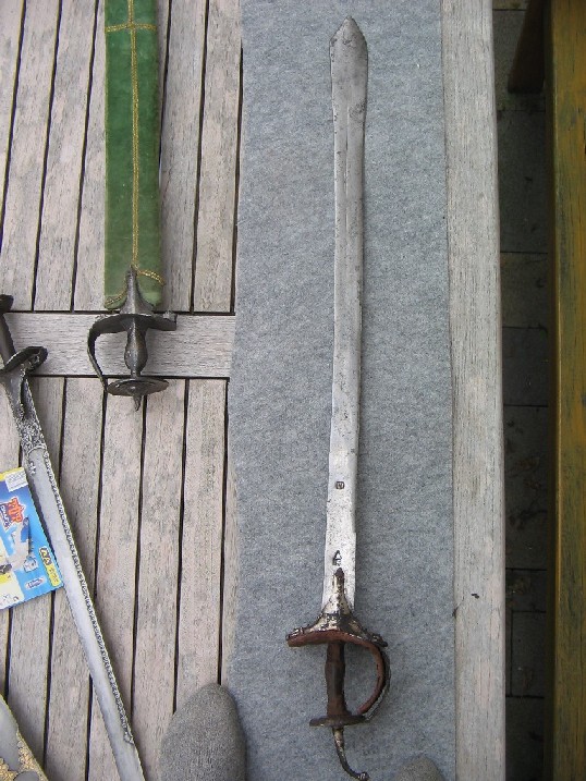

hi alex
please show me the complete sword blade!! (if you could ). i bought for one year also an indian sword( i don´t know if it is an khanda ore rather an patissa sword) with exactly the same stamps at the surface.i will make for you some pic, than can you see it and maybe someone from the sword forum can tell me what a kind of sword it is? you can find also such stamps at an khanda sword at the web site from gnwtc( great noth west trading company) in america. i think it was in the sword room 3 ore 4.

No need to apologize for your English....you're doing great and have explained your questions well. I am interested in your note that you saw this marking on some other website, and especially if it was on a khanda. Was this a reproduction weapon location?
Can you say more on the marking and weapon you saw ?
Alex,
I agree it would be good to see the overall weapon you have posted, could you show the whole sword.

First, thank you for sharing your research and creating a separate post with more information. Good idea and very well done too.

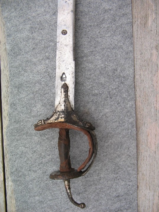

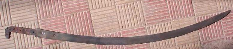

Stefan,
welcome to the Forum. Below I post more pictures of the blade. It is still in a sad shape, but it's much better than it was before:-)
I suspect this blade is a regular/standard tulwar blade, UNLESS the rare combination of two stamps makes it special:-)

Alex, thank you for the nice words, and thank you for the pictures, which adds to the size of the puzzle, as this blade had a shamshir hilt and not a tulwar hilt – just have a look at the form of the tang. Should I guess; then this is a shamshir made for a Hindu, due to the stamps, and this makes it a rare piece. To see one of the stamps is rare, but to see both stamps is even rarer. I asked a friend, who has seen more Indian blades than I will ever see. He did not know what the marks mean, but he said that he has seen the trisula about a dozen times, and the katar three to four times.

Posts: 936
Jens, thanks again for your comments. I think the blade was originally of a tulwar. Later it has been re-maked into a shamshir. The metal shamshir hilt core it crudely welded to the blade, so I think it is not an original hilt core.
I have several spare Indian steel hilts, so I think I'll make it a tulwar again:-)

Interesting ! Especially to see a new tang crudely welded to the blade.
