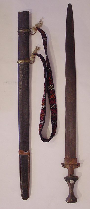

What do you think of this bizzar amalgamation. An Omani kattara scabbard with a Yemeni Jambiya hilt stuck on an interesting blade. I don't have it yet but its coming and I would be interested in any speculation on the blade.

This is an Omani kattara, of a very early type, as per Elgood, 17-18th century.
The pommel was broken off and the owner or some other %&$%#$@%^&$ stuck the handle of an Omani jambiya onto it. With a screw, no less....
The blade needs to be cleaned to look for any markings, but I would not be surprised to find it is Persian.
I wanted it so bad! Evidently, you wanted it more...
Well, having vented some steam (and a lot of it, as you see), congratulations!
Just do not forget to post the post-cleaning pics

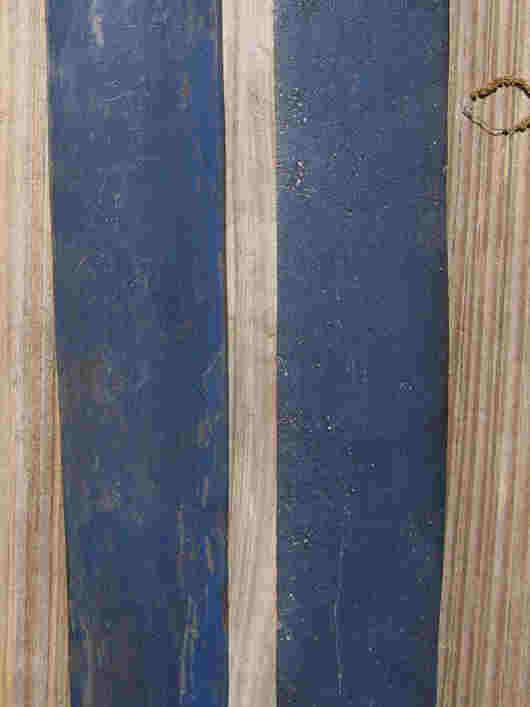

This sword came today. I don't see any markings. I think a see a pattern in the steel but I could be imagining things. Does anyone have a suggestion on how to clean it up?
Michael Blalock is offline   Reply With Quote
Old 18th May 2006, 06:25 AM   #14
WD-40 and Brillo pads?
Old 18th May 2006, 10:39 AM   #15
M.carter
M.carter's Avatar
Join Date: Jan 2005
Posts: 176
I saw this one, and was waiting until the auction would end so that I would post it here. This is a really strange kattara I must say, I would like to know more about these, because with that hilt, it looks really medieval arab to me.
I dont think the blade is persian, and without any fullers, I do not assume European either, most likely Omani.
Im getting increasingly fascinated with your collection Mike, it contains some very rare pieces, this one, including those Yemeni swords you have from before.
As Ariel said, some soak it in WD-40, then scrub with some brillo pads. Good luck!

Once I clean it I will post pictures. The scabbard was obviously never used for this sword. It's much to small. There are definately irregularities in the steel that indicate a primitive level of forging. The jambiya hilt that was attached with a screw also had silver buttons glued to the top of the screw. Does anyone need a jambiya handle that looks like it was used as a dog's chew toy?

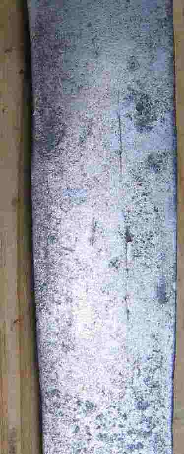

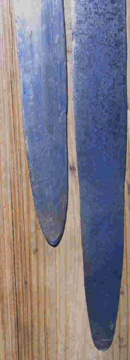

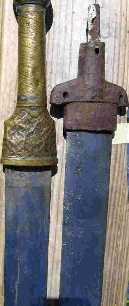

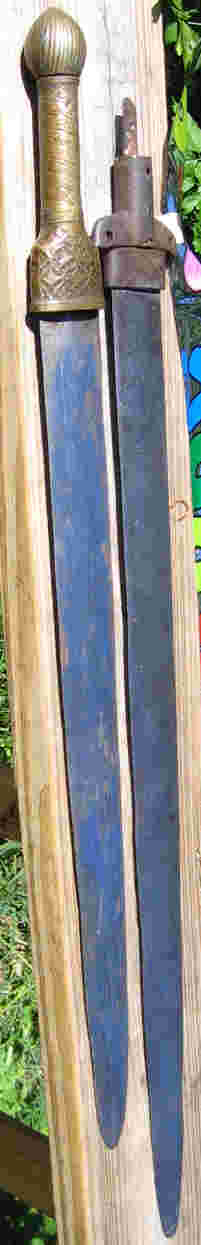

I think I may have over-cleaned the blade. The posted pictures are side-by-side with one of my Yemeni swords which has a very similar taper and similar forging flaws and cracks. I would say they were both made in southern Arabia.
