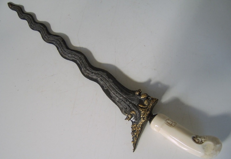

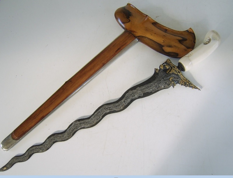

I know nothing about this type of keris with 'gold' decoration and most that I saw have been told to be of low quality touristy items.
Yet, I kind of attracted to this particular one. The bling is very understated and the hilt looks like it is made of a good material but what is it?

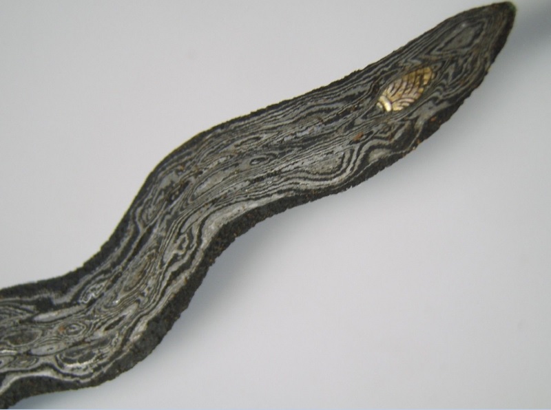

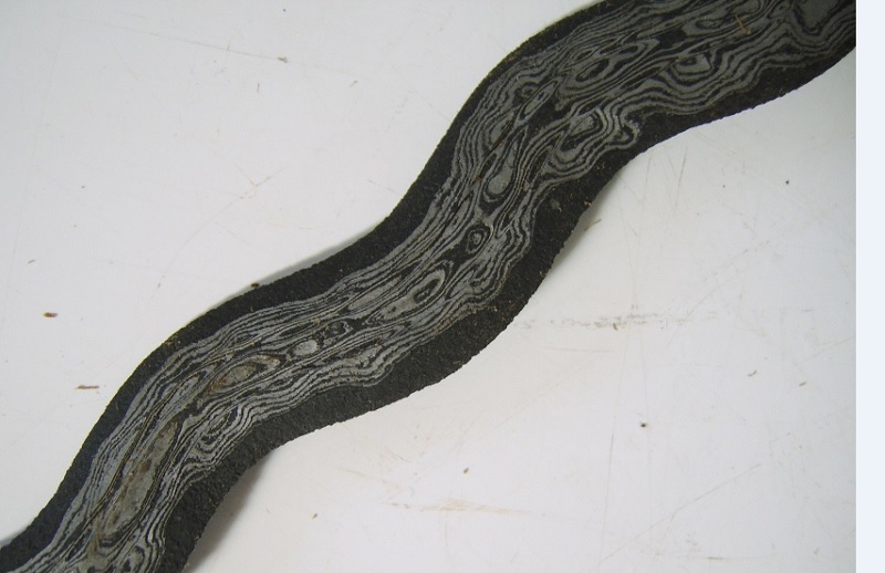

The pamor also looks fine to my still untrained eyes ( despite a few years looking at keris now).
Would love to know opinions on this keris . It went for a relatively low price on ebay last night... congrats to the winner (not me).

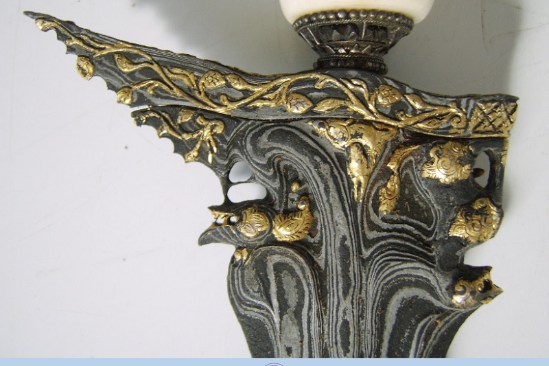

Well Green, i don't really know what you mean by tourist trap. This is a modern era art keris that dies seem to have at least some good craft applied. As such it is very collectable if that is within the realm of keris that one chooses to collect. But i don't know of any accepted dhapur that combines both the singo and naga motifs in a single blade so i don't see this keris as having any practical place within the social structure of Javanese keris culture, nor does the dress seem right for anything other than display.

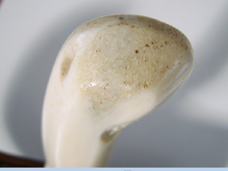

I am not sure what the hilt material is exactly. The spot at the top looks mineralized making me wonder if this is some kind of partly fossilized ivory, but i don't really know.

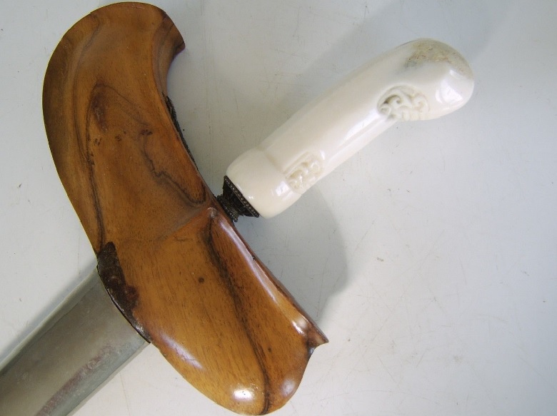

Agree with David. The hanlde is not a good match: a Yoygja model fitted on top of a Solo kris.

Yes, the blade is current era, nice quality, and would be totally acceptable as the blade used in a Javanese dress keris used by a person who was not involved in kraton or elite level society activities.
Yes, recognised dhapurs and relevant iconography can have a part in places where these things are understood, but Central Javanese dress is almost a national standard now in Indonesia, so you will find people in Jakarta and Surabaya, and even Bali,wearing a keris as a part of formal dress that does not really relate to Central Javanese kraton standards.
The incorrectly matched hilt is possibly the result of an ill informed dealer attempting to create an attractive and saleable item, but it could equally be the result of somebody who knows no better trying to be a bit blingy.
In any case, it cannot be thought of as one those rather mythical Tourist Keris.

Quite a nice kris indeed in spite of the mixing of the elements, from the pics the hilt seems to be made from walrus ivory (typical "marble" appearance inside).

While I cannot say anything about the kris itself, the hilt doesn't look marbled like walrus ivory to me. In my oppinion it is plain bone, displaying the usual porous structure.

Indeed Marius. While the porous structure is right on top it seems bone to me too. If we could see the bottom part, it would help.

One vote for Tridacna here...

Tridachna is very hard and brittle... it would be quite impossible to carve the intricate designs on this hilt i think...
Also, from my experience , the tridacna imperfections are small holes due to porosity effect...

Tridacna is a no IMHO, it has a dense structure. The picture is deceiving, it does not look that white in reality?
Besides, I think the Blewah is not matching either. It should not have pendok at all.

I think the hilt is made from fossil walrus ivory and in my opinion it is relative poorly made for Javanese standards.

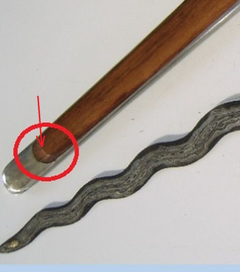

I found something remarkable on the Wranka. The Wranka seems too short for the blade, so the bottom of the Wranka was cut off and the point of the blade lies free. To hide this, they made a new elongated Pendok.
In my opinion the Wranka was not made for this Keris and is probably older than the blade.
Fossilized ivory of some sort is indeed a possible material Roland.
I am afraid i do not see any exposed blade at the tip of the sheath though. I do see different colored wood and what it looks like to me is that this is not this is not the original pendok for this gandar and there is now some exposed wood that was once covered by a different pendok. The gandar would probably be the easiest part of a sheath to replace if indeed the blade was too long for the original one so i can't image that someone would do a fix like you have suggested when they could simply add a longer gandar onto the sheath. The problem here seems to be that this pendok is too long and so will not slide up far enough to cover this part of the gandar.
Hello Marius,
The colour of the hilt at the base and the top, and the very smooth surface are not indicative of buffalo bone. If you have the book from Wolfgang Schilling "Faszination kris", you can refer to it. See another hilt specimen probably made from walrus ivory also (the top one).

I too think its walrus ivory, but perhaps bleached or at least treated chemically.

the wrongko is old, probably pre-WWII, the pendok is also old, definitely pre-WWII, it is made from mamas and is of a style that is exceptionally rare in post-WWII wrongkos, the pendok was not originally fitted to this gandar, the manner in which the wrongko + pendok has been presented is extremely amateurish, the imperfect fitting of pendok to gandar is totally unacceptable and makes this keris unable to be worn in polite society. Possibly the pendok may be able to be refitted in an acceptable way, but a far better solution would be to fit a pendok bunton. A cheaper fix would be to smooth and reduce the gandar and fit a velvet cover to the gandar, the colour for the velvet would need to match the kraton code.
I cannot see sufficient of the hilt to pass comment on the quality of workmanship. What I can see seems to indicate that craftsmanship is adequate, and compatible with the overall level of quality represented by the ensemble. The mendak appears to have some age and would probably test as silver.
The incorrect mating of hilt and wrongko I commented on in post #4.
My overall opinion is that it is a pretty decent keris, it needs a little bit of revision in presentation, but that is something extremely minor, and not really worthy of comment. What we can see here is the way keris are often bought once they appear on the market outside Jawa, or for that matter, even within Jawa when offered for sale by private people or non-specialist dealers. If it went cheap, whoever got it did well.

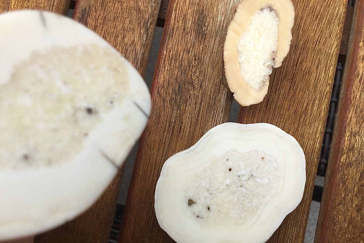

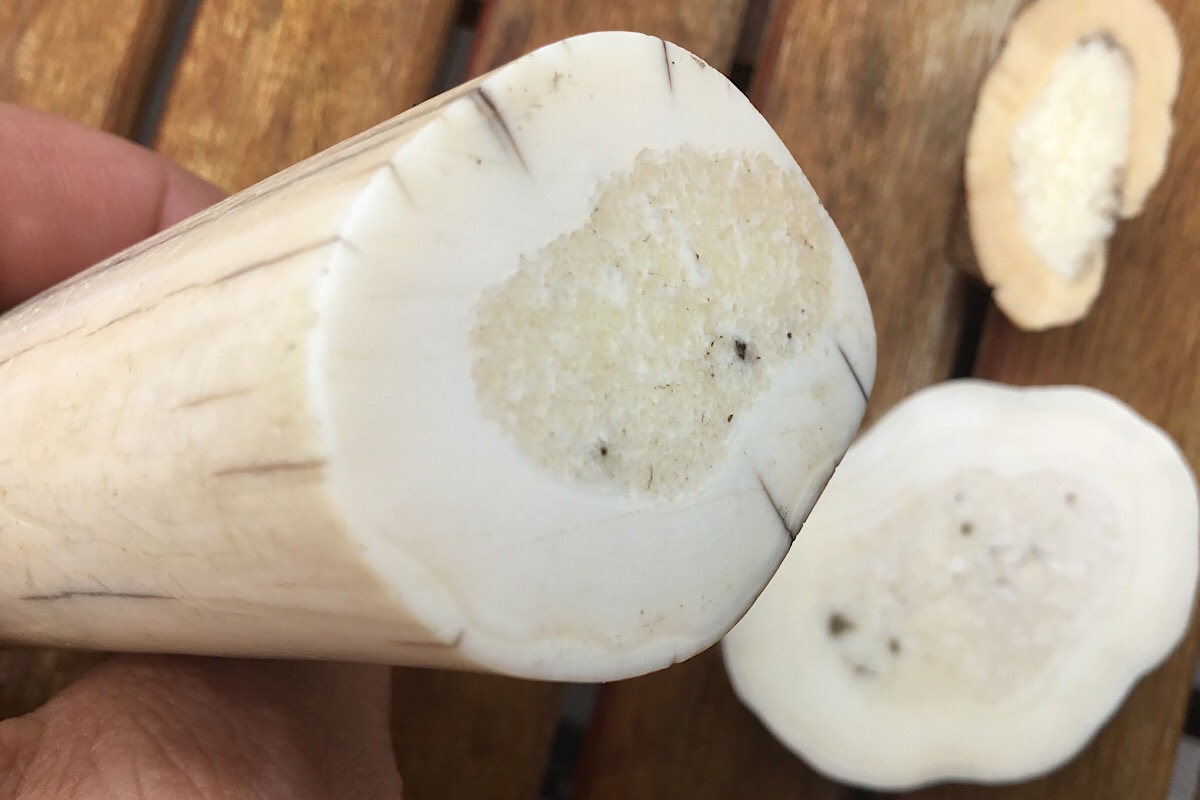

As a knifemaker I have worked with walrus ivory often in the past. So I‘m 100% sure that this is walrus. The prices for that kind of material are very high. It looks not very old but the prices for a piece of raw ivory of that size (with cites ) will be at around 300 $ or more. Not a material that somebody will use for a tourist trap
Just my opinion
Best Thomas
„Fresh“ and creamy, aged pieces

Thank you Thomas for the interesting pics and I support your opinion, we have learned something new about the identification of walrus ivory which is often wrongly attributed
