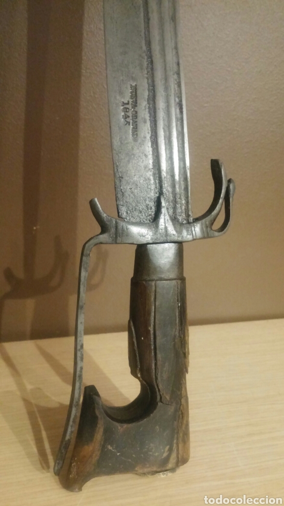

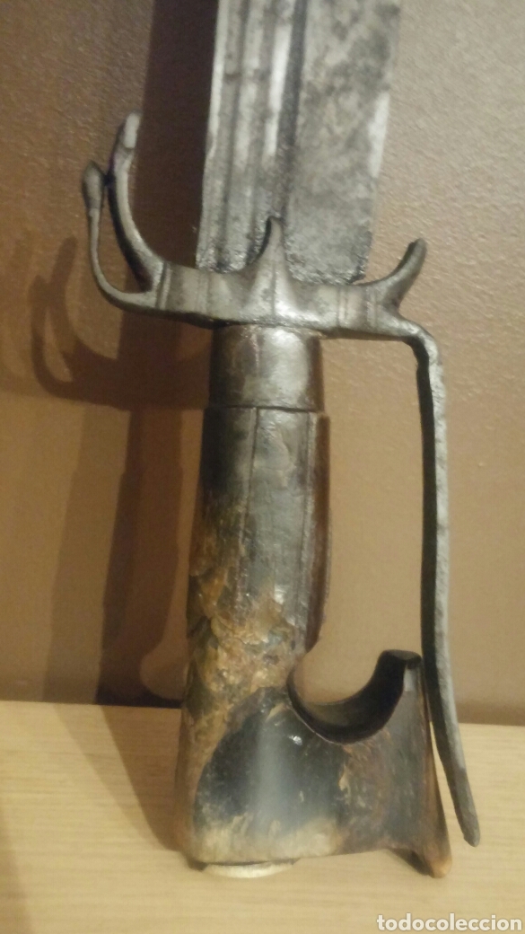

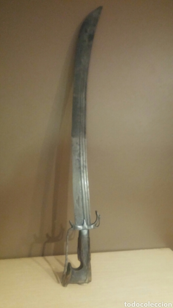

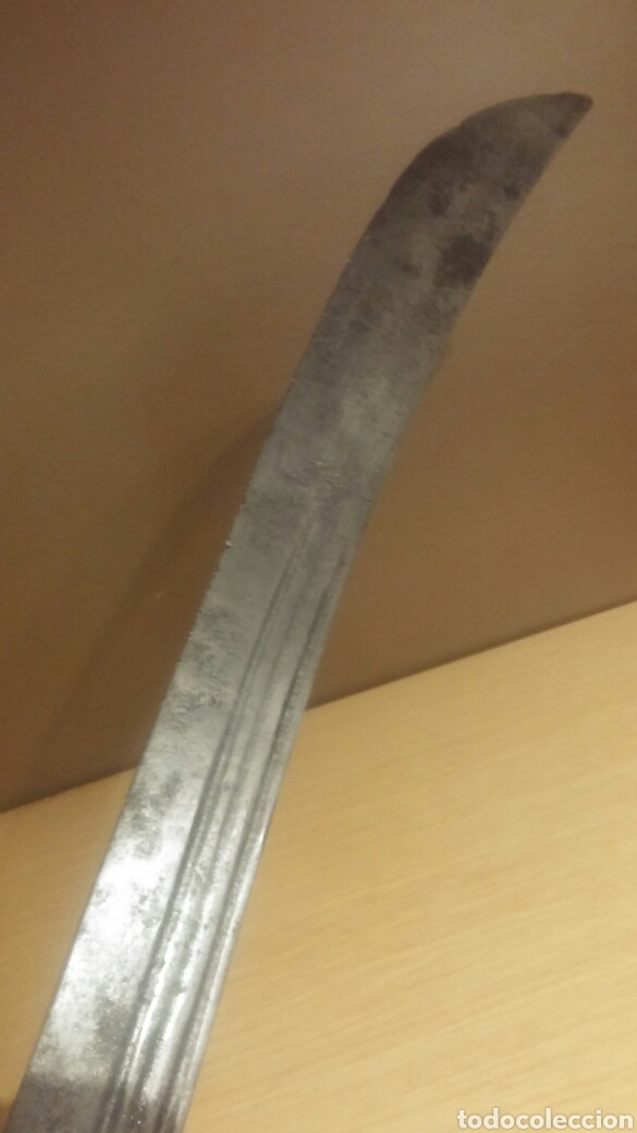

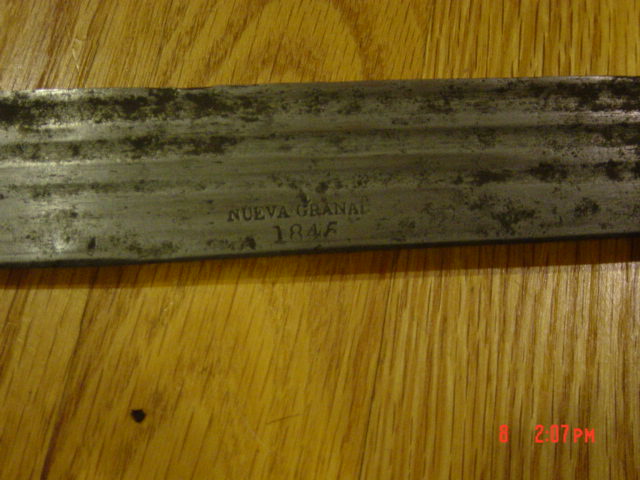

I have this thing traveling to me. The seller does not seem to know what a Nimcha is. Sorry for the pictures, they are the sellers, but I do not know when I will get the time for doing better ones.

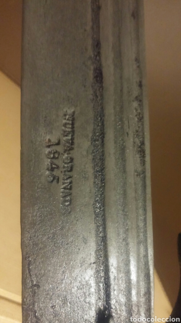

My idea for two days was how was possible an Algerian Nimcha could finish in a developing Colombia (Republica de Nueva Granada was its name between 1830 and 1858, with a couple of civil wars in between), where it became enroled and marked its state property.

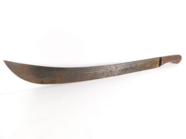

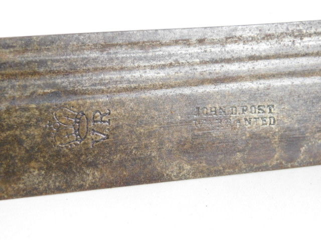

Then I saw the Victorian machete with VR below and realized that it was the other way around, Nueva Granada ordered machetes from UK or Germany, with its name and date, and somehow, one of them became the blade of a Nimcha.

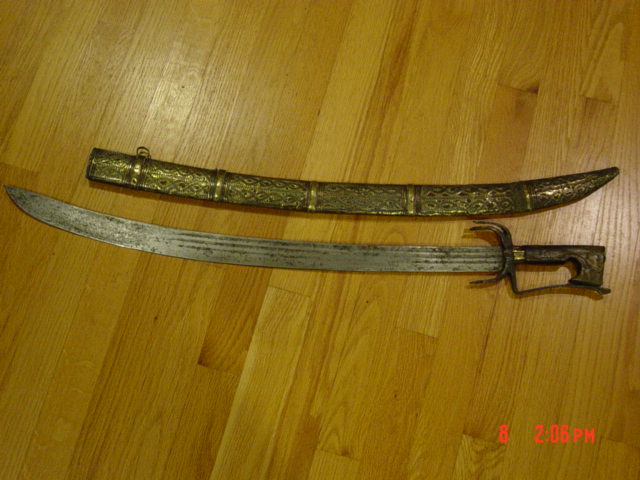

Then finally, I made the obvious search in google "Nueva Granada 1846 Nimcha" which unearthed a thread from this very forum dating from 2007, with a nimcha companion in it.
http://www.vikingsword.com/vb/showthread.php?t=4874
So, it was rather a batch of blades what landed in North Africa. Possibly the Novagranadians never paid for it and the maker found another buyer...
In a second thought, the Nimcha from 2007 has lost in comparison quite 1.5cm or more due possibly to sharpening, but the scabbard seems made for that breadth. Did it get a new scabbard sometime or was the blade like that when it became a Nimcha...

Your nimcha perfectly demonstrate that the so-called berber swords are berber swords (of course with a strong Spanish influence on the hilt).Thank you!

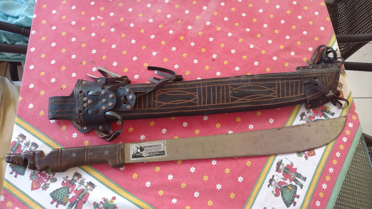

If I make a search for Berber saber in google images most of what I get I think are old Dominican machetes (without guard). There is some kind of degenerated involution (see below) under the trademark Promedoca. The older designs possibly did not survive the artisan family that made them.

The South American revolutions cut relations between Spain and its old colonies for a long time. At least at the official level. UK would try to occupy the best trade agreements. I do not think Nueva Granada would buy machetes from Spain in 1845. I think they are English, too early for Germany and design matches the so-called "Steamer machetes". I think the government of Nueva Granada asked to have that imprinted and not the maker logo, because it takes its place.

Nice nimcha, which demonstrates the diversity of blades that were mounted on Moroccan handles. Considering that we have seen examples ranging from 18th century backsword blades through a variety of European hangers all the way to French cavalry swords and even one potentially Indian made blade shown by Ariel earlier this year, it is not all that surprising at all to see a machete originally intended for South America end up with this hilt. As European merchants discovered, there was a huge market for blades in Africa (see Barth and earlier French merchant accounts quoted in the Nigerian Panoply), offering substantial profits for what were essentially surplus and antiquated blades elsewhere.
