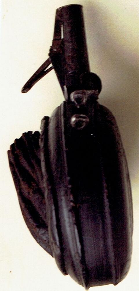

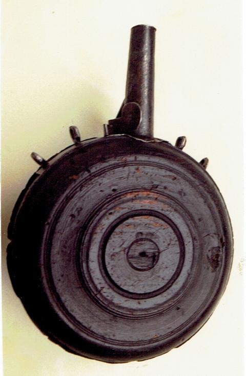

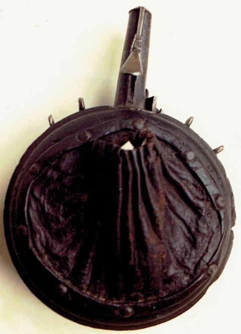

At an auction last weekend I was fortunate to acquire an early powder flask which generated very little interest when it came time to bid.
It is obviously old but I did not think it likely to be as early as the 16th Century as per the brief description. It has a small leather draw string bag on one side, this I at first thought to be for flints & I therefore thought it likely to be a flask for early flintlocks.
However having spend several hours perusing the excellent information that Michael "Matchlock" (R.I.P.) posted here on early powder flasks I find that this is indeed most likely 16th century & that the pouch would not therefore have been intended for flints, but for other small items.

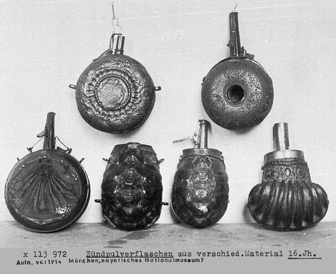

The info is however mainly about other shapes of flasks, such as Trapezoid & although Michael most tantalizingly showed a photo of an almost identical flask (see 2nd photo) in a collection (his I assume) I have been unable to locate any discussion about it. I would like to learn what country of origin is most likely & also if for military as opposed to sporting use & any narrowing of the date range would be very nice.
Does anyone recall having seen one of these discussed before or able to help with info in any way please?

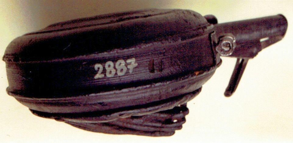

Until some years ago I had in my collection this powderflask which probably is very similar to the piece shown. The number "2887" says that it was in earlier times an item of the Austrian "Landeszeughaus" of Graz.
corrado26

Thank you for posting that, all three examples are indeed very similar.

Adrian,
A very interesting and rare flask! It has to be from the same area and time as that of Michael and Corrado. Wonderful piece of history!
It is so similar that I think we can say identical, so very likely from the same 'home'.
I think somewhere I saw some of these posted by Michael.
Would the search be under bullet bag/pouch or something?
Can you please give us the dimensions? also, I presume a measure was used to gauge the correct amount of powder, and that the flask has the spring-loaded cap only.
We do not often see items of this age. thank you for showing it!
R.

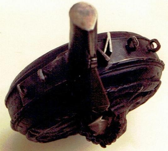

Hi Richard, thank you for your input & comments. The body is 130mm diameter & the spout is 57mm long.
It has a spring loaded cap & also it has a spring loaded shut off below the base of the spout. In reading Riling's "Powder Flask" book he describes this arrangement & attributes flasks with this double shut off system as being, logically, transitional between early flasks with a spout cap (one step up from a removable spout plug) & flasks with a shut off, a system so successful it is still used today. Both functions on my example have completely seized up, though I am sure that this could be remedied with a penetrating lubricant & TLC.
Michael showed quite a few examples of trapezoid flasks with this double system.
It is undeniable that the spring loaded cap is unnecessary when there is a base shut off - & it would have been an added expense. I speculate that it survived in use as a safety cap, to prevent a spark falling into the open & vertical spout, & as a measure of wet weather protection. Once powder horns, which hang horizontally, superseded powder flasks that hang vertically, any need for a safety/weather cap was greatly diminished.
