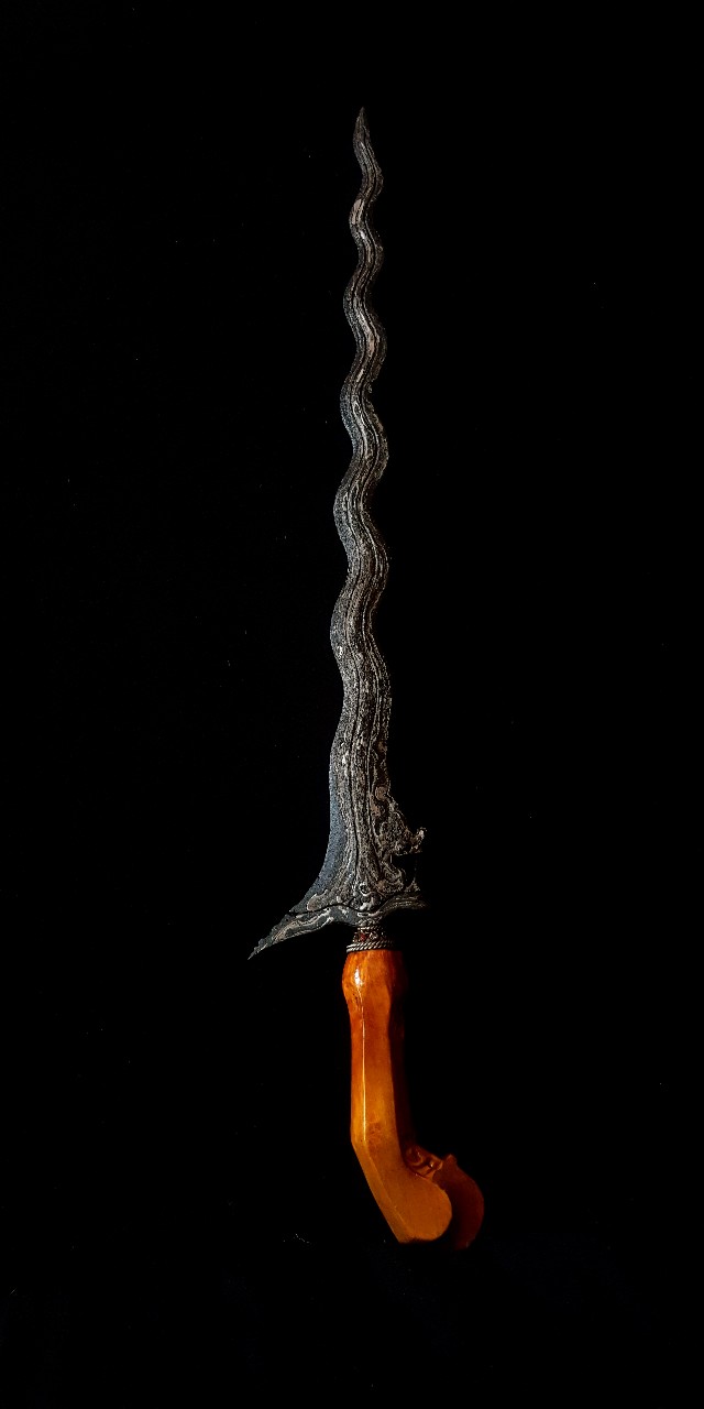

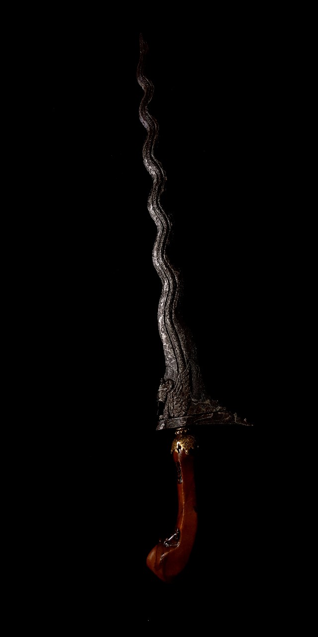

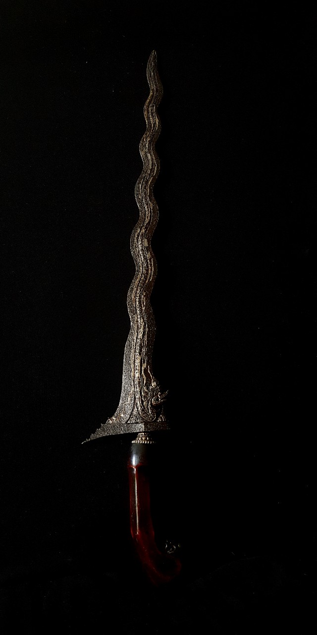

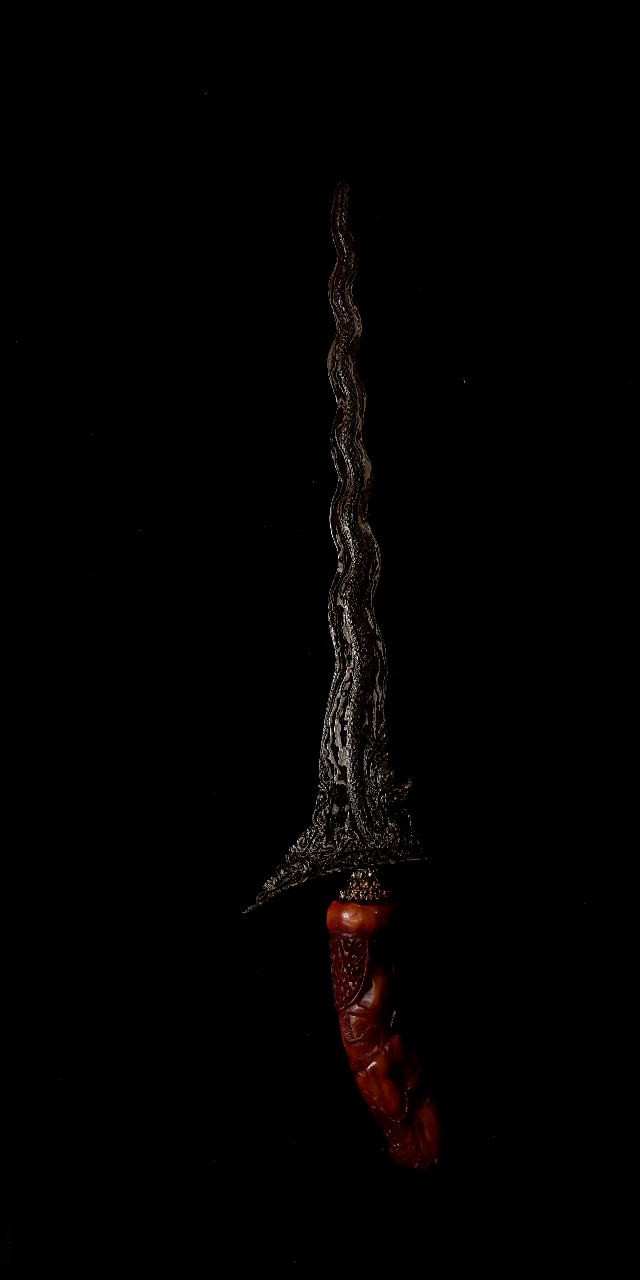

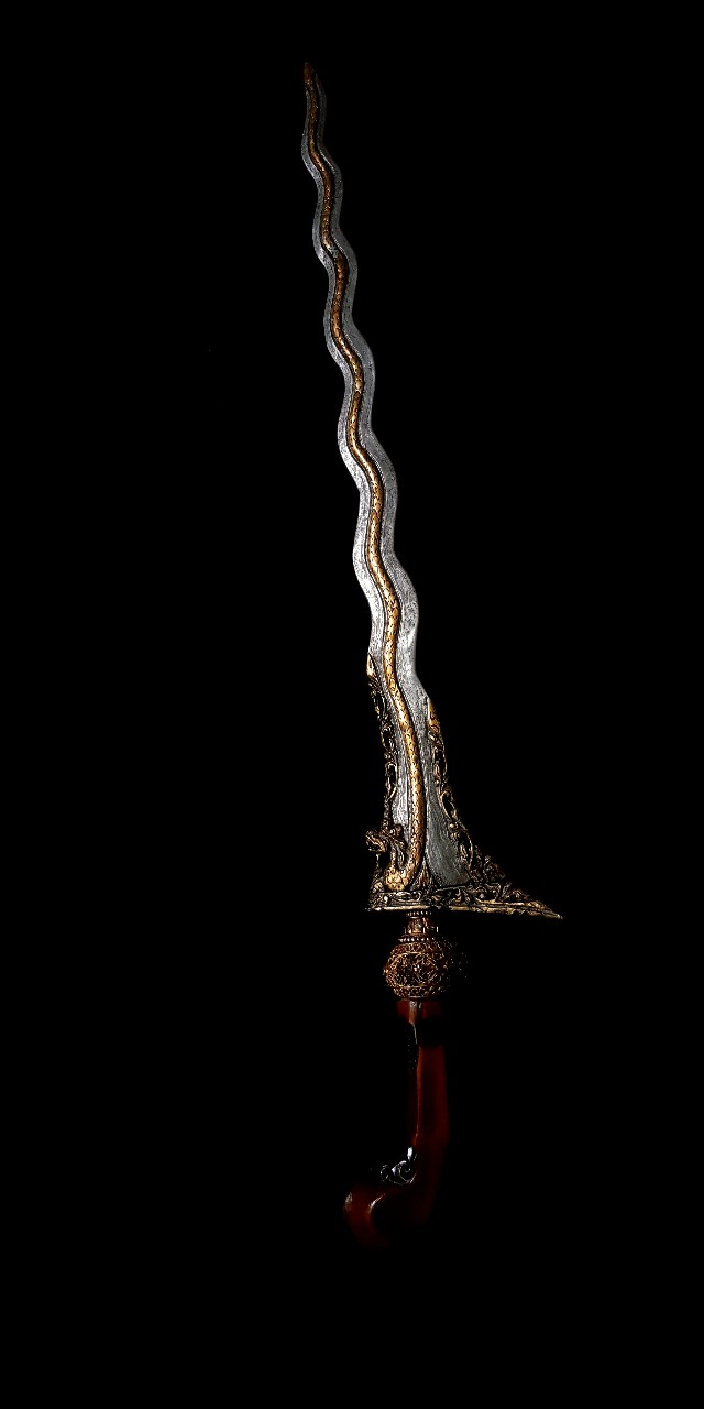

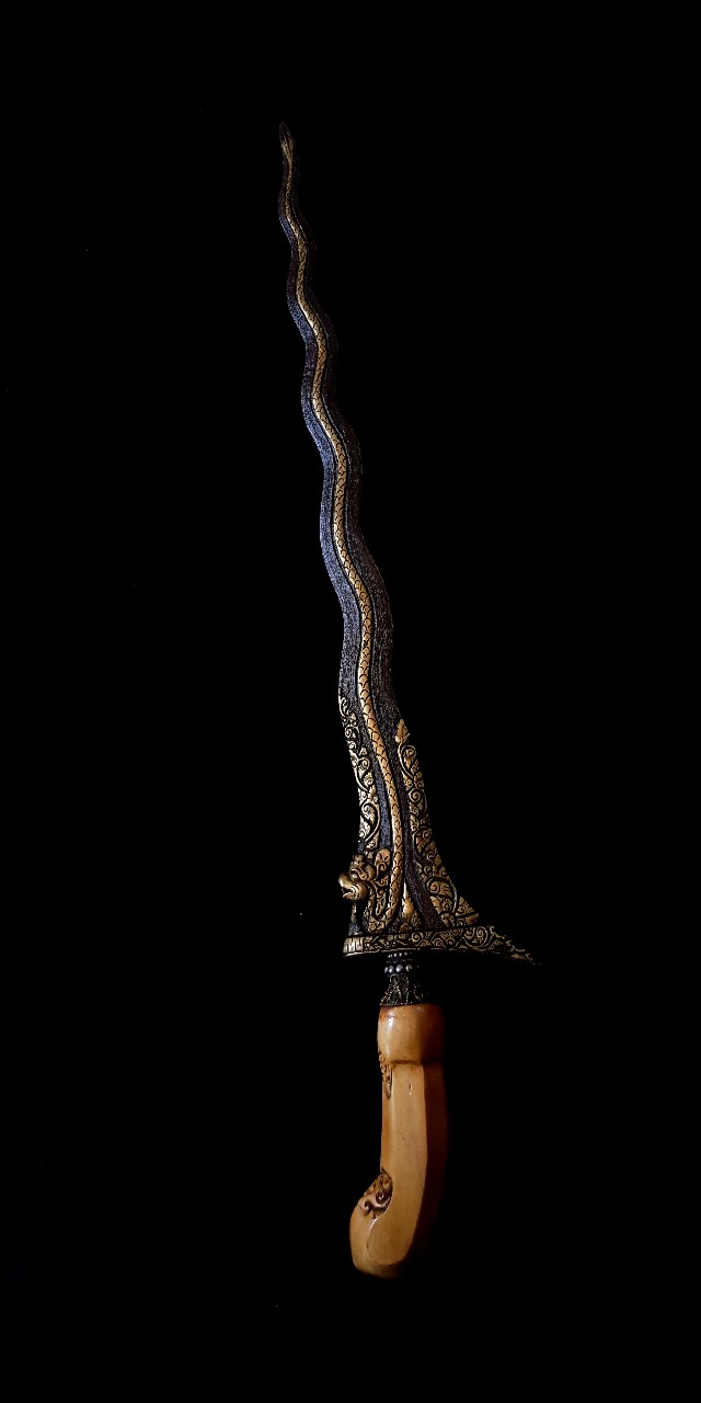

Hi Forum.
I really need your advice and comment. Which one of those keris with gandik Naga ornament is fake(not old keris)?
Thank you all

As Rick suggested in another thread, we need better photgraphs.
Also, i would not use the word "fake" to describe newer keris unless they are being presented to you as antiques. Even then the intention of the maker probably was not to create a "fake".

Instead of fake, may I suggest that you make your question more concrete, e.g. which of these keris are kemardikan? Or which of these keris are older than the 19th century?

Originally Posted by ridho pulungan
Owh ya..sorry for the picture David. I'll soon post more clear picture. Amd forgive me to use a word 'fake'. Is that any suggestion how to edit the titlle and my post?.if its a way to edit,i'll change it. Thank you so much for your attention.
Regards.
I changed the title for you Ridho.
Thank you so much for your help David.
I make a litlle change to the picture. I know its not perfect enough,but i hope the new pict can give Rick more clear about the keris. I really want to take another picture with new angle and lighting soon.

I think using a neutral gray and not a black background will make things clearer; also photos taken in outside light will much improve things.

Yes Rick, I agree 100%.
Neutral grey back cloth, natural light in open shade, light from the south in the Southern Hemisphere, from the north in the Northern Hemisphere, bounce boards to throw light as compensation for the shade, avoid big apertures, maybe 3 or 4 F stops smaller than biggest aperture, tripod and time release or remote release if possible.
Alternatively, full auto with the flash deactivated and full natural light, avoid direct sunlight. With a point and shoot this will normally give something usable.
As a minimum, in processing:- resize for net use, remove cyan,sharpen (unsharp mask)
