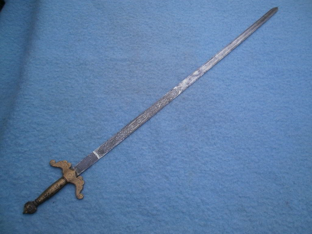

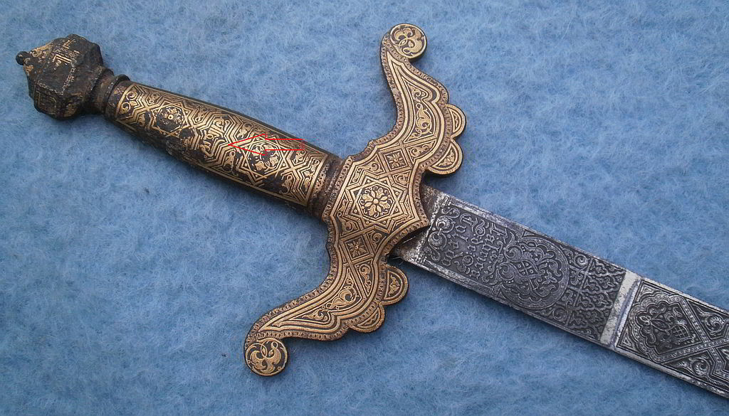

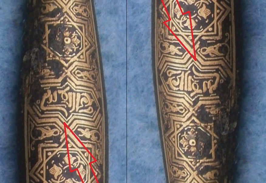

Saw this on a toledo made sword from around the mid 19c. appears to be arabic in a cartouche on the grip. can anyone tell what it says? I'm not sure which way is up, I do not recognise if the writing is actually arabic or the artisan's impression. blade is quite flexible and razor sharp. appears to be real gold inlays.

Can you please show us the whole sword?
Marius

It's not Arabic

I think it's mock/ersatz arabic, for decorative purposes by someone illiterate in arabic calligraphy.

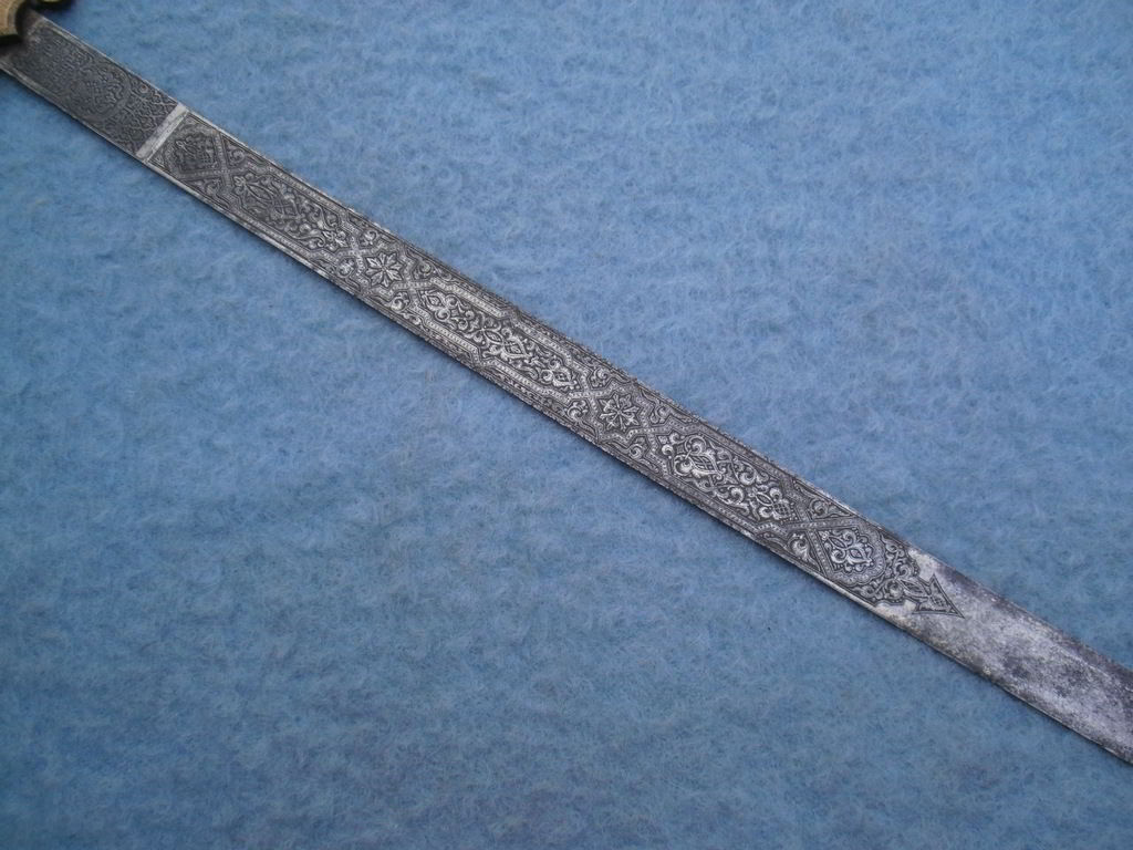

Posts: 4,285
Marius

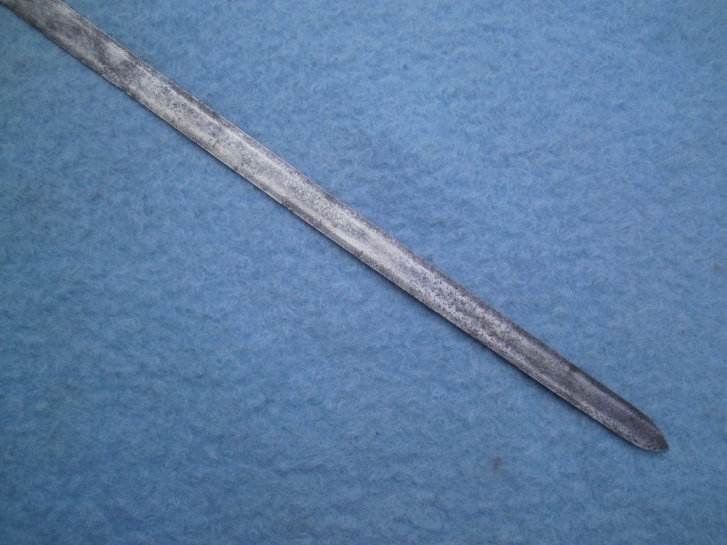

Attached note the reinforced forte/ricasso area.

carlos
Posts: 755
The work in handle is typical from Toledo and is known as Damasquinado. I think this piece could be from 1920 more or leas. Is a beatiful sword. The Fábrica de Toledo made some copies of swords from different ages.
I love this sword! If some day you want send me ...😀😀
What a beautiful sword! These Arabesques are among the best I ever saw!
I tend to date the sword back to the 19th ct..
Roland

Posts: 1,918
Beautiful it is but unfortunately it is just a purely decorative piece not even a reproduction of a hystorical sword... at least none I can recognize.

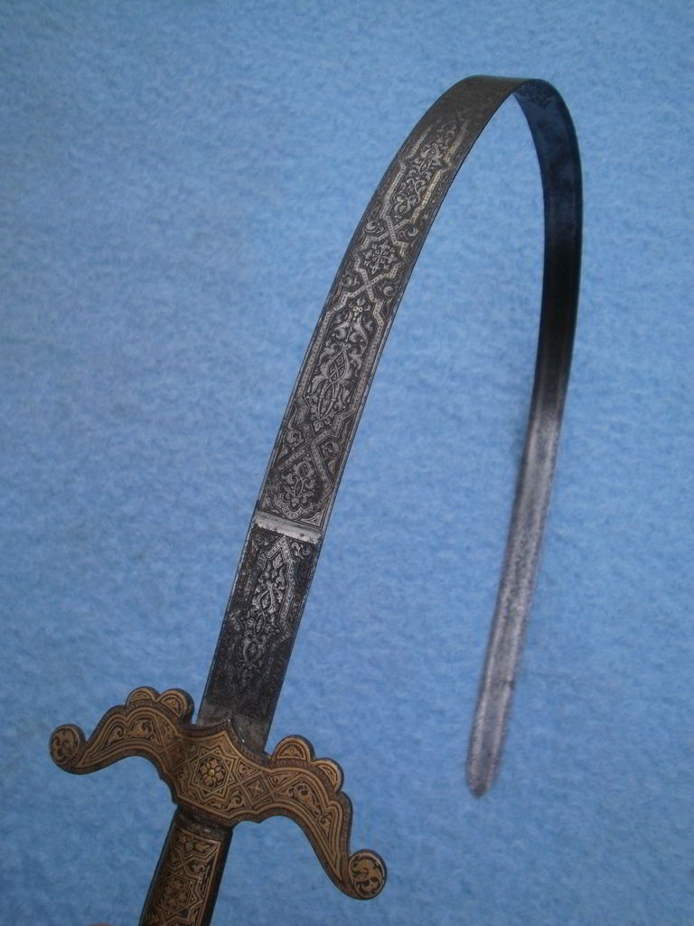

Posts: 7,397
My first thought was an artificially aged copy. Then the blade bending -
Old 9th March 2018, 09:33 AM   #12
Originally Posted by Battara
... My first thought was an artificially aged copy...
Mine as well.
... Then the blade bending -
More of an Indian trick, right ?

Originally Posted by fernando
On the other hand i wouldn't take it for certain that this piece was made in Spain.
I also have major doubts that it was made in Spain. Much more likely it is a "toledized" Jian, made in China.

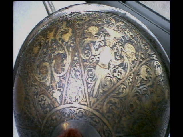

Posts: 295

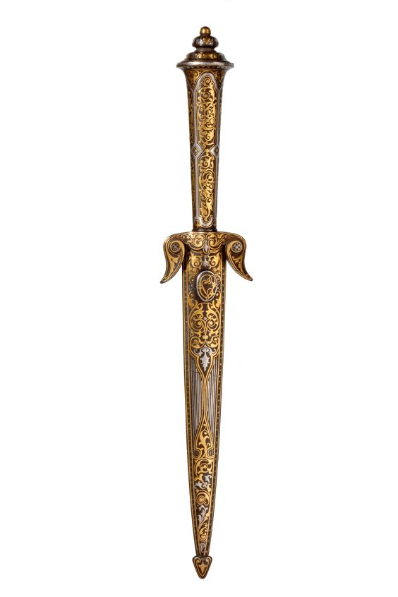

These were from the 1870s to 1880s. There was a workshop at the Toledo Factory working with silver and gold inlays. The main artisan was Zuloaga, a brother to the famous painter, although I think he was more often at Eibar.
There is another piece from this workshop in this thread:
http://www.vikingsword.com/vb/showthread.php?t=21551
Often they are idealized weapons with a now absurd romantic or oriental-like aspect.
There is a book on this:
https://www.khalilicollections.org/p...li-collection/

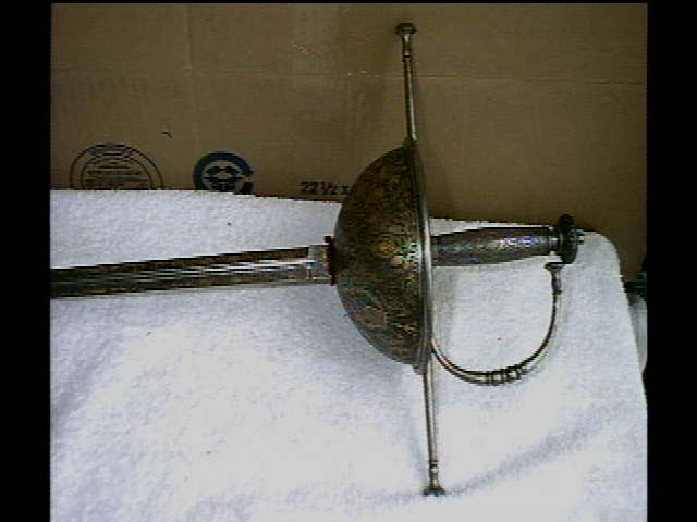

I have myself a cup hilt rapier dated 1881. I do not think from Zuloagas himself. The piece is hopeless as a weapon, too heavy, wrong balance, too stiff, too long (1.25m plus). It has three different gold tones (out of reach now). Main gauches are often seen in this style.

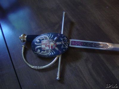

The horrors you can see in Toledo tourist pieces, mainly from the 1950s to 1970s are trying to imitate with acid etching and red and gold paint the old workshop. Last two pictures.
