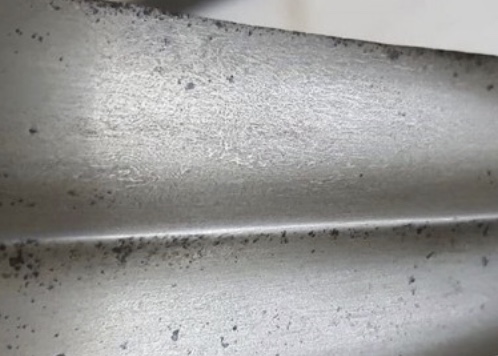

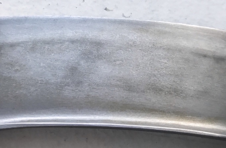

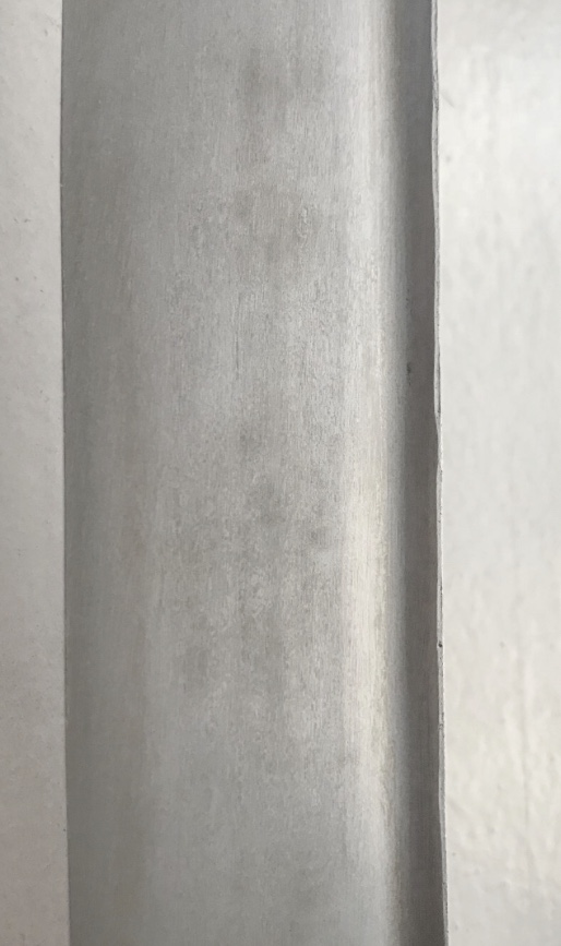

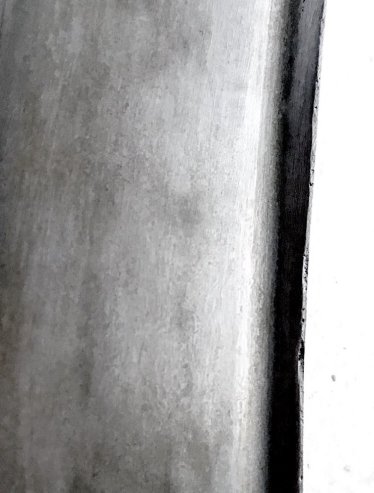

i was hoping this tulwar I have was wootz, so i cleaned the blade a little bit and the pattern slightly matches my other wootz tulwars but also matches other Skela, or Watered steel, tulwars I have. Here are a few patterns on the blade but let me know what you guys think. What could the blade be?

I honestly cannot see any kind of pattern. Try polishing the blade, then etch it and if it is wootz the pattern will be clearly visible.
Old 15th June 2018, 02:39 AM   #3
Posts: 7,420
I agree. At the very least do what in the nihonto community is called a "window" or a section. That way you will not waste your whole time on the blade if no wootz is present.

Yea thats what I’m gonna do. Ill post the pics here. Its really frustrating because I can see it person but in pics the pattern doesnt show up. Im gonna etch a part of the blade soon. So hopefully pattern emerges.

I can see the pattern in your original pictures but they are not clear enough to determine if wootz or pattern weld. India. Crystalline Damascus can have a very tight grain structure and not jump out at you. Additional etching is not going to improve the grain. Your best bet is to take the pictures in good sunlight and angle the blade to try and capture the pattern. From what I can see it looks like Indian crystalline wootz steel.
