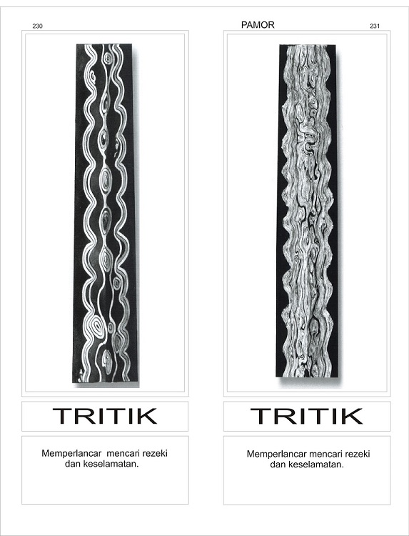

For the pamor it's not easy to see because the blade isn't cleaned or stained, but it looks a bit like pamor Tritik (but it is highly possible that after cleaning I will see that it is another pamor).

Yes.
