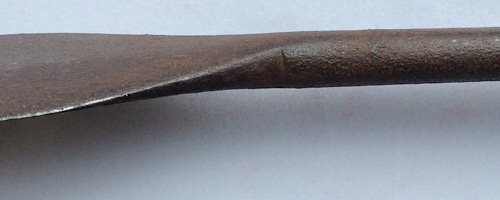

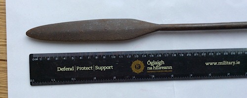

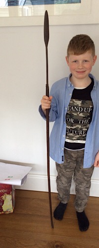

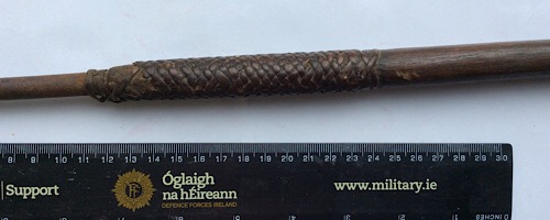

Hi
Bit outside my normal area
Do you think this is a Zulu, spear
It has the a typical notch on both sides behind the blade which I took to be a strictly Zulu manufacturing trait, this info is from the back of my mind somewhere

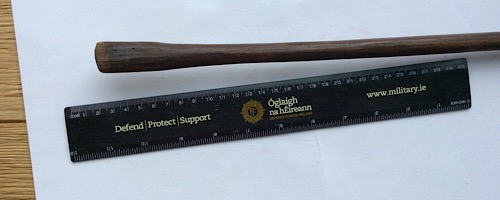

V light throwing spear with overall length of 137cm
Lovey platina, It was caked in red rust which I am in process of removing without hopefully affecting the underlying black oxide.
The binding is firm and is rattan as opposed to wire
Head is 15 cm with shank adding another 19 cm
Flaired butt
From a quick look on the forum I may have identified it as a ingcula type used for hunting rather than warfare
If it is Zulu would anyone be able put an age to it?
Just picked up in a car boot sale for a few euro so if it is not the real deal no worries
Ken

Old 11th March 2018, 06:54 PM   #2
Looks appropriate for the Zulu throwing spear, Shaka stopped the use of throwing spears as their primary weapon, but they, like the romans, used them to soften up the enemy just before contact, when they used their ikl'wa (stabbing spears) or iwisa (knobkerry clubs). the throwing spears had shorter blades, longer tangs, and longer thinner shafts, but invariably had the pinch notches at the blade/tang junction. bindings were wire or fibre, or leather thongs, or de-gloved cattle/goat tail skin which was applied wet & shrank tight. Being the top dogs in the area, the subordinate conquered tribes from a wide area, like the shona, supplied their tools and weapons as tribute, so there is some variances. (age is really hard to tell)
p.s.- they NEVER used socketed spear heads.

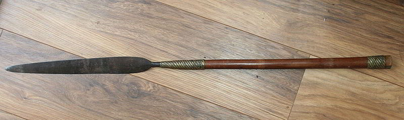

My best ikl'wa for comparison:

Thanks for info.
It looks like the metal has been pinched inwards.
Is this part of the manafacture process?
Lovely balance and feel to the spear.
Ken
Old 11th March 2018, 10:38 PM   #6
I'm not sure, seems unique to the Zulu spears, their tanged axes don't have the pinch, but all their spears do, and other tribes do not have it. As i mentioned, other tribes made weapons for them, so they only seem to have pinched the zulu ones. Maybe a mark to differentiate them as intended for the zulu, like the british broad arrow. Maybe someone else knows more.

Thanks for the confirmation Kronckew
I guess it is a handy identification mark for collectors to have a ISO mark on Zulu Spears
I know as you stated in your initial reply African weaponry is difficult to date but do you think it might be of Victorian period? Or at least sytle to that period
Ken
Old 11th March 2018, 11:38 PM   #8
'Victorian' covers almost the entire 19c, so that would probably be safe. The wood, binding and steel patina looks consistent with that to me too. because of the UK's invasion of the KwaZulu nation in the latter half of the era, and the war with the Boers, a lot of souvenirs from there were brought back to the UK.

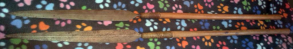

I just took delivery of two Ik'lwa that were sold as a pair of shortened ethnic african spears, and quite inexpensively. The sharks (other than me) were not biting that day.
14 in.sharp blades of flat diamond x-section, 26 in. wooden hafts tapering up to the hilt end, socketed blades bound with twisted rawhide 'bolsters'. they both have the Zulu 'pinch' on the bit of tang outside the socket. These I gather were 'GI' for the lower ranking warriors

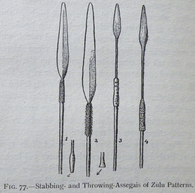

I am attaching an illustration from Montague's book "Weapons and Implements of Savage Races" 1921 for interest.
Old 22nd May 2018, 11:45 AM   #14
yes, the TV series 'SHAKA' follow that storyline. Worth watching. Spoiler: He gets assasinated in the end. King Cetshwayo (Zulu war 1879) did better, visiting London and was quite the hit there, returned to kwaZulu and ruled there till he passed in 1884.
The two ik'lwa stabbing spears are on the left, the 2 much longer isijula (light throwers) on the right, with long tangs like roman pila, possibly for the same reason the Romans did it.
