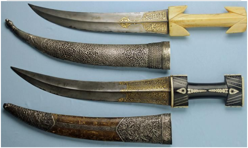

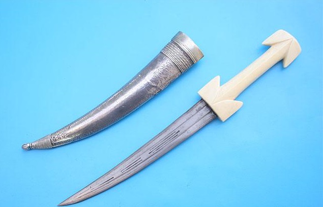

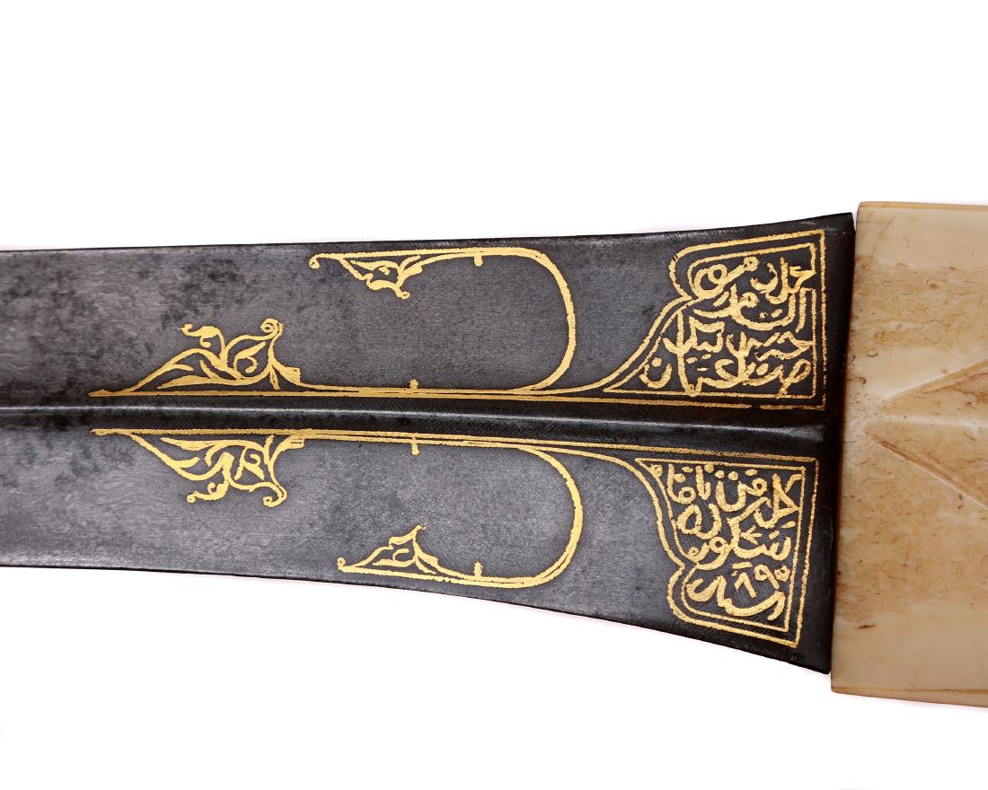

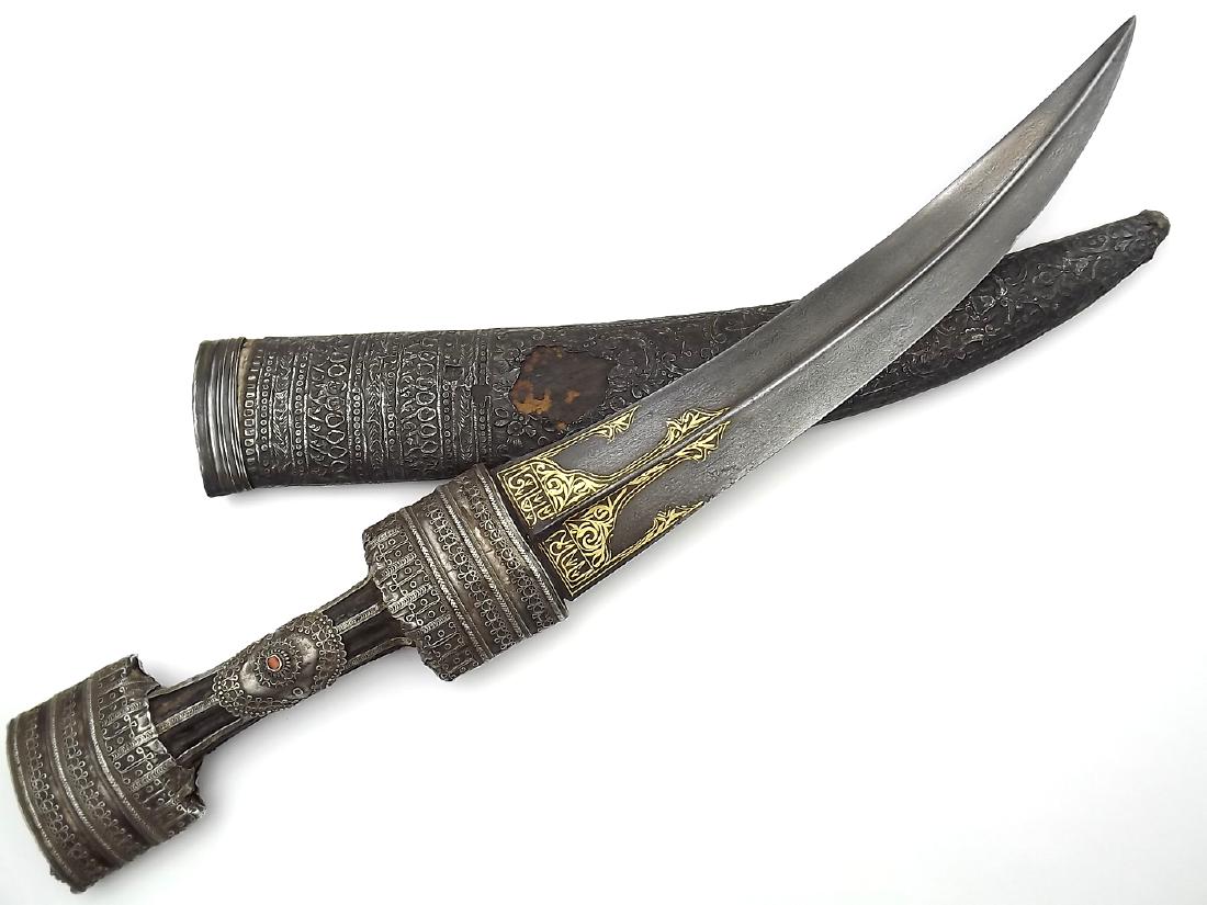

Here we have one that belonged to Osman Bey and was made in Damascus, Syria.
Now let us try to find more of the same kind with incriptions containing the place of origin, in the hope we can accurately locate more of them and eventually establish a pattern.

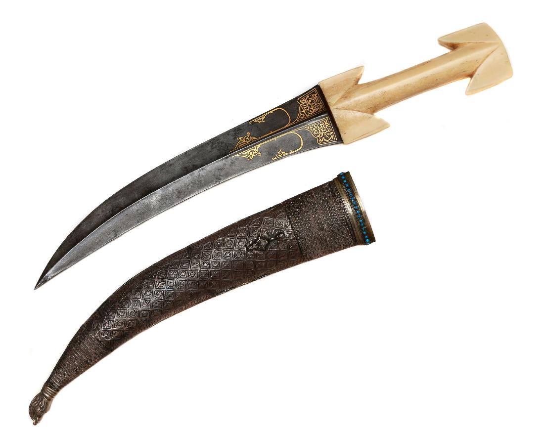

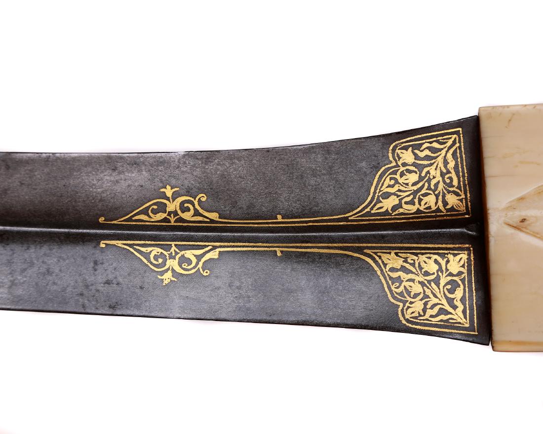

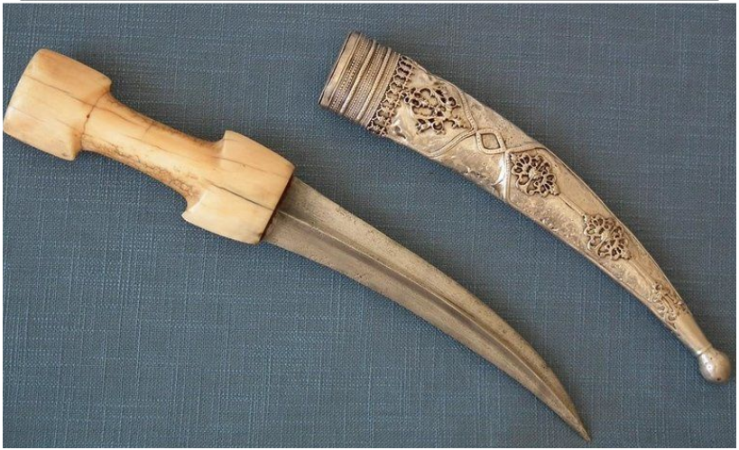

Here we have a second one attributed to Turkey and dated 1187 corresponding to 1773 AD.
Maybe Kwiatek will be kind enough to translate the text for us so we cand know where exactly does it come from...

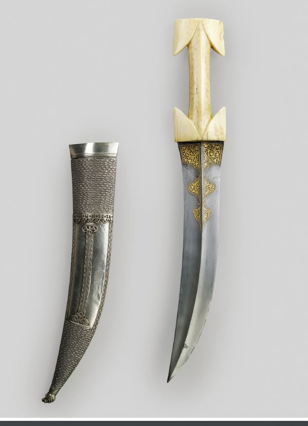

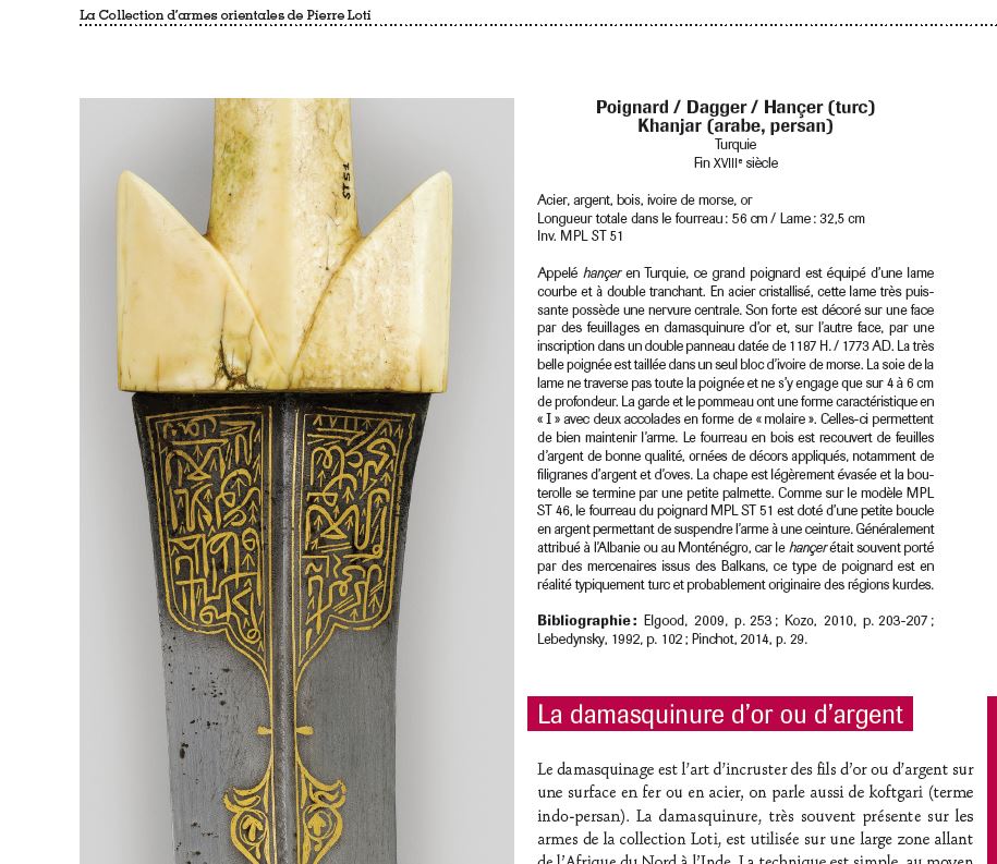

Interesting that the second one is described as "... generally attributed to Albania or Montenegro". And then mentions its issuance to the " Balkan mercenaries"; those were by and large Albanians.
Old 19th March 2020, 06:04 PM   #4
mariusgmioc
mariusgmioc's Avatar
Location: Austria
Posts: 1,918
Isn't this exactly what Kubur said?!
And further continues saying they were in fact typical Turkish and of probable Kurdish origin... which is consistent with what Elgood said.

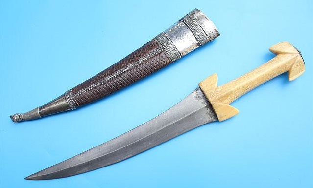

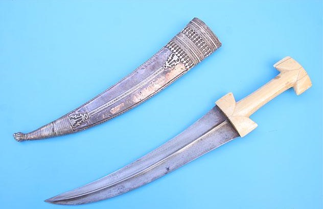

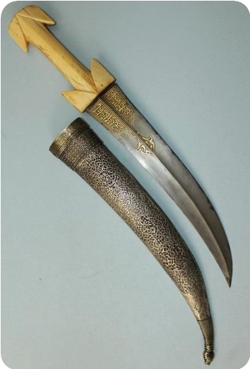

More of these, they are called by collectors and dealers "Albanian jambiya".

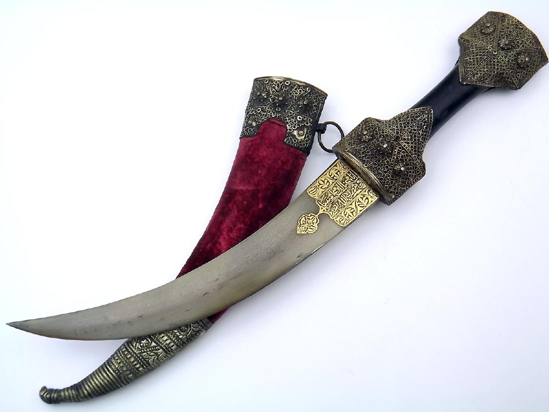

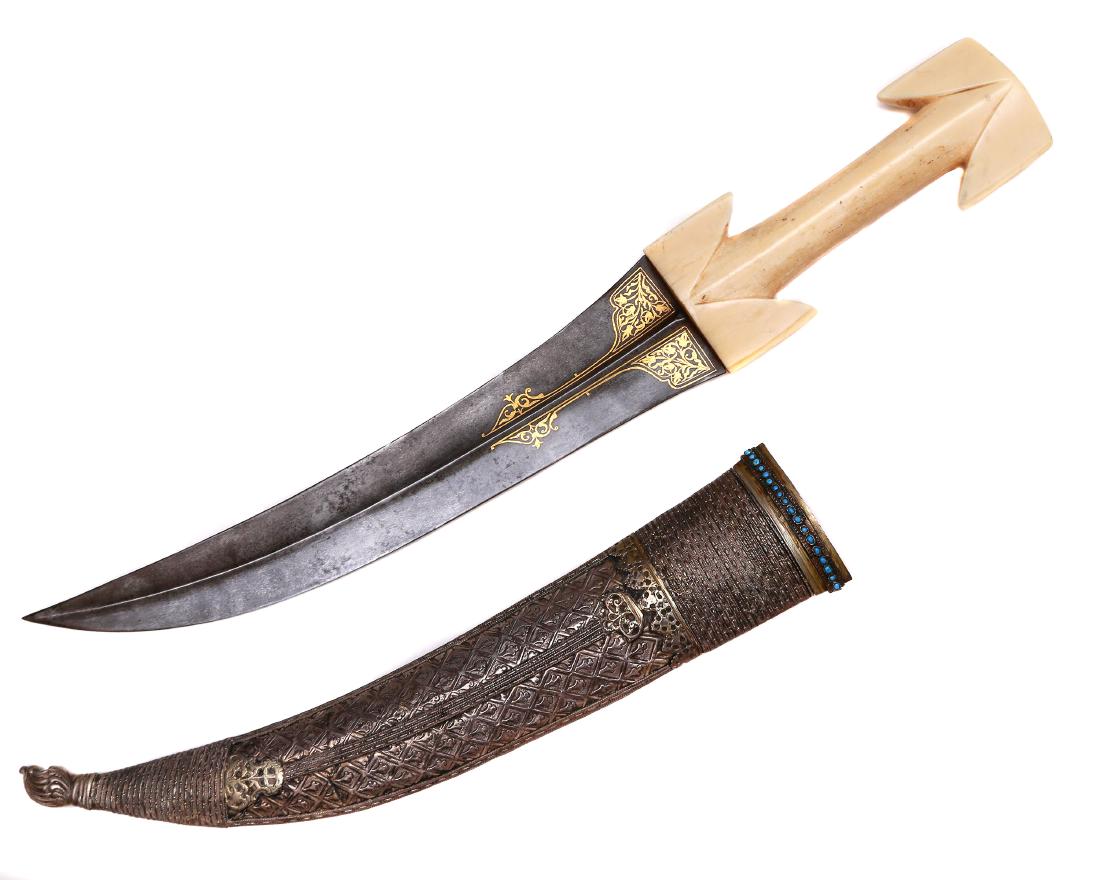

As you can see some of them have hilts more Kurdish in style...
To support Marius point and the link with Persian blades, I think the Kurds are the link: from today Turkey to Syria up to Iran...

The two first daggers that you posted are often described as Baghdadi jambiya.
They are very similar to the Kurdish ones but with silver filigree fittings.
I might be wrong but it will be good to focus only on the first dagger that you posted as the shape is different from the others.
But I agree that they share many features.
Again, it is possible to make suggestions for individual words, but I do not think the inscription as a whole reads or that the person who made it knew what they were inscribing/copying. The date of 1187, however, is legible
The one with the dark handle has a Turkish poetic inscription I've only ever seen on yataghans. Interesting piece

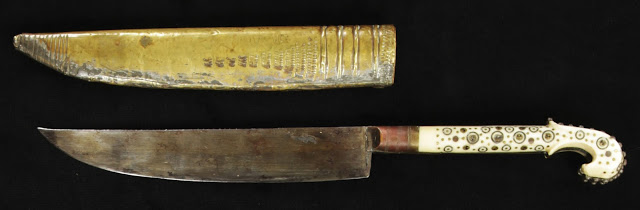

Bıçak: knife EN[1] oldTR biç-/bıç- +gAk → biç- oldTR kınğırak (et bıçağı TR; meat knife EN). biçek/bıçak [ Divan-i Lugat-it Türk, 1070] Bel bıçağı, et bıçağı, kıyma bıçağı, kaymak bıçağı, pastırma bıçağı, börek bıçağı, bekçi bıçağı , kasap bıçağı. from oldTR[ Kaşgarî, Divan-i Lugati't-Türk, 1073] biçek: as-sikkīn [bıçak] (...) as-sayf [kılıç]; oldTR: [ Kutadgu Bilig, 1069] bıçaḳ tartma anda kötürme süŋük [bıçak çekme orda ve kemik taşıma oldTR bıçak/biçek kesme aleti oldTR *bıçġak < ETü bıç- +(g)Ak
Oldest source: biçek/bıçak "aynı anlamda" [Divan-i Lugat-it Türk (1070)]
The bichaq is a single-edged dagger of Turkish origin. It is widespread in areas controlled by the Ottoman Empire and its close neighbors.
The blade of this knife is either straight, holds a slight forward curve, like a short yataghan, or very rarely a backwards curve, like a jambiya.
This knife and others were made at the end of 19th century. They were often sold as souvenirs to officers of the Austro-Hungarian Empire who invaded Bosnia at the time. The principal centers of production were Sarajevo and Foca.
source of the above : costak.blogspot.com / date Friday, July 05, 2019
