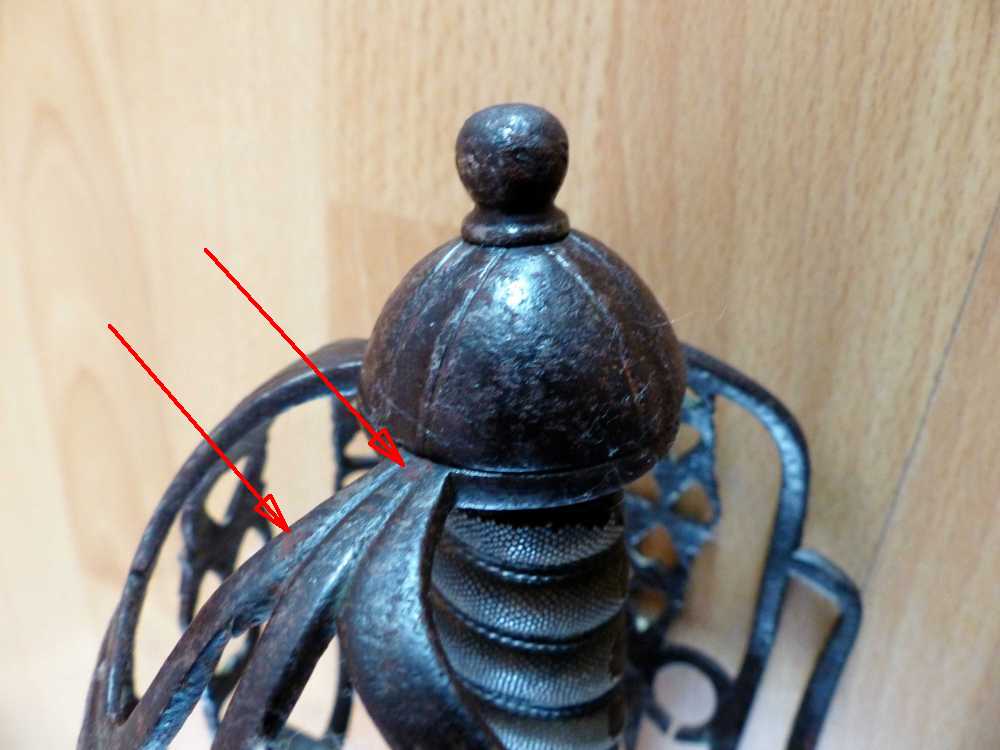

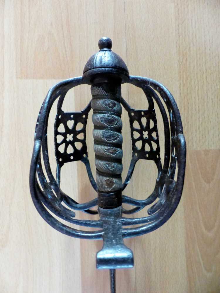

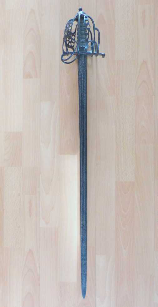

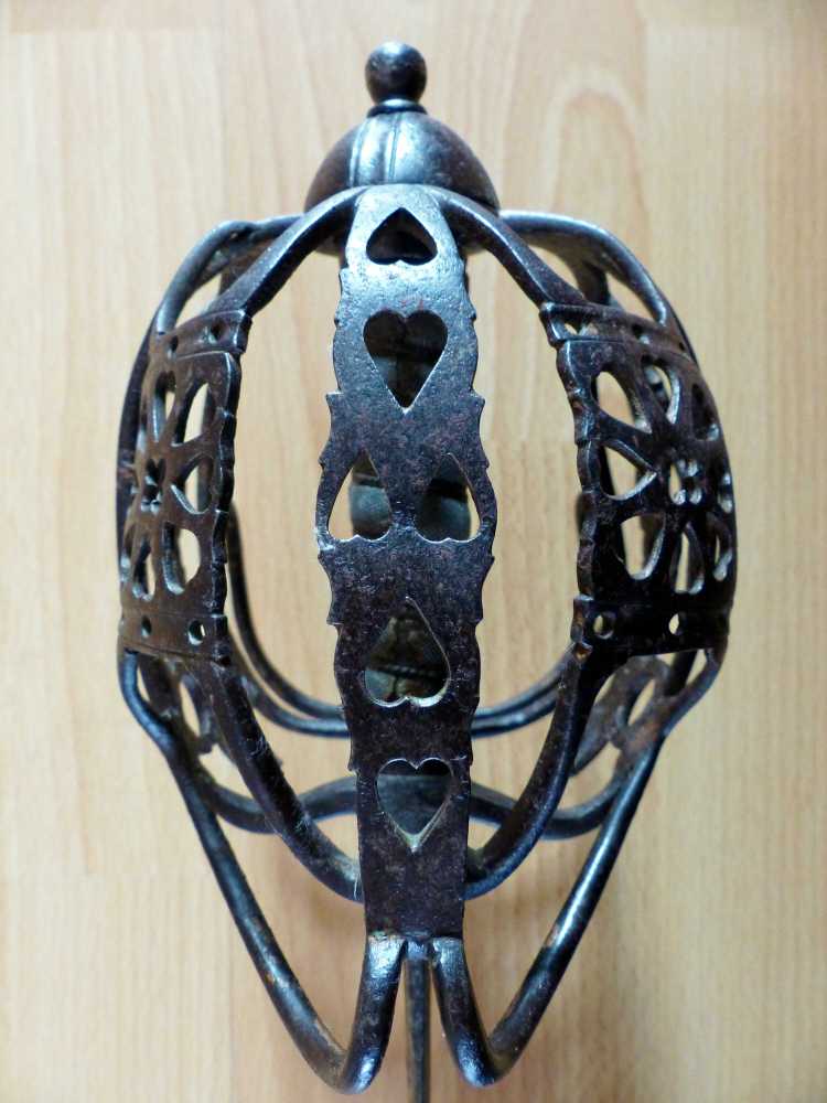

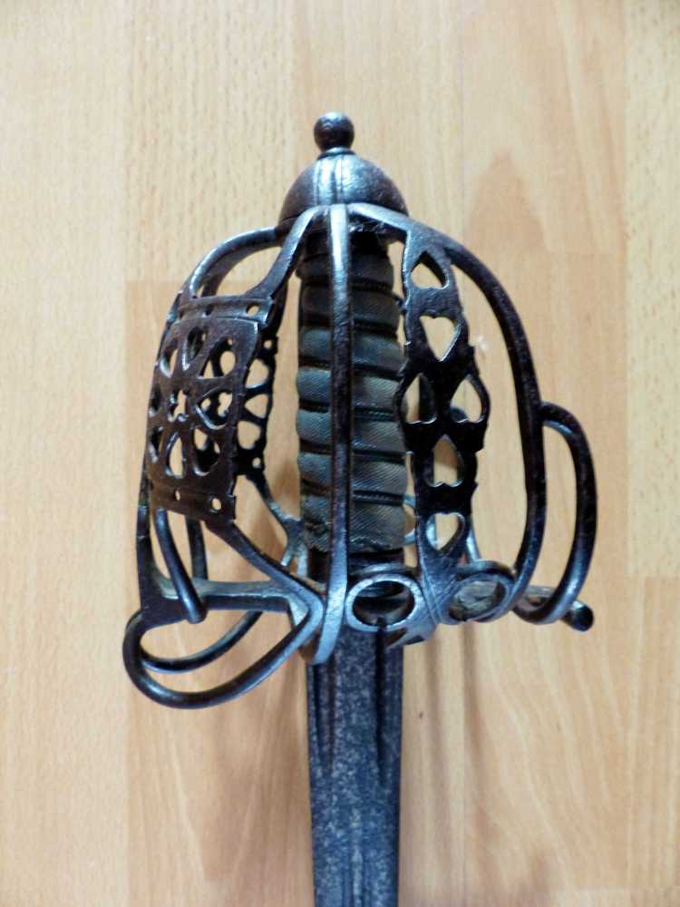

Not long ago, I got the Scottish Broadsword in the photos below.
1. Any comments about the sword are welcomed!

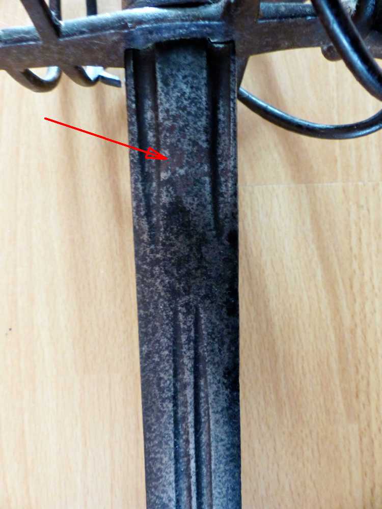

2. The sword is very nicely patinated but it has some brown rust in places (see red arrows). How can I stabilize and stop the oxidation advancing further, without affecting the patination?

Already tried brushing off the brown rust. Even added some WD40. Some came off, but most of it remained.
I am now considering using Hammerite Kurust to somehow inactivate the brown rust but I am reluctant to do so before learning more about it.
Is somebody familiar with Hammerite Kurust?
Kurust can stain your blade so I wouldnt use it.
Stubborn rust can be gently removed with a soft brass brush or using the edge of an old copper coin ..... these will not scratch the iron but will loosen the brown rust . In areas I have treated in this way I gently warm the metal to drive off moisture from the pores and pits and then melt beeswax on to the affected area , and polish. If you simply oil or wax w/o warming first , then as has been said , rusting may continue under the protective layer .

I find brass brush leaves a golden colour on the metal after cleaning off red rust
what i generally do is clean with brass brush and then do a very gentle clean with 0000 wire wool after to remove the brass golden colour.
Then I seal with wax, either renaissance or furniture depending on size of the job.

No comments about the sword?!
My guess would be Scottish, late 18th century, but I am not very knowledgeable .
Old 1st February 2018, 12:04 AM   #9
NeilUK
Join Date: Dec 2014
Location: Scotland
Posts: 126
i would say your guess is pretty close - Scottish mid-late 18th century and middle quality. I assume that there are no marks on blade or hilt to help identify it. But a nice sword to own.

Posts: 7,407
This may well be Scottish, but made in the early 19th century.
