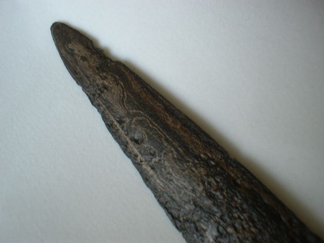

Under a close up from the tip.

On picture 4,6,7 you can clearly see the pamor. Its hard to give a simple answer about establishing age, any indication about age is a guess. But then again, some guesses are more better then others.
Good guidelines are; color, wear around the edges, number of pamor layers, traces of grains in metal, the way the layers are bend etc etc. As soon as you think you know the period, compare it with reliable dated keris (maybe there is one in a museum near you. In the exemple above you'll probably end up in the 16th century..but then again that my guess
Sheath, hilt ect.. are of course more recent. Its very hard to find even a 19th century keris with original sheath, handle, mendak etc (I have some, will share them later).
One reason is obvious (and mentioned above), its hard to keep a piece of 200 year old wood in good condition in the tropics.
The second reason is that keris blade are (locally) seen as valuable, but the rest is not (well not always). Most of the "new" owners simply want to change the "clothes" of their old blade. Put on a brand new sheath with shiny new brass cover is still seen as a good thing. You also dont wear the same clothes all the time, right ? The old ones sometimes is simply thrown away (trust me I see it happen a lot).
To Illustrate: I was on a market in Solo, few months ago. Found a nice old blade, in a good 19th century cover. Seller wanted to do me a favor and change the old cover with a brand new, for free even...He really had difficulty to understand why I wanted to keep the old one. In the end I left the market with an old blade in a flashy new sheath, meanwhile carying the old cover in a plastic with me of course
I can't comment on the "catch", and I dont see any reason I should But I'm sure the new owner will be happy with his new collection addition.

Hhhhmmm.....well, thanks for the pics Doecon. Unfortunately, they still aren't very good (blurry, dark) and i certainly wouldn't try to judge age from them. There does seem to be a certain amount of the type of pitting i would expect to see on artificially aged blades, but i wouldn't bet the farm that there is no real age to it. I do suspect that it is, indeed, a Madurese blade and therefore correctly, if poorly, dressed
I do find you comments on dress to be a bit off the mark. Dress is very highly regarded in Indonesian cultures and the really nice and reverred types of woods that are/were used in high quailty dress are becoming rarer and rare. Rare valuable materials are often used such as ivory which are held in very high esteem. The idea that a new owner would automatically trade out a fine quality dress for a shiny new one if that dress is in good condition just don't sound right to me at all. It would be disrespectful to the blade to leave it in damaged dress, but otherwise it would not just merely be tossed away for new.
Anyway, this is a fairly low quality blade (old or not) in a low quality dress. I would still say the new owner did alright if this is the type of keris he was looking to add to his collection. I do wonder, however, if it is advisible for you as the seller to appear on this forum to defend your description of this keris (and future auctions if they are discussed here). If there are factual discrepancies in your listings and you chose to defend them here i can assure you that the level of expertise on this forum here WILL find them and expose them. You may not find that in your best interest.
