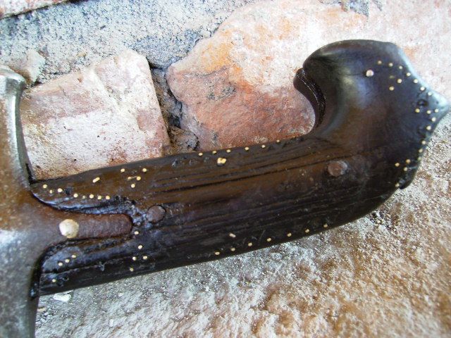

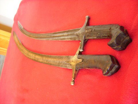

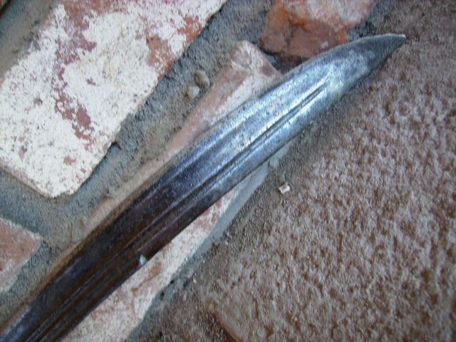

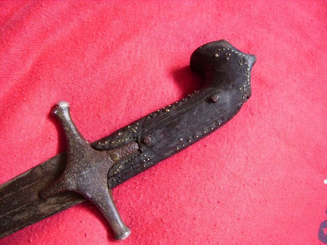

Here is another nice sword that belongs to a friend in Bulgaria. To me it looks like a Polish karabela, but I might be wrong, as it could be Turkish or Arab. I am curious to see where you guys place is in terms of origin and age. Also, is someone familiar with the little x-shaped marks in the fullers and their significance? Finally, according to my friend the hilt is dark wood (ebony?) and not buffalo horn - is that unusual?
Thank you,
Teodor
Old 12th December 2007, 01:09 AM   #2
Posts: 10,867

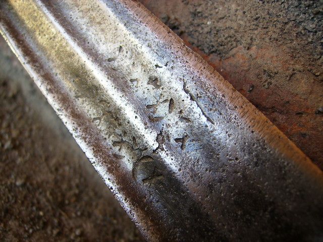

Teodor, this is an interesting cavalry sabre that is probably quite early, probably 18th century and most likely Eastern European, whether Polish or Hungarian always hard to say. It does carry the karabela style hilt and the guard corresponds to those seen on earlier Polish examples, really difficult to say without better references at hand.
The markings are of course most interesting, and exactly the kind of thing we are discussing on the early makers marks thread, where it seems the 'X' marks appear in a number of variations, typically enclosing a name, phrase or inscription. It does seem sometimes they occur in some sort of systemic representation of a numeric, which is the theme of the topic, trying to determine the symbolism behind these mysterious marks. Perhaps you might visit the thread?

Thank you Teodor, the reason I brought that up is that this is exactly the sort of questions on markings on blades that prompted starting the thread. While this is of course most likely a European sabre, blades of this type occur often in various ethnographic swords, and this is a great example.

Great piece! I think this is most likely Arabian in origin. The Karabella hilts like this were well used. I will post one from Pg10 Of Elgood's The Arms and Armour of Arabia described as a Arabian nimsha with wooden hilt. The nail head decoration is well documented on Arabian swords and daggers. Is there any way to get a better picture of the guard? The blade most likely is as Jim describes, and European. I will see if I can find any reference to the marks.
Again a great piece (I want it )!

You're right, the pommel on this is very un-karabela like and in rethinking it seems like the characteristic Ottoman hilt with a peak. The karabela hilt is multilobed and of course is a highly stylized zoomorphic that seems to be a bird head of some sort. I think of those silver hilt pallasches that Elgood also shows in that book, which are noted as 18th century and probably from Hadramaut . Many Arabian regions were under Ottoman suzerainty, so the presence of Ottoman forms seems well placed.
Thanks for coming in on this Jeff! I think those are the usual X markings that show up with ANDREA FERARA etc. at either end, but again think of those numeric sequences.
All the best,

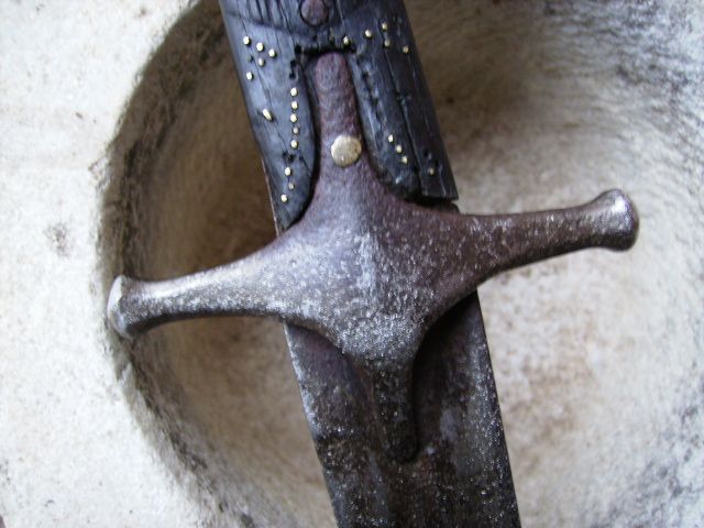

Here are some better pictures of the guard.
Old 16th December 2007, 05:01 AM   #10
Posts: 10,867
Teodor,
Thanks for the additional photo of the guard. I once had a sabre much like this, in nearly the same condition. The guard was exactly the same and the hilt was of roughly the smooth pommel Ottoman form. The blade was a heavy one like this with an inscription in the center which seemed possibly Polish, but cannot recall. It turned out to be indeed Arab.....as rough as it was, I wish I still had it!
When I bought it back in the 1970's from a dealer, it was listed as a 17th century Hungarian hussars sabre.
All best regards,

As Jim has expertly noted the hilt form is Ottoman and of course covers a large geographic area. Here are a couple more Ottoman hilts from Swords and Hilt Weapons
Thanks for the better shots of the hilt, It is always great to collect as much data as we can.

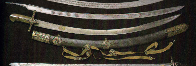

Awesome references. The Sha Safi Karabela is shown in the middle portrait above. Oliver Pinchot note that it most likely is the same as his fathers.
Here is a quote from Pg 62 of Orez Perski Lech Kobyliniski states;
On portraits of Sha Abbas the Great dating from the 17th century shamshirs with a carabela hilt appear. This type of hilt can also be seen in portraits of Shah Safi and Shah Abbas II. On one picture in Padshahnama, which shows the audience granted by the emperoe Shahjahan to a Persian ambassador, the Persians carry sabers with such a hilt. Based on these portraits, some authors connect the genesis of the carabela hilt with Persia, however it is known that this type of hilt also appeared in much earlier Turkish sabers and so it probably originated there and was adopted in Persia later. Anyhow, it was used only in court sabers, and it was popular only for a short period of time.

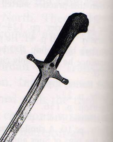

Old 27th December 2007, 05:01 PM   #20
Another hint:
Some time ago I posted this Yataghan:
http://www.vikingsword.com/vb/showthread.php?t=4728
and thought it had a Karabela handle.
I was corrected, however, by several Forumites. This is the so-called North African form of the Yataghan handle.
However, look how similar it is to the "eaglehead" configuration!
I would say the N. African handle was a local modification of the Karabela one. Any disagreements?
Another area of Ottoman influence, and no connection with Persia!

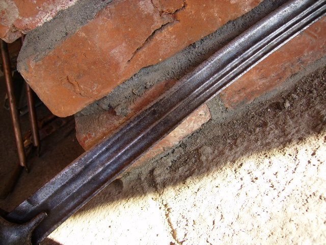

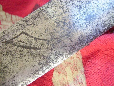

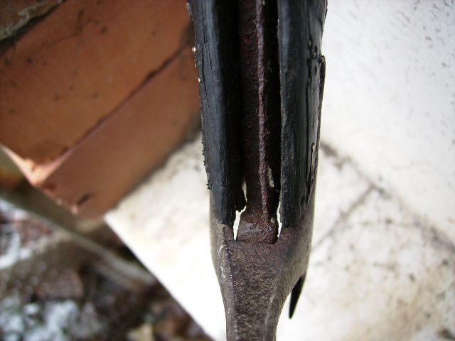

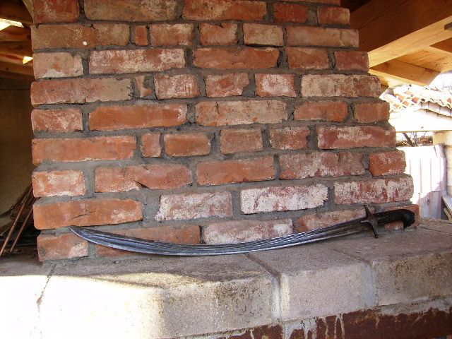

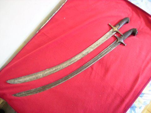

My friend in Bulgaria, in his latest attempt to cause me great envy, has added another karabela hilted sword to his collection.
Tha blade is marked with what looks like a hand holding a cleaver, I am assuming meant as a stylized version of a kilidj (a blade with a yelman). Looking at the old markings thread, I saw similar markings, such as one by Peter Munich. In Munich's version though, the sword was straight and double edged. Does anyone recognize this particular marking?
Also, what would be a good guess on age? Late 17th century? There are a few similarly hilted swords in Vienna in displays associated with the second siege of the city by the Ottomans, thus my guess.
Many thanks for all responses,
Teodor
