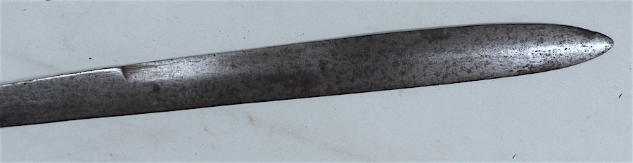

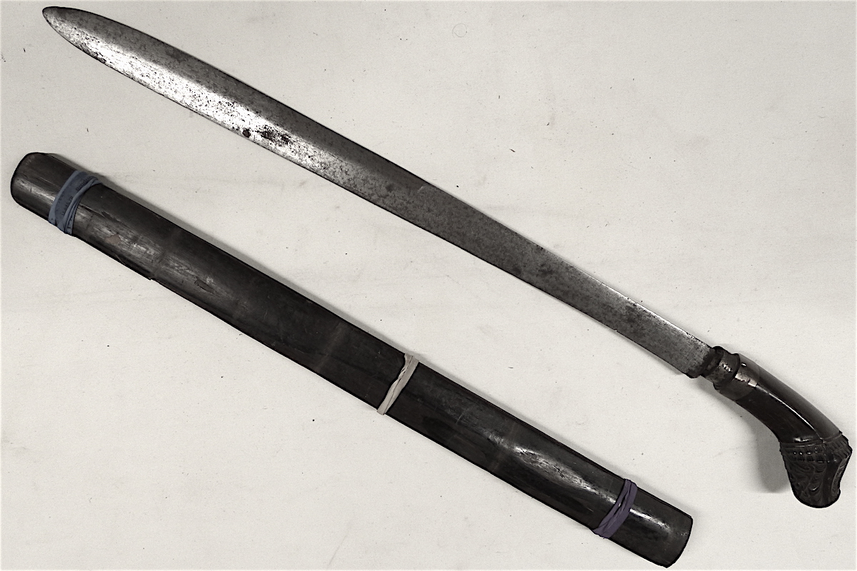

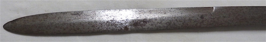

This one is a bit of a mystery.
A short sword with a blade that seems to have some age--pre-WWII I think--and appears to have been sharpened and used quite a bit. The blade is spear-shaped, with some gradual widening from hilt to tip before tapering to a central point. The back edge is sharpened along its distal half. Both the regular edge and the sharpened part of the back edge have a V-grind.

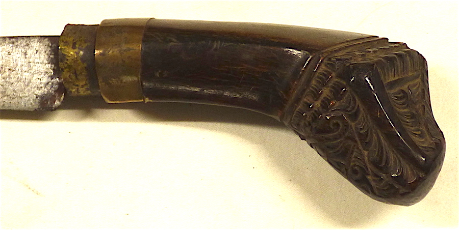

The hilt has a nicely carved pommel that I am having trouble identifying (hopefully someone here will recognize it). There are actually two ferrules on the hilt, a large brass one that partially overlies a smaller one.
The sword came with a nondescript wooden sheath in two pieces held together at the moment with elastic bands.
Thanks for your thoughts on this one, I would appreciate some help in identifying it.

My first thought is a european blade. Maybe broken and reworked into a klewang or pedang.
Nice find.

For me it's possibly an old klewang blade that has been resized (to change the shape).
The handle is also very old and very worn, but it was modified at its base (because broken?) At the time the sword was mounted in its current state.
I have the impression that it is an old klewang that has been restored and modified in a more European way in the first half of the 20th century.

I agree with Henk, as it appears to be a European blade reworked, or at least made from European monosteel.
Marius

it's a Mandau dayak with Pedang hilt

I had seen lamination on the blade, but maybe it's just my imagination.

I am with Séverin (Athanase) on this one. But it could be that the blade shape is original. This you can proof by a polish and etch since I think as well that the blade is laminated (sorry Marius), I've seen many unusual blade shapes by pedangs. It's for sure not a mandau blade (not concave/convex). Pommel is most probably carved from horn and can be called makara, maybe a little bit reshaped at the top.
