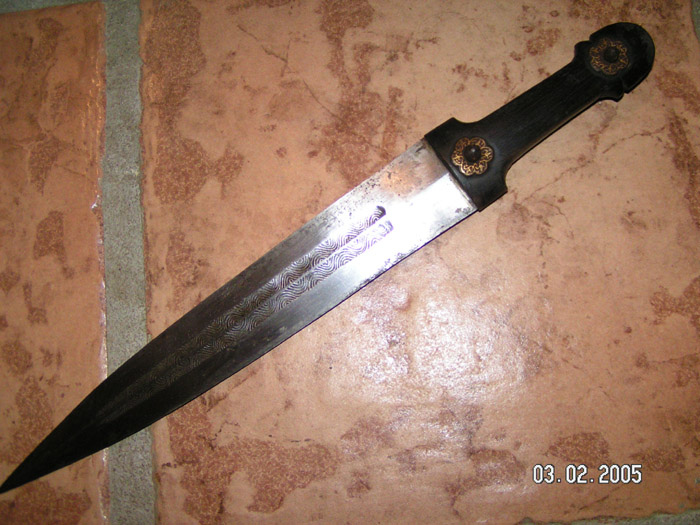

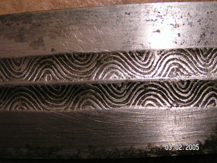

Old 8th May 2006, 03:21 PM   #4
galvano
galvano's Avatar
Posts: 178
Default exemple kindjal
For example
Here my kindjal.
The center is engraved with etching.
But it is not Damas.
galvano is offline   Reply With Quote
