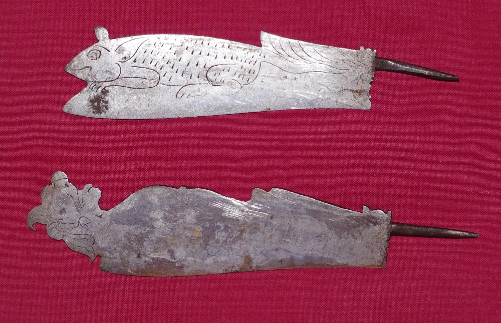

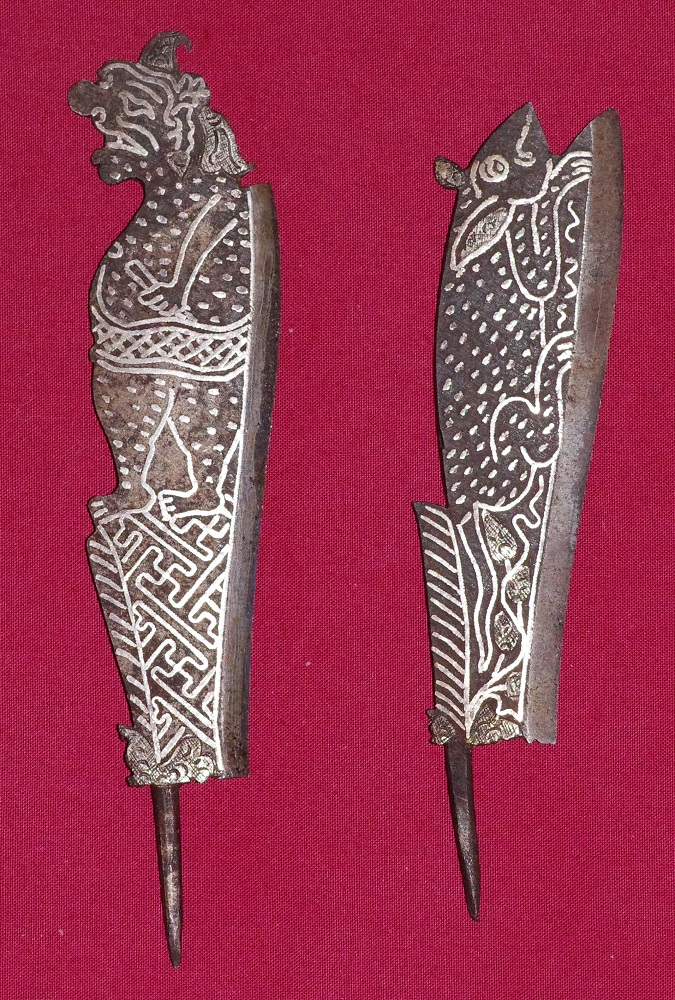

I found this two miniature axes at the same antique dealer.
It looks a lot like Pengentas Belakas but much smaller ones.
The sharp edges are very sharp and that with the "Semar"? is a damask blade (we can see the alternation of layers on the edge but I have not managed to make pictures that shows).
Semar : 9,5cm without pesi
Mouse : 8cm without pesi
It's ritual blades?
What is their symbolic? and / or function?

Athanase, I have seen a few of these, they are a legitimate part of Balinese culture.
I have not previously posted to this thread because I really do not know much about them, and I had hoped that somebody else might know more than I do and would be able to respond better to your question.
In about 1982 I visited Mangku Pande Made Wija who lived in a little village just outside Klungkung. He had just completed a keris that Dietrich Drescher had ordered from him, and he asked me to advise Mr Drescher that it was ready for him to collect. I examined the keris and complemented Pande Wija on his work.
I then asked what sort of things he usually made, and he showed me a basketfull of axe blades of the type you have, but they were not yet decorated with silver.
I asked what these were used for, and he gave me a long complicated response that I did not fully understand, but the impression I got was that they were for use in cremation ceremonies, mainly for cutting the ropes that bind up a corpse.

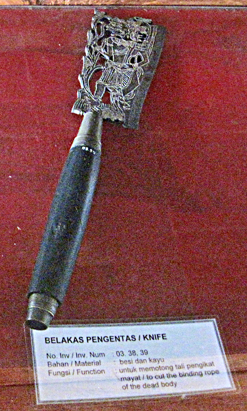

The rather poor photo (2011) of a much more elaborate example of the same type of hand axe in the Den Pasar Museum supports my understanding of Pande Wija's explanation.

I did see the measurement Detlef, but they did not register, because I tend to think in imperial, not metric. However, I have now looked at a ruler, and I realise they are quite small, but not too small to cut corpse binding ropes.
I suppose they could be souvenir-type imitations, but over a 50 year period I've spent a lot of time in Bali, and I've never seen this sort of thing in the tourist traps. This doesn't mean it has never been there, just that I've never seen it.
In any case, what we are looking at here is certainly not a household tool, it is some sort of cutting implement meant for use in some sort of ceremonial context.
Corpse ropes? Maybe.
Offering preparation? Maybe.
Internal use in a pura? Maybe.
But it surely is not intended for peeling mangos or pineapples.

Alan is right. From what little research there is, I have found that these axes/knives are for cutting strings that hold down the funeral coverings over the bones of the dead.

The Semar is made of damask steel and both are very sharp. I think they could cut ropes without problems.
