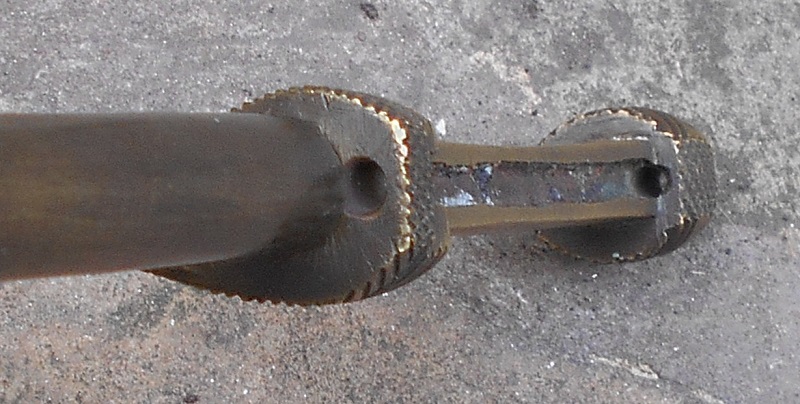

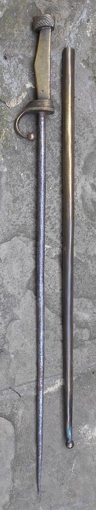

I do not have guns. Can any gun collectors give pictures and dimension information on African ram rods, to establish whether this spike weapon could be fitted to a ram rod and serve as a rudimentary bayonet. Thank you.

I don't think that is a ramrod, please see the recent posts.
I think that's a Lebel bayonet from 1886 turned into a dagger.
I won't be surprised if this dagger comes from Morocco or Algeria...

I know this is not a ram rod, but could it fit on a ram rod to serve as a rudimentary bayonet. Is a ram rod thin enough to go through what could be the attachment holes?

As Kubur mentions, this looks like it started life as a bayonet for an early Lebel rifle. Which, in that case, would have a cleaning rod under the stock versus a ramrod, since this Lebel would be in the later black powder cartridge period versus an early muzzle loader. I don't know how the Lebel bayonet fastened to the rifle.
To convert this bayonet for use on a metal ramrod on a muzzle loading rifle would be very impractial. The weight of the bayonet on the end of the rod would be very heavy, and would likely bend and split the gun stock on the first thrust.
Question: Does the groove on the bottom of the handle look like it was made that way? Or cut out latter ?

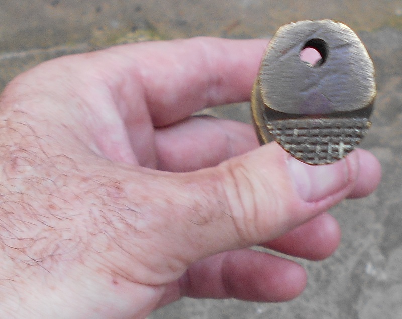

Somehow the visual information ie my fingers and the attaching holes, is not getting through. Could this fit on tribal guns/flintlocks ram rods?
Hi Tim,
OK a straight answer to your question. Yes it COULD fit, BUT as Richard says it seems to me to be rather impractical for the reasons already mentioned, and for that matter it could fit ANYTHING of the right diameter. If a tribal person had one of these, IMHO, it would be much more useful to use it as a hand held weapon.

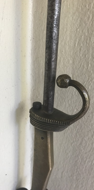

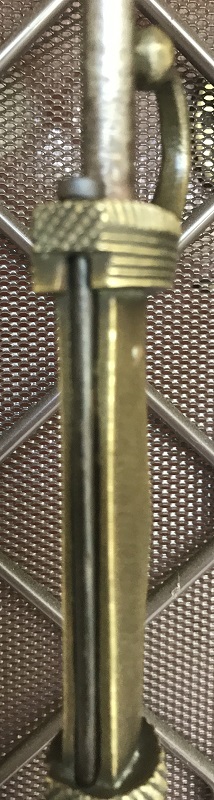

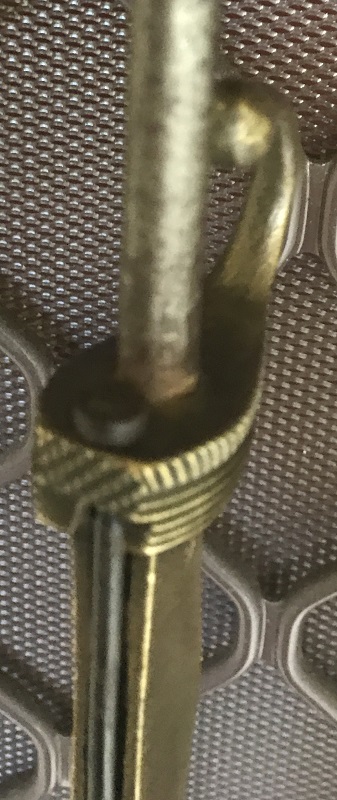

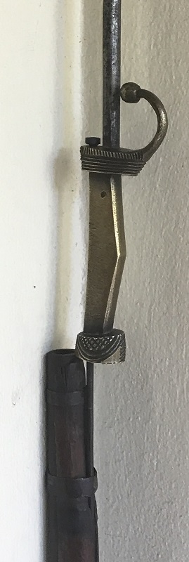

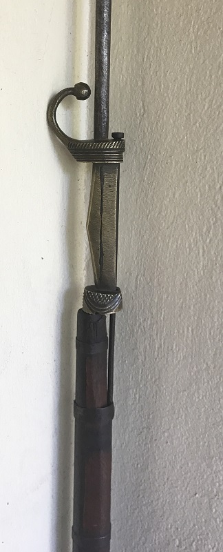

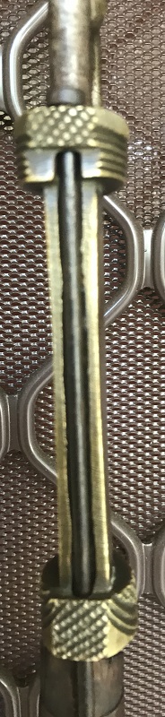

This bayonet is no longer mine. If you are a regular you may have noticed it on the swap forum. I was really pleased to receive these photos from the recipient in the swap, showing how the bayonet fitted this long Dane Gun. I am informed that this example of gun is long and that many of the West African made guns where a lot shorter making the bayonet a more practical weapon. It is a little awkward but I think no less useful than a plug bayonet when the time came to using it. Even attached to the ram rod I think you could stick someone with it. I just feel the pictures are worth a viewing and the gun with bayonet is a very cool addition to any gun collection. He did well?

This is extremely interesting , there is very little precedent for bayonets being used in Africa outside of native troops in Colonial service , but I do agree it does look as though it could have attached to a ramrod or other projection from a musket . Although it looks style on the lebel and perhaps copied in N Africa from French troops bayonets , it seems strange that an actual lebel 'blade' was not used as the region must have been slewing with them ! When I first saw your 'bayonet' I immediately thought this was a piece of trench art from WW1 designed to slot on to something and act as a short flag pole or somesuch.
