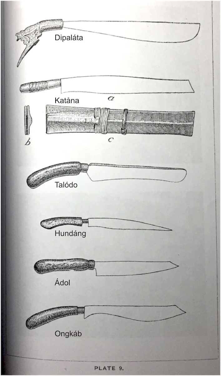

In a recent thread about "Negrito" knives and bolos we talked about some of the knives shown in a figure from Fox's article The Pinatubo Negrito (1947). Of particular note was the hundang and its distinctive wooden scabbard. This knife is a common weapon of the Negrito as well as a general utility knife.
Another recent thread provided information about the dipalata, a less common fighting knife used by the Negrito.

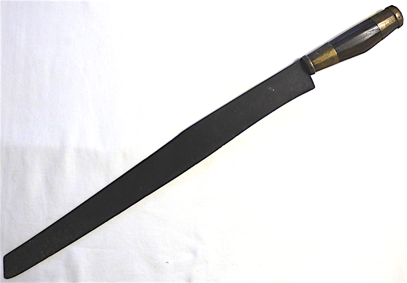

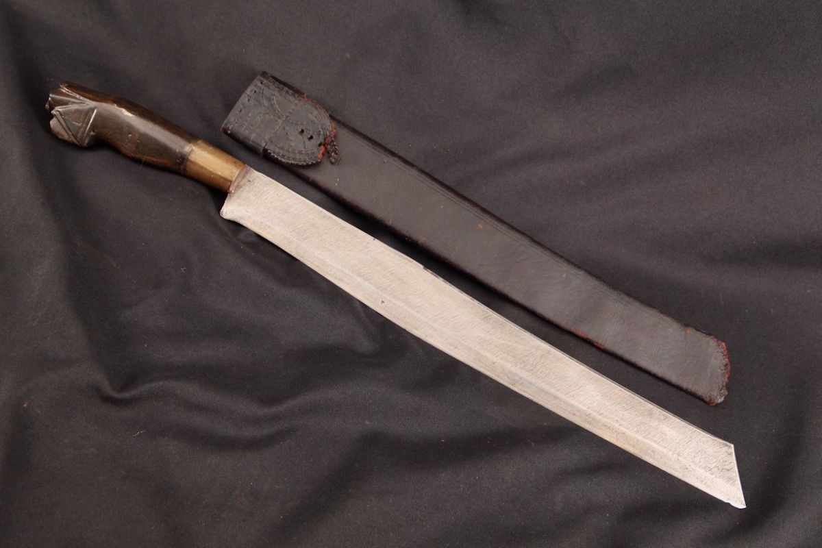

Another uncommon Negrito fighting knife is the katana, which is also pictured in Fox, figure 9 (see attached). The katana is a narrow bladed large knife/short sword with a distinctive blade profile and a tang set toward the back of the blade. The close similarity of the illustrated example of a katana in Fox and the more familiar Ilocano tabak is probably more than coincidental.
Although accomplished smiths, the Negritos have been a longstanding iron poor culture, with the result that they acquired iron and iron objects (including blades) from neighboring ethnic groups. This is mentioned specifically by Fox. It seems very likely that the Negrito katana is adapted from, and in some cases is actually, an Ilocano tabak.
To illustrate this more fully, two Ilocano tabak are shown below the figure from Fox. The two characteristically Ilocano hilts on these knives differ from the one illustrated by Fox, which is a more traditional Spanish-style three part hilt. It appears that the Negrito katana and the Ilocano tabak are essentially the same knife, and it is quite possible that the Negrito knives were tabak blades acquired from the neighboring Ilocano.

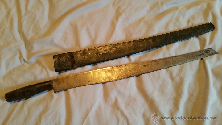

Posts: 755
Beatiful post !!! reciently I have sold similar piece.
Thanks
Carlos

Originally Posted by Sajen
Hi Ian,
thank you for bringing up this interesting topic. I agree with you that the Negrito katana is the same knife as the Ilocano tabak but it seems that the Negritos designed their own scabbard style for this knife.
Could be Detlef. However, Fox has made one mistake in this figure and labeled the dipalata as a katana and vice versa. It is possible that he made another mistake about the scabbard for the katana--which looks from his drawing to be very similar to that of the hundang in the examples we have found.

Carlos:
Thanks very much for posting your picture.
Looks like another nice example of an Ilocano tabak in its leather sheath. This one could be older judging from the three-part Spanish hilt.
Ian.
Old 7th April 2017, 01:26 AM   #6
Posts: 4,719
Here is a link to another example from Lew Waldman's Collection posted on this web site. The hilt on this one is very similar to the illustration in Fox's article.
Ian.

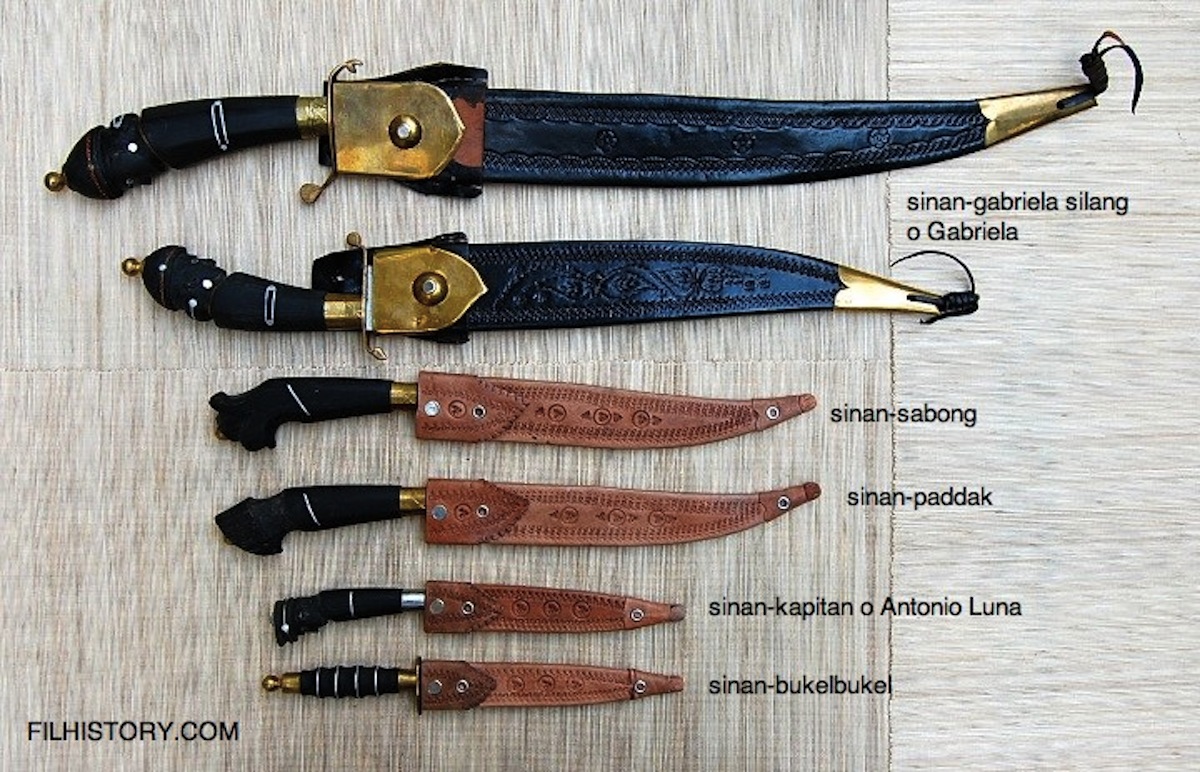

First, why are the knives that are shown here Ilocano? In a very helpful post on this site in 2010, migueldiaz provided some key information and an important reference about Ilocano knives (see here). In that thread he posted the following pictures and descriptions of Ilocano knives (the examples were modern made knives but come from a long tradition of similar knives). Apparently, the Ilocano nomenclature he provides was based largely on the hilt style, and he provides the names for a dozen different styles. Here are the Ilocano terms for those styles:
kinakandon: a blade which form was inspired by the palay (rice plant) leaf => am still getting a photo of this blade [Comment: this blade style is called dahong palay and is discussed elsewhere on this site along with pictures of examples with this blade style--see here, here, and here]
ganado: "has a rounded blade end and slightly arched body and is used for cutting tree branches"
innigat: "has rounded blade end akin to the shape of an eel's head and is used for clearing field grasses and shrubs"
linipit: hilt has a twirl design
minanabo: "has a straight back edge and slightly curving blade but pointed end and is used for cutting meat and butchering animals"
sinan-babbai or sinan-gabrielasilang or gabriela: the hilt has a woman figure with a native hemispherical hat; by the way, 'Gabriela' or 'Gabriela Silang' refers to the famous 18th century Ilocos heroine
sinan-bukelbukel - hilt has circular or spherical elements in the design
sinan-kapitan or Antonio Luna: the hilt has a human head figure, with an officer's cap; Antonio Luna is a Philippine Revolution hero incidentally
sinan-paddak: hilt has a horse or carabao hoof design (at the pommel)
sinan-sabong: hilt has a partially-open flower design (at the pommel) => this is probably the most often-seen hilt form among Luzon blades
sinan-tattao: generic name for a blade where the pommel is made in the likeness of a human being (would thus include the sinan-babbai and sinan-kapitan swords)
sinan-tutot: "is long with a 2.5 inch-body that tapers into a sharply pointed end and is also used for cutting meat but usually carried in a belt as weapon against venomous snakes"
And here is his picture illustrating some of these types of knives: http://www.vikingsword.com/vb/attach...id=60025&stc=1
If you look at the examples of tabak knives shown here, you will see that each has a hilt that fits with the descriptions provided by migueldiaz. Of particular interest is the first example I showed in the original post of this thread. It would be called a sinan-kapitan, and as far as I know this particular depiction of an officer wearing a cap is uniquely Ilocano. The second example I showed would be called a sinan-sabong. Your example, shown in the thread that you linked, shows a spirally wired hilt, and might be what migueldiaz describes as a linipit. This collective evidence argues, I think persuasively, that the tabak knife is mainly an Ilocano weapon/tool.

----------------Attachment----------------
Here is the picture from the thread of migueldiaz showing various Ilocano knives and their distinguishing hilt shapes.

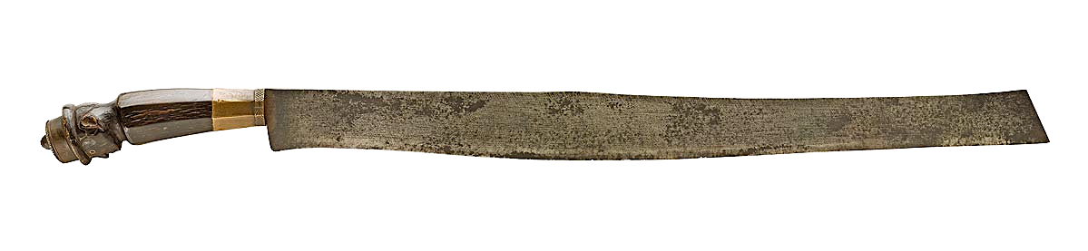

Posts: 4,719
I was at a gun show here in Minnesota a couple of weeks ago and came across another example of this sword form. This one has a horn grip with brass ferrules, and the blade has the usual "Negrito katana" shape. The photograph shows the "as found" state of this one, with a heavily patinated blade. I would say probably mid-20th C. Could be Ilocano or Pampangan in manufacture--the hilt on this one looks more Tagalog than Ilocano in style.
Old 20th November 2017, 03:53 AM   #10
Posts: 7,401
For clarity sake, what for you makes the hilt more Tagalog than Ilocano?
