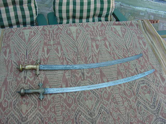

Who can tell me the difference

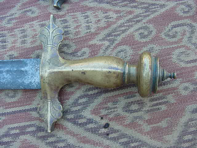

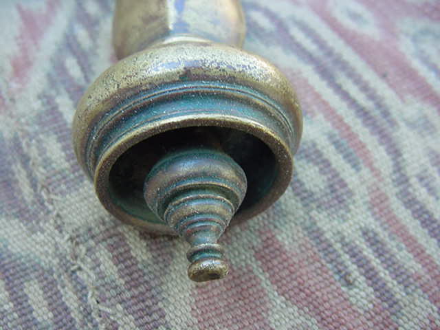

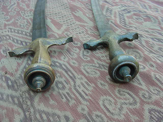

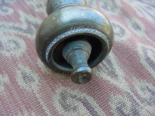

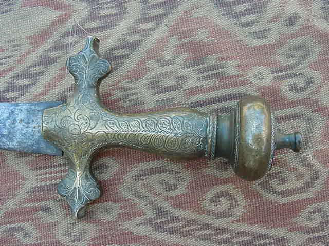

I far as I know piso-padangs if I am spelling it correctly are Batak. Here is a picture of mine for comparison.

That's probably impossible to see (unless you know were they were collected of course?). Maybe if we could see the scabbards there would be some signs of origin?
As you know those, originally Indian, swords were very popular trading blades in both regions. It's documented that they also were manufactured in the arms factories of Brunei at the end of 19th C for domestic use in Borneo. The Iban Pedang usually doesn't have that kind of very floral decoration on the hilt as one of your examples.
Maybe that sword is an Indian trade blade?
Some people say that the "open cup" is typical Batak but I guess we all also have seen Batak Piso Podang with closed cup like yours?
Dajak, what have you found out yourself?

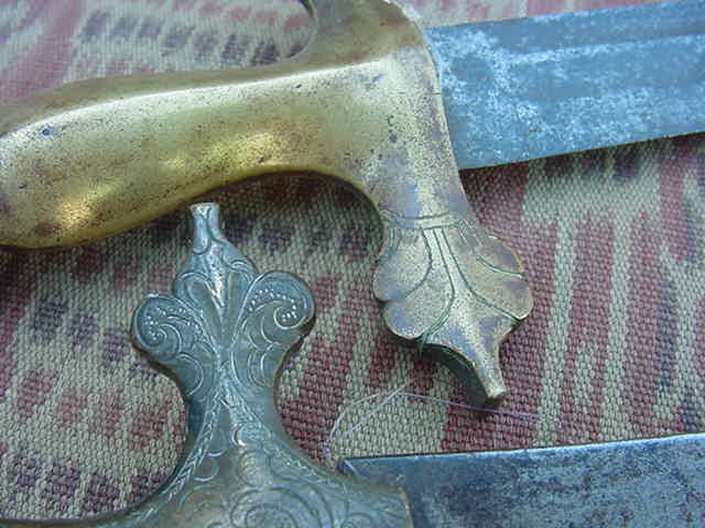

Hi lets say I did only see a batak piso podang with the plain hilt
And did see a brass hilt from an parang nabur with the same as in the pic

As far as I know these swords are Batak. Both Tirri and Stone reference them. Here is a picture of mine, with open cup style hilt.

Hi yours looks more a batak sword than the one from vvv

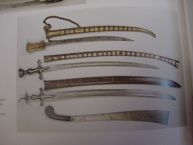

here are some pics that show a dajak batung lupar that did use these swords too
And some pics from an Batak book

I am a bit disappointed and don't buy the old open cup/closed cup classification as a 100% indicator of Batak or Borneo origin.
As you know I have f.i. an extremely long Batak PP with a closed cup that once was in your collection.
The other reason, as I described above, was that several of them were popular trade blades produced in India and for them the open/closed cup tell sign doesn't work either.
The famous PP in Tropen was collected among Toba Bataks and has a variation of closed cup.
Also at least 3 of the Batak Piso Podang in the Leiden collection has closed cup (but I suspect two of them are trade blades).
However I agree that most of the time the Borneo Pedang hasn't open cup.
But sometimes the Batak Piso Podang has closed cup...
It's a tricky sword to classify and I think a lot more research has to be done on it.

I like to get more information about this too

Take a look at this Handle this one sure Borneo

That's a beautiful and rare Parang Nabur - congratulations on the nice find!
But to make it an indication, or a trend, unfortunately I think you have to find at least five of those that has survived or been documented somehow?

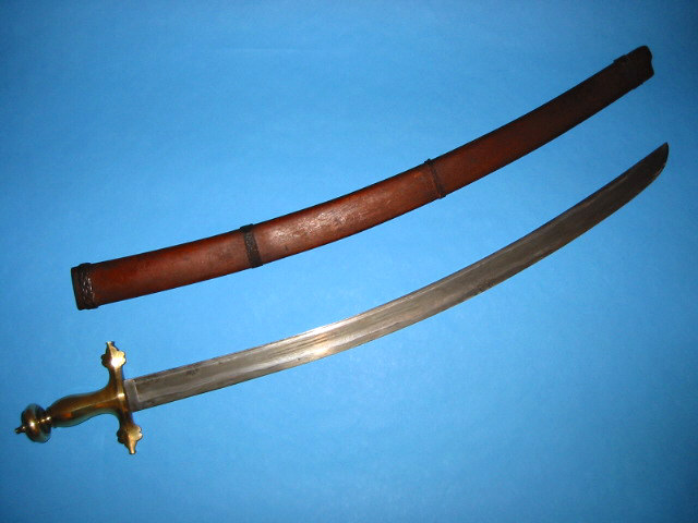

Here is a steel hilted Malay piso podang: the scabbard is definitely Sumatran.
Teodor

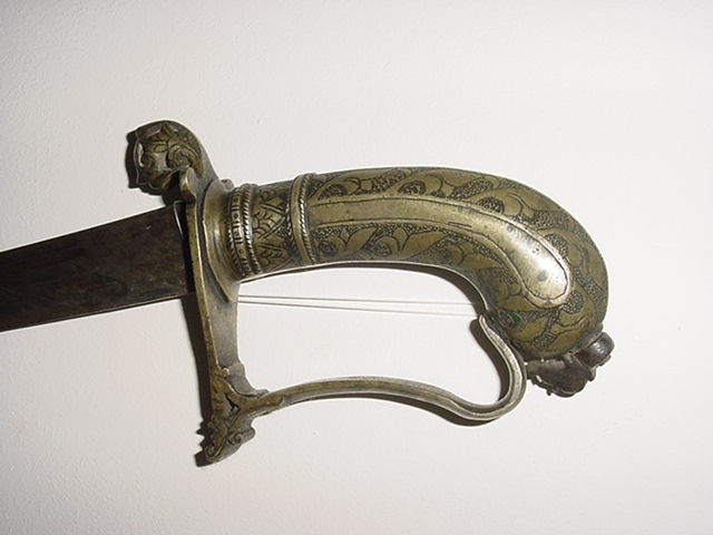

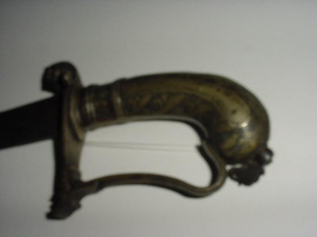

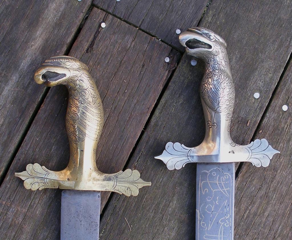

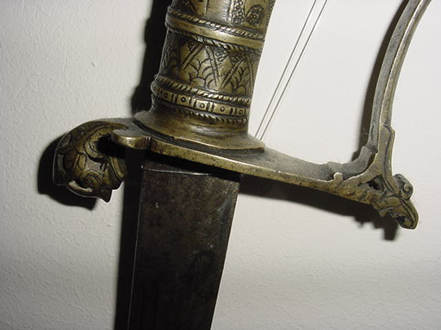

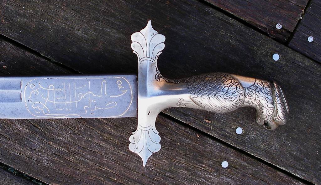

Not to barge in here, but while we're discussing sabres of this ilk, can any of you give me a hint as to the origin of these two?
I have only seen 3 of these in my years of collecting edgy stuff and would love to know their origin.
The blade with the unknown script is puzzling because the wire used for the inlay crosses the blade edge and continues to the other side and more unknown script.
Thanks
Old 12th October 2017, 05:11 PM   #17
To the best of my knowledge these are Sumatran.

Look like the Handle s made in Malaysia .

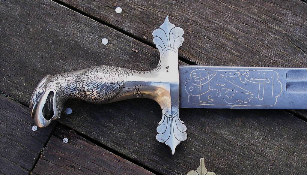

Hello Ben & Ariel,
This eagle-like hilt is not Batak and probably not a very old style (late 19th century?); I'd agree that it's very likely ethnic Malay in origin.
Whether any given example originates from either side of the Straits is probably a moot point considering the mobile life style of the coastal Malay population in the region, at least prior to independence.
