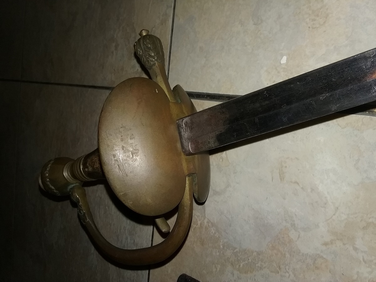

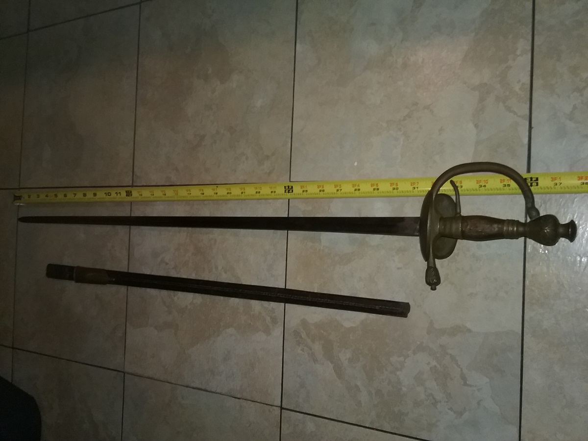

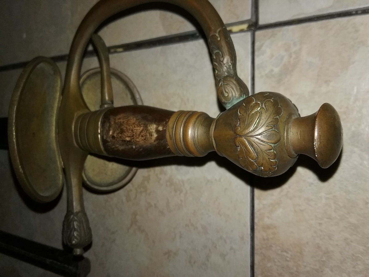

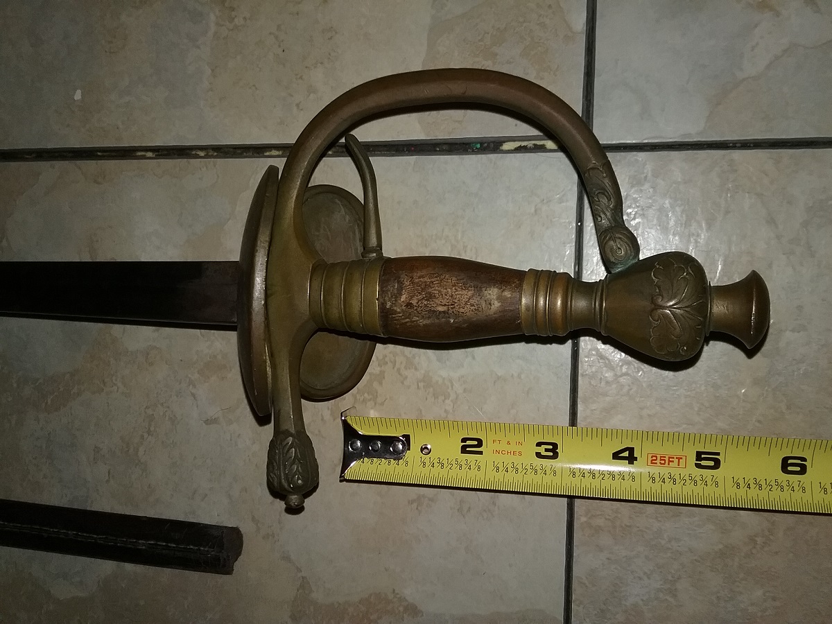

Hello all,
I'm hoping some of you will be able to provide some information on the item pictured below. Approx 38" overall, 31" straight/single edged blade. I haven't seen this hilt form before, but my experience is VERY limited. The guard is totally unadorned. There are simple (but cleanly executed) oak leaves rendered on the pommel and finials. There also are nearly invisible oak leaves on the blade, but I cannot get them to show in a photo.
I initially assumed it was a repro, but am not so sure. Even so, is it intended to represent an actual model? Fingers crossed.
As always, thank you for sharing your expertise.

Hello Shayde,
its no repro but a German or better Prussian model of 19th C small sword.
These were also made for export to other countries at the time.

as Ulfberth said, this sword looks like a german IOD aA (Infanterie Offiziers Degen alter Art), which means Infantry Officer Epee old type.
The short ricasso means normally around 1860 or earlier but there is no signature and other decorations and the hilt is not the same as on my IOD.
references: http://www.zietenhusar.wg.am/iod_aa/
Roland

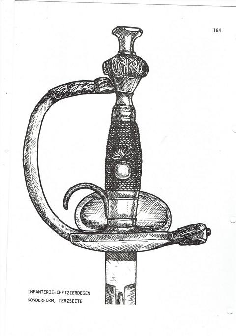

danke schön.
drawing indicates it is a special or alternate infantry officer form. (sonderform), with the shell about to explode on the grip wrapping. grenadier?

corrado26
corrado26's Avatar
Join Date: Dec 2014
Posts: 1,268
The owner belonged to one of the Prussian Guard Grenadier Regiments

Revisiting the piece in the original post, any advice on how to restore the missing wire wrap on the grip?
