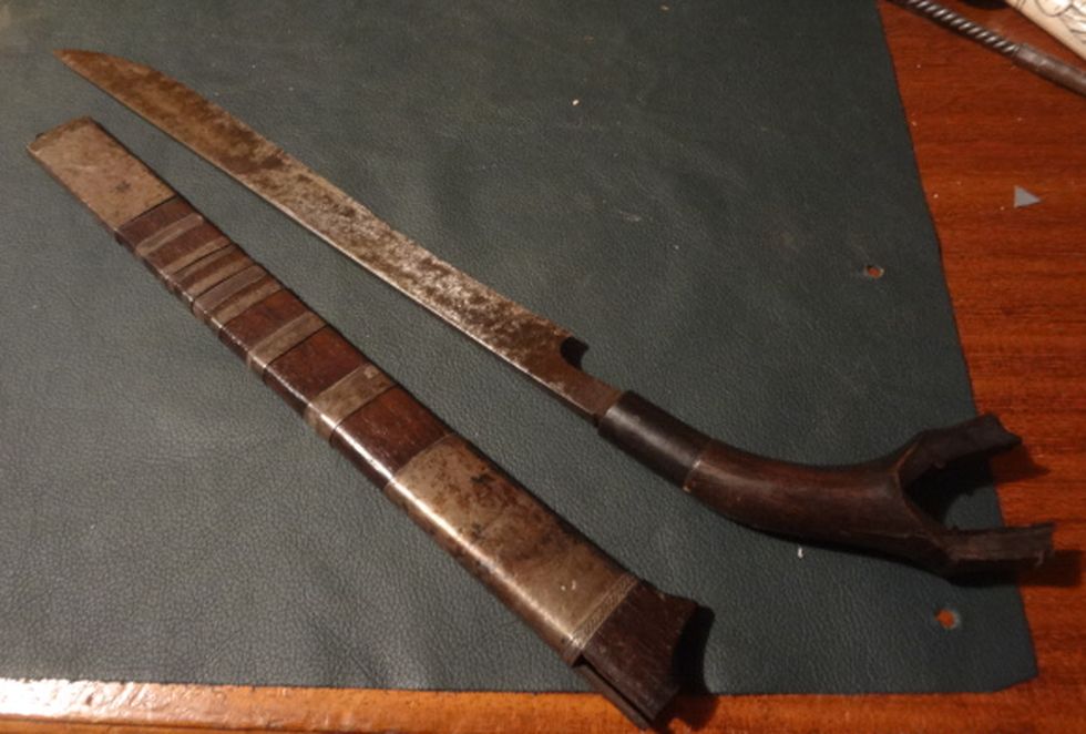

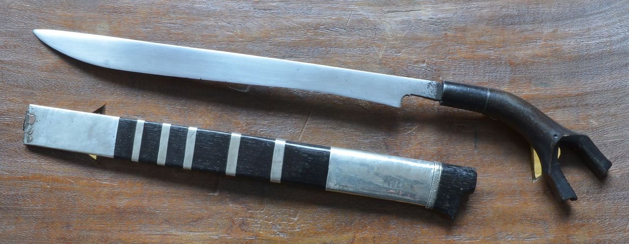

after restoring this nice Sumatra dagger, it became one of my favourite daggers in my collection.
According to Volz it is an old Karo-Kalasan as a dagger with a 30 cm (almost 12") long Taka-blade.

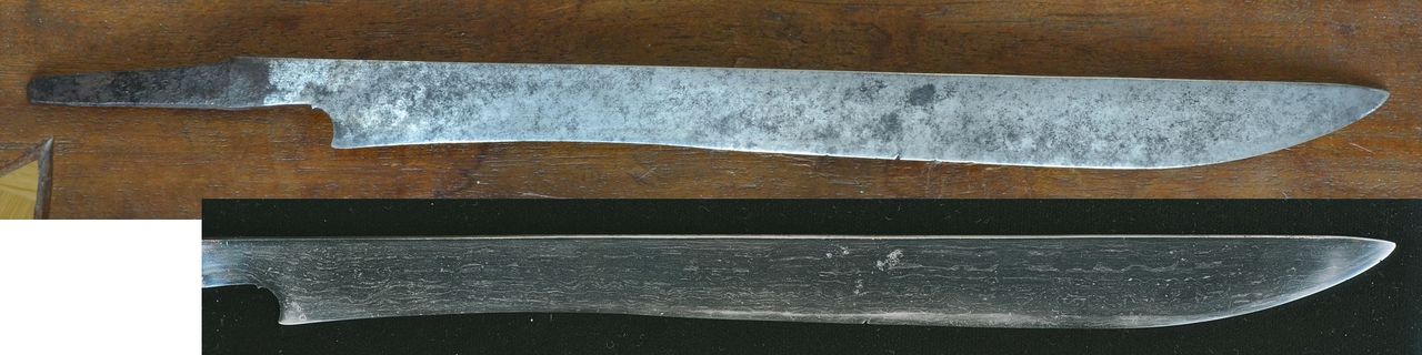

I received it in a very nasty condition, deep corrosion and active red rust.
I quickly decided, that it is worth the effort and this was a truly exhausting decision.
The blade was extraordinary hard to grind and polish, eats sandpaper like peanuts.
It took more than three weeks to grind and polish a simple shaped dagger! But the result is worth every effort.

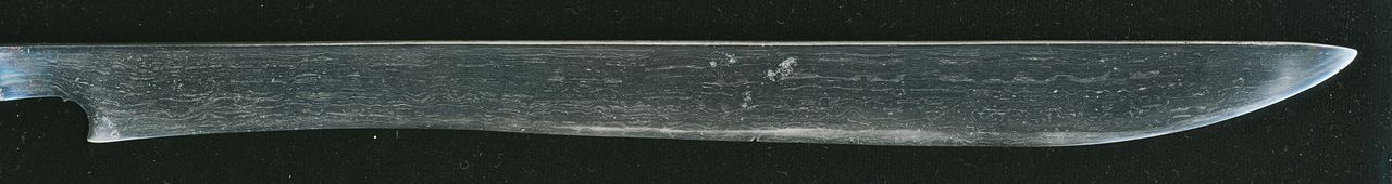

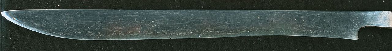

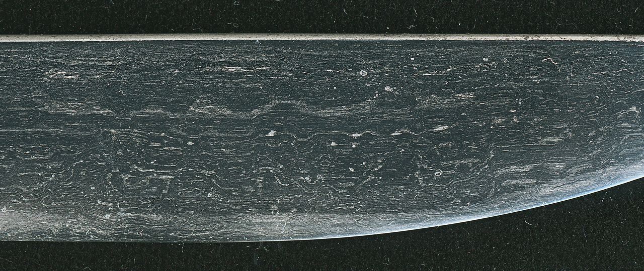

It is a perfectly laminated shear steel with a wavy pattern a nice Hamon on one side and probably with an inserted cutting edge.
I`m really happy with my Kalsan and this was just the beginnig of a wonderful year 2017 for my collection.

Thanks for the comments, I really like the feedback.
The most important reason to restore the blade was its condition. Absolutely no visible sign of laminations and I was just curious to see whats hidden. Even after the polishing the surface of the steel was looking like monosteel. It is quite rare to find an old blade without the tiniest flaw. This is truly a masterpiece of forging and important for my private research.
Apropos wootz, just do it, you will not regret it. I have often serious doubts during my work, destroying the patina, losing material (less than 1 gram of pure steel in this case) and more. But if you put a lot of effort in one blade and after etching you find an Indonesian Wootz blade as a pedang (no reworked Shamshir, Kilij or Tulwar), this is first almost a little disturbing but than just WOW, absolutely unrivaled!

This is a fine job of restoration Roland, as I am sure you already know, and have already been told by others.
However, were I you, I would not give it a topographic etch. These Indonesian blades that we are accustomed to seeing with topographic etches, and "in your face" stains were not like this when originally made. They were bright, smooth blades with just sufficient stain to see the pattern. I'd leave this blade as is.
