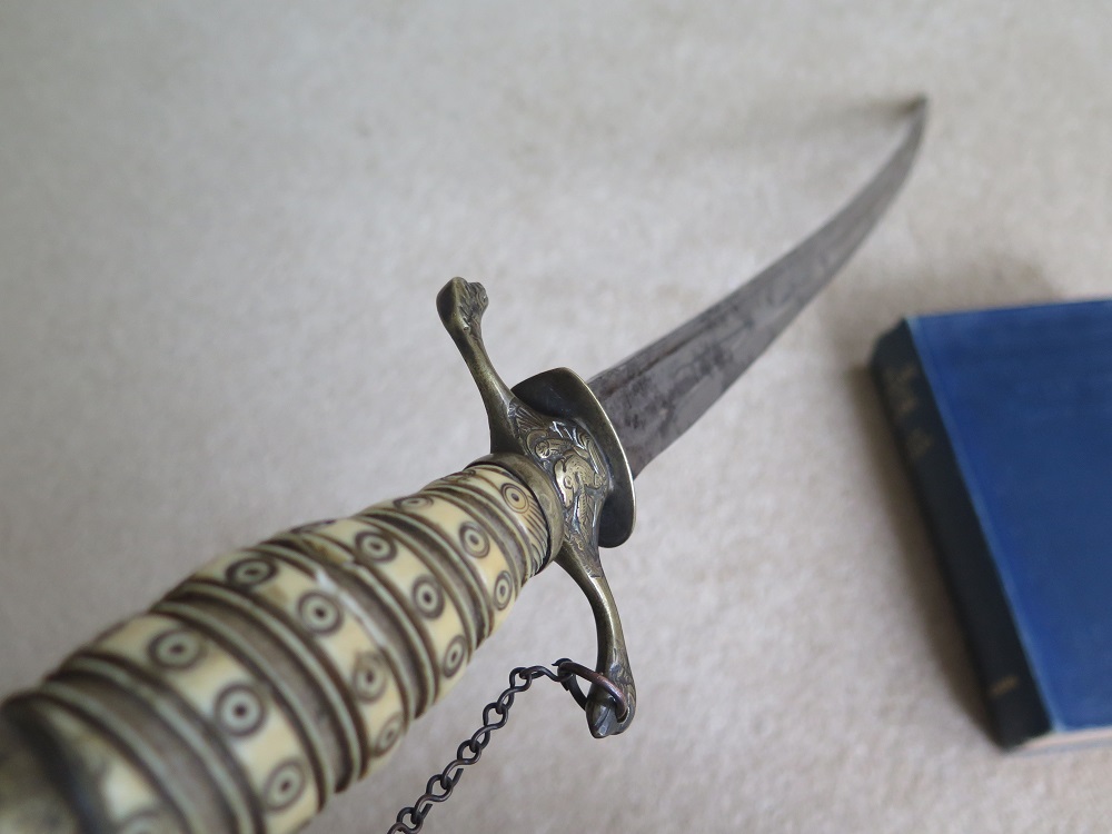

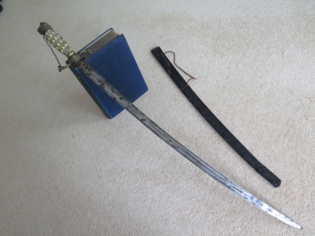

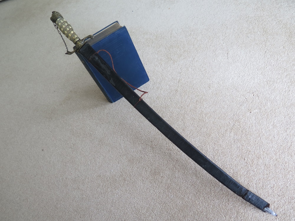

Hope we are having a good day.
Not too experienced with this type.
Comments welcome, many thanks

VERY NICE Jon!!!

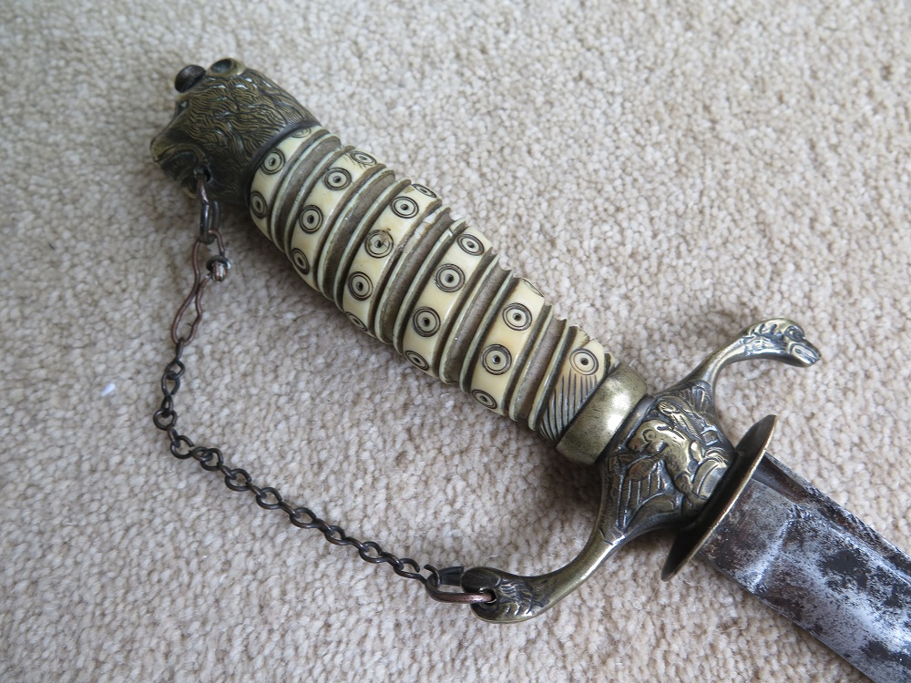

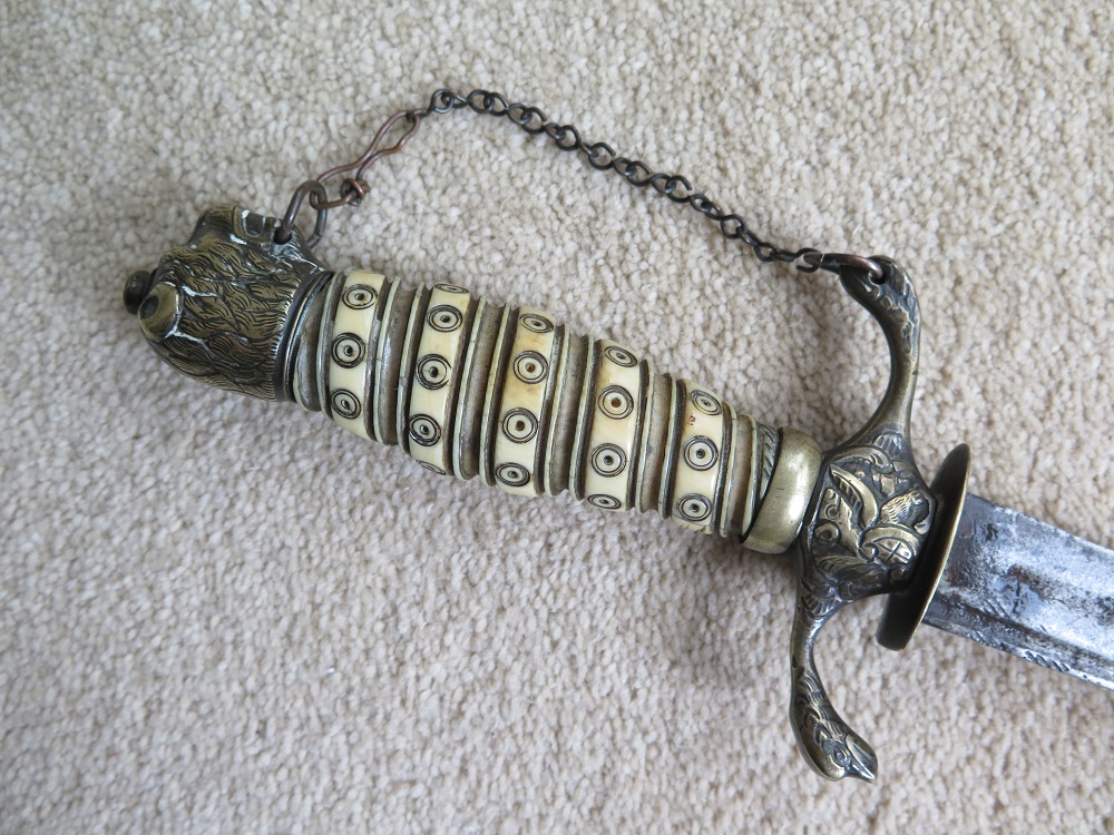

As always, I turn to my trusty Neumann ("Swords and Blades of the American Revolution", 1973), and on p.98, 110.S is pretty much an identical (or dramatically similar) hilt. Described as an English cuttoe c.1750-80 and as used by officers in French-Indian and Revolutionary wars.

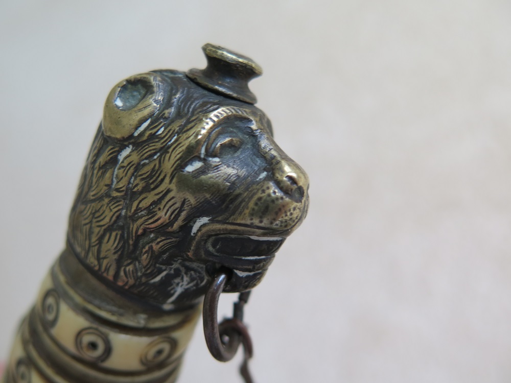

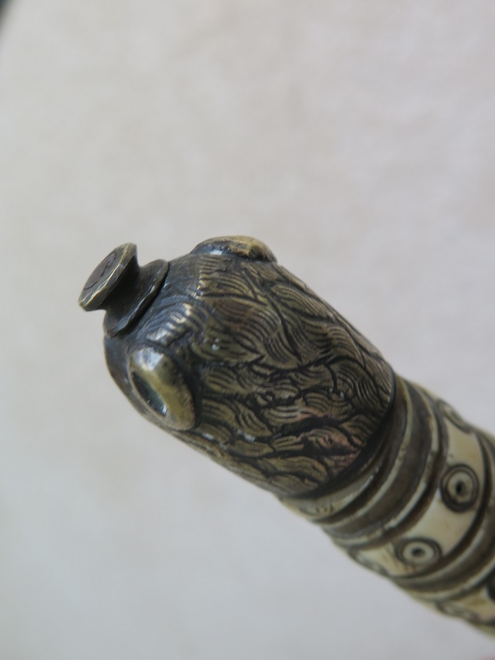

The pommel is not a 'dogs head' but a lion head, with these often sold and traded between furbishers along with various hilt components. The ivory grip here would normally have silver banding in the gadrooned channels.
The dot and sphere device is a widely used decorative theme which it seems was quite present in the decoration of Scottish swords in some cases, so possibly might lend to that sort of connotation. On the other hand, Neumann (p.122, 181S) is an American version of 1760-80 which has a bone grip with stained in spherical devices in similar patterns, and these kinds of decorative stylings seem to be more prevalent in the Colonial examples.
The blade is much like that in the Neumann example, which I think has been termed a 'Montmorency' type cross section. It would be great if there were any signs of makers marks.
As always, hoping for Glen to show up here.

An absolutely beautiful sword, Jon. Jim pretty much summed it up. I would only add that these lion pommel swords were very popular with English/American officers in both army and naval settings. Here's mine-
http://www.vikingsword.com/vb/showthread.php?t=14342

Almost forgot something important Jim pointed out. This item does appear to have the classic Montmorency blade pattern, another tip of the hat that it might be naval (I know some Forumites are groaning...everything is 'possibly naval' to me! )

Exactly, Jim! Unlike all the other military branches in Europe and the colonies, specific naval models were rare, with most weapons being those convenient enough to use in the tight quarters of a ship (hangers, hunting swords, dirks). There were virtually no model patterns until the start of the 19th c. ! Officers carried whatever tickled their fancy, private merchant vessels placed orders with local blacksmiths to put together primitive cutlasses in batches to fit out their ship (private purchase weapons, as previously mentioned, could have any one of a combination of hilts, blades, etc). Likewise, don't even get me started on pirate swords!!! As all manner of riffraff sailed with the Saley Rovers, one might see tulwars, shamshir, baskethilts, etc, all on the same crew! Pirates picked up what they could in their raids and didn't discriminate. With no rules telling them what they could carry, anything was fair game.
Getting back to the lion hilt, however, it is well documented that naval officers and army officers on 'both sides of the pond' used them. In Boarders Away, Gilkerson pictures one with provenance. The Maritime Museum in Greenwich likewise has some interesting examples...
