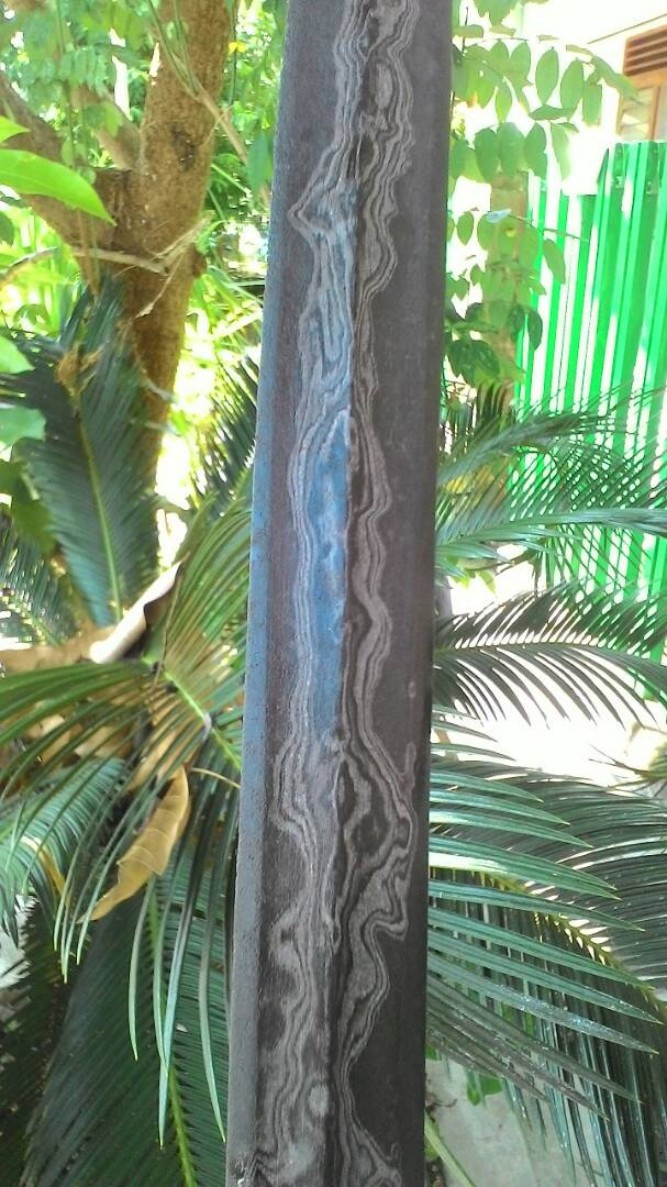

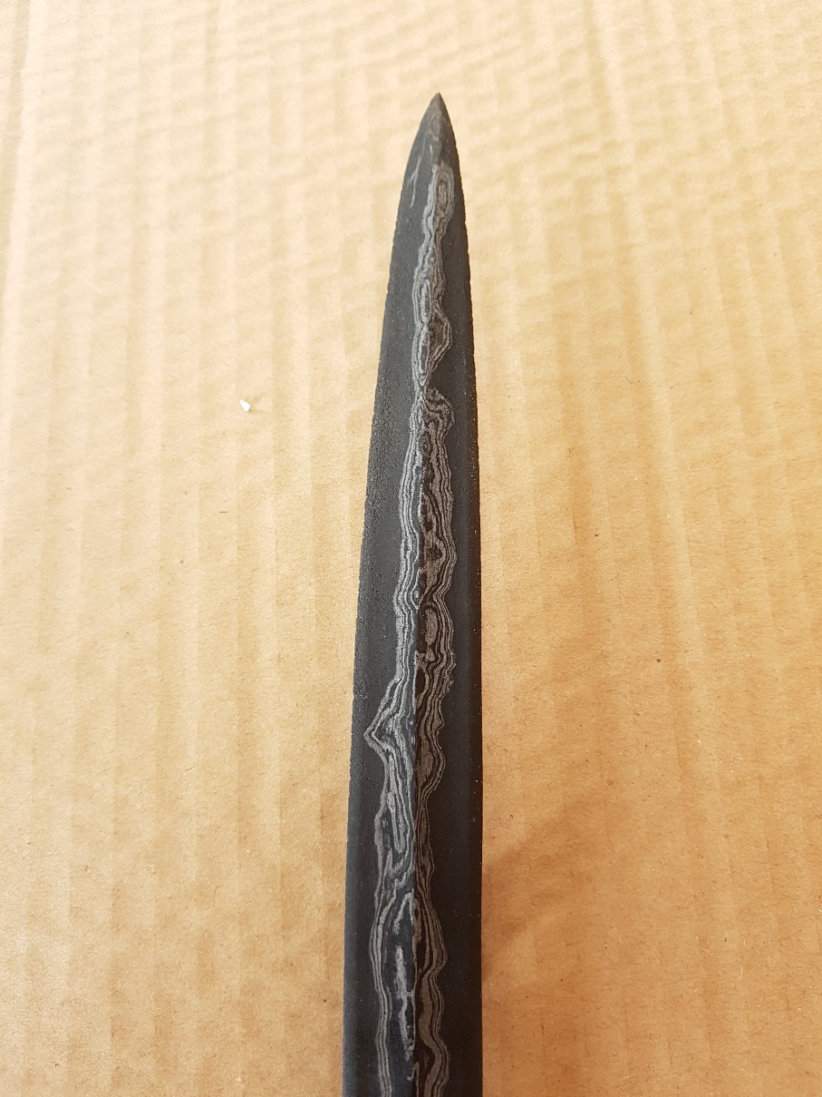

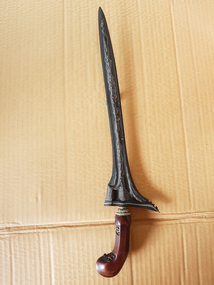

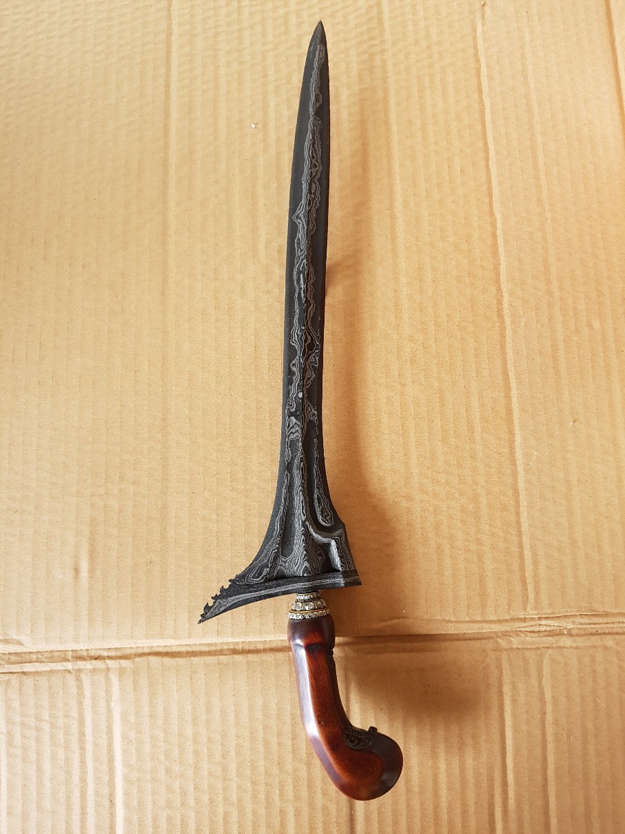

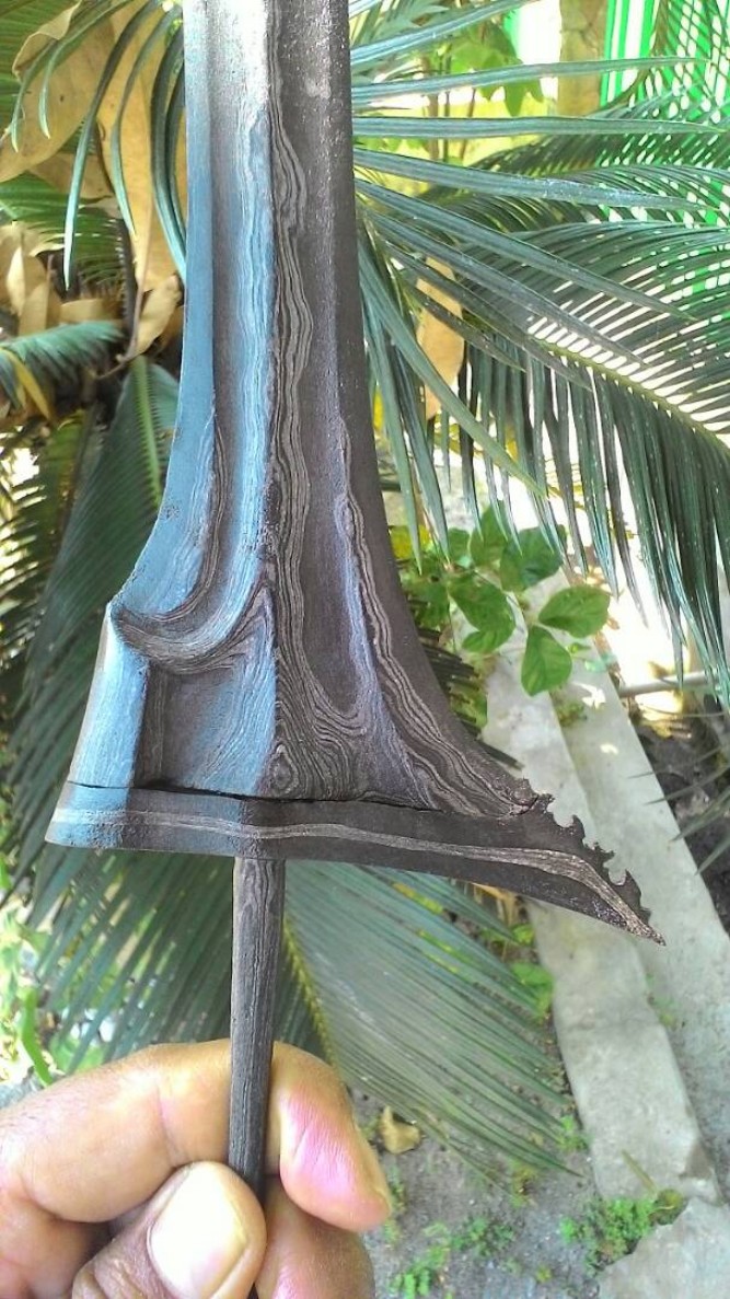

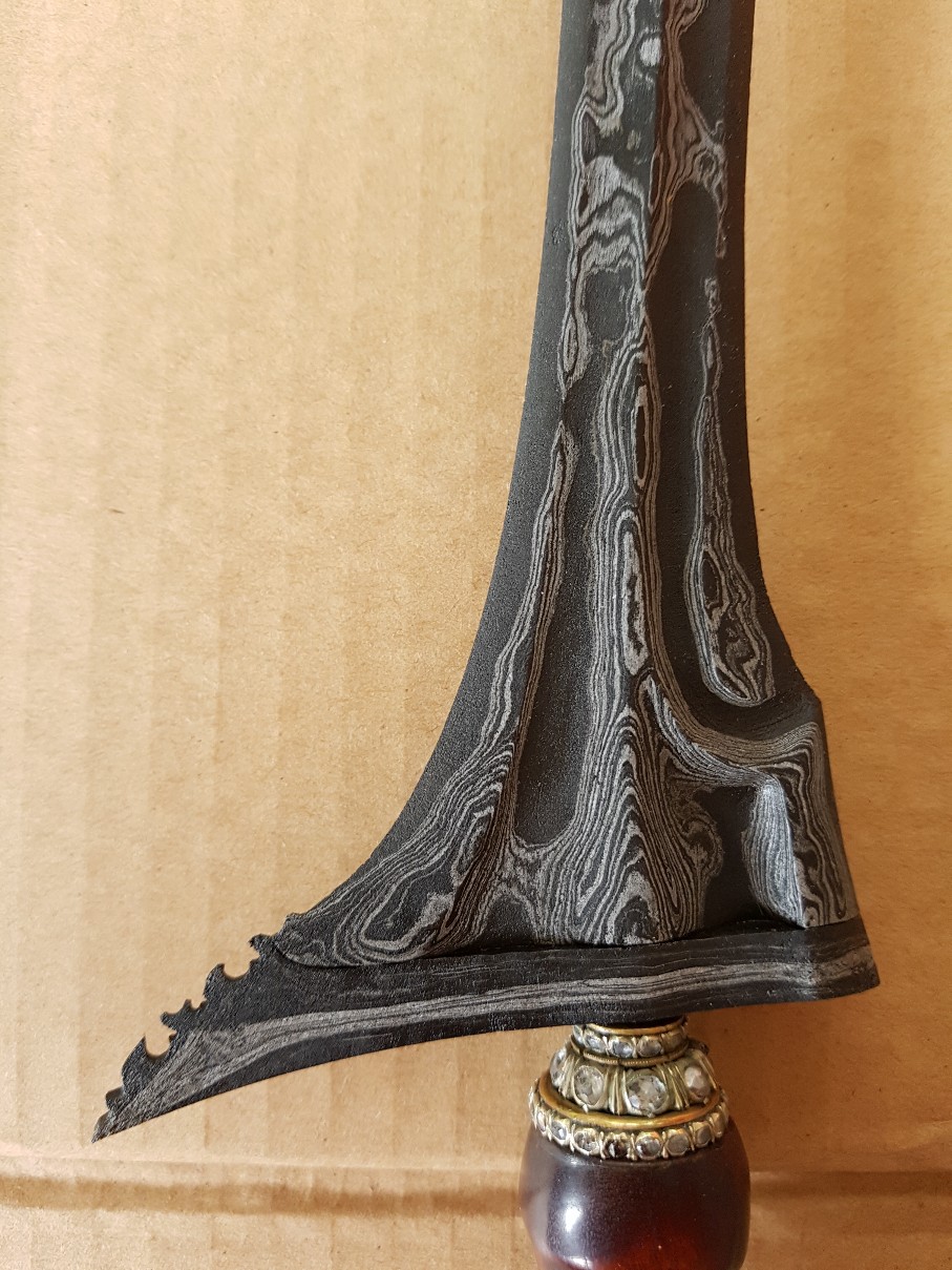

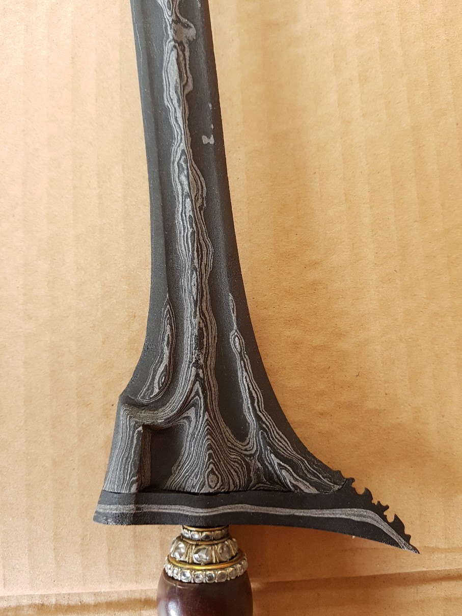

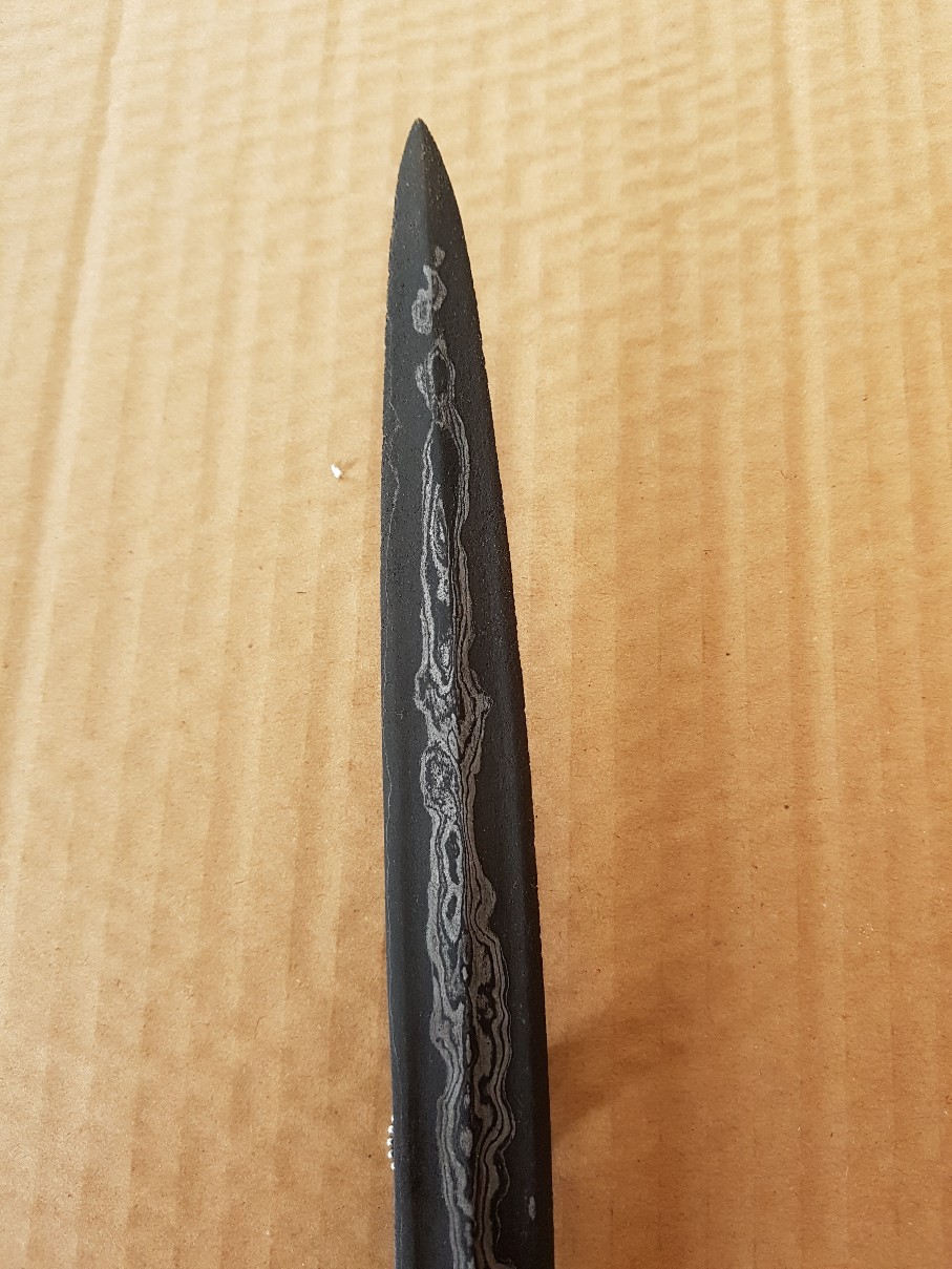

I bought this keris because it had uncommon pamor visual. The pamor had a malela looks. (Hard to describe, will add the picture below). But, when I cleaned (warang) it again, the pamor's visual become quite normal now. There are a couple of things that confuse me to determine whether this keris is sepuh (old) or kamardikan.
In my opinion, things that indicate that this keris maybe old:
1. The form of the greneng. I think it is hard to find this kind of greneng in kamardikan keris. But, maybe I haven't seen enough samples to compare with mine.
2. There is some corossion in the wilah, like in the landhep part, in gonjo, and in the some part of the wilah that looks like it was formed due to long times. But, once again, kamardikan keris timeline is quite long, has been 70+ years now. Maybe in decades it can creates some corossion that similar to my keris.
And things that make me doubt to determine is sepuh:

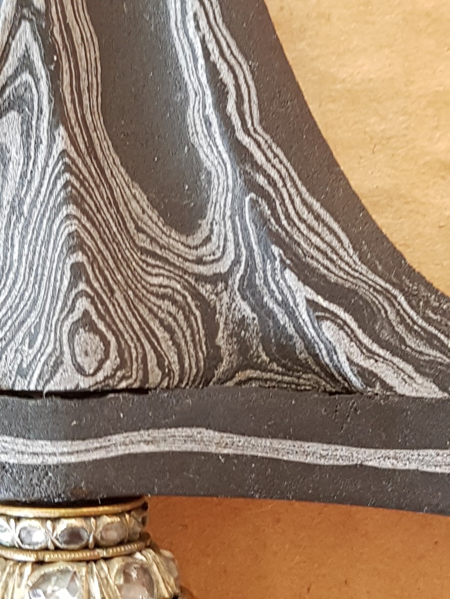

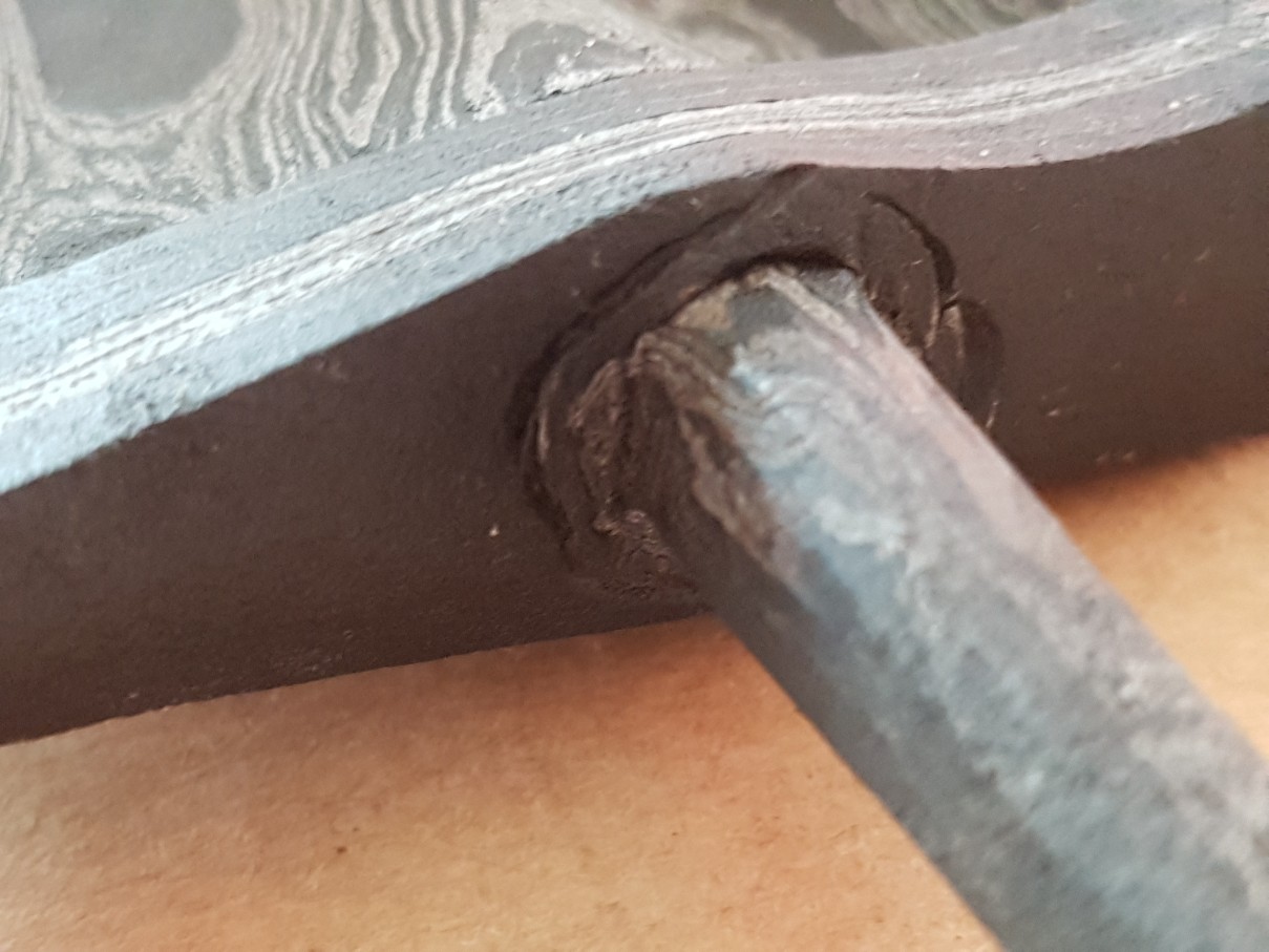

1. There is some rough work in this keris. There is some scratches in both side of tikel alis dan pejetan.
2. The form of gonjo. Like in the picture attached, there is a uneven thin bulge on one edge of the gonjo.
3. There are scratches on gonjo and pesi joints. I have never seen that kind of form in other kerises.
Hope anyone is willing to share his opinion to me.
Thanks,
Joe

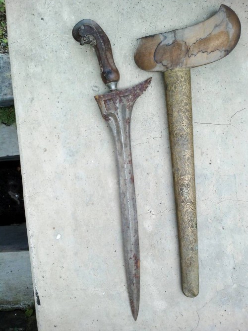

Hello David,
I have attached the photos, but I dont know why they did not show up. Thank you for your information . Hope the photos will shop up now

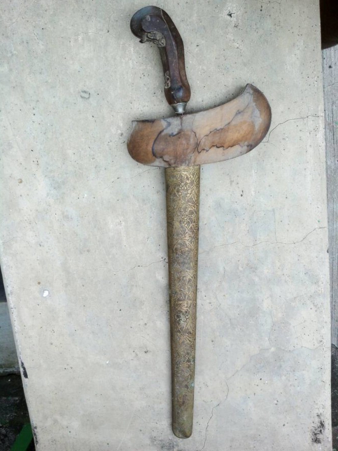

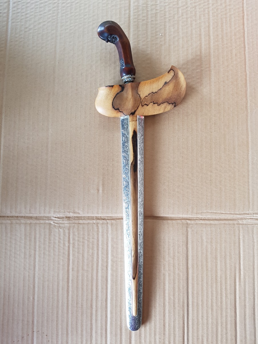

Additional information :
Gayaman in the picture is the original warongko when I got this keris. I just replace the old gandar and pendok (banyumas bunton style use mamas) with new ones like in the picture. My mranggi just resharpened the edges and "gebeg ulang" (dont know the English words) the gayaman.
Thank you,
Joe
Bejo is offline   Reply With Quote

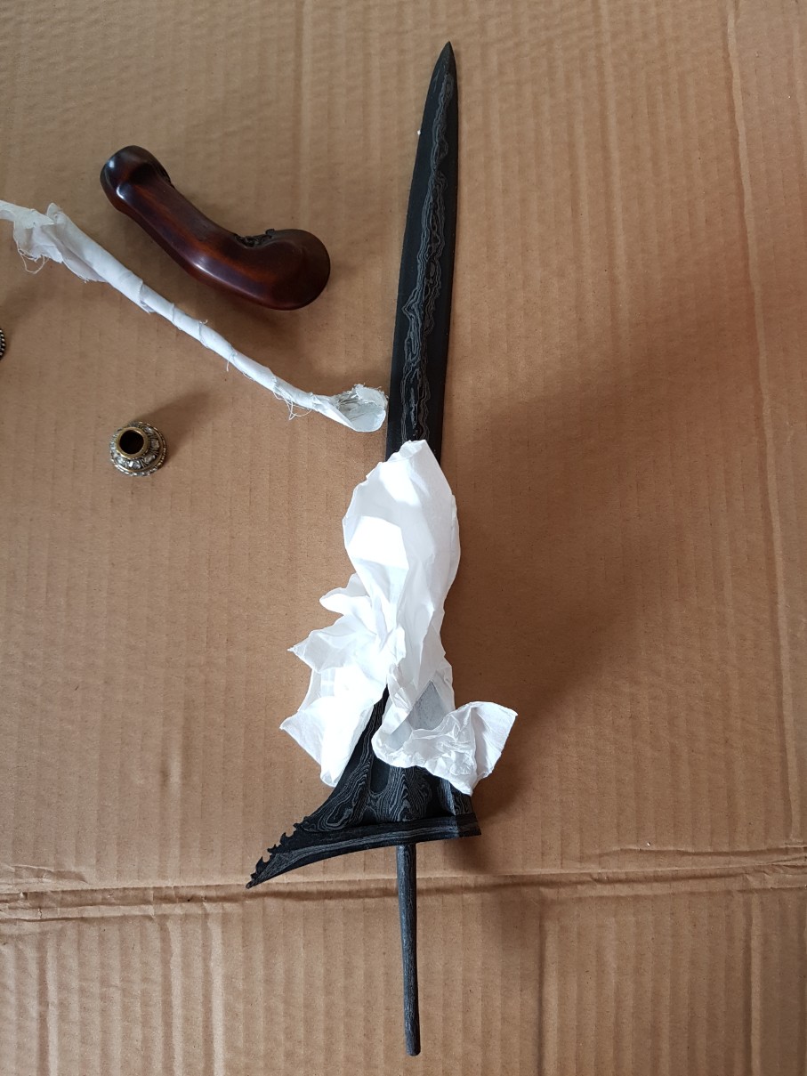

More photos about :
1. The original warongko and still dirty keris.
2. The keris after the first warang with more malela looks like pamor.

What a mess around the pesi hole!
Hello Jean,
Yes, I agree with that. Do you have any idea the cause of that scratches?
Thank you,
Joe
Old 8th August 2017, 10:57 PM   #9
Posts: 7,229
Yeah, the way in which the gonjo has been fixed is a bit untidy, but whoever has done it has probably done the best he could.
From the pics, it looks like the hole was too big, or the pesi too small, so a collar has been made to reduce hole diameter, and then that added collar has been tightened by punching with a drift. This sort of repair is an old one, before we had things like wonder adhesives. In my opinion it is an enhancement to the collectability of the keris, rather than something undesirable:- it tells the story of the keris.
Thank you for your explanation. It enlightens me about this keris more.

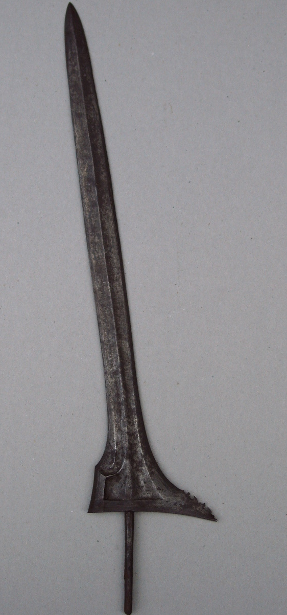

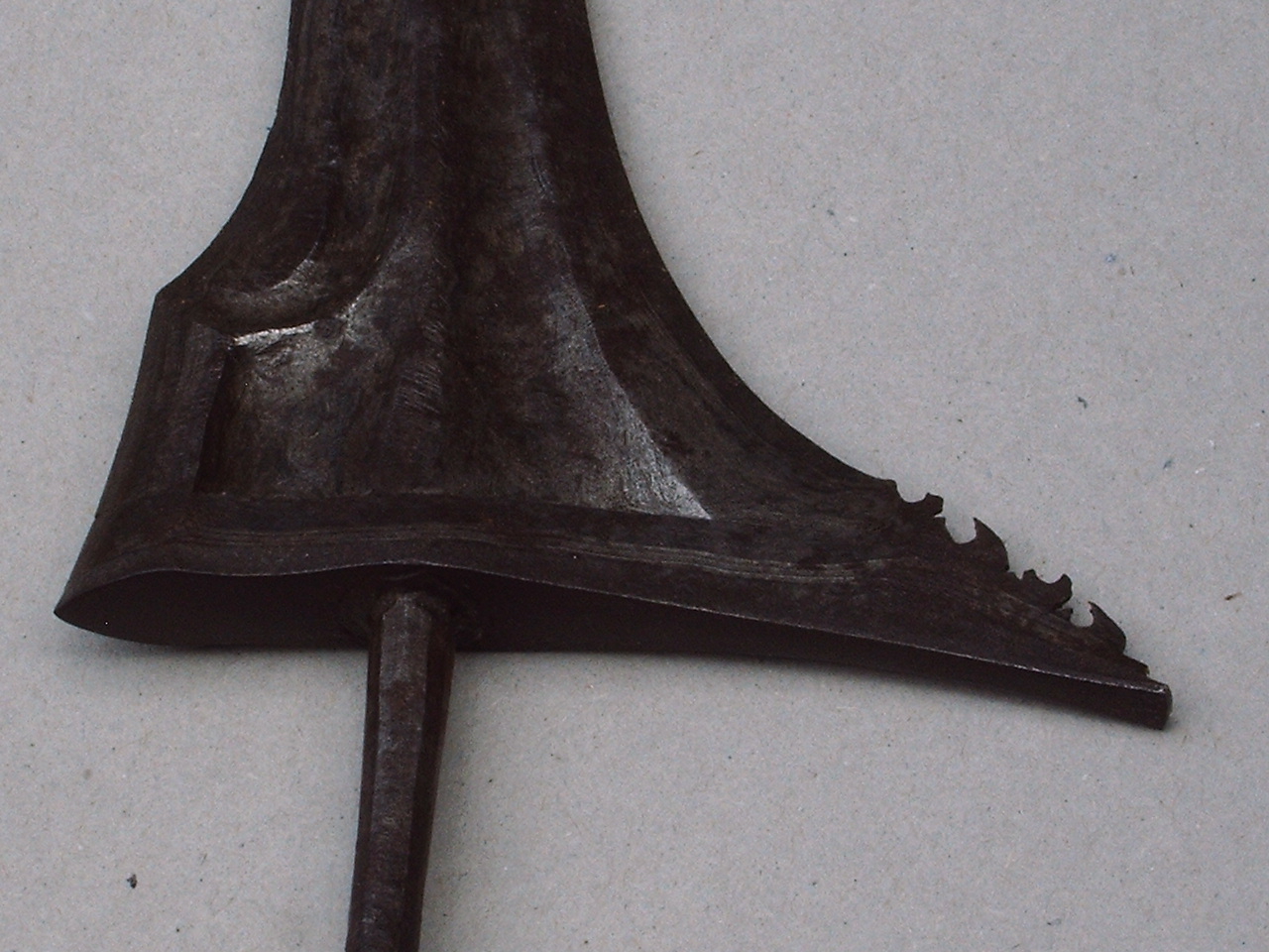

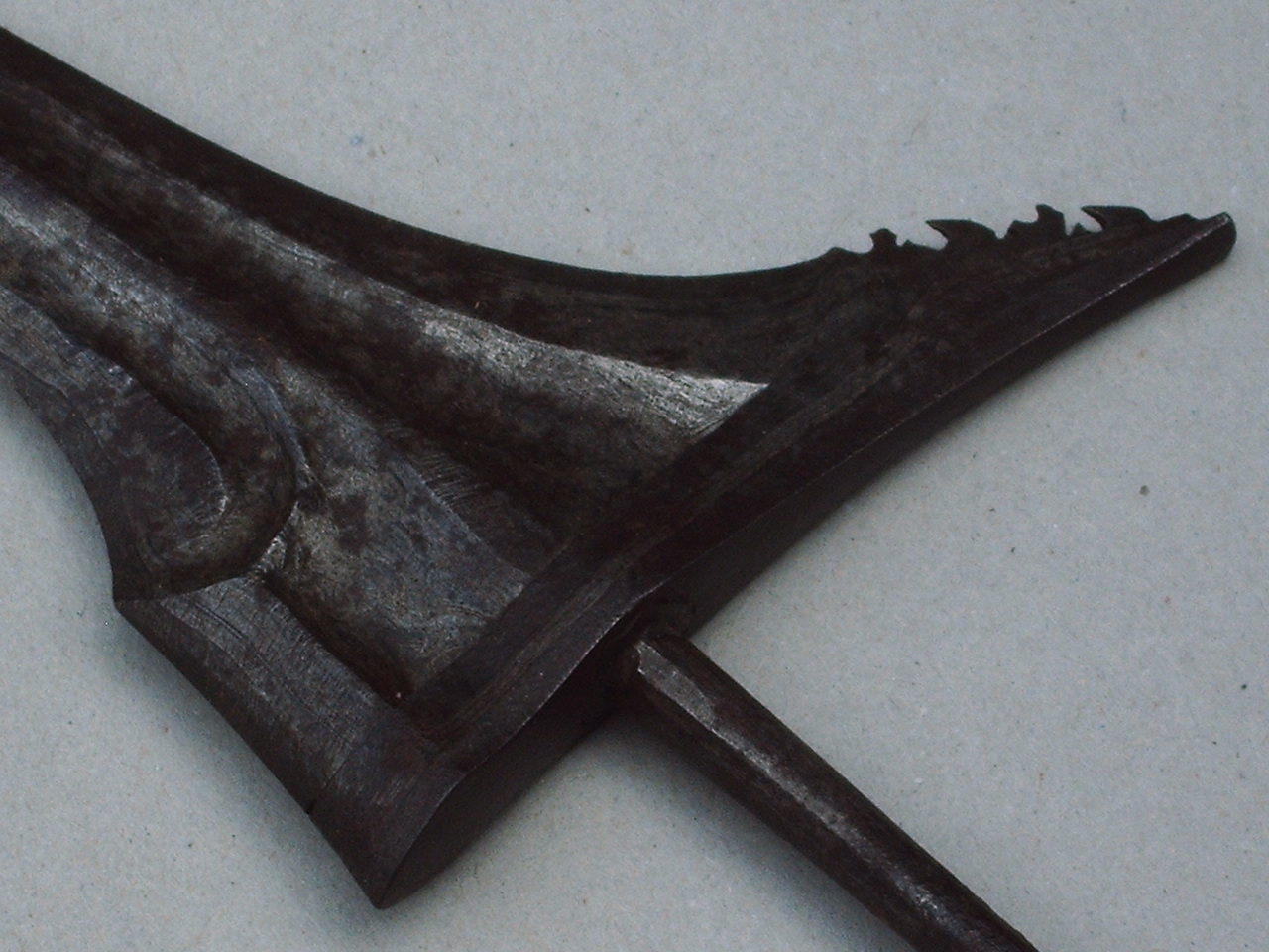

Joe, this one with some certainty could be the same maker or workshop. It's obviously unfinished.
With 38,5 a quite sturdy blade, my feeling ist East Java. It's surely not Magetan, yet resembles one in the hand, and Magetan had Yogya roots.
Pre- or after WWII? I don't know. Are there other workshops in East Java besides Magetan, where Keris making didn't stop after WWII? Where?

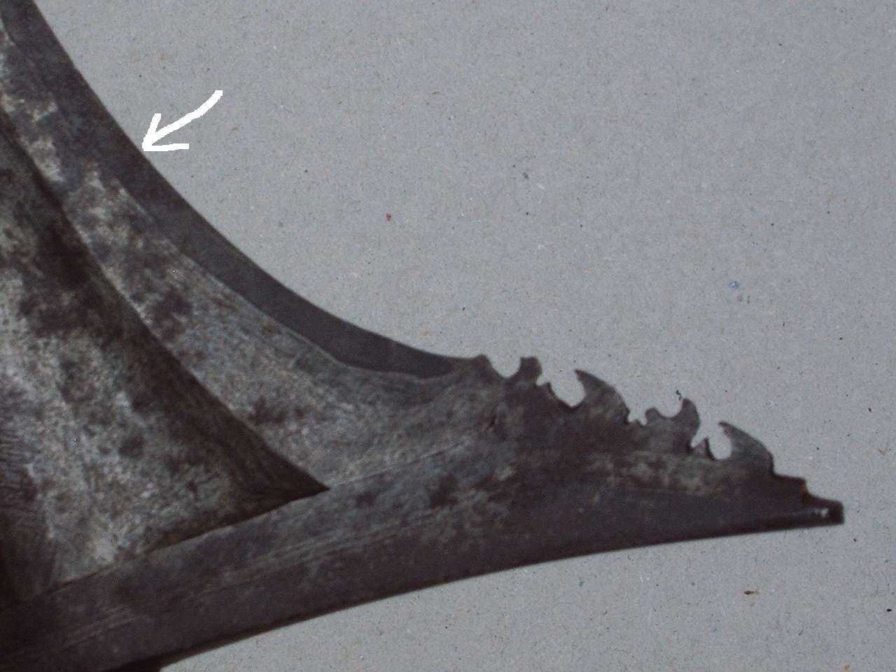

If we look at Gustav's example we can see a couple of really badly cut Surakarta ron dhas, and the same method of fixing the pesi as was used in Bejo's keris.
Magetan is right on the border between Central Jawa and East Jawa, and it is closer to Solo than Jogja, yes, East Jawa, but the people there lean to Jawa Tengah, not Jawa Timur. Magetan had Mataram roots, rather than Ngayogyakarta roots, but after Giyanti it became Mancanegara of Ngayogyakarta.
I do not believe that these two keris are from the same maker, but I do feel that they are both productions of an Empi Mageti, which one I have no idea, but again, just a feeling, I think Gustav's example is possibly Empu Paku Rodji, based upon what I have heard.
Gustav, you say "Surely not Magetan", but I think it could be. What do you know about this keris you have posted images of Gustav?
EDIT:- THE TANGGUH THOUGHT PROCESS
It has occurred to me that some people who read this may find additional information that relates to the process of classifying a keris (tangguh),useful, and these two keris are in my opinion pretty good examples to illustrate the thought process.
Never forget:- "tangguh" is an opinion , others can have different opinions, and the same person can have different opinions at different times.
Bejo's keris displays a lot of Surakarta characteristics:- it is a large, strong keris, it has a full length ada-ada, the gonjo from the side seems to be very close to Surakarta, the kruwingan and especially the tikel alis are like Surakarta, there is a kusen (gusen), however, the greneng is uncontrolled it mixes ron dha types and neither of those types are well cut, in fact they are very poor, the blumbangan appears to be square, the overall standard of finish is poor. These negative features do not permit it to be classified as Surakarta.
The tangguh system was initiated by Surakarta nobles, thus any keris that is to be given a Surakarta classification must display a noble standard of work:- pride does not permit somebody from Surakarta who understands tangguh to admit that any Surakarta work could be less than excellent, tangguh is not just about aligning a set of characteristics, it is about other things as well, things like belief and honour. The most highly regarded tangguh classifications are those which are associated with eras or places that Javanese people believe hold an honourable value.
Bejo's keris has a square blumbangan and one ron dha is closer to a Mataram (Jogja) pattern than to a Surakarta pattern, combined with the negative features, this is sufficient to place Bejo's keris as Jogja. Jogja tangguh is pretty much a generic classification, within Jogja there are a number of sub-classifications such as HB (Hamengkubuwanaan, the best), through Koripan and Godean and a couple of others. One of those others is not Magetan, the reasons for this are buried in history, Magetan is on the border between Central Jawa and East Jawa, and historically probably aligned itself with Solo, but after Giyanti it became a territory that was the responsibility of Jogja, thus the confusion in style.
Now, if we look at the keris that Gustav has provided as an example, there are a lot of similarities to Bejo's keris, the most notable similarity is the way the gonjo is fixed, this sort of fixing method is normally used as a repair technique, but in these two keris it looks like it was done as original. Why? My guess is that the hole was not precision drilled, or punched and then filed to size, but it was rough punched and the collar used to take up the slack. Both keris must come from the same school.
The greneng, ron dha, tungkakan, kruwingan, ada-ada in Gustav's keris is of the same overall style as Surakarta, the tungkakan --- which can be difficult to cut --- is a neat fit, the greneng is the same style as Bejo's keris, but the two ron dha are very much towards Surakarta, not Jogja at all, however, they are incredibly badly cut. The blumbangan is square, pawakan is adequate for Surakarta. Gustav has said that this keris is unfinished, in my opinion, no, it is not. According to what I have been told, this is the standard of work that we can expect to see for Magetan. It is a perfectly functional keris, but it is most certainly no work of art.
So if we give Bejo's keris as "Jogja" --- a classification that I am now inclined to think borders on unsupportable, and we disallow Gustav's keris as Surakarta because of the quality of workmanship and blumbangan what are we left with?
It must be a classification that displays Central Javanese characteristics, that includes stylistic expression that is mixed and workmanship (garap) that is of very low quality. I am now inclined to believe that both these keris could be tangguh Magetan.
There are a lot of minor classifications like this --- Matesih, Kajoran, Godean, Madiun --- some people disallow them as proper tangguhs on the basis that the quality does not reflect what should be seen in a good keris, and there is no nobility attached to these places, however, the way tangguh is used right now, I personally think it is probably legitimate to use these other minor tangguhs.
Stylistically there is nothing of East Jawa in these keris, even though Magetan is now administratively a part of East Jawa, both these keris are stylistically Jawa Tengah.
Last edited by A. G. Maisey; 10th August 2017 at 12:33 AM. Reason: additonal information

Alan, I bought that Keris about 3 years ago in Netherlands, no information came with it.
On Keris made by Empu Paku Rodji there is a small stupa-like carving at the end of Pesi, and, as I understand, that carving is tradition of Magetan. I don't know, if it was done on ALL kerisses, and my Keris is nothing somebody would have been proud to have made it. It's obviously unfinished, and that Greneng (and other Ricikan) does mean it wasn't made for selling it to another "Empu" to do the Garapan. Perhaps some deviation from a standard (speak mistake) was just to big.
Also, from the example I have seen, Tikel Alis on a Magetan Keris should generally be narrower.

In any case, whether this is Magetan or not, and in light of what you have just said, maybe its not, it is definitely from the same school as Bejo's keris, and it is definitely stylistically Jawa Tengah.
So what other options are there?
Not many. To my mind, the outstanding distinctive features are that gonjo fixing method + the low quality of workmanship. I reckon if we can ID where that gonjo fix was used as original, we might come close to giving a place or school of origin.

Hello Gustav,
Thank you for the photos. Yes, both of the keris have some custom similarities. Maybe they came from the same besalen. My keris is only 36.5 cm. I have tried to look for information in books I have, but they don't give any information about Empu Keris in East Java after WW2. The closest timeline I read in book (Wangkingan Kebo Ijo) stated that in Pakubowono 9 time, many keris maker in east Java and Madura have stopped doing keris work.
Hello A. G. Maisey,
Thank you for your opinion. At first I thought this keris as a Surakarta Keris. But, after I read your opinion this keris, maybe Mageti is one of the option we have. Also, I have tried to contact the seller of my keris. He told me that the keris was bought from a village in Magetan. The previous owner got this keris from his parents. Although there is not 100% guarantee that this keris is created in Magetan, but he got the keris there.
Thank you,

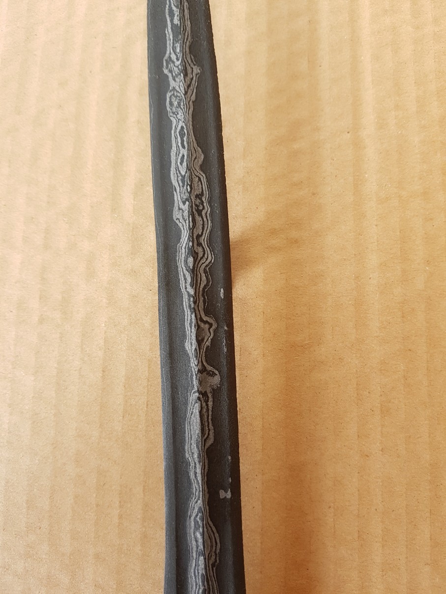

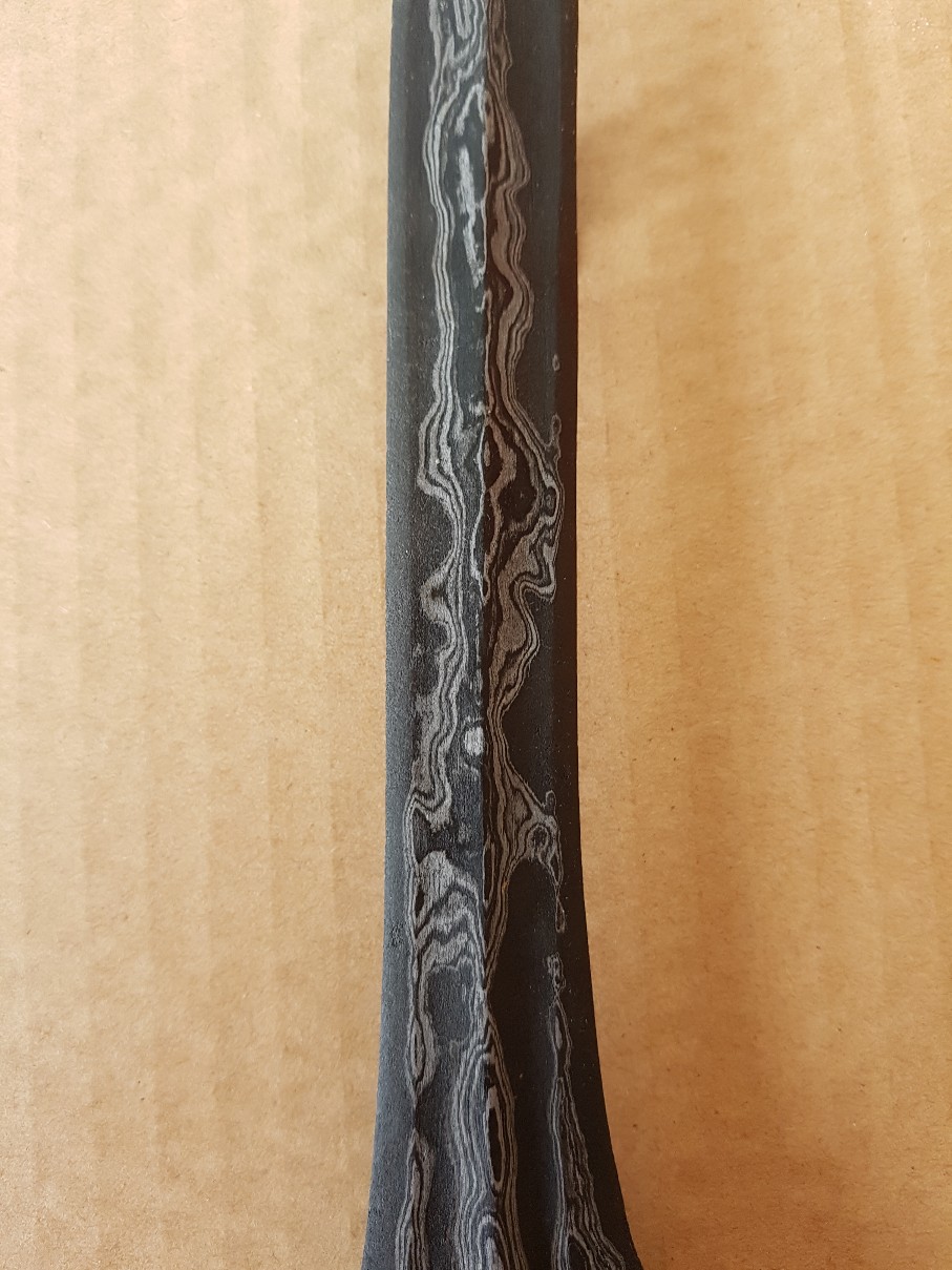

Both these keris have a core Johan, and it is very clear.
The easiest place to see it in both keris is in the wadidang, the wide curve at the blade base, the core is the narrow black border between the blade edge and the start of the pamor.

"Keris moves in mysterious ways."
Hello Gustav,
I really agree with that statement. Happened to me sometimes. Just dont look for the mysteriousness, but be grateful when you feel it.
Just my guess, maybe my keris is done by the Panjak. Maybe he still in the process for perfection, so there is still some rough work in this keris.
Hello A. G. Maisey. Thank you for sharing information about Empu keris. It gives me better knowledge to know more about keris.
Thank you,
Joe

Alan, thank you for your kind initial reply to my query. You say the core is clearly visible. That, of course, is when you know what you are looking at, and you know what to look for. I am struggling to see the core, and the reason is that I don't know what to look for.
What is a core? In my limited knowledge, a core is a hard steel sheet inserted between the laminated pieces at a certain stage of the forging process. I understand by that, that the core metal is virtually covered (hidden from sight) by the pamor. Inspecting post #3, in which Bejo gave us good pics, I see with my untrained eye a refurbished blade (appearing so new as to have been made yesterday) with a laminated pattern that looks like islands of silver-colored metal lying in a sea of black metal. Of course, we have here an iron-pamor combination. But what does the pamor consist of? It would be "dark" iron and either nickel or white (phosphorus-rich) iron. It gives a sharp contrast. But in Bejo's blade I see ONLY two colors: very light and very dark. Where does the core steel lie? And what is the color of the core steel? Surely it should run all along the edge.
Alan, you say the core is the narrow black border between the blade edge and the start of the pamor. Well, then ALL the very dark metal I see = core material! Can that be? I thought the steel core was nearly fully imbedded between the pamor layers, and that only a very narrow strip can be seen at the very edge. This I fail to see in Bejo's pics. So it is clear from the above I am as confused as ever!
I'm making many statements in the above as if they are facts. However, there is a purpose to that. If I do not report what I think I see, no-one can help me see where my reasoning is faulty. Please could someone put me on the right track? Thank you!

Hello Johan, at this picture you can see clearly the core. Hope this helps.

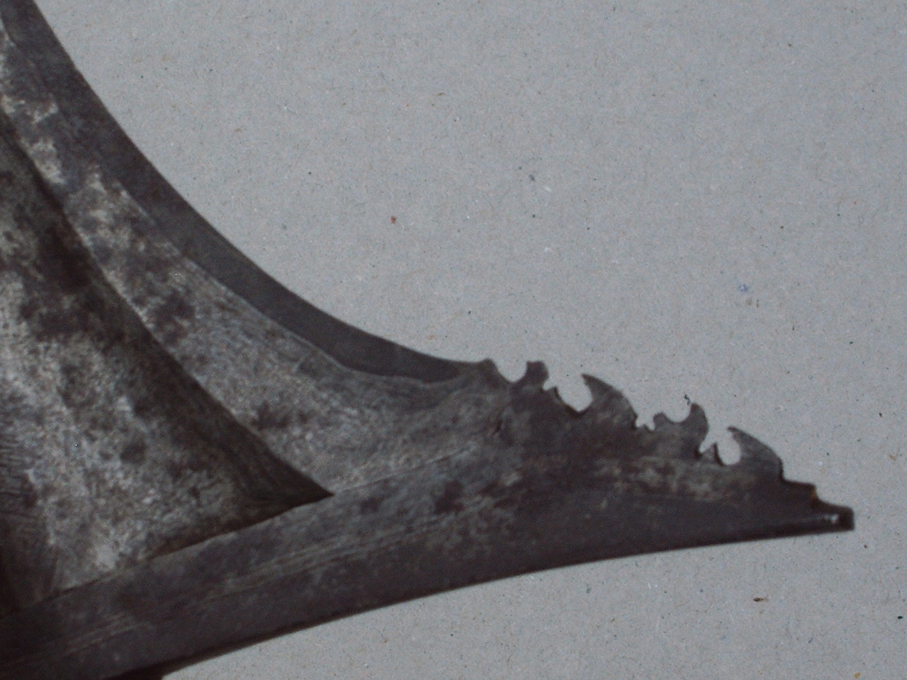

Johan, a keris blade is made by forge welding a piece of steel between two pieces of pamor material that has been made by forge welding iron and a contrasting material.
If the forging is well made and then well carved, the edge of the steel core projects beyond the pamor material around all the edges of the blade.
The diagram that Detlef has drawn shows the steel core where it has emerged from the pamor and now forms the edge of the blade.
The blade is in fact a laminated sandwich, pamor on the faces of the blade, steel core running through the centre of the blade and forming the cutting edges.

Yes, Sajen, thank you for indicating it, and this is what I expect to see, and it is clear on the blade that Gustav has presented. And it is a nice illustration of what Alan is describing. But I have been referring to Bejo's blade all along, specifically the excellent 3rd picture from the top on Bejo's post #3. I'm looking for that same edge showing the steel, but I do not find it at all.

Hello Johan,
use the picture from the uncleaned blade and make it bigger on your screen and you will see.
Old 11th August 2017, 04:02 PM   #26
Hello Johan,
use the picture from the uncleaned blade and make it bigger on your screen and you will see. Post #4.

Johan, if you look at the deep fullers in the blade base, you will also see the core, in cutting the fullers (kruwingan) the maker has cut through the pamor material and exposed the core.
In post#3, third image down, on the left hand side of the blade you will see a very faint lighter line. This can indicate one of two things, the first is that the blade edge was forged down prior to the cold work being done, the second is that we can see a weld joint in the core. Impossible to know which from a photo, this would need examination under magnification.
All of the wider black areas that we can see on the blade are most probably blade core. There is a very, very faint possibility that the inside layer of iron in the pamor was left thicker than the outside layers, and what we can see is not blade core, but rather an attempt to economise on work time and fuel, but this is unlikely.
Think of a pamor blade as a ham on rye sandwich, with the ham sticking out from the bread; cut the bread too thin, and you'll likely see bits of the ham trough the bread.
There is a method of blade construction that was sometimes used in very old blades, Mataram and before, where steel core construction is not used. It is an older method economises on steel by using an overlapping double V construction, similar to that used in Viking swords, where a steel edge is welded into the solid blade core.

Alan, I see the faint lighter line you describe. I had in my imagination expected the core strip to be more apparant. Thank you & Sajen for the trouble to point these out.
