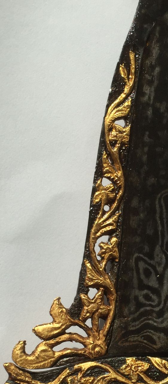

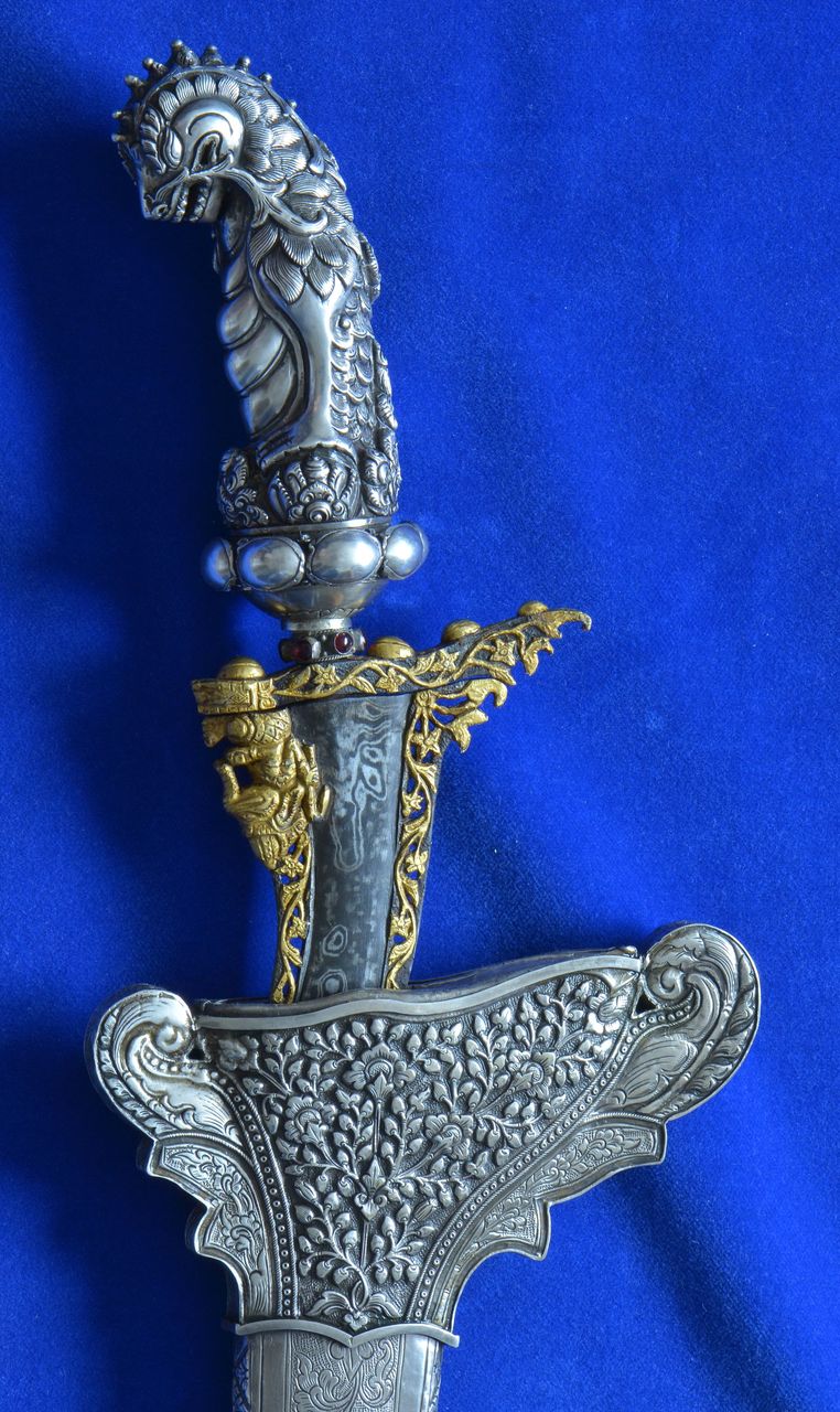

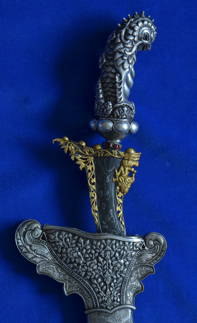

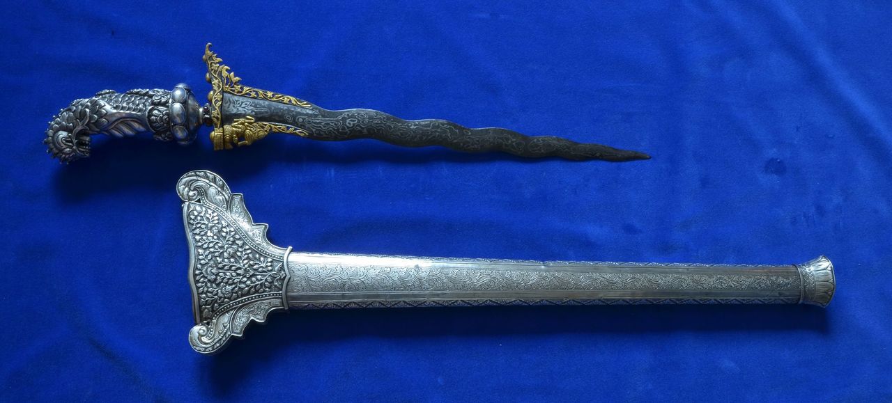

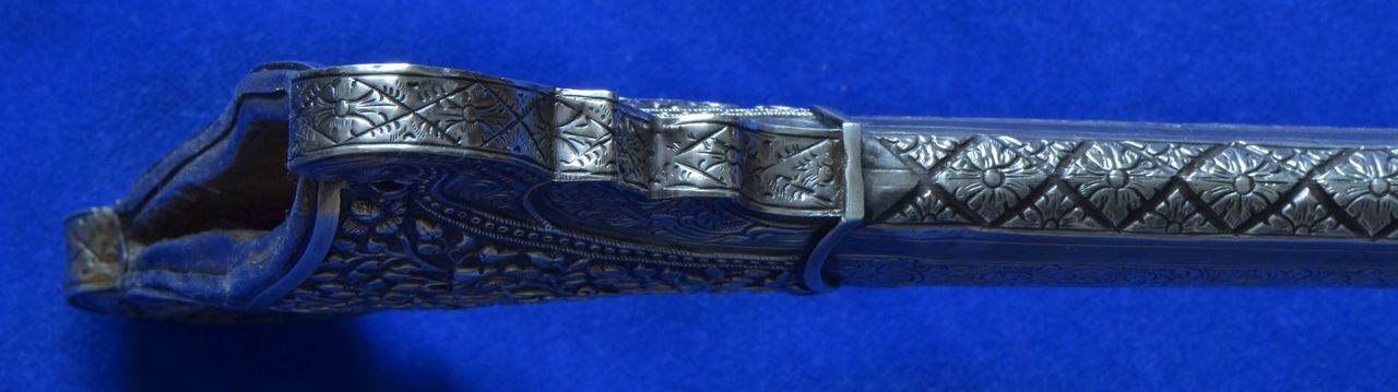

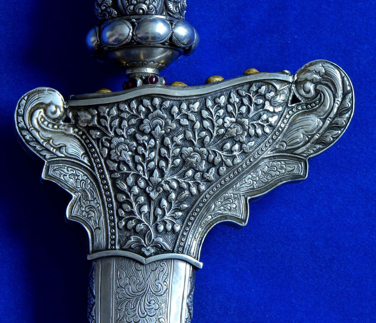

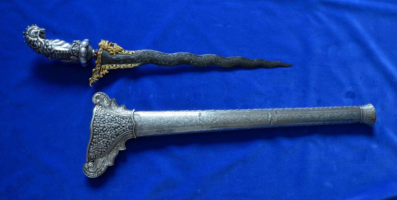

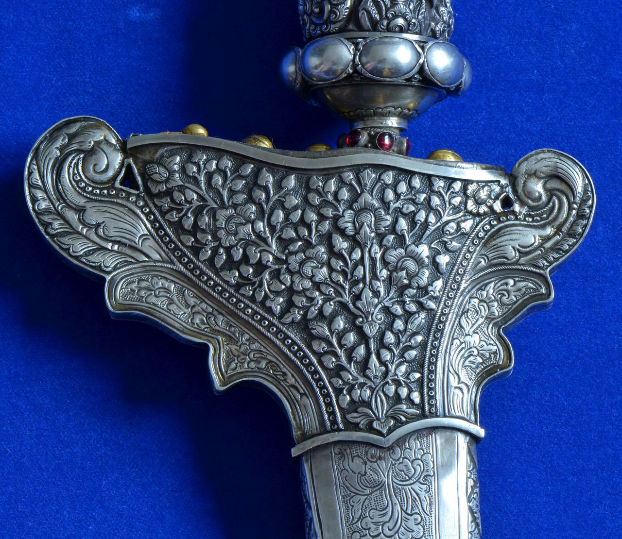

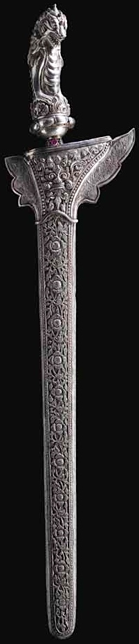

As promised, here is my Silver-Keris. I believe it is a Bali-Keris.
I don't wanna say too much, just listening to the opinions of other collectors.
What I can say is that hilt, scabbard and blade are of good quality. The golden layer on the blade is very thick, around 1/10 mm or more. Thick enough to hide some details of the figurine. Modern gold leaf is between 1/3000 (the thickest type) and 1/9000 mm thick. This means modern gold leaf is around 300 times thinner than this.
Now I'm really interessted, to read some opinions.
Best wishes,
Roland

more objects of photography

Hello Roland,
Nice kris but not traditional Balinese IMO, especially the sandang walikat scabbard with added buntut.

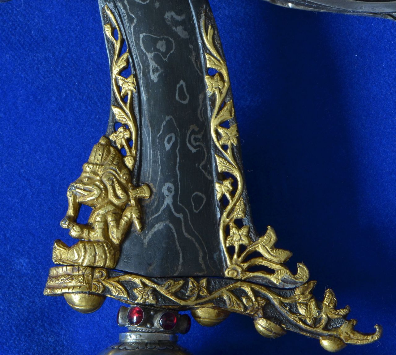

Hello Roland,
The kinatah technique does not use gold leaf.

Hello Roland,
I am probably one of the less knowledgeable people here, but to me, this keris looks fairly new.

From the Internet: "On blades from Malaysia, Kinatah is a relief decoration on a blade of the highest order."

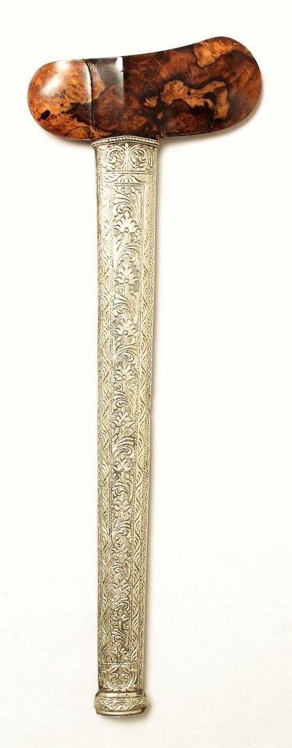

Old 11th August 2017, 01:50 PM   #7
I know and have handled the keris Roland own already longer several times and have Roland always told that this keris is very unusual and don't show traditional Bali work, this for dress and handle. The blade is an other object but in short, it's also not what I would think to see by a good old Bali blade.
Like all can see by the pictures Roland has posted is the quality of the silver work a very good one but I am unsure where done. The motives are like stated from Jean already are not Balinese style. But when you look to the pictures carefully (see in down) you can see the wooden core, the wood is old and very dry, this is nothing what I would to see by a recent worked scabbard. Also the overall impression let me think to see a fairly old piece in all parts in front of me.
By my visit to the Hollenstedt Exhibition I have had the chance to handle to more keris where the scabbard was worked in exactly the same manner, I am sure they coming all from the same workshop. One of this other two pieces has had a similar worked blade like the one from Roland without gandik figure and kinatah, the other one has had a fairly good worked older Bali blade. Also by this both examples was the wooden core visible and show good age. So I think that this pieces get worked wherever as earliest end of 19th century until latest the thirties.
Like said before, I am very very unsure where this three pieces get worked.

Hello Roland,
I mean that kinatah is made from gold sheet (thicker than leaf). Yes, original kinatah blades are generally of high quality.
As you have my book you can find a rather similar silver pendok on pic 3.15, page 201.

Hello guys,
There was much discussed about the dress of the keris but very little about the keris itself.
To me, this keris looks very new (max 10 years) and very Javanese and definitely not Balinese.
Am I right?! Am I wrong?!

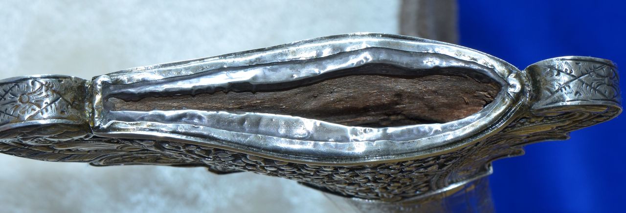

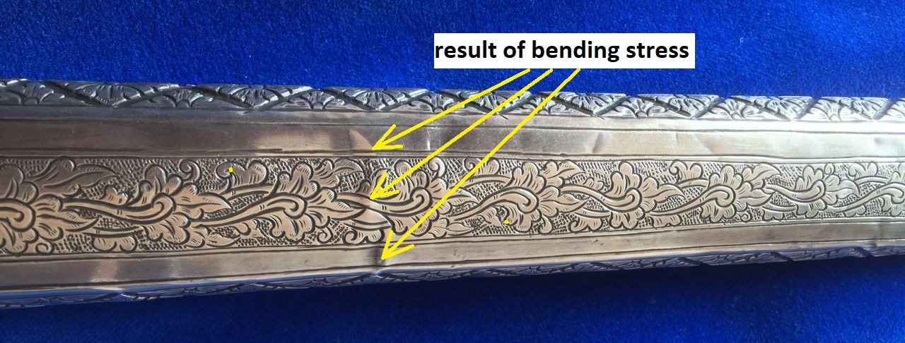

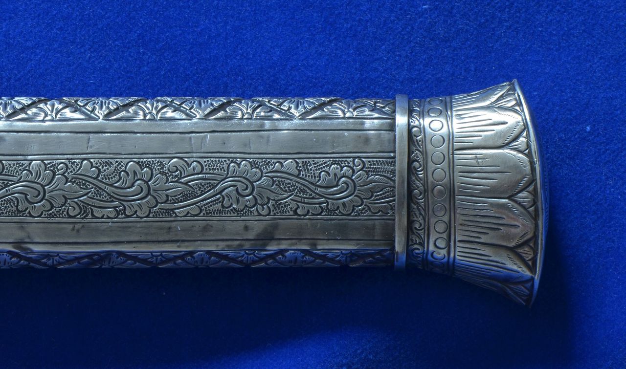

The pictures were made with a modern DSLR, the Nikon D7000 plus a high quality lens. Every picture has seen different automatic algorithms to increase the picture quality, without any possibility of influence by the user. The D7000 doesnt allow to use the raw-data. What I try to say is that pictures of old artifacts taken with a modern DSLR like this are always looks more modern than they are, always!

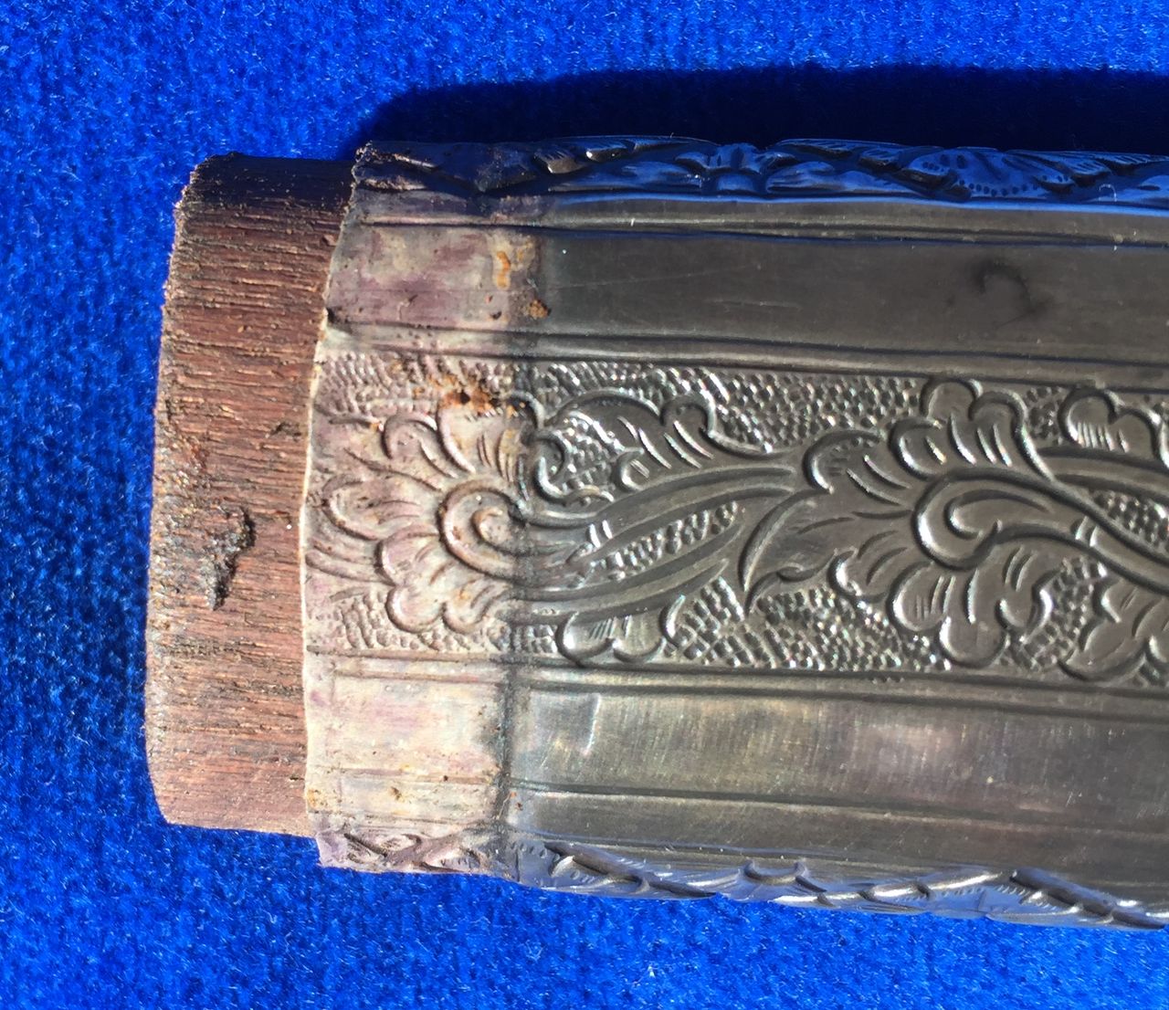

1: The scabbard of this Keris has been worn without any question with the typical signs of strain in the middle of the scabbard. Who was wearing such a big Kris ten years ago?
2: The blade itself has a mirror surface finish and a mild Waranga but there is corrosion everywhere and it takes some decades until a blade is corroded like this.
During the last cleaning the "foot" of the scabbard became loose and the resin inside the foot and also the wood from the core seem to be much older than 10 or 25 years.
If I see a artifact which is of unknown style to me, I would never judge the age of the piece by pictures. Especially if they are had been taken by an DSLR and if the artifact is made from gold or silver.
Without any question, this Keris is non traditional but this fact alone is no evidence for a recent production. What shall I say, my collection is full of unusual blades, I'm a kind of magnet for unusual artifacts
Roland

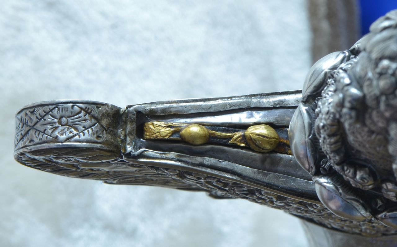

I do not wish to speculate about the age of this piece from the pics but would like to make the following observations:
. The silver color looks very clear, there is not much dark patina in the cavities which is typical of old silver artefacts. The silver quality seems excellent.
. I don't see much corrosion on the blade but some artificial pitting made by punching on the ganja and the pudak sategal on the sides of the blade around the kinatah.
. The kinatah fully covers the Ganesha figure but around the axe which he holds in one of his left hands there is a trace of gluing or welding which could indicate that the figure was added later.
. From my observations the "studs" on top of the ganja seem to be a recent javanese fashion.
. I have some quite recent silver krisses in which the wood core appears old and dry as this one.
Old 14th August 2017, 02:04 PM   #16
Cool
With precious metals any age estimation tends to be very tentative since newly pieces can be made to look old and genuine old pieces can look spanking new if repolished (or well preserved). Thus, we tend to look for a combination of craftsmanship, patina (if any), wear/damages, stylistic and other hints. However, none of these are really reliable since precious metals are fairly easy to be mended with...
Old 14th August 2017, 02:18 PM   #17

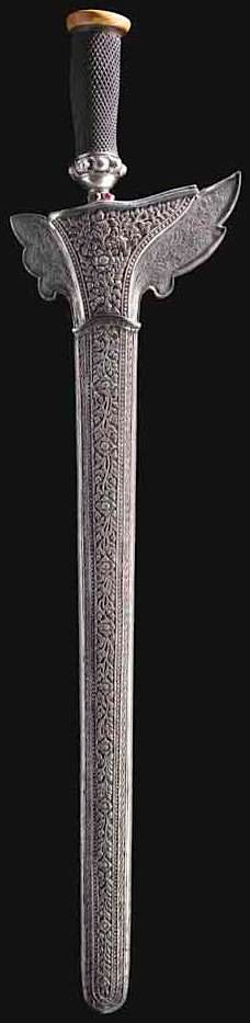

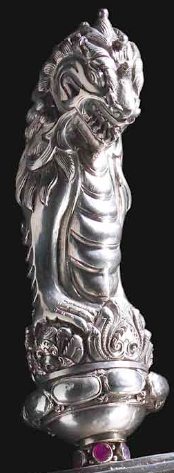

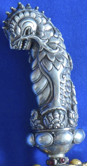

I guess we all agree that these 2 hilts are of the same style.
Still, I'd be very cautious of any claims like same maker/workshop/school - successful designs tend to get copied very quickly!
My best guess would be that this non-traditional hilt reflects the European influence during the first half of the 20th century (up to Indonesian independence) in Bali (or, possibly less likely, Lombok). I can't rule out a Madurese origin nor Kota Gede work though.
Photo credits: left hand pic cropped from the catalog of the IFICAH exhibition (Weihrauch & al. 2015), copyright Günther Heckmann (IFICAH); right hand pic from Roland (post #1).

Question
The scabbard is certainly interesting and with 3 examples we have established an pattern...
Note that Roland's example has the tips curled inside while in the 2 examples from the IFICAH exhibition they are pointing outside. Moreover, the carved motifs of all 3 examples are very different!
Any hints for the buntut being a repair for a broken scabbard tip in your piece, Roland?
I'm not convinced that Jean's pendok has any relationship with these 3 discussed here. (Thanks for adding the pic!)
Photo credits: left from Roland (post #1); middle & right hand pic cropped from the catalog of the IFICAH exhibition (Weihrauch & al. 2015), copyright Günther Heckmann.
In a tropical climate, the corrosion visible here can easily develop in much shorter time!
I'm uneasy with this blade. To me it looks like a larger blade got sacrificed for carving the "picture"/figural gandik as well as the open-worked kinatah on the blade (and raised kinatah on the gonjo); especially the cuts made into the base of the blade to demarcate the kinatah borders does not flow with traditional esthetics IMHO. While Ganesha is done akin Hindu style, the general craftsmanship looks almost Madura/Jawa to me; however, the warangan looks acceptable by Balinese standards - something I've not seen coming from Jawa/Madura mranggi yet...
While Madura as well as East Java received quite a bit of Balinese cultural input by expats, I'm inclined to believe these ensembles may be from Bali, possibly pre-independence attempts to sell keris to affluent European visitors?

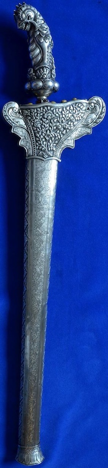

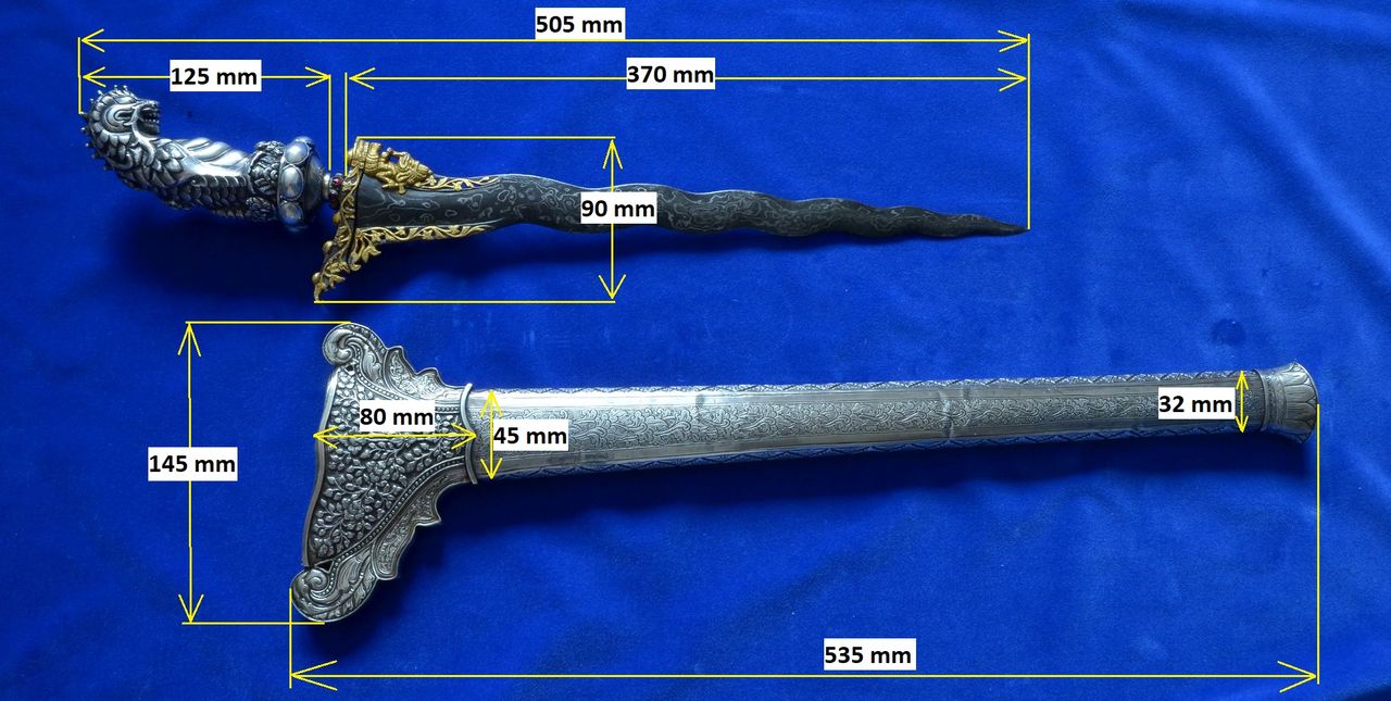

More pictures and the measurements.
I hope that the Keris is still interesting and that I can add more good pics for the discussion.

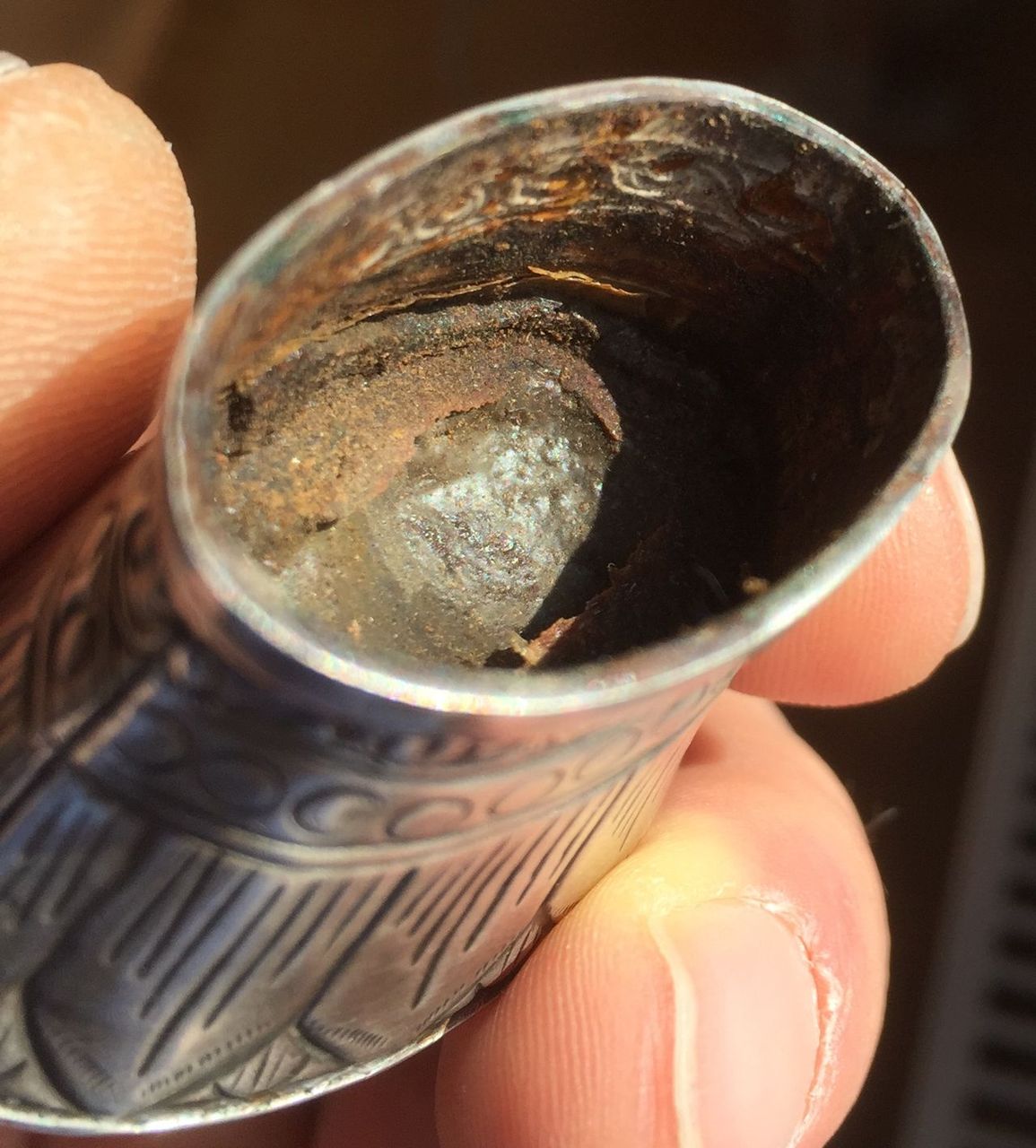

The piece which I call "foot" was solid in place. It became loose recently, after I tried out a new cleaning method with sweet almond oil, which is very thin. The wooden core looks old. Even the the red wax-resin-mixture (?) doesnt looks new to me. And not to forget it was hermetically closed before I was using the almond oil.
The scabbard is full of small dents and one large one from which I think it could be caused by bending stress, the typically markings.
The piercing in the area above the greneng were made with great effort, not just simple drillings.
The Ganesha-figure is an integral part of the blade, no upgrade.
Really hard to say what it is. One possible old background could be, that it was made for the dutch VOC as a present for proved soldiers.
Roland
p.s. all pictures are untouched, I reduced the size only.

Well, i don't think there is any question that this blade has some age. That doesn't mean that it is not of the contemporary period of keris manufacture. Let's keep in mind that even a keris made in 1977 will have 40 years of age on it.
Thanks for the detailed dimensions. Though the blade length is more in keeping with blades from Jawa and Madura i do not believe the length of only 14.5 inches counts it out as Balinese work. I personally own 2 keris which are most certainly Bali/Lombok blades that are 12.5 and 13.5 inches respectively.
Roland, the VOC ceased operation at the very end of the 18th century. While we may be able to continue debating the age of the blade i, for one, would rule out that it comes from that early a period of time.
I don't think there is really any question that we are indeed looking at a keris of some quality so regardless of where the final consensus falls regarding age and origin i believe we can all agree that this is still a keris worthy of discussion.
