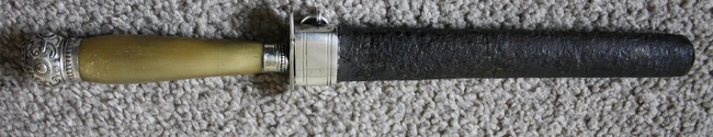

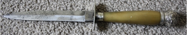

this is a William Rodgers blade but in I'm not sure if the handle and mounts are original ,the blade fits into the sheath very nicely , but I'm noe expert and any info and comment will be much appretiated

Very nice find, I'm sure all of it is original, many of this type had similar grips etc.

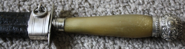

thanks for you reply , after researching his name all I could see was bowie type knives and made me wonder if this has had a different handle , also the end of the scabbard is open ,should this also have a silver mount ?

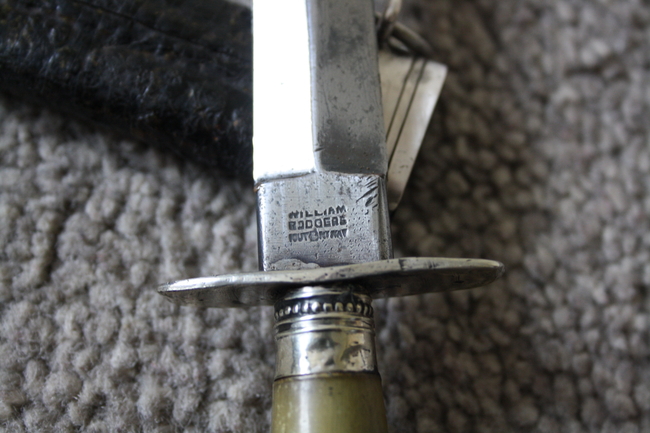

Posts: 1,204
I am 99% sure this is a 1950s Rodgers blade which has been remounted and also refitted with this scabbard. This pattern of blade is claimed by some to have come into existence during WW2 but so far I have seen no prime source evidence of this , but am keen to be shown some. The fittings do not look British to me and I feel this is a 'marriage' .... not to deceive but perhaps more likely to appeal to 'Mediterranean' or similar tastes .
William Rodgers name appears on English knives of the 20th century with the I CUT MY WAY trademark ... but in the 19th century W Rodgers is more associated with spring , tool and balance manufacture . I believe the firm ceased to trade in the early 20th century and the name and trademark was taken up by the cutlers Clarke of SHEFFIELD. The famous 19th century maker of high quality bowie and hunting knives was the unrelated Sheffield firm of JOSEPH RODGERS.

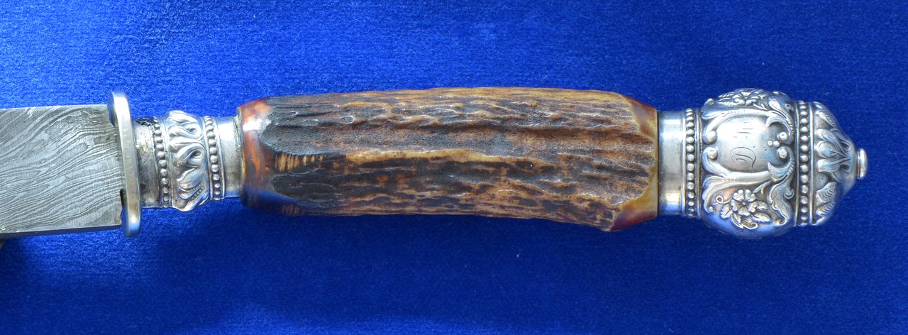

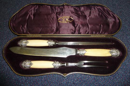

this may even be a 1950s Wm Rodgers blade with the additional enhancement of 19th C cutlery fittings .... I illustrate here 2 grips , one from this knife , one from another knife on this site which many of us believe is definitely a marriage between older grip and newer knife , and for reference , a Victorian cutlery set of the type that is often cannibalised to make this hybrids. This is course is a theory offered by me in this particular instance, though my experience is that it commonly occurs .

After looking closely I think for sure the handle and scabbard have been added later to the blade , for one the handle is very slightly off centre to the blade and the blade is too short for the scabbard , plus the pommel has very close resemblance to some cutlery as shown , well thanks for everyones input
