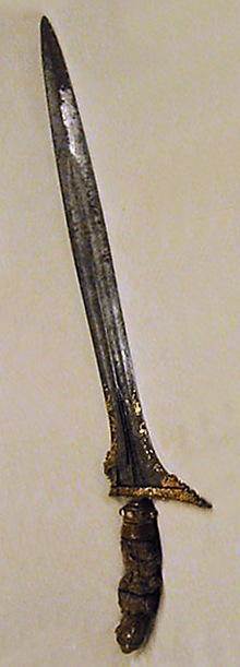

Hasekura Tsunenaga was a Japanese samurai and diplomat who was born in 1571 and died in 1622.
He undertook diplomatic missions to the Americas, Europe, and the Philippine Islands.
He returned from his mission the the Philippines in 1620, and amongst the things he brought with him was a keris from the Indies, that is, Indonesia.
That keris can now be found in the Sendai City Museum in Japan.
Here is a picture of the keris brought to Japan in 1620 by Hasekura Tsunenaga.

Please accept my apologies for posting such inadequate images.
I find that I am unable to understand almost anything about a keris unless it is in a vertical orientation, rather than a horizontal orientation, in fact when I want to really look at a keris I download the image and change the orientation to that shown in this post.
Hopefully these images will be a little more useful.

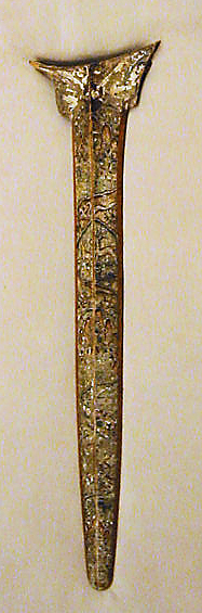

Time to bump a worthy thread. Can anyone say anything about the sheath?

Well, this really deserves more attention, yet there is a problem with adequate online pictures, with available material a discussion here seems to be impossible. Slightly better pictures of sheath and blade, good pictures of hilt and description are to be find in Jensen's Krisdisk, chapter 7 (Bali), pages 31-33.

PERHAPS THE DESIGN ON THE SCABBARD IS ONE OF THE BATIK DESIGNS. THESE DESIGNS IN BATIK AND PUA AND OTHER FABRICS HAVE A LOT OF DIFFERENT MEANINGS JUST AS PARMOR DOES. I WONDER IF THE HANDLE IS CARVED TO REPRESENT A JAPANESE GOD FIGURE PERHAPS QUAN YIN. THAT WOULD BE APPROPRIATE FOR A GIFT TO THE JAPANESE RULER. IT NO DOUBT WAS MADE ESPECIALLY FOR THAT PURPOSE UNLESS IT WAS AN OLD ONE AT THE TIME .I SUSPECT IT WAS SPECIALLY MADE FOR THE PRESENTATION AS AT THE TIME GIVING SOMEONE SOMETHING OLD WAS OFTEN LOOKED ON UNFAVORABLY. THE ANTIQUE IDEA WAS NOT YET BORN AND OLD STUFF CONSIDERED LESS VALUABLE. JUST CONJUCTURE AS USUAL

Would love to have had even bigger pictures to tell if the scabbard has gold on it for sure and what quality of work. Same for the rest of the piece, especially since it is rare to have such an old piece like this with documented provenance going back that far.
Still thanks for posting this Alan.
Also I wonder if this was indicative of the size of blade back then, getting smaller in Indonesia as time progressed and larger in the Philippines.....

The sheath is painted. There exist three or four such old sheaths with painted alas-alasan motifs. Painting is done very spontaneously, the depicted animals are well characterized.
Old 17th February 2011, 03:50 AM   #16
Posts: 7,423
Thank you - I now see it as gloss and not metal shine. Helpful.

Jose, these white stains are places, where ground coat is visible.
The sheath is made from one piece of wood, gandar iras, like all sheaths, which can be traced back to the first half of 17. cent. Gambar is unfortunately broken (the wright side).

You are obviously better read on the subject than i. When i speak of "most writers" i am not coming from the scholarly position you are at all. I have only had the opportunity at this point in time to research this from the internet. It seems to be that "most writers" in that venue are following the Manila story. This does not make that story necessarily so and i have made no claims that it is. This is often the case on the internet where one particular story gets picked up and repeated again and again by various writers on websites.
Why does it not matter to me whether he was gifted the keris in Manila or Spain? Because in both scenario he is still not receiving it as a gift from the Balinese court. This is all i have been trying to establish here. If Phillip III presented this keris to him in Spain or by a Spanish official in the Philippines it has a completely different meaning, purpose and power than if it was presented to him directly from the Balinese court. From it's original source the gift would have come as a particular transference of power that would be absent from a second or third hand re-gifting of this keris. This is all i am trying to establish.
I posted the map to show the travel route, not to establish time lines so an off date does not particularly concern me. Is this travel route fairly correct? Has anyone written anything placing Hasekura in Bali or what is currently Indonesia at any time during his travels? This was my purpose behind posting the map, merely you help establish what you yourself are already saying, that Hasekura did not receive this keris in Bali directly from the court.
It also seems that the Christian symbolism on the keris would not likely have been placed there for the benefit of the Christian covert Hasekura since it seems that the gift of the keris may well have always been intended to be received by Date Masamune, who as far as i can tell was not a Christian. If the keris was originally gifted to Philip III or some earlier Spanish king perhaps the symbolism was placed there for their benefit. If the keris was indeed completely painted in Bali this would make more sense.
Old 19th February 2011, 11:31 PM   #30
Gustav
Join Date: Jun 2009
Posts: 1,348
David, there is no victory at all possible, and please accept my sincere apologies, if my tone seemed or was adversarial.
You are absolute right, there is most probably no possibility this keris beeing a gift directly received a Balinese court. Other possibilities each could have their speculations (behind some speculations are undeniable facts we learn to know) and averment proofs. I still have the deceptive idea, to follow each possibility would give me (and us) a better understanding or probably only a feeling of history, and in the case of this keris history is pure adventure.
