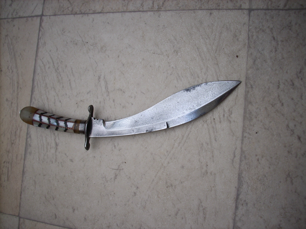

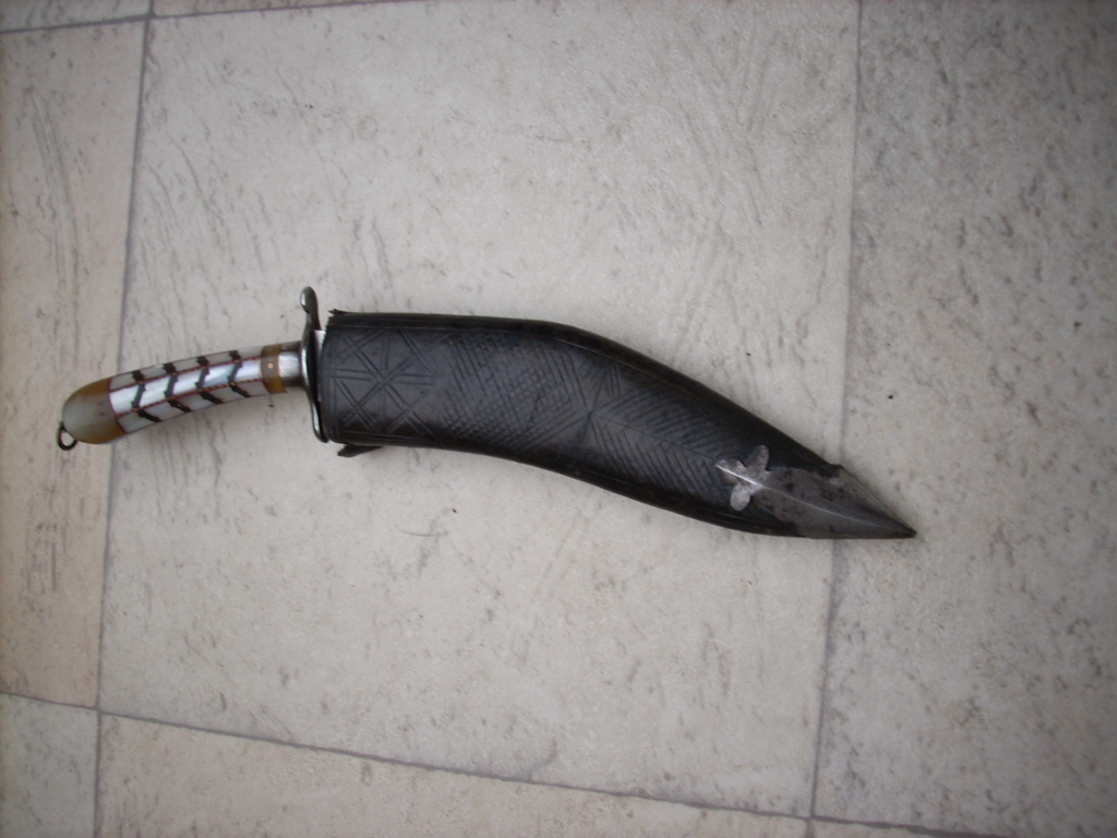

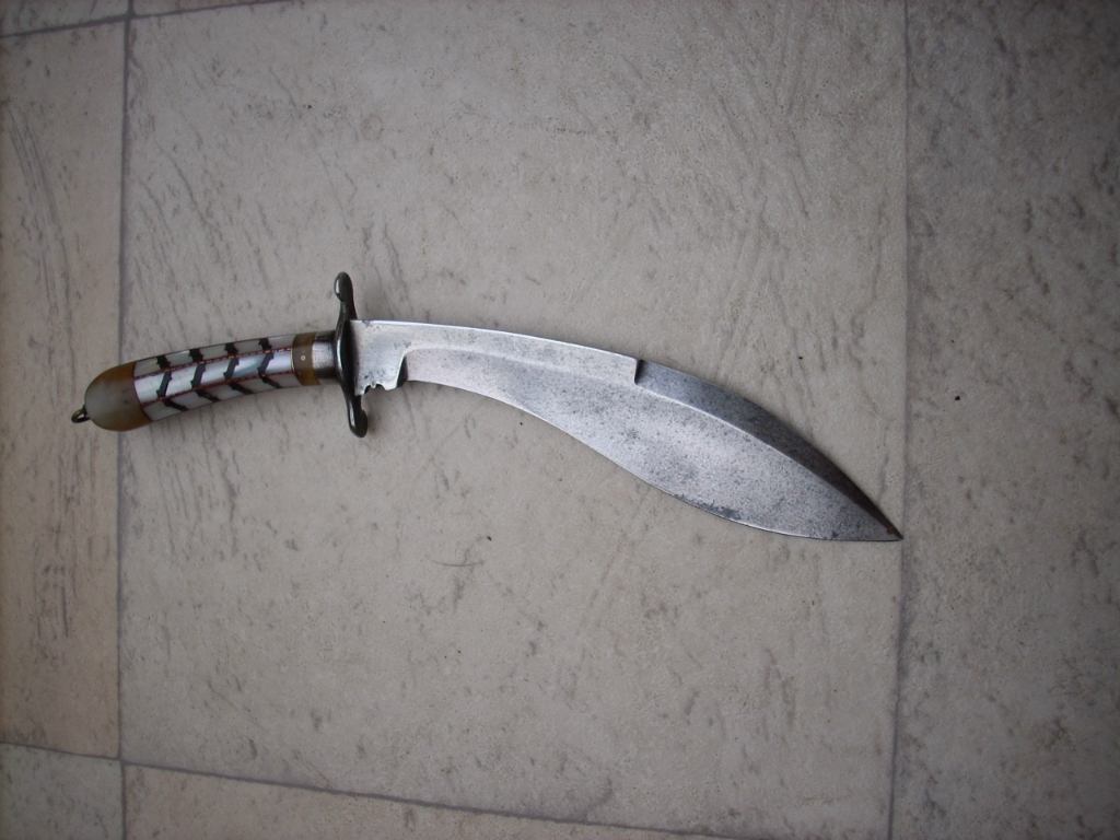

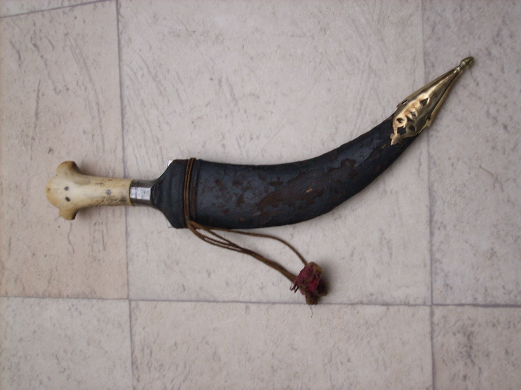

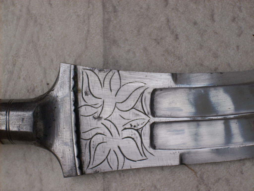

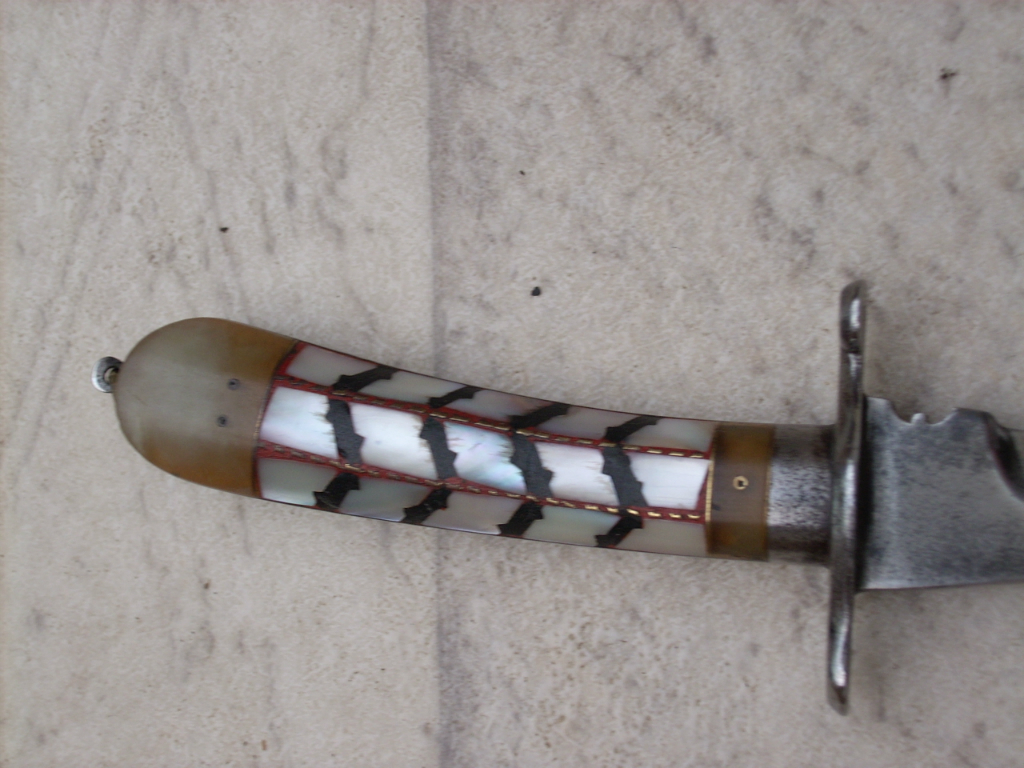

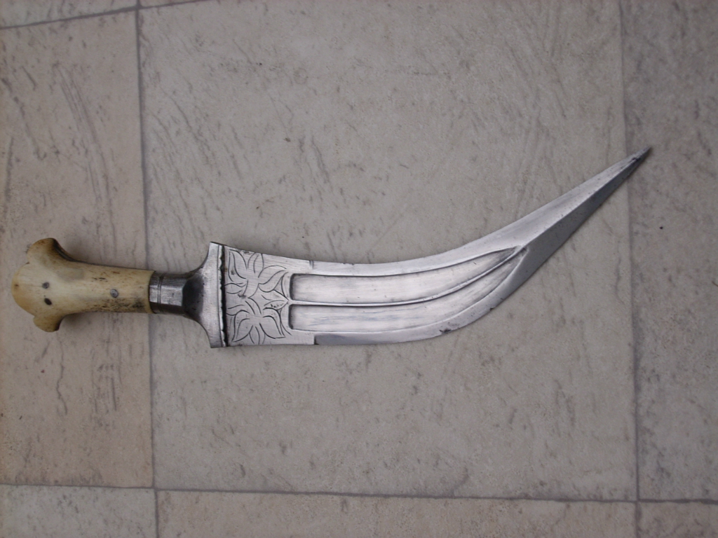

Hello Everyone,
The first one, I believe, is called a The O/L"Tigers Tooth" and has an O/L of 13 ins with a blade 8.5 ins lg x 4 ins wide at its widest part. the hilt is bone and the scabbard is of wood covered in leather with a brass chape.
The second one has a "Kukri" shaped blade with a pearl and greenstone hilt and short steel Quillon's. The O/L is 9.75 ins having a blade length of 6.5 ins. The scabbard is of wood covered in leather with a steel chape.
Thank you

Here must be one of the Indian Classics... The Tiger Tooth... In my view one of the most efficient dagger blades ever made. Often with a reinforced tip for piercing armour/thick clothing and with chiselled blade making for a lighter stronger blade. I assume the tang goes right through to the typical 3 lobed pommel and there is one I saw with a tiger striped horn hilt ~ at 2 below..
See1. http://www.oriental-arms.co.il/item.php?id=2495
See2. http://www.swordsantiqueweapons.com/s995_full.html
Ibrahiim al Balooshi.

Hello Miguel,
Things are pretty clear for the Tiger Tooth dagger but I see no comments on the second one.
In my oppinion, the second one is a more artistic XX century Indian interpretation of a Khukuri, hence not an etnographically correct Indian knife. Yet, it appears to have a very well made, sturdy and effective blade.
If I were you, I would test the Tiger Tooth dagger for wootz, as most examples I have seen were made of wootz.
Marius

For the second one please take a look here:
http://www.vikingsword.com/vb/showth...highlight=pesh
By the way, there were very good Indian antique Kukris as well. There are some examples on the Kukri Forum. But this one is of course different.
The Tiger Tooth is pretty late too, I believe from the second half of the 19th century - beginning of 20th century.

Thank you Marius for your reply, I had never thought of the second one as an Indian Kukri. I have always thought it was Indian made as a hunting knife for a European with it having quillons and a false edge. With regard to the first one I don't think it is wootz I cant see any pattern in the steel.
Thank you also Tatyana, the link was very interesting. I also agree with your dating.

Hi Miguel,
Are you sure that the Tiger's Tooth has 4 inches (10cm) at the widest part of the blade? It seems disproportionate with its total lenght, but I can be mistaken. The surface of the blade looks as it could be made from multilaminated steel, but photos are tricky.

Hello Gonzalo, well spotted, thanks for pointing it out I must be cracking up
I have checked again and the blade is 2 ins wide just below the hilt then 1.75 ins. Not sure about the blade looks like carbon steel to me.

Thank you, Miguel. The multilamination can be made of many steels, and it was made in the old times from simple carbon steel. Several plates were forge-welded to make a blade.

Hello Miguel,
Wootz IS carbon steel and when polished, it is practically undistinguishable from plain carbon steel.
I agree with the age of the blade suggested in previous postings and with the high probability it is not wootz. However, it remains a slight probability that the blade is older than it was estimated and it is made of wootz. And I would explore this possibility.
Anyhow, both are very nice and well made blades!
From what I have observed there are two types of Indian tiger tooth jambiya, and they are a type of jambiya....one type has a thick blade and the tang is also thick. The other type is a much less well made type.....a thinner blade, a bit flexible even and also thin at the tang.....for a person of less wealth, or a youth maybe, who knows but there is a world of difference between the two types...I also have one of the lesser types and it is certainly not wootz. hard to tell with a photo but in hand the difference is clear.
Miquel can tell which type his is.
Thin blade, thin tang, not wootz.
Thick blade and tang.

These are good examples of the two types I mentioned, one with ivory hilt and wootz, the other with horn and not wootz.
The family of daggers known as Tiger Teeth are coming from North India, They are characterized by the slender curved blade, usually with reinforced edges and slightly thickened tip. The hilt is of a full tang style, with big bolsters, wide grip strap and very typical three lobed pommel. This specific one has a fine 8 1/2 inches blade forged from good wootz (Damascus) steel with fine gold koftgari work on the ricasso bolsters and grip strap. The grips are ivory. Total length 13 1/2 inches.
Indian tiger tooth jambiya, 33cms long when sheathed.
Out of the sheath the dagger is 30cms long with a broad 20cm blade.
The hilt is a very well selected section of horn, cut and polished to resemble Tiger stripes. The blade has two broad central fullers, a chiseled forte and a thickened armour piercing point. The sheath is timber inners covered in a finely grained leather that is finished with a pierced brass end with a bud finial.

Not just a "kukri" shaped blade, it is an Indian kukri, nice example, I have not seen this type of handle on a kukri, the same type of work usually seen on Indian daggers.

Thank you for the info from which I would say mine is a lesser type. Another reason I think this is the line engraving at the Rivas so. The better quality one look to be chiselled decoration.

Look at the dagger with the blue background. Do you see the peacocks on the blade?
You often see them on early southern katars.
Ok, they are not easy to see, but with a bit of experience it should be possible.
Here is Runjeets description, he also mentions "South India".
Indian tiger tooth jambiya, 18th century, The blade is earlier and very rare, similar to blades found on hooded Katar from the Vijaynagar empire of South India (1336-1646 AD). The blade was probably traded into North India where it was mounted on this hilt, there is a possibility that the whole dagger was made in South India (The Deccan) in the North Indian ‘Tiger-Tooth’ style using a local blade.

Miguel, yours is in excellent condition, it looks like the chape has been polished. When you put several examples of the same type together you can see the similarities.
Old 21st June 2017, 07:40 PM   #28
Miguel
Join Date: Jun 2015
Posts: 584
Hello estcrh, I see what you mean they are almost identical. The scabbard and chape for this type of knife follow a similar design as do the knives, interesting.
Regarding my knife with a kukri type blade, I agree that it is Indian as made in India with an Indian style blade but I don't see it as an Indian Kukri. I have a number of kukris and the shortlist blade is 11ins, kukris are far larger weapons. In my opinion I still think it is a hunting knife made for a European. Many years ago I saw a similar size knife in a dealers shop which had a jade /green stone, slab hilt and was told by the dealer that it had been made in India as a hunting knife for a member of the British military The size just doesn't seem right to me to be used as a kukri in my opinion.
Kukri come in many different shapes and sizes.

Hello estcrh, nice selection. Have you any images of Kukris with a false back edge similar to the blade of my knife? I have not seen one which is another reason for my believing it to be a custom made knife.
